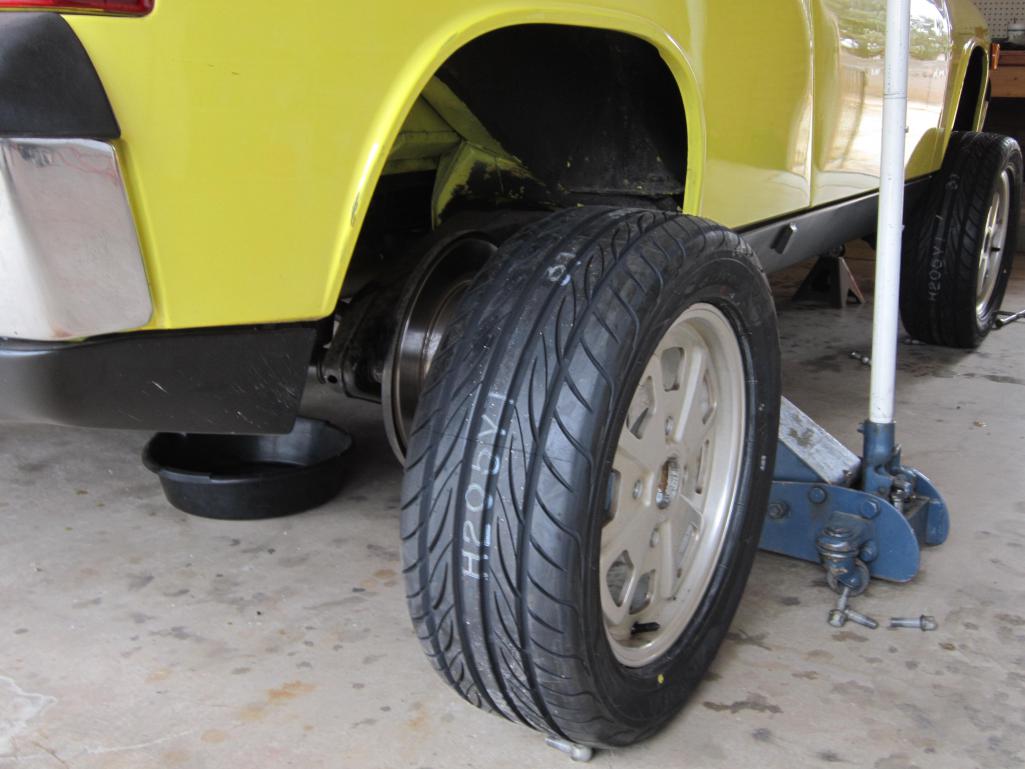

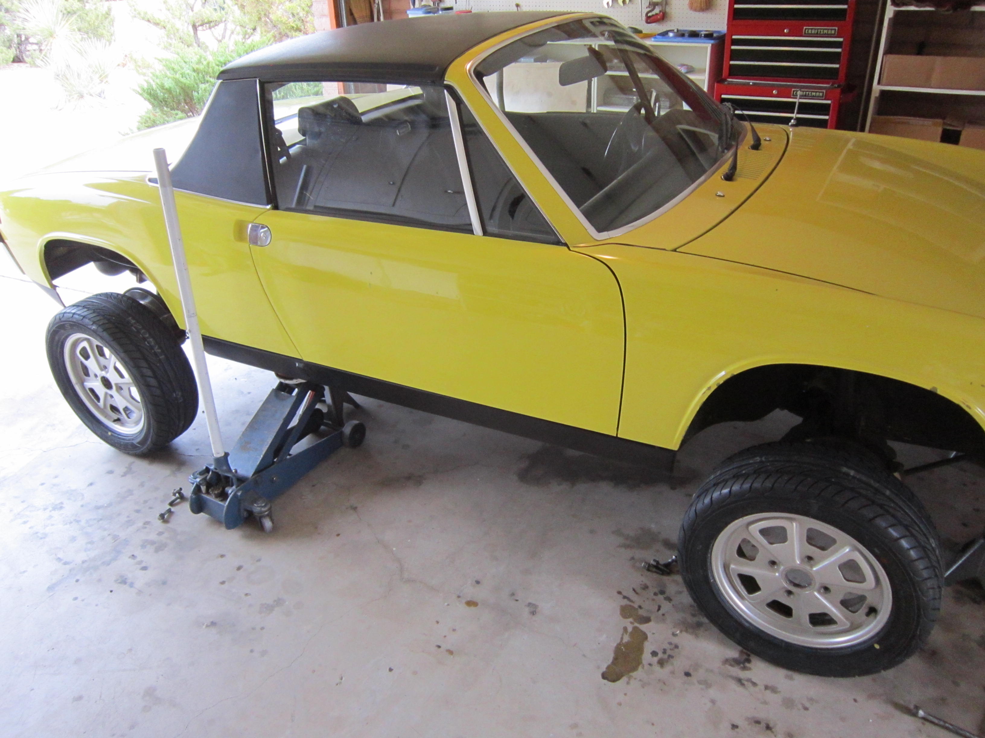

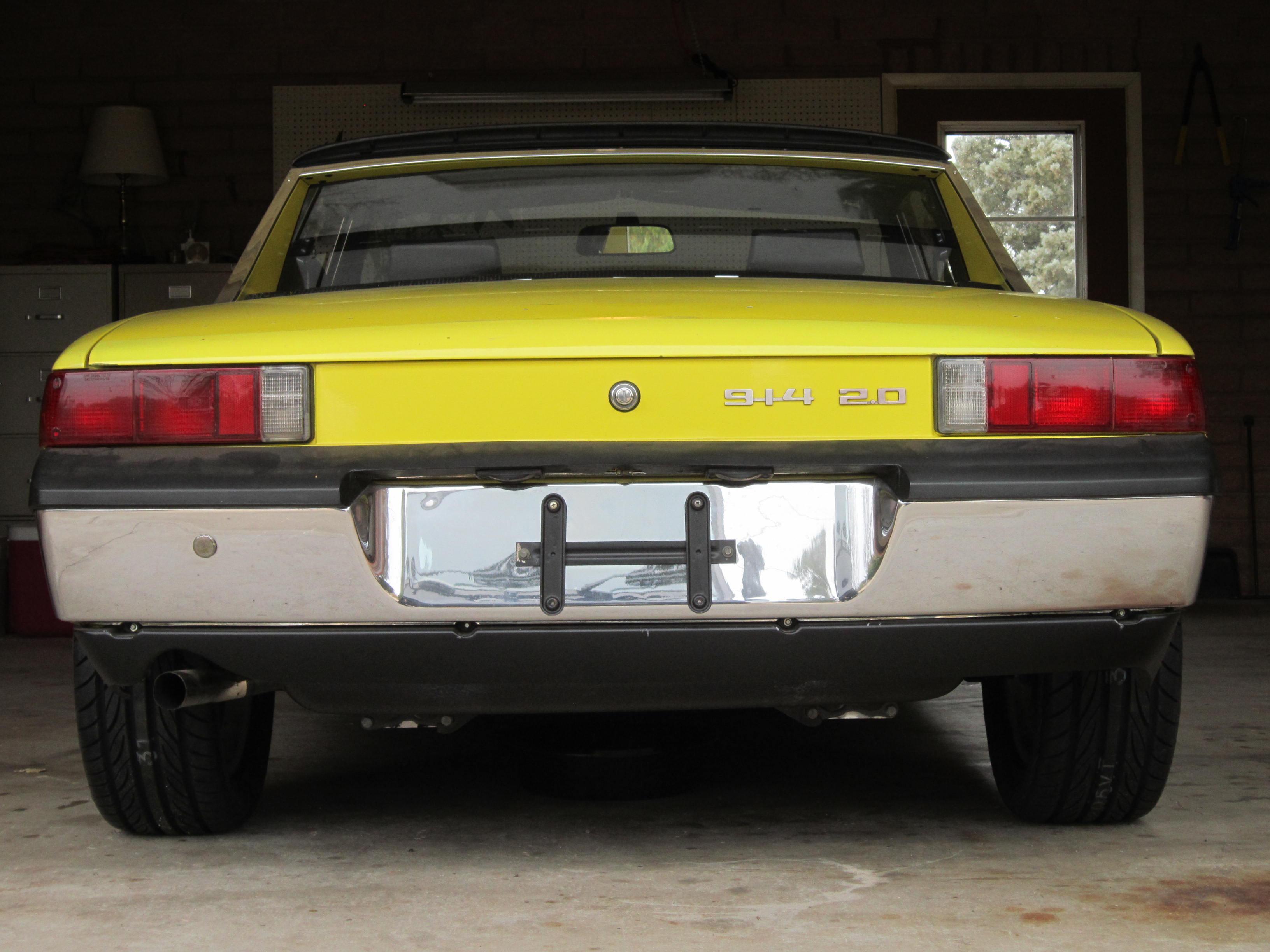

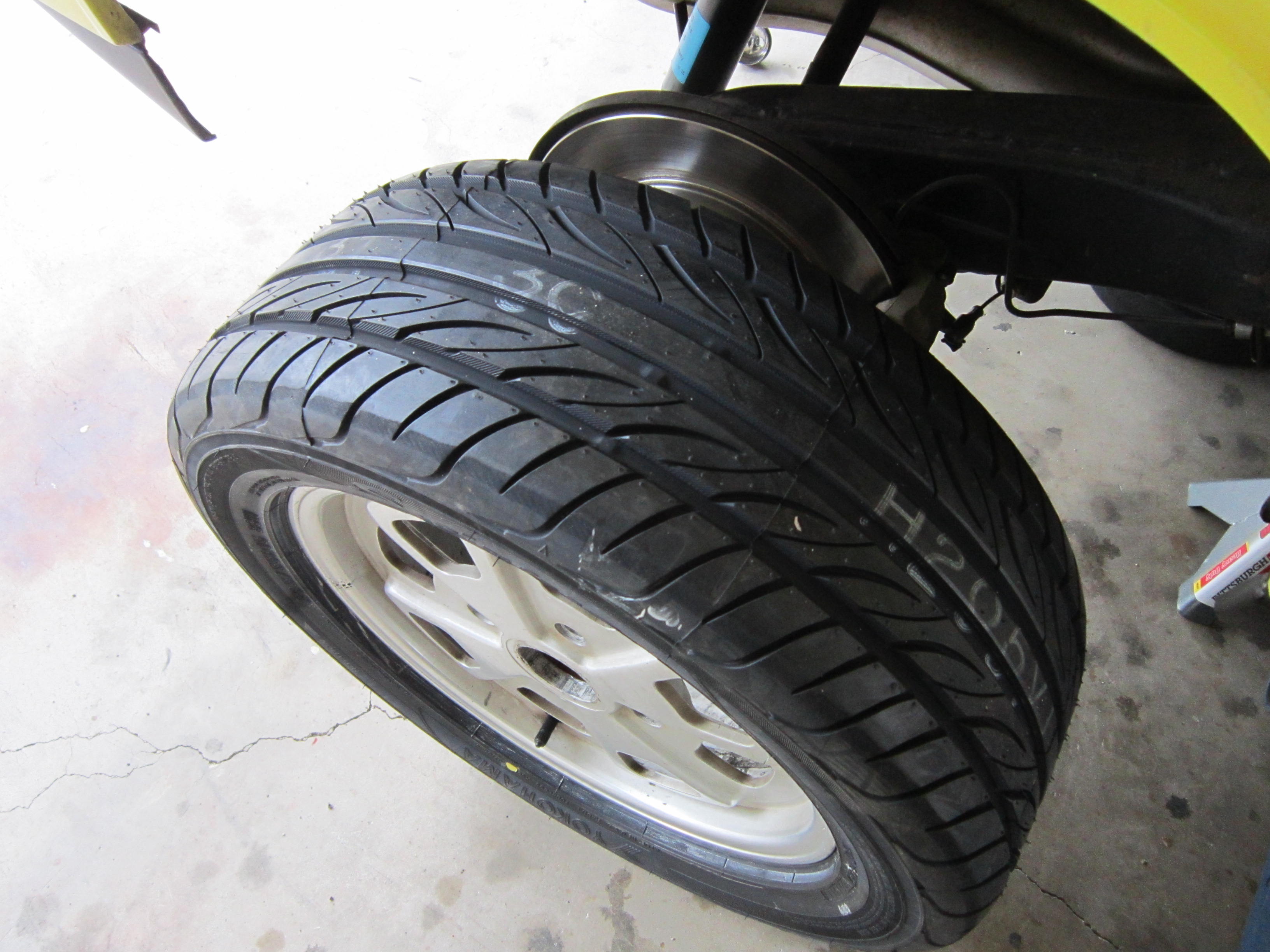

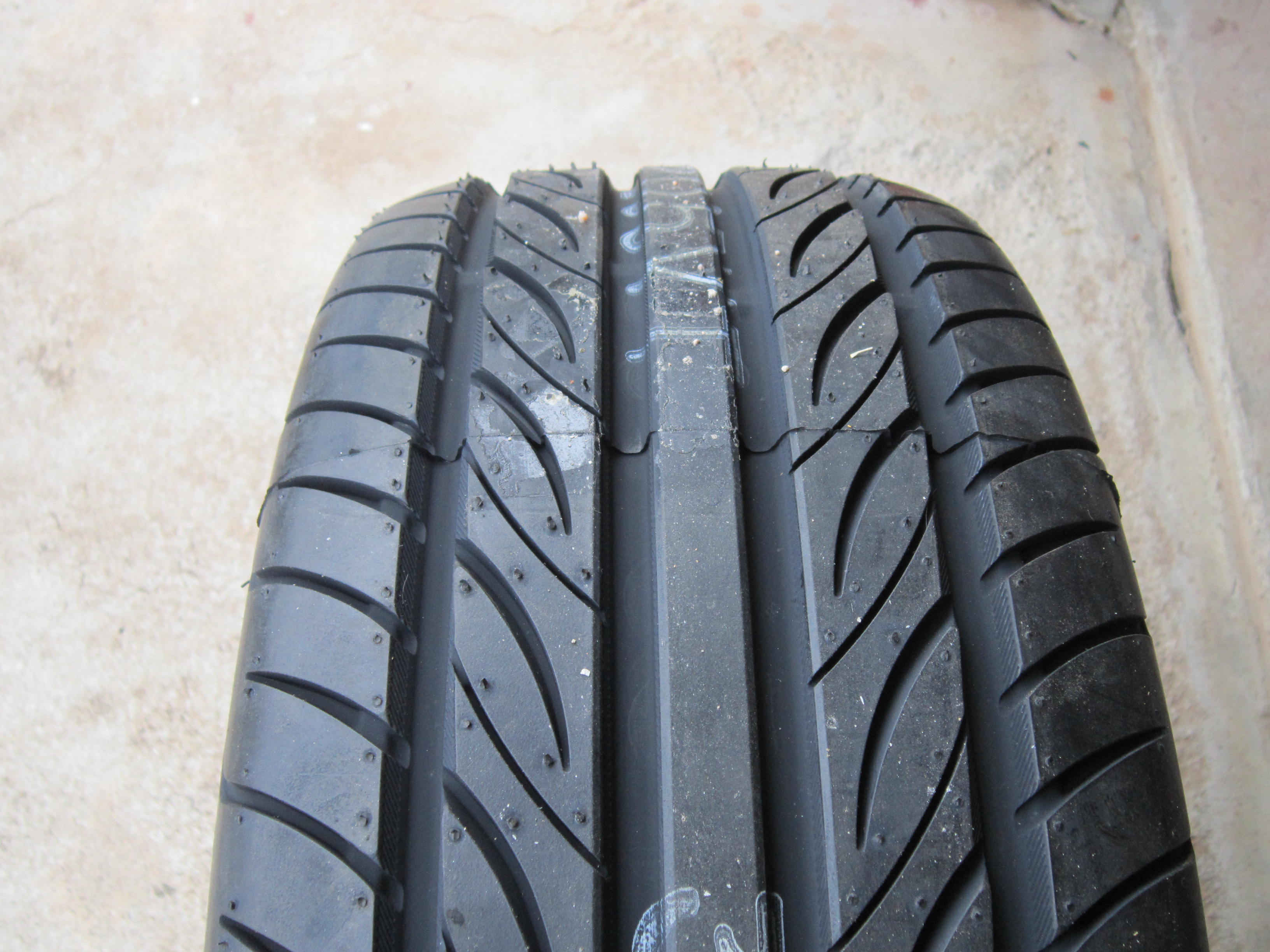

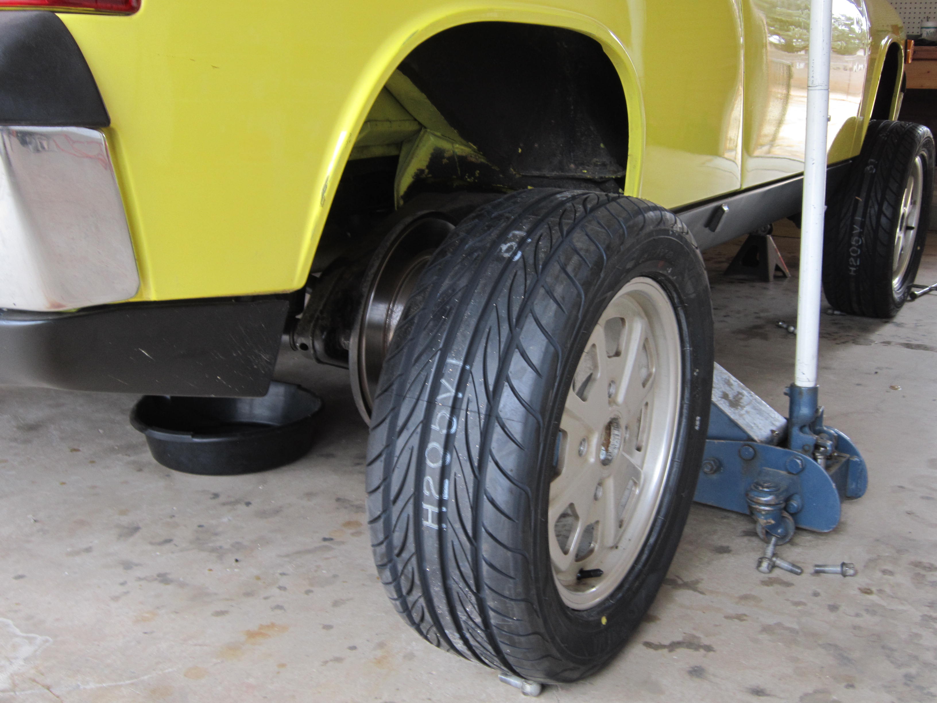

Greetings... I just bought new tires for my 914, ended with happy results, so far !
I have the 15" Fuch alloy rims & want to keep them, so was limited to that size range, obviously. Finally decided on the Yokohama S-Drive 205/55 R 15, which is, surprisingly, made in USA !
It's an aggressive looking tire, business like in the spirited driving venue. A more modern low profile, which is better for cornering, but provides slightly less ground clearance. Has a high speed rating, temp & traction ratings also. Looks like it was made for the 914, in my opinion. However, being a 205, looks a bit pudgy on the 5.5 " Fuchs rim. Height is 23.5", mounted, not 24" that Discount tire claims.
Price is a moderate $95. per tire, plus the usual M&B fees, etc. Oh yes... tread width is 7.5 " So far, I like it.
Here's some pics of the occasion...Attached Image Attached ImageAttached ImageAttached Image[attachmentid=634
