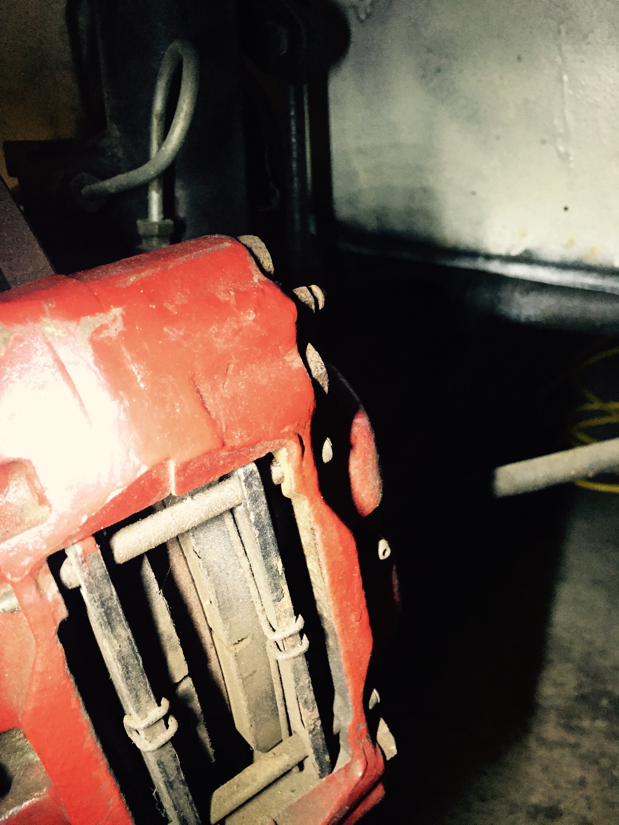

the volvo is a hell no... the old PO did this swap..
