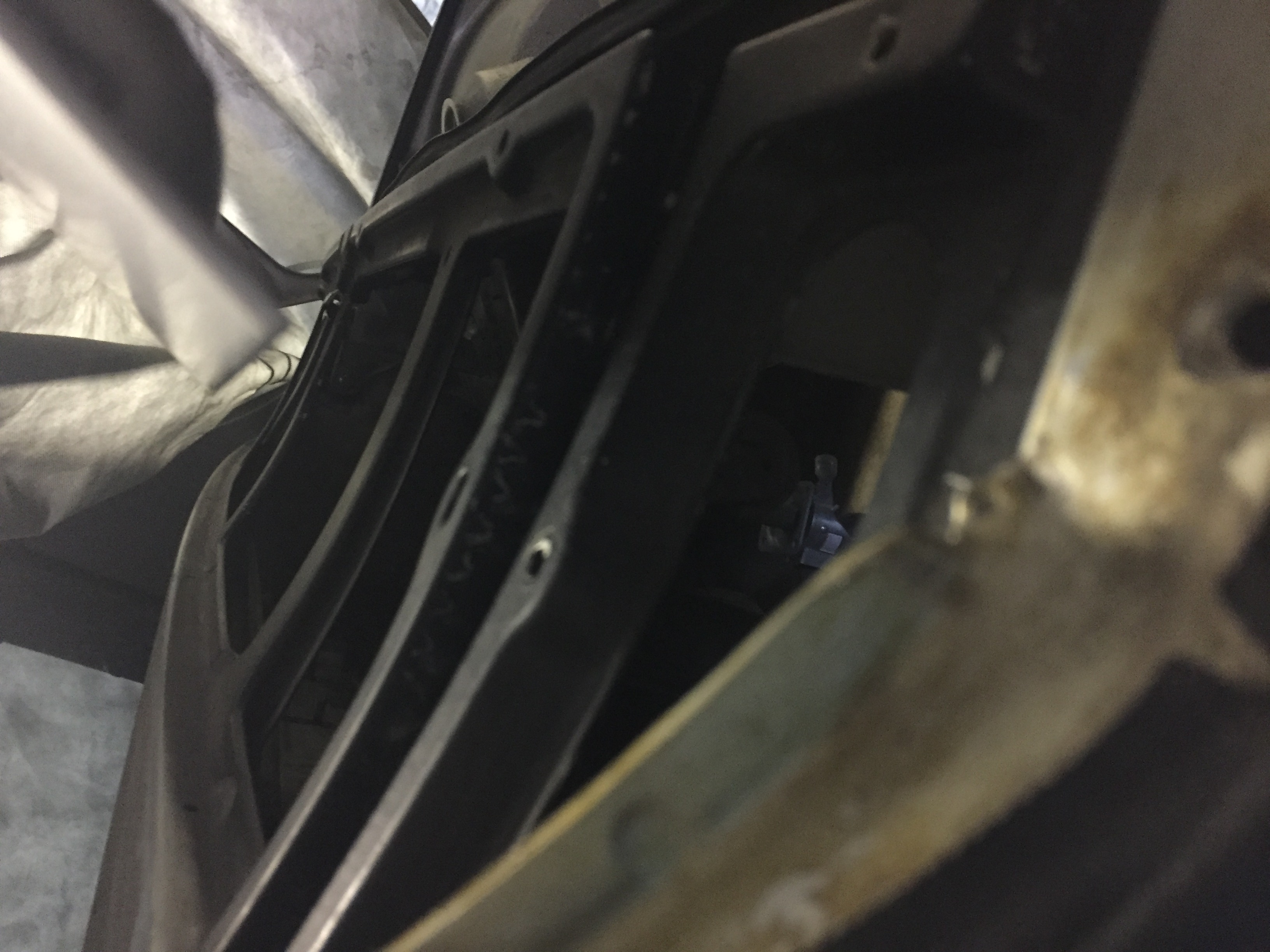

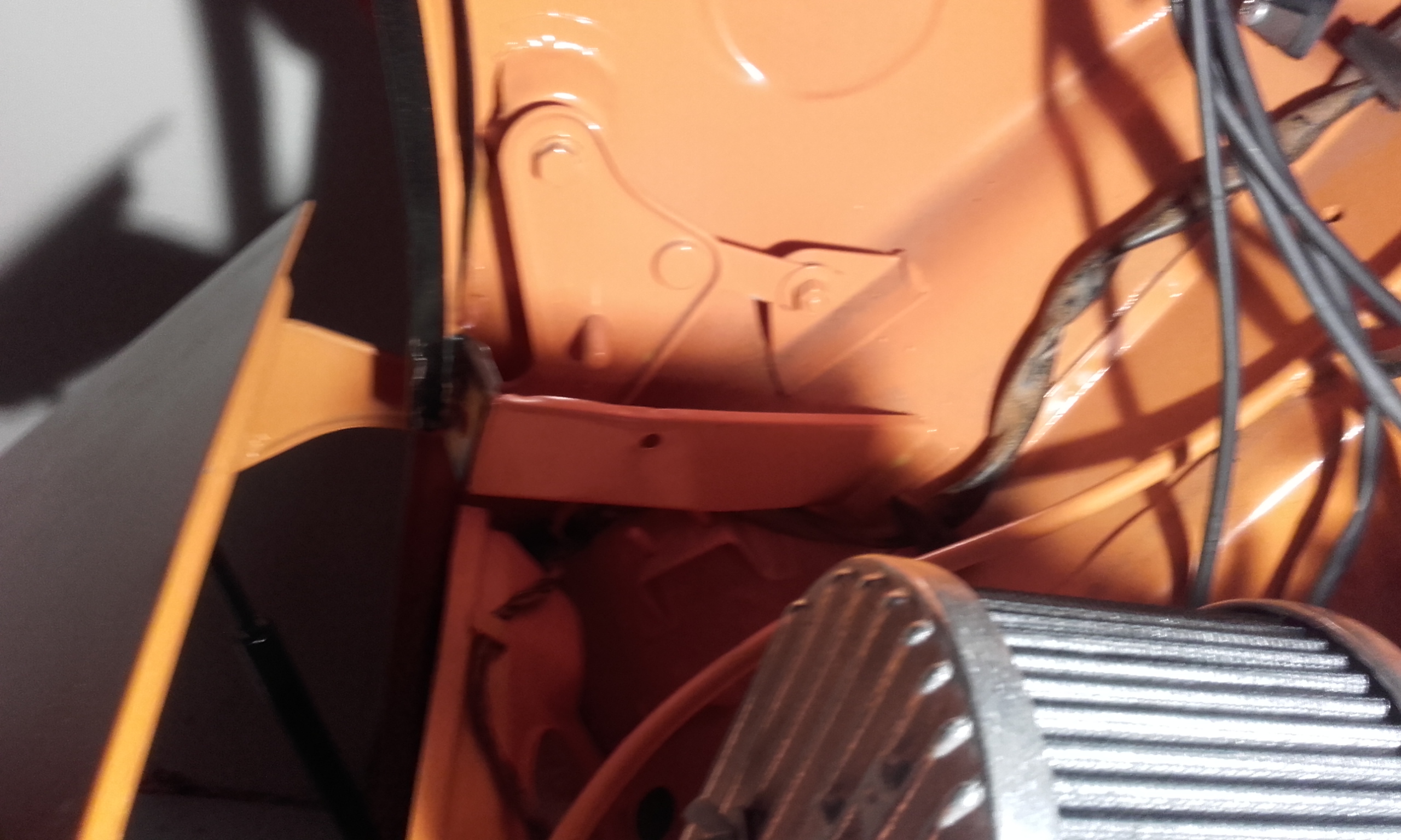

My trunk opens (& always has) into the small grill sections either side of the decklid.
rubber mark has some angled rubbers for a bracket in this area but i cannot find in google images any pictures with this bracket fitted.
Can someone show me this on their car?

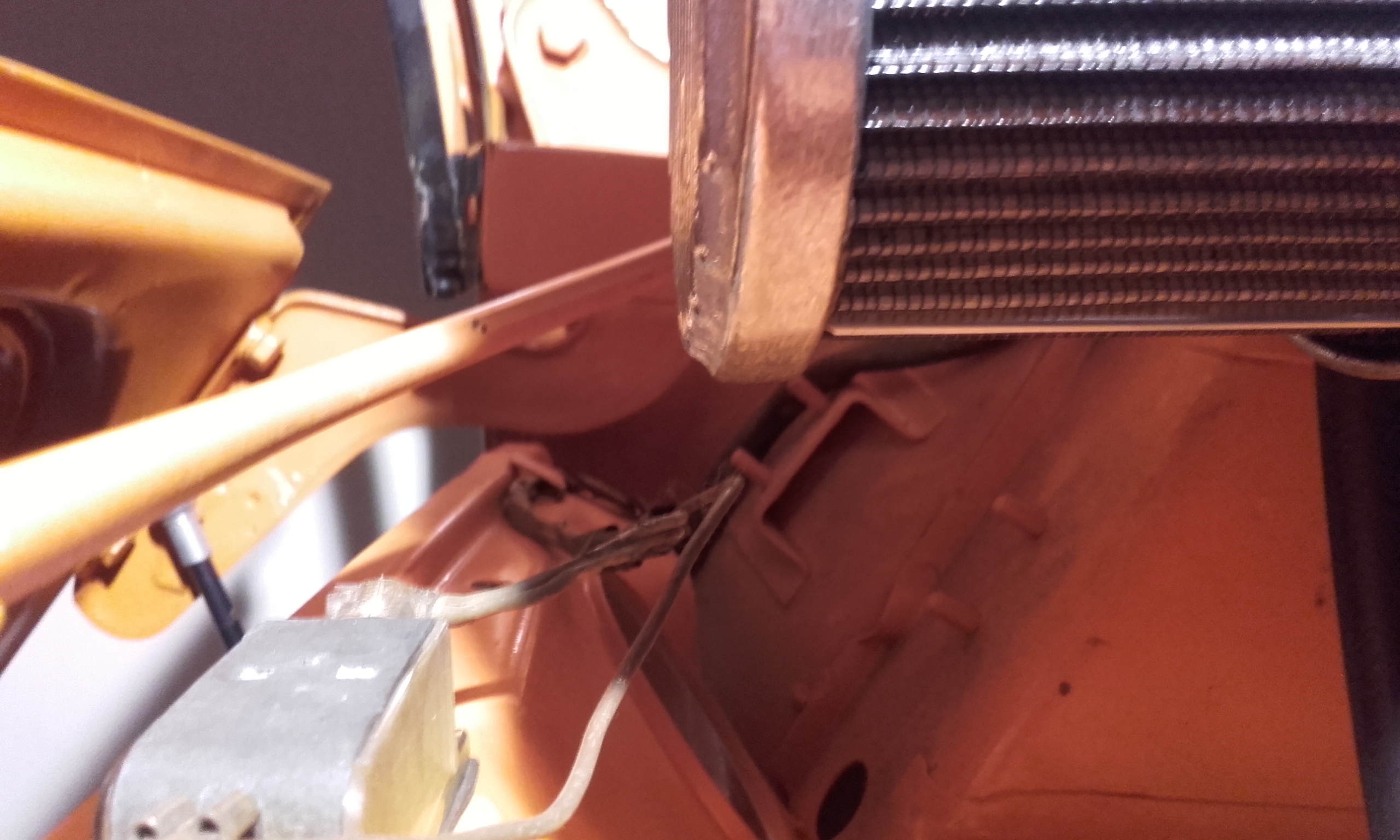

I think the angled rubber piece you mention is the one that goes on the ENGINE cover and keeps that from hitting the trunk lid when both are open. It mounts under the trailing edge on the driver side using one of the rain tray bolts.
From your description, your problem seems to be that the trunk opens too far (or is not adjusted properly?). The stop for the trunk hinges may be played out. Check the little stop-strap connected to the hinge (in the third picture), which I believe is the mechanism that keeps the trunk from opening too far.

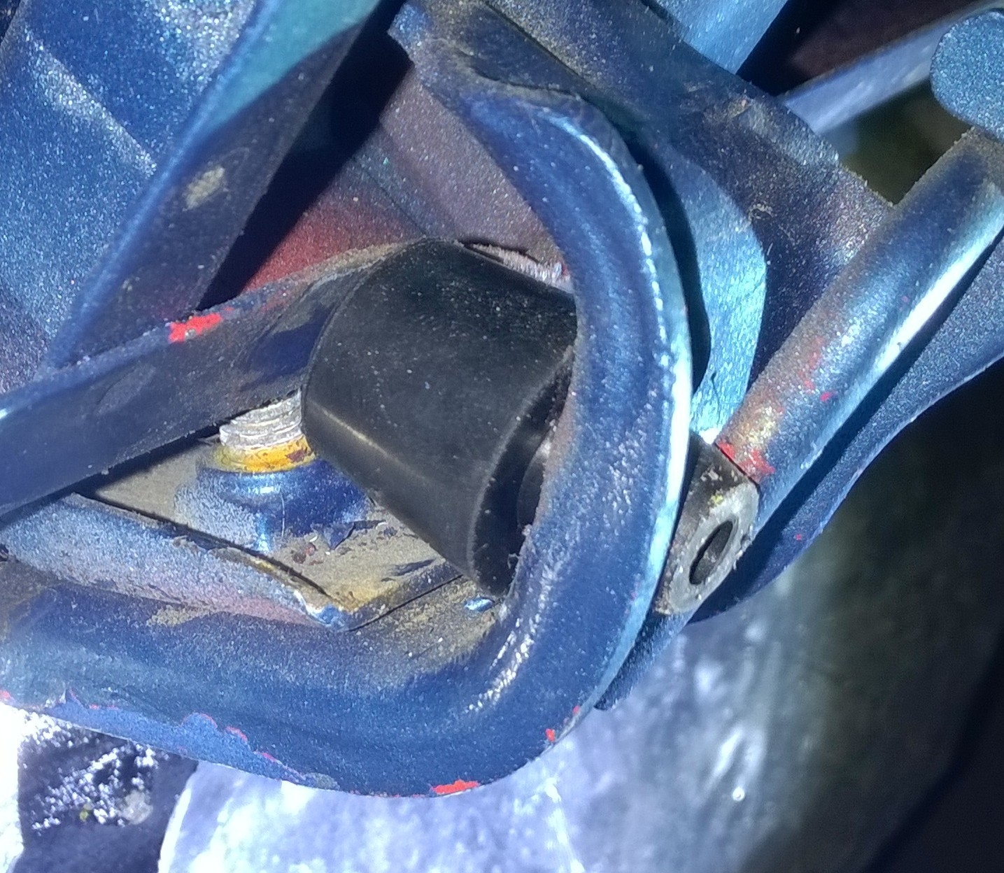

Are you talking about the little rubber bumpers in the hinges that stop the lid from opening too far, or the L-shaped piece that hangs from the engine lid and is held in place by the metal angle bracket?

I had the same problem on my 71.I even had new pivots welded on .I ended up shortening the flat straight piece that pivots and stops the trunk hinge from contacting the bottom of the end grills.

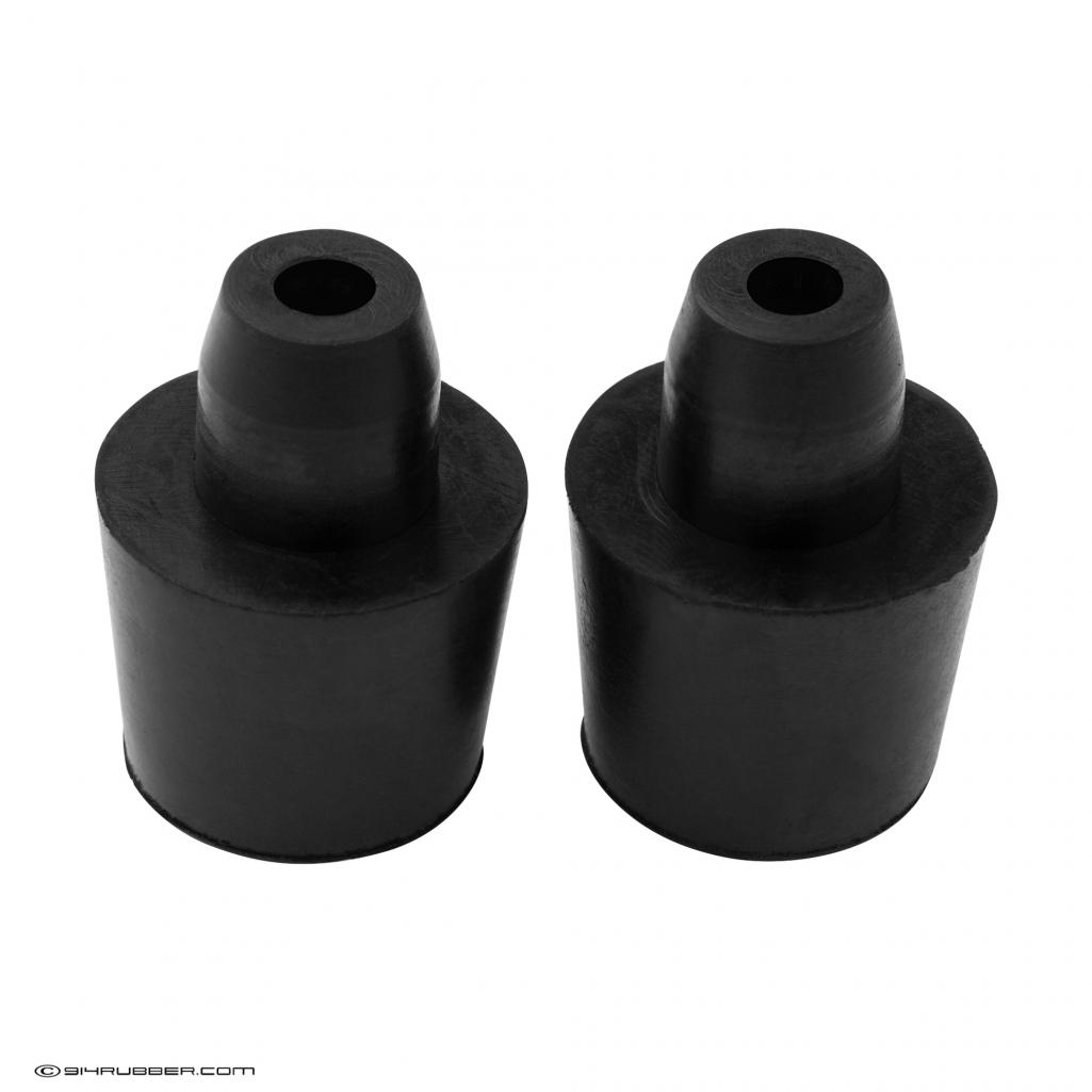

I have the deck lid bumper. If it's the L shaped one -
https://shop.914rubber.com/Rubber-bumper-to...m?categoryId=-1
Mikey914
post Mar 8 2018, 01:12 AM
The rubber man
Posts: 12,772
Joined: 27-December 04
From: Hillsboro, OR
Member No.: 3,348
As well as the ones that go on the hinges.
https://shop.914rubber.com/Engine-Deck-Lid-...m?categoryId=-1
I'm sure URO will be knocking them off soon so I'll offer 20% off what you can buy the URO part at. Just let me know when you find it. (IMG:style_emoticons/default/biggrin.gif)

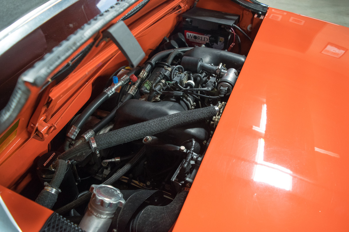

and that is the car we did, a 3.6 conversion to a 73 914. Fast car
