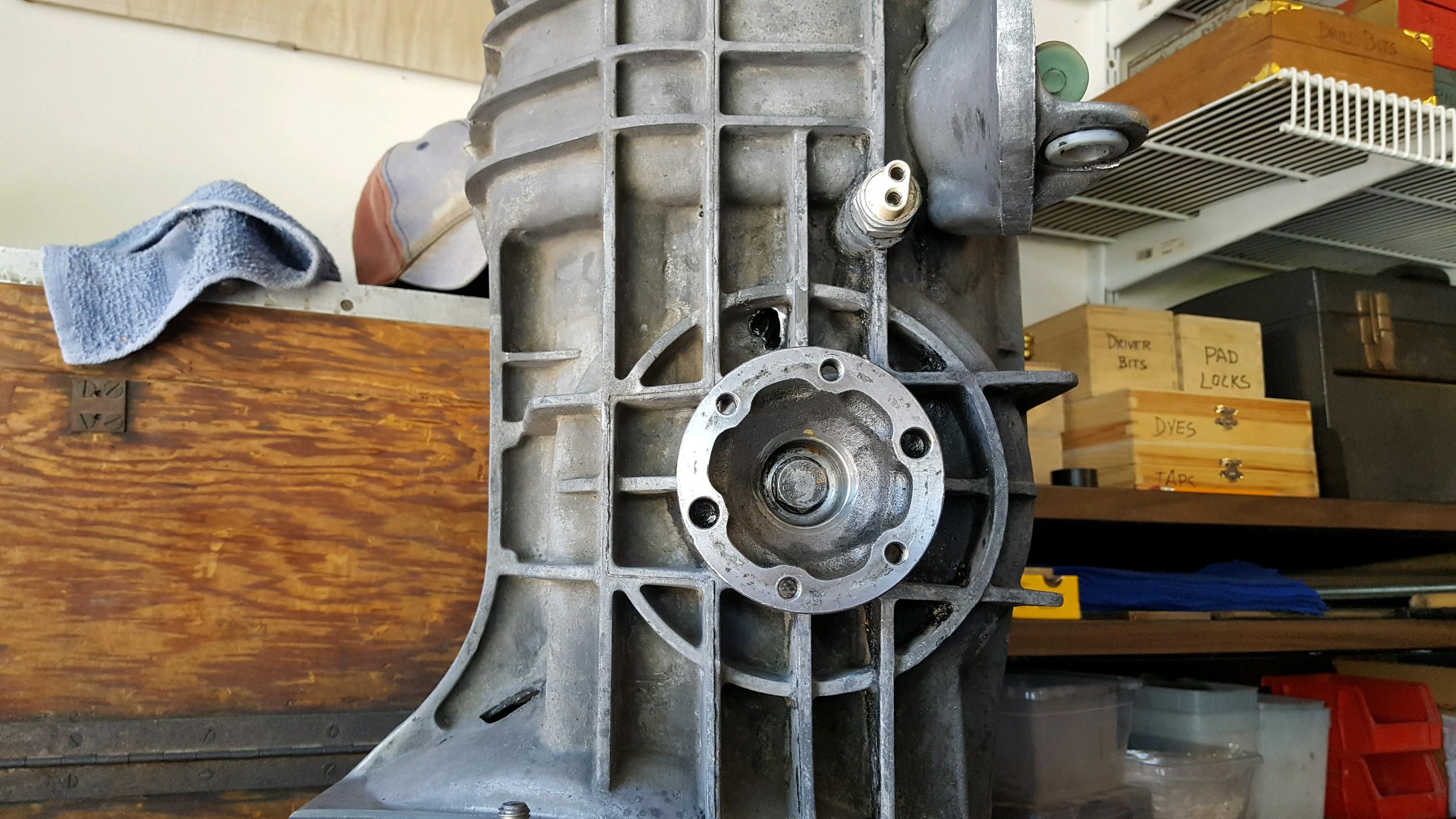

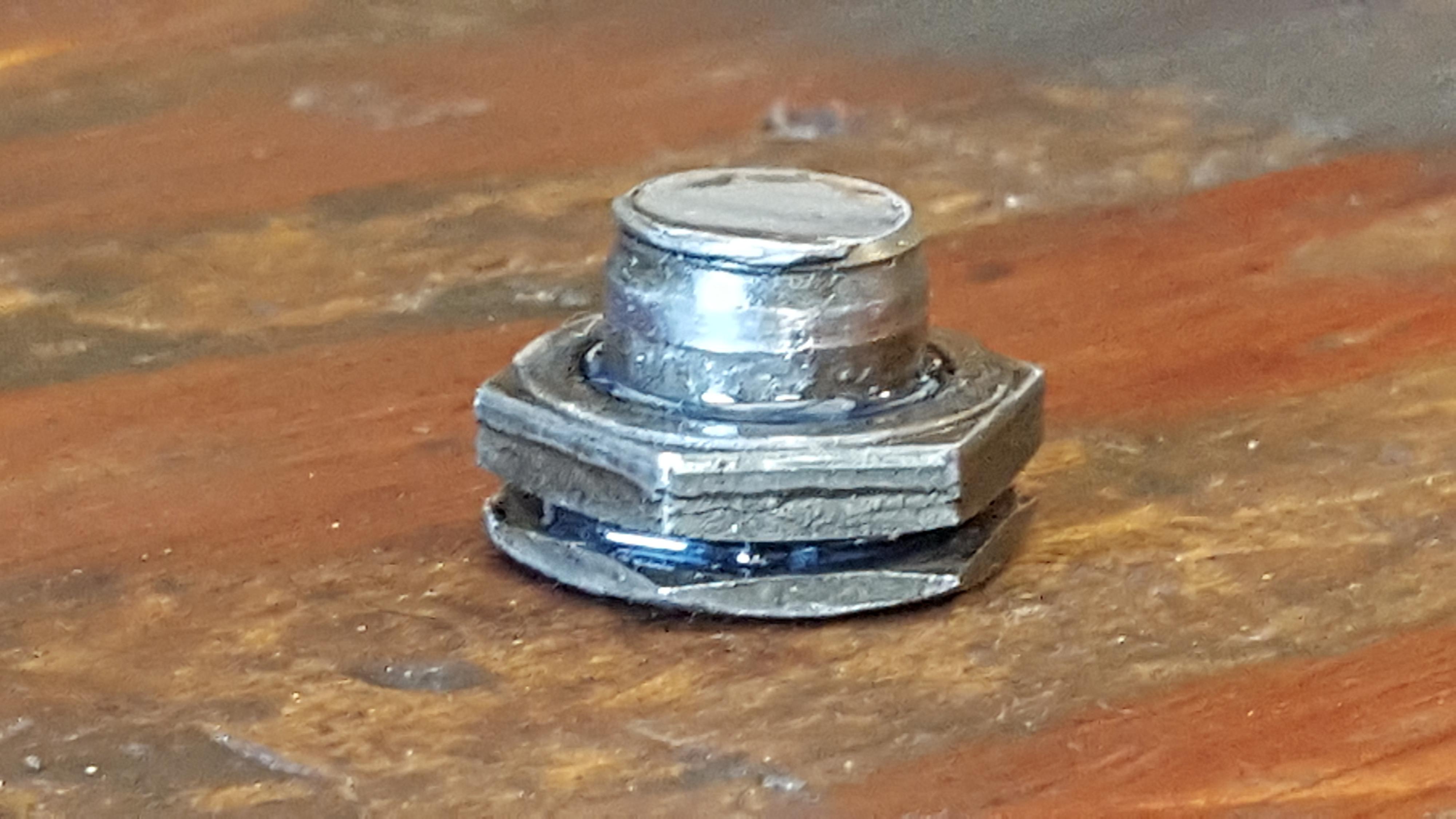

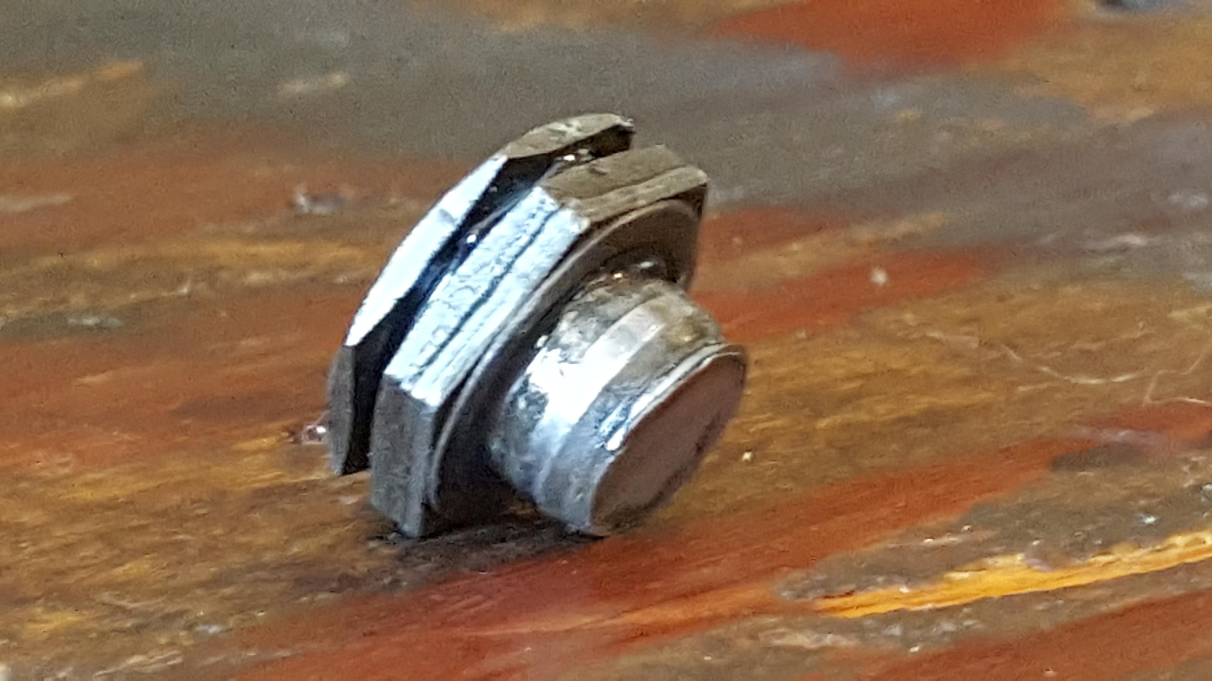

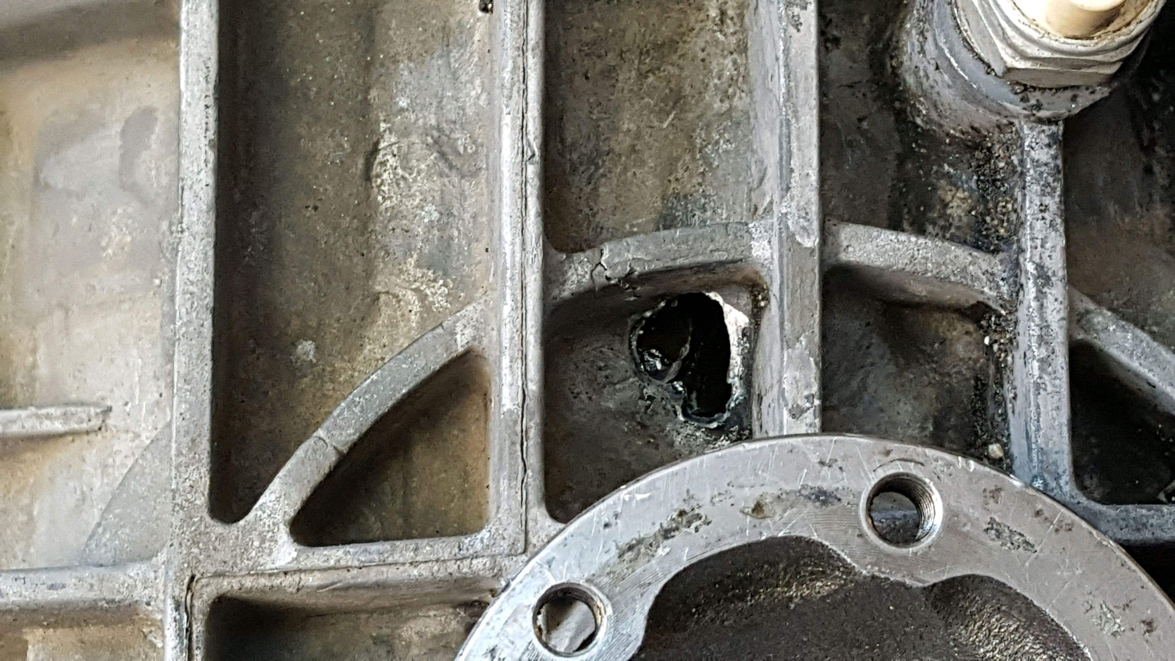

So I now know what killed my gearbox. One of the ring gear bolts failed. It took out my case. (IMG:style_emoticons/default/hissyfit.gif) It looks as though I can still use the gear stacks as nothing is wrong with them (wear is the unknown variable, although I have kept up on oil changes and clutch adjustments). The ring and pinion gears have all their teeth and look OK but further inspection is still needed. Check out the pictures below.

Yup. (IMG:style_emoticons/default/hissyfit.gif)
Some parts in there then they might be worth harvesting, so I wouldn't toss it, but regardless a whole new transmission is the easiest way to salvation. (IMG:style_emoticons/default/sad.gif)

Wow. Ya, that’s bad. A rebuilt core is your best bet now. Glad wasn’t worse.
