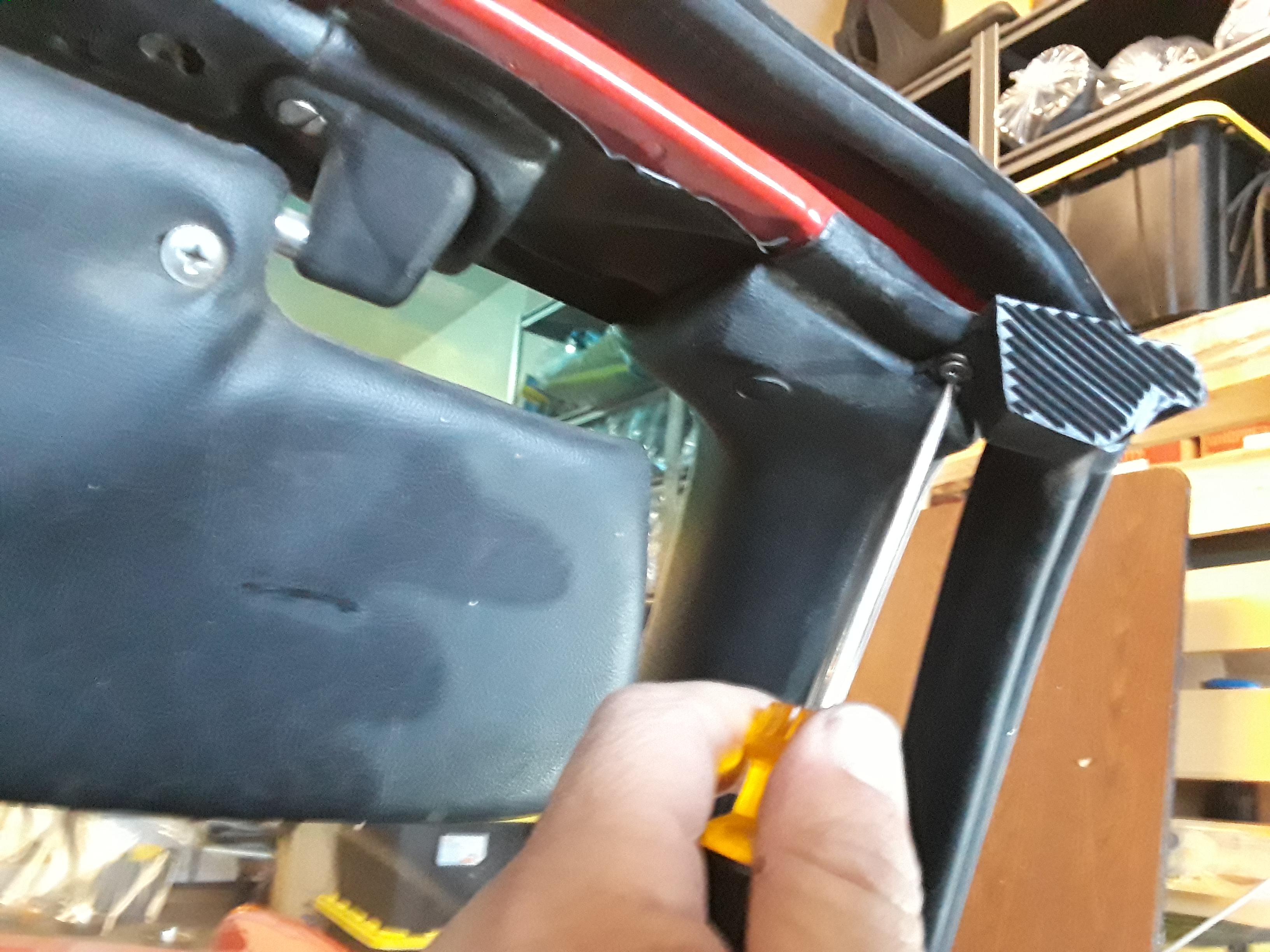

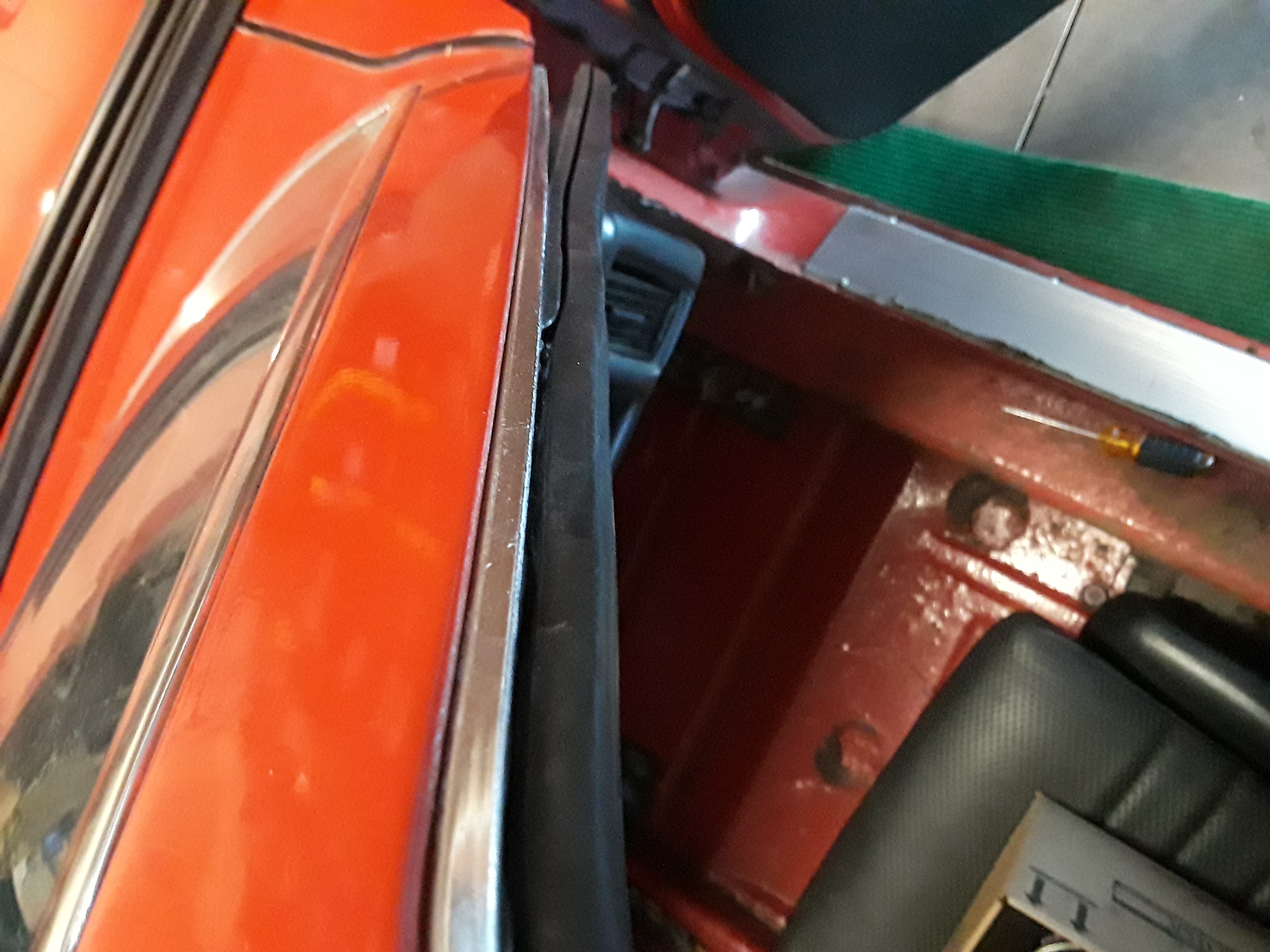

Heres some pics from my install.
The rubber will not slide down the tracks , at least not without great effort. The set tge inside edhe and push in the outside is the technique you want.

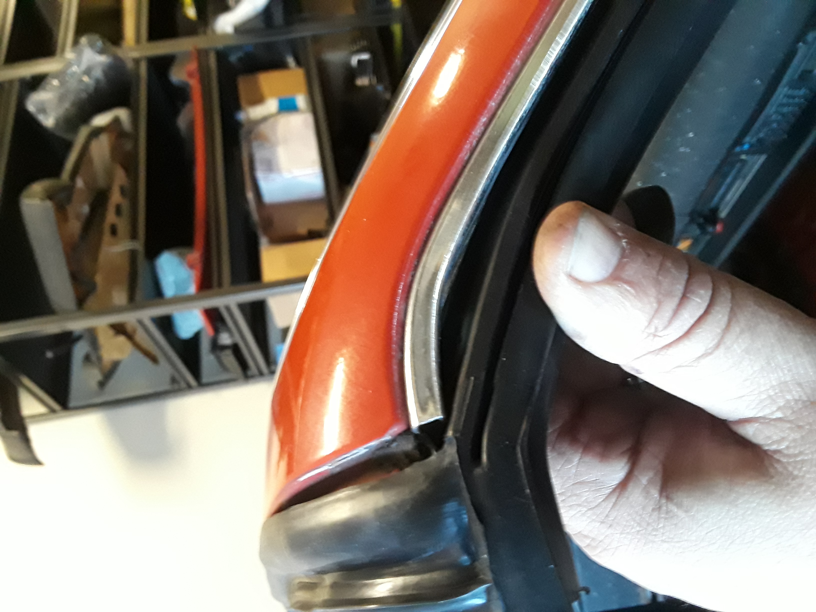

Stary the inside edge
Mikey914
post Apr 25 2018, 11:49 AM
Post #43
The rubber man
Posts: 12,772
Joined: 27-December 04
From: Hillsboro, OR
Member No.: 3,348
Push in the edhe all the way down
