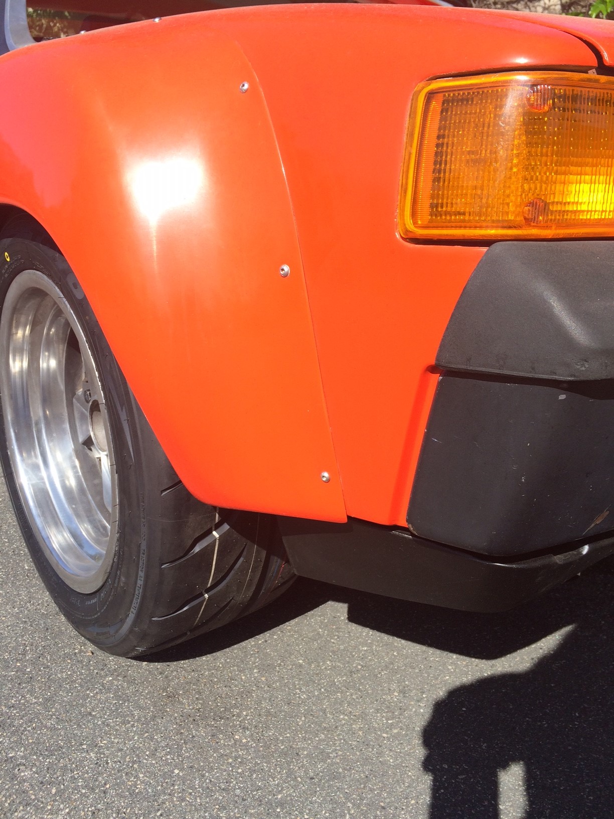

Yes on the toyo proxes r888r. They have 205 x 15 which will fit narrow body on 6 or 7 inch wheels usually. It's a great looking tire! Also check the Falken Azenis in 205x/50x15. I think Americas Tire can get them. We used the Azenis on our green 914 for autocross. Nice sticky summer tire! Toyo Proxes 225 shown on 15x8 with flaresAttached Image

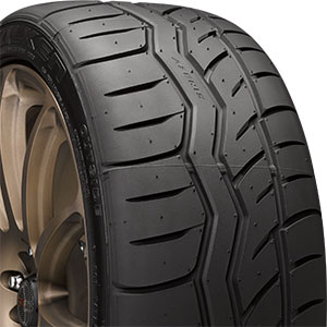

Yes, Americas tire has the Azenis 205x50x15 that will fit on your 7 inch wheels and is the tire we run on our green 75 914. $107 per tire, order and they get within a day or two.
https://www.americastire.com/buy-tires/falk...615k%2b/p/34274
