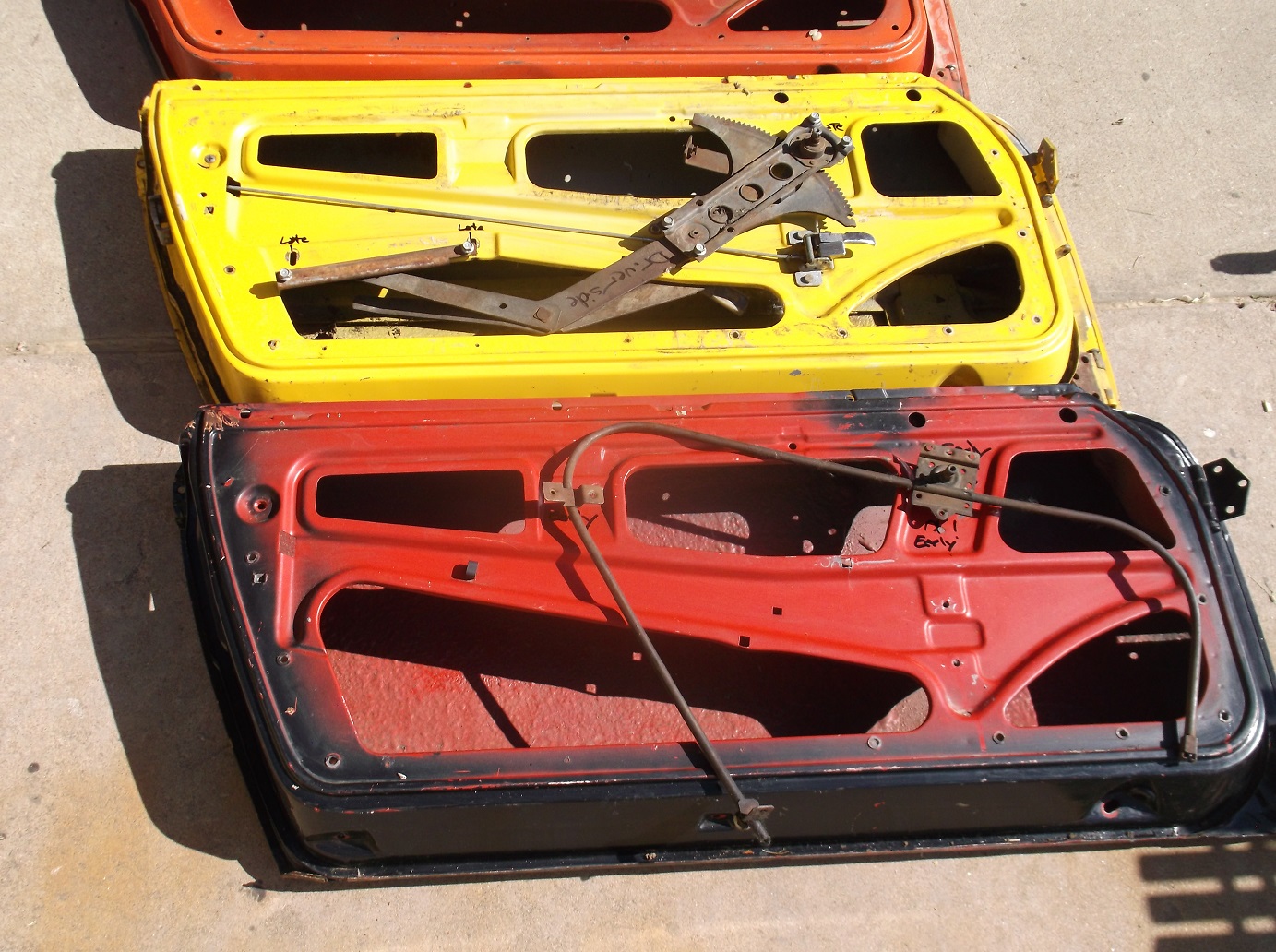

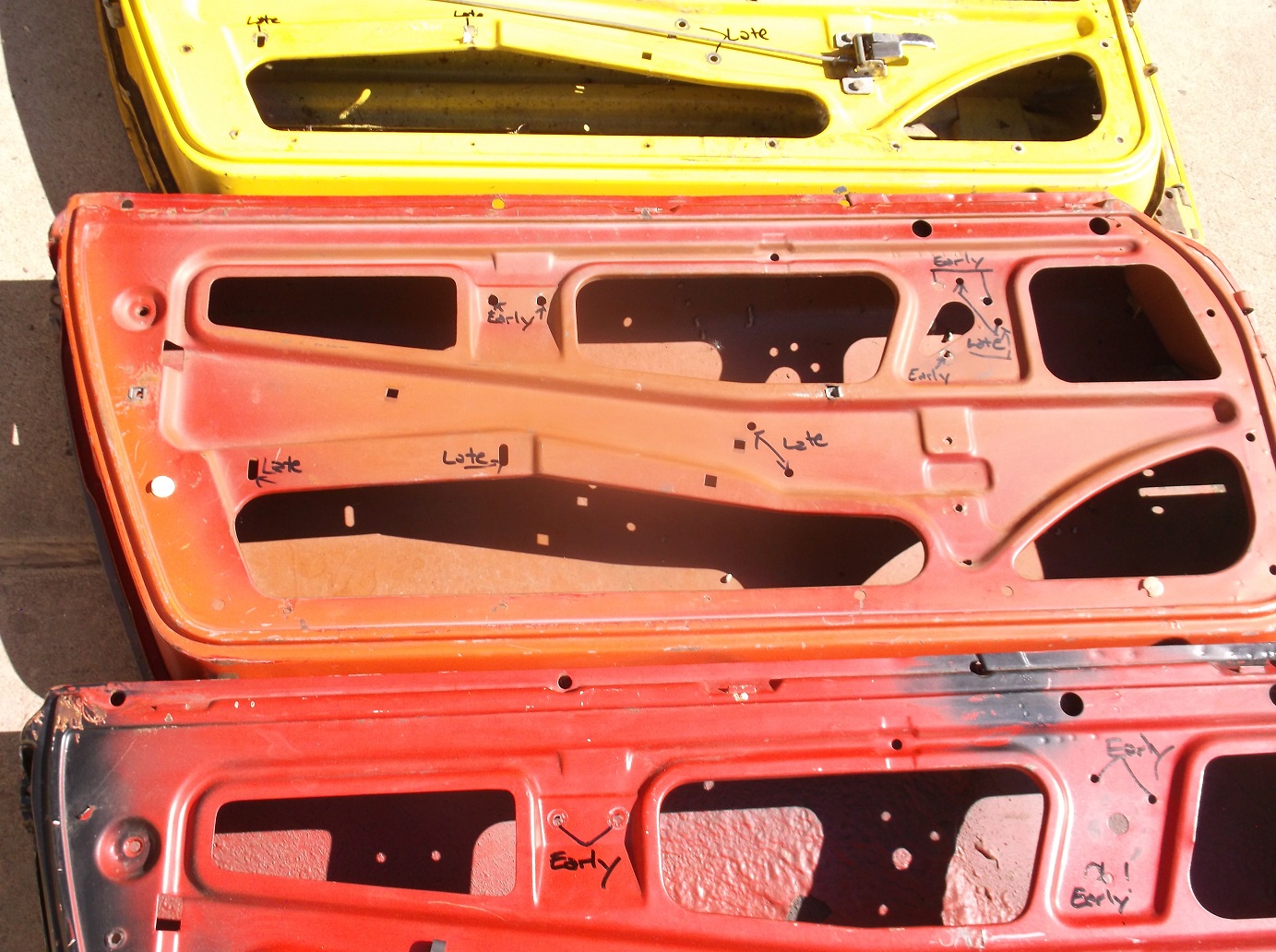

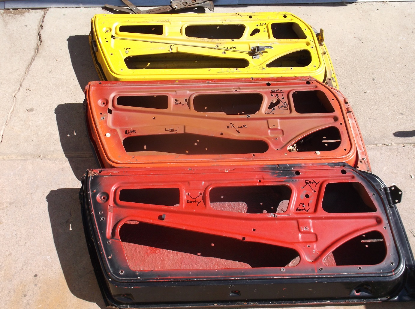

Wow!
I was going to send some pics of different regulators when I discovered something off.
Let's see how many knew about this finding (IMG:style_emoticons/default/biggrin.gif)
majkos1
post Jun 5 2018, 09:27 AM
Post #32
Posts: 265
Joined: 11-August 17
From: Mile High 914
Member No.: 21,338
Late regulator on top,
Early regulator below.
majkos1
post Jun 5 2018, 09:28 AM
Post #33
Posts: 265
From: Mile High 914
Member No.: 21,338
Closer view.
