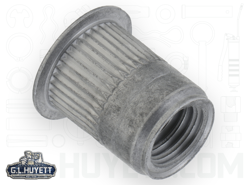

QUOTE(Porschef @ Jun 1 2018, 08:48 PM) *
Yes, I did it, using a nutsert.
I can take pics in the morning, shoot me a pm to trigger my memory.. (IMG:style_emoticons/default/blink.gif)
Joe has the right idea.
Very handy tool but sort of spendy for a single use..... try to borrow one ?
$80 on Amazon

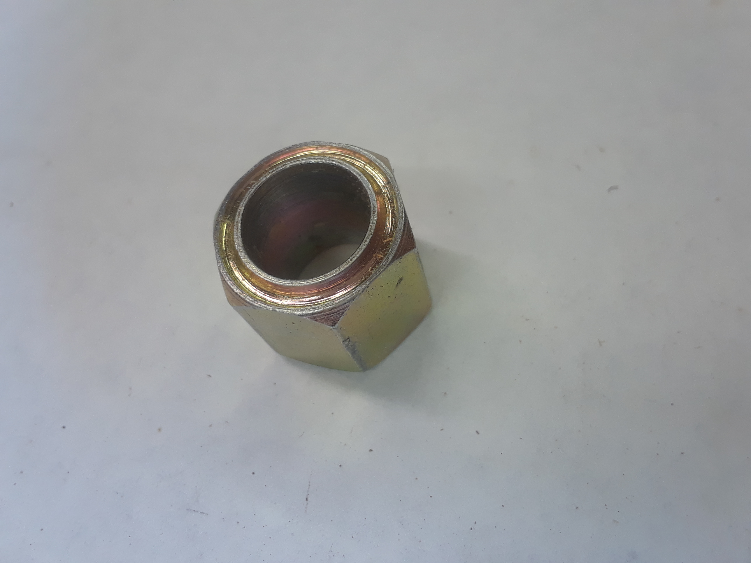

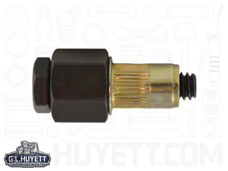

Ok, so I went back to review my post about backdating here
http://www.914world.com/bbs2/index.php?sho...+long+BUB's
and found that I had already installed the fogs and horns prior to the final installation of bumpers. Couldn't remember what I did, heck, I can barely remember what I had for dinner last night; wait, it was fluke fillet with a white wine/caper sauce, mmmmmmm, delicious, but alas, I digress. Anyway, thanks to the search feature here, there is a flat area below where the light goes that I drilled in the center. It must've worked out well 'cause the lights pretty much were centered when I installed the bumper assembly.
You don't need a fancy tool to install the Nutsert, there's one that looks like a bolt with a nut that gets tightened after the Sert is placed into the hole, effectively mushrooming out the back and locking the Sert into position.
Now to go out to the complete Hell Hole that is my garage and see if I can find it.
Stay tuned...
Porschef
post Jun 2 2018, 08:03 AM
How you doin'
Posts: 2,180
Joined: 7-September 10
From: LawnGuyland
Member No.: 12,152
Ok, so I found it. Will wonders ever cease...
It's placed between the Sert and the bolt, the side with the groove up against the Sert, the Sert goes in the hole, the bolt is tightened and this is held in place with another wrench to keep it and the Sert from spinning. Then the Sert mushrooms up against the back of the hole. Once locked in place, the bolt is removed, the little tool is removed, and the bolt goes back into the Sert.
Be sure to drill the appropriate sized hole for the nutsert, it should be just tight enough that the Sert doesn't spin at all when placed in there and is actually subject to an interference fit. This is to ensure is that the tool will work properly, and once that Nutsert is locked into place, it's pretty permanent.
HTH,
Joe

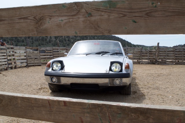

(IMG:http://www.914world.com/bbs2/uploads_offsite/farm1.staticflickr.com-20876-1527952799.1.jpg)
(IMG:http://www.914world.com/bbs2/uploads_offsite/farm2.staticflickr.com-20876-1527952799.2.jpg)

I used the same tool and did rivnuts on mine also. I’ve used rivnuts for lots of stuff on my 914.

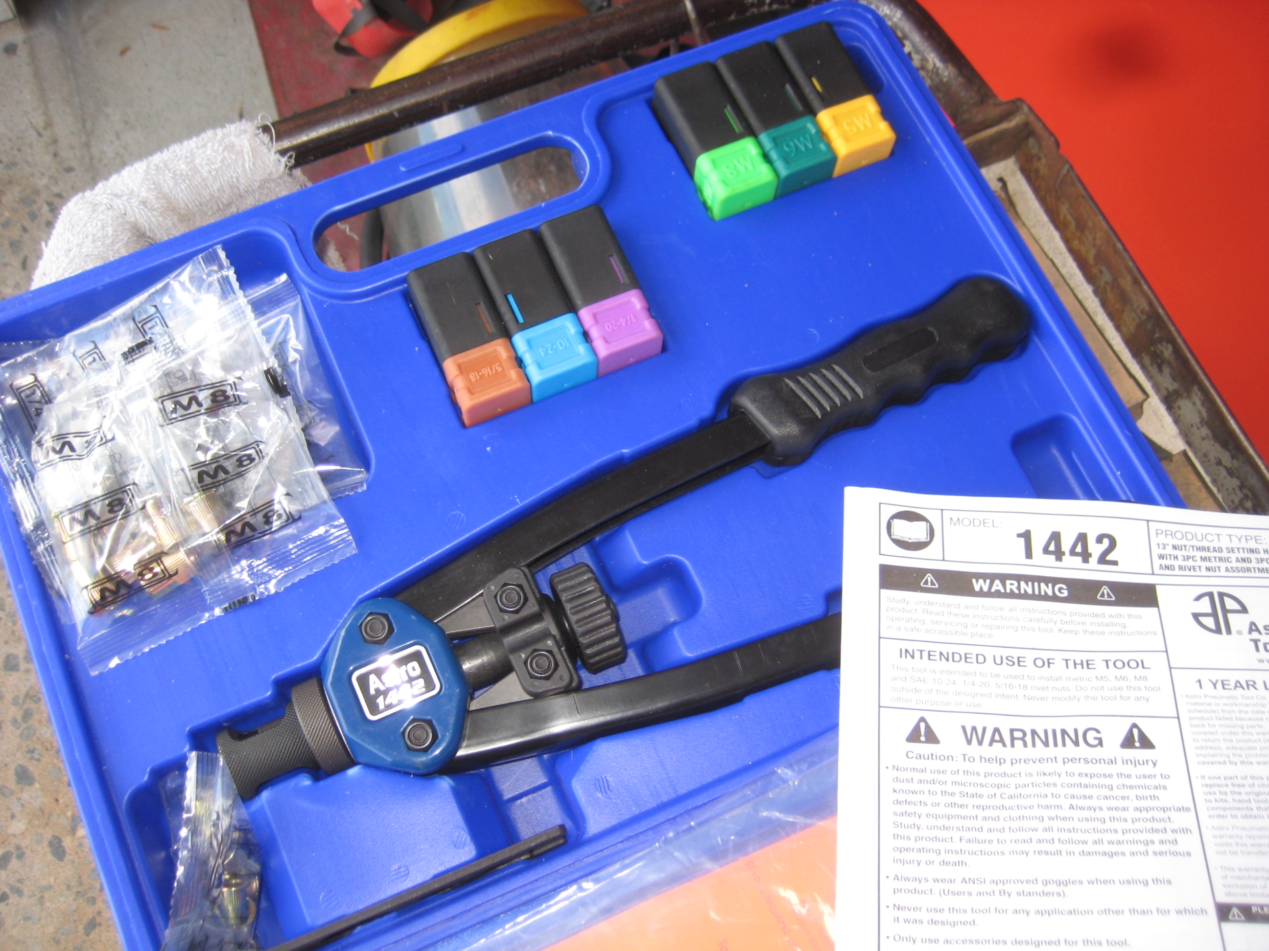

These guys have the tool and the rivnuts...
Rivnut Tool
(IMG:http://www.914world.com/bbs2/uploads_offsite/glhblob1.blob.core.windows.net-20876-1527967194.1.jpg)
Rivnuts
(IMG:http://www.914world.com/bbs2/uploads_offsite/glhblob1.blob.core.windows.net-20876-1527967196.2.jpg)
The tool is only $7.15 and the rivnuts are about $1 each. I ordered 4 each of steel and aluminum. I'm going to practice a little first. I'd prefer to use the steel if the test with them on a piece of scrap goes OK.
