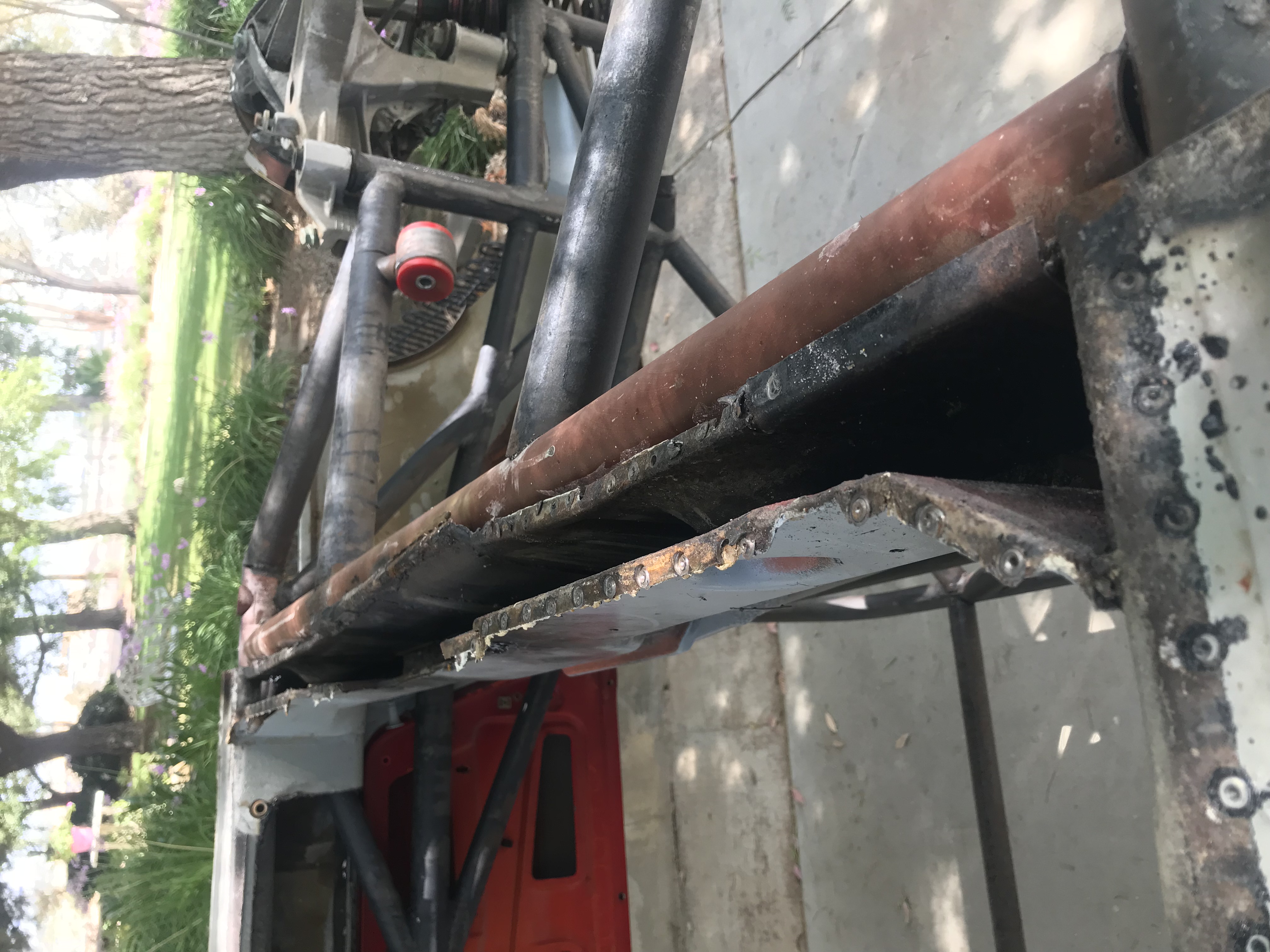

While you are in the mood shoot some of that coating in the hollow of the firewall where it meets the floor. This is what it looks like with the floor removed
