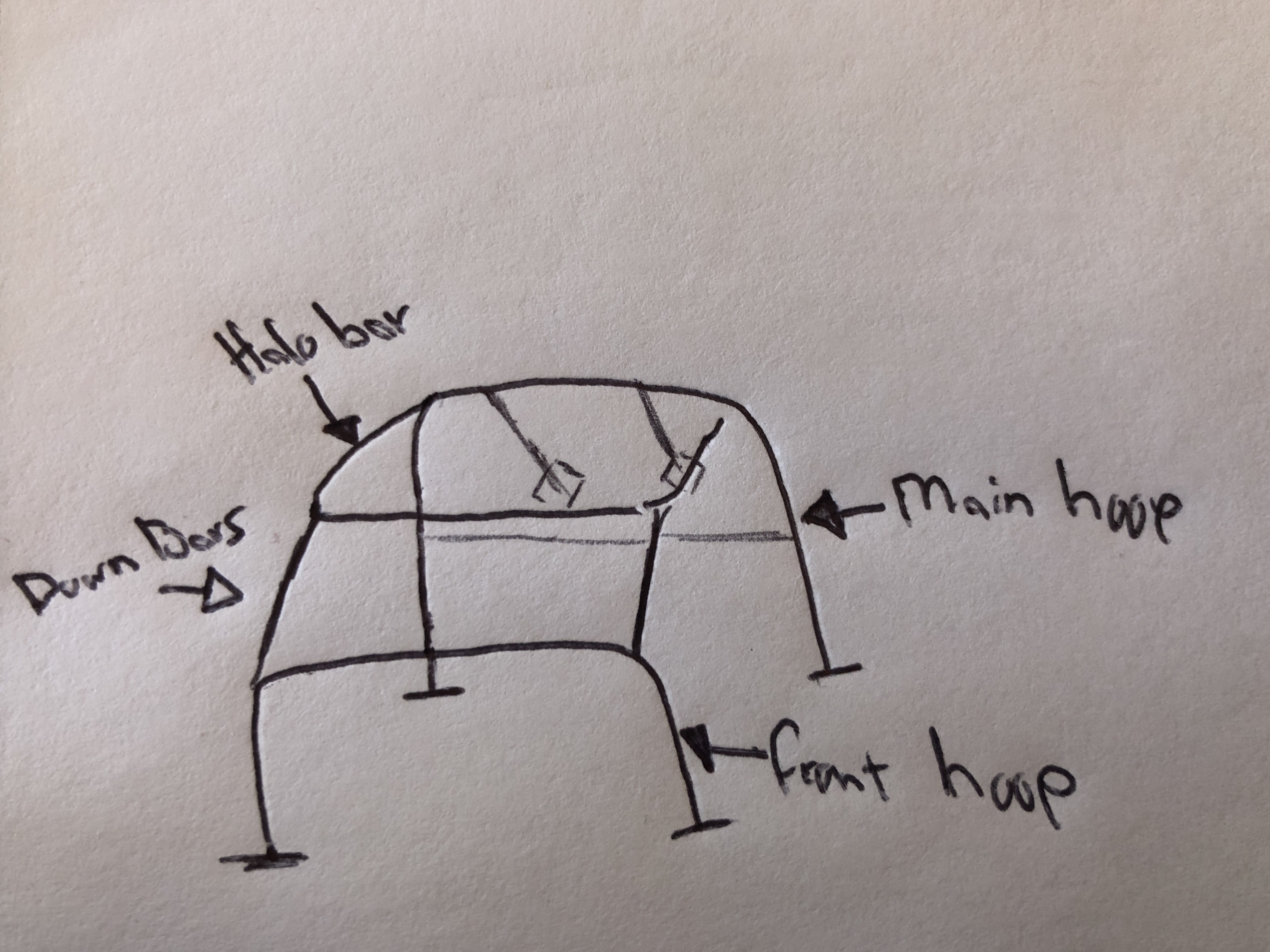

is a front hoop with down bars like such illegal to use in scca or any other forms of racing? And do they have inherent structural flaws compared to a down bar that goes from the halo bar to the floor?

This is ignoring door bars and diagonal bracing*

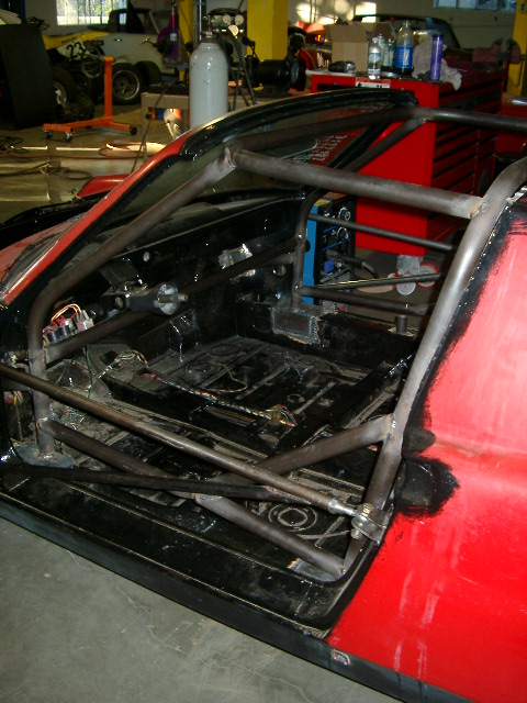

Kinda hard to see (also, ignore the temp door braces) but this cage was legal with SCCA at the time of install some 15 years ago.
It has a front cross tube that was added high enough so it is now hidden behind the dash/kneepad ...
(IMG:http://www.914world.com/bbs2/uploads/post-179-1305597048.jpg)

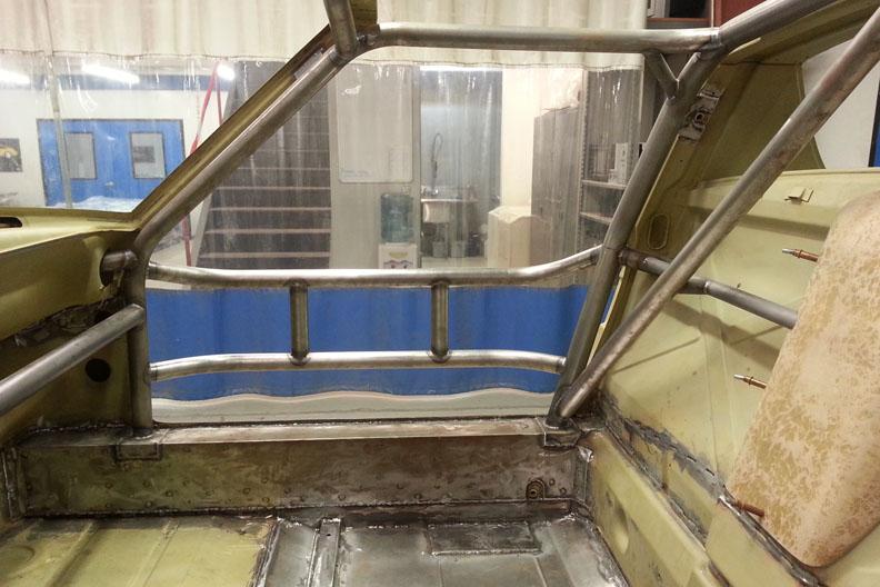

Your best bet is to run a single bar from the main B pillar hoop to the front A pillar.
(IMG:http://www.914world.com/bbs2/uploads_offsite/patrickms.s3.amazonaws.com-172-1536350559.1.jpg)

I would agree but it isn’t for my 914...... this time. It’s actually for my non 914 race car im building, I thought id just ask you guys if the front hoop was actually allowed or dangerous. As it turns out its not allowed and the jury it still out to whether it’s dangerous or not.
