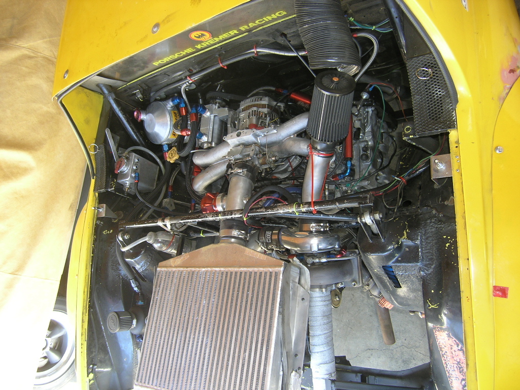

I am parting out my 914. The cage was built to FIA specs. by Matter in Germany. Side bars were added to meet SCCA requirements. The rear braces go through the rear window and attach to the shock towers.Attached Image

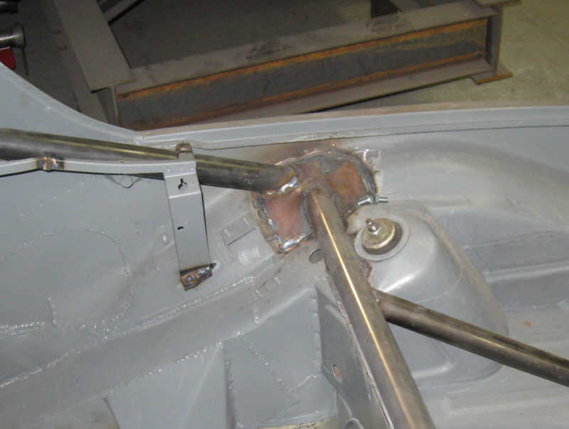

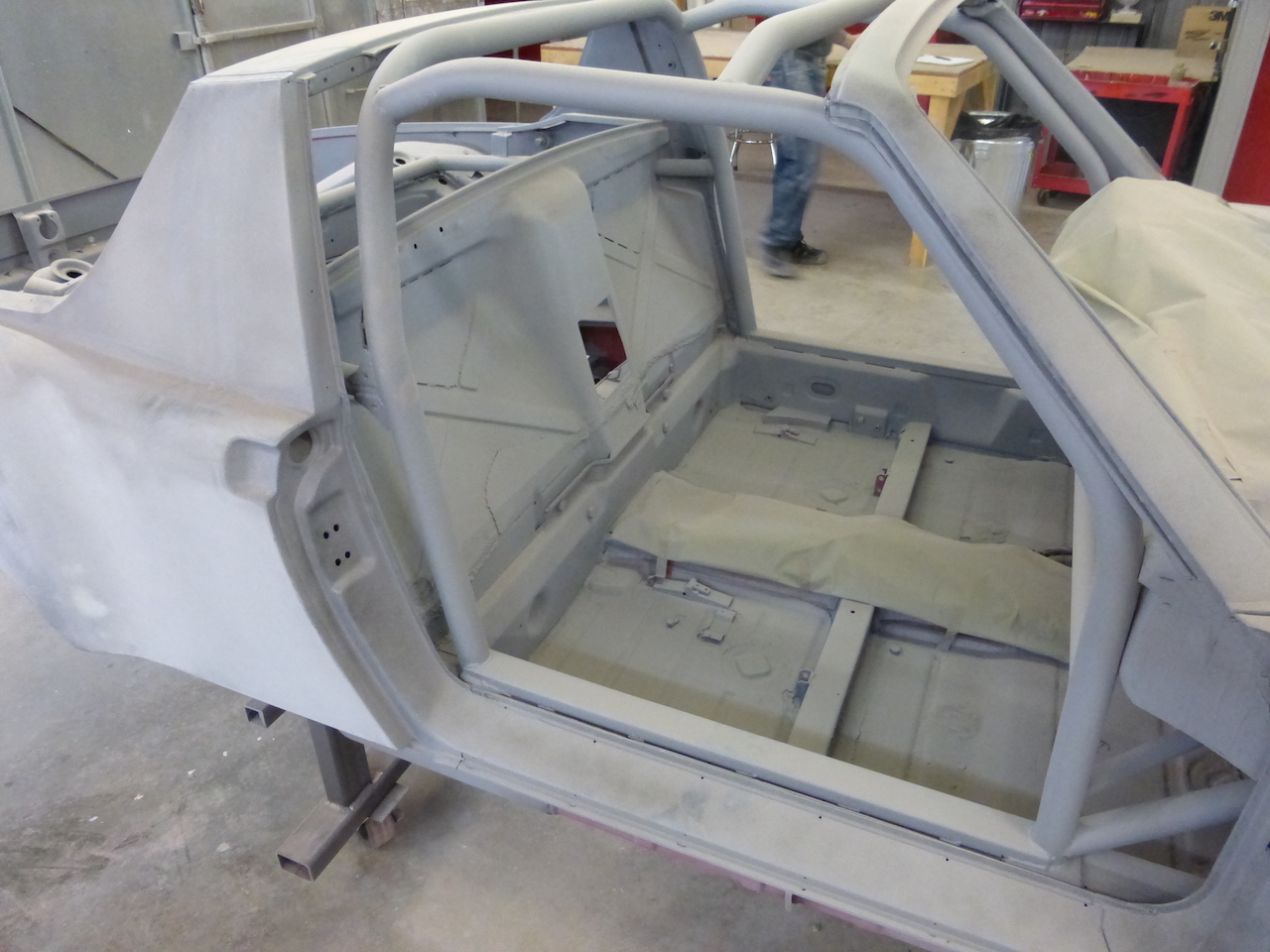

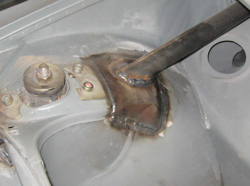

Here's mine Bob. Best, MarkAttached Image Attached Image

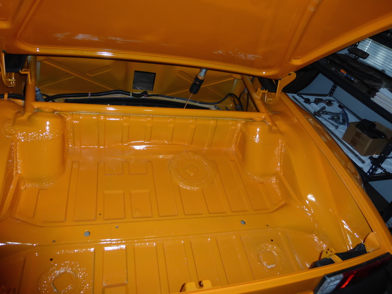

One more shot of the passenger compartment before painting.Attached Image

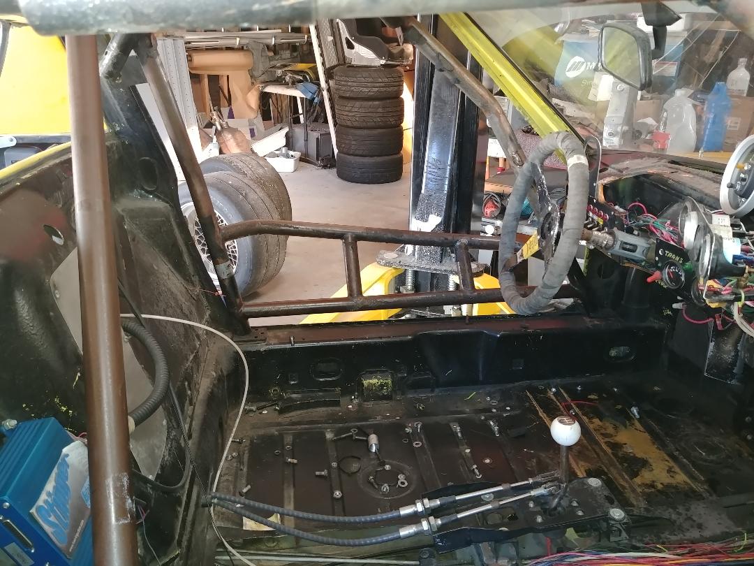

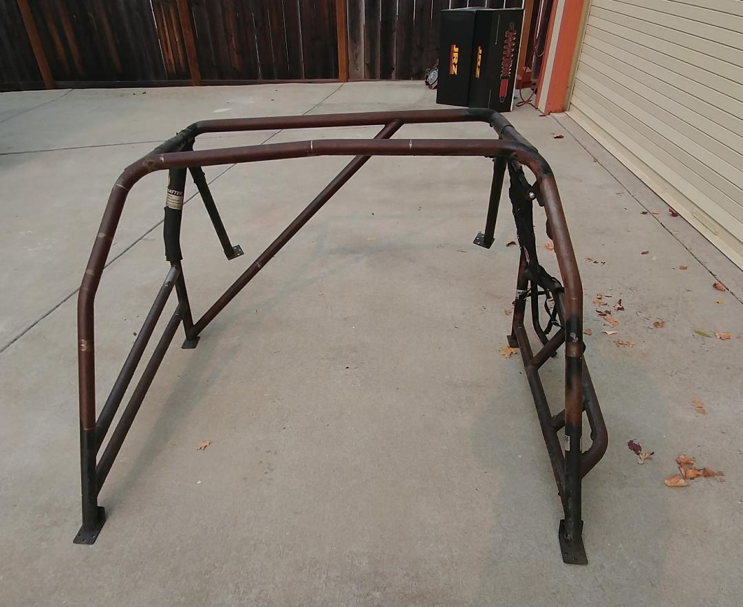

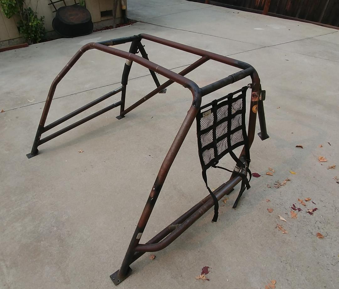

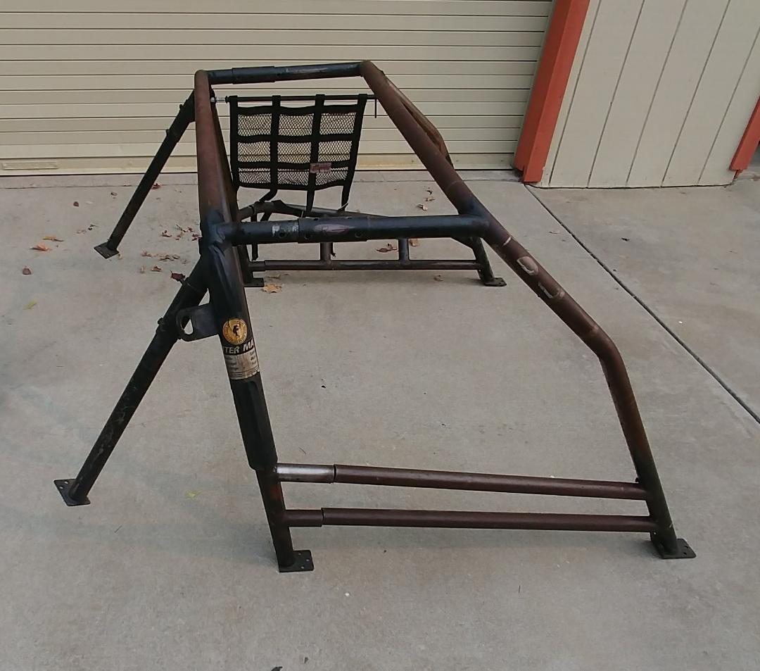

This cage is legal for SCCA. Just removed it from the car. It was originally made Germany for FIA regulations.
Attached ImageAttached ImageAttached Image[attachmentid=677

QUOTE(Heater Guy @ Dec 4 2018, 09:41 PM) *
523]
sooo....about that cable shifter...what engine/trans you got in there???

ChrisFoley
post Dec 5 2018, 06:12 AM
I am Tangerine Racing
Posts: 8,019
Joined: 29-January 03
From: Bolton, CT
Member No.: 209
Without a full width main hoop crossbar that cage is not legal for SCCA Club Racing.

ChrisFoley
post Dec 5 2018, 07:35 AM
Posts: 8,019
From: Bolton, CT
Member No.: 209
QUOTE(naro914 @ Dec 5 2018, 08:31 AM) *
That’s what my cage crossbar is like and it’s legal
The diagonal is fine, but without a horizontal crossbar it is not approved for wheel to wheel racing.
