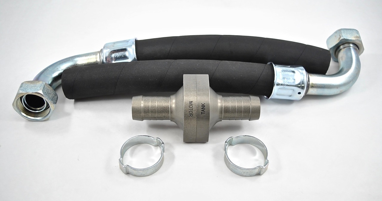

Forest's issue is pretty common. the one way valve will fix it with no downside.
Rothsport Oil Inlet Check Valves
http://www.rothsport.com/Products/Engine/O...heck-Valves.htm

Have the Rothsport version in my 911 and it has cut down initial smoke at startup by 50%. The plugs also don’t oil foul either.

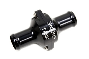

Rothsport version. Less money, but doesn’t come with the lines.
