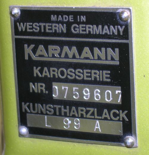

Not sure about the exact shade. I know there are paint codes. On my 944 it's on the tag in the hatch. Are the 914 color codes located on the driver's side door vin area?

The 914 has a riveted-on plate on the front of the driver's door jamb that is often called the "Karmann plate". There's a spot for the paint code on that, it will usually be something like "L 56 M".
Here is one example, courtesy of Jeff Bowlsby's amazing "Classic" resource page.
(IMG:http://www.914world.com/bbs2/uploads_offsite/bowlsby.net-121-1542917839.1.jpg)
You can Google the paint code or ask here to find out the name of the original color.

Thanks for the info. I know exactly what plate you are talking about. Color code is L13K, Sunflower Yellow.
