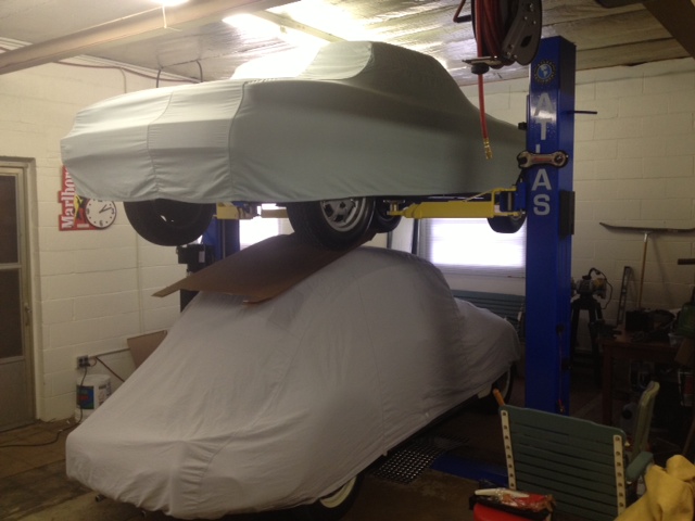

Unless you don't have the ceiling height (min 10 feet) don't buy the MaxxJax. For a little more money you can't get this:
https://www.gregsmithequipment.com/Atlas-BP8000
I've had mine for 5 years and it works great. It's the real deal in terms of quality and safety.Attached Image
Took 2 1/2 hours to install myself with a couple of friends. I only had to hire an electrician to wire in 220.
Dave

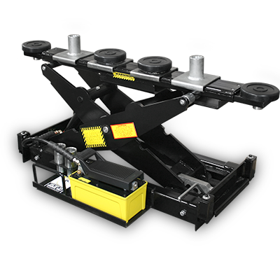

Bendpak HD9 (standard width) has a move-able side that you can widen to juuuuust fit the /4 engine bar between the rails. I just ordered 2 bridge jacks so I can easily do suspension/wheel/brake work.
Should be fun, and as anyone on here knows, mine is 99% used as a storage lift...but now can be a full service lift too

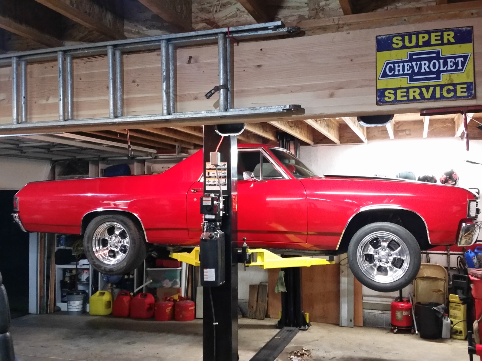

I really like my 2 post. Even with a 9’ ceiling, I can roll around on chairs and easily do everything I need.

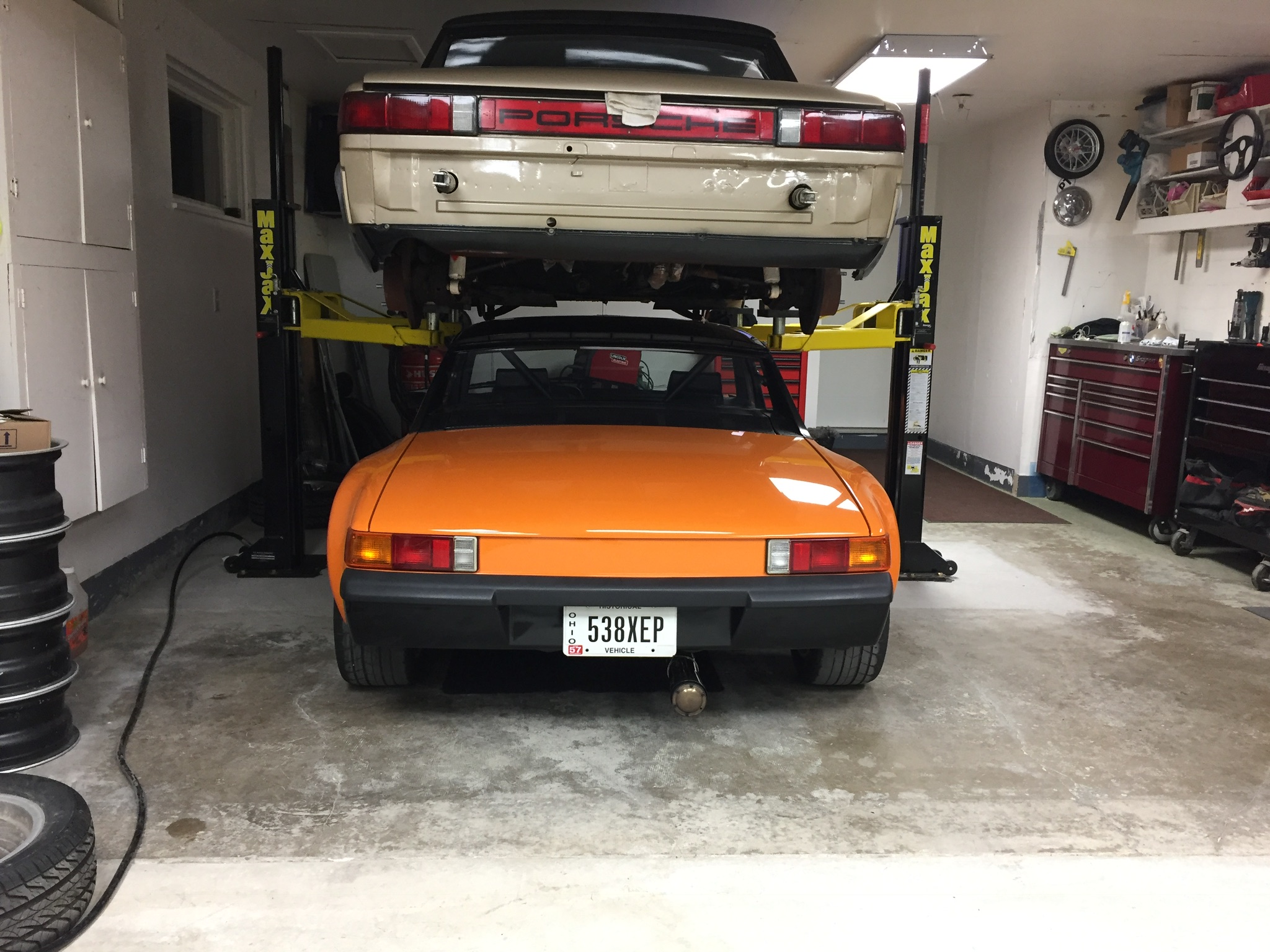

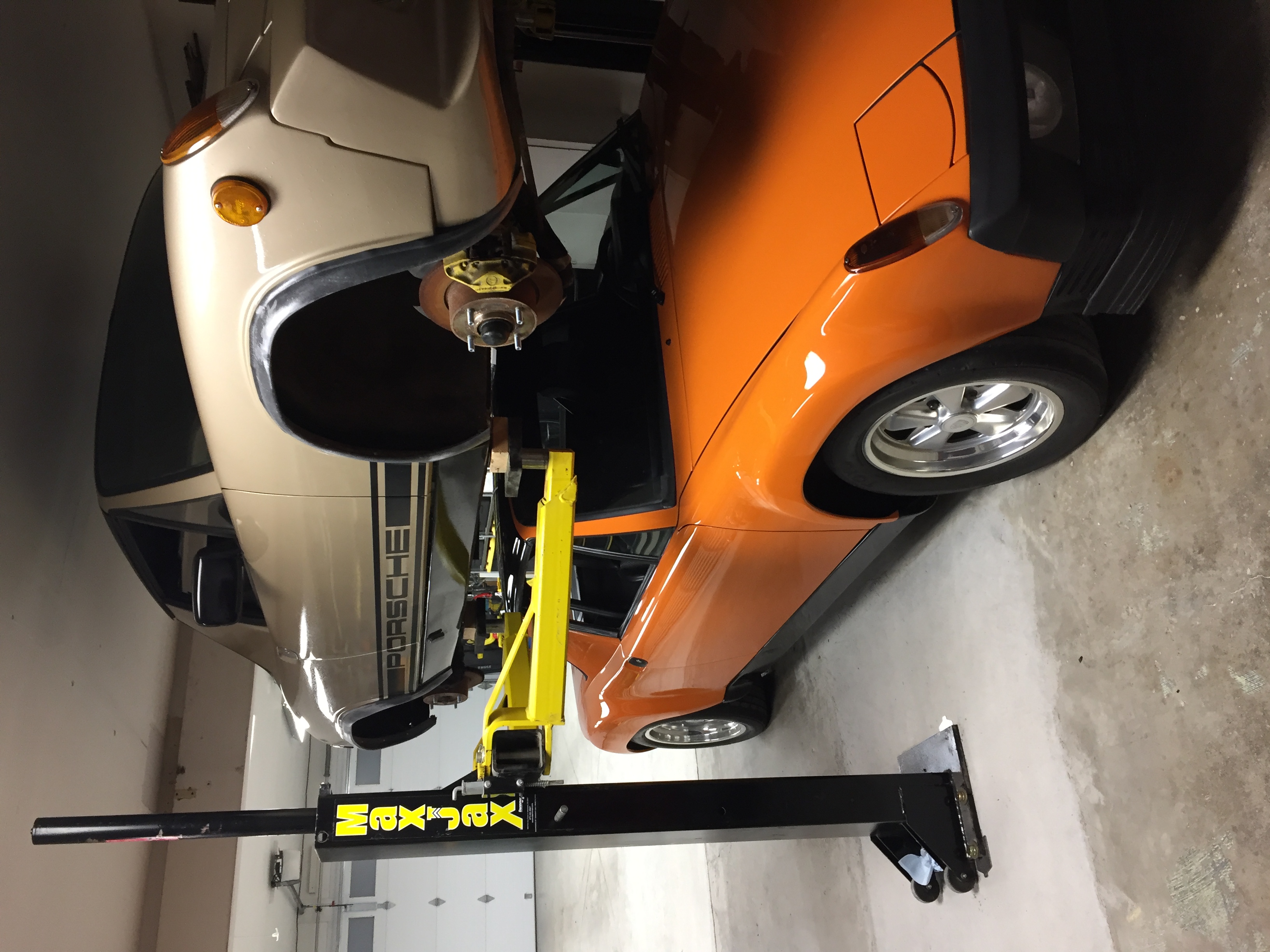

The MaxJax is definitely a good option with low ceiling height. Two post lift gives easy access for engine removal.I’m able to fit two teeners when needed for storage. Attached Image Attached Image

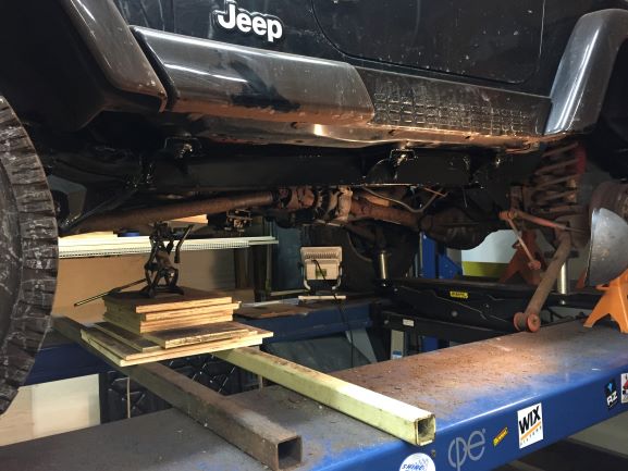

i have a HD 9XW Bendpax lift with a sliding scissor lift. It makes it real easy to lift either end of the car to work on it. The span between the rails is 37.5". When i dropped the 4cyl motor I had to remove the engine support bar to drop the motor. I have not attempted lifting the 6cyl into the car so i don't know if there is clearance for it.
You can just see the scissor lift in the photo of the Jeep. We were welding in new frame rails on the Jeep as the drivers side trailing arm had torn free due to rust.

FYI: on the HD-9 the rails widen:
Width Between Runways: 37.5" (953 mm) or 44.375" (1,127 mm)
