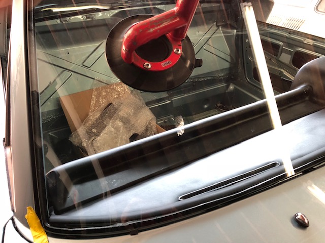

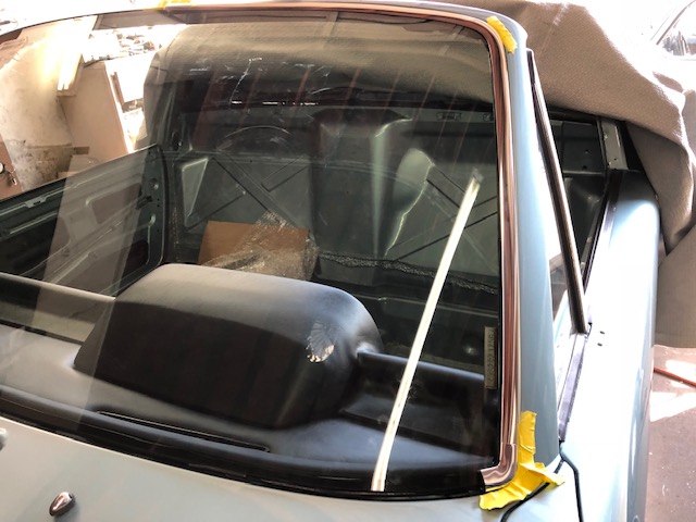

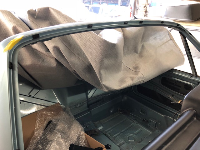

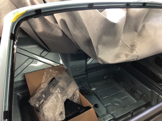

Used the clips that come with The Genuine Porsche OEM trim kit From Sierra Madre and important to note that they do not break as easily as the aftermarket ones. Drawback is that they were one clip short in the package. Luckily our 914World Designated Windshield Installer had a spare.
Once clips were in, a Butyl Primer was used as recommended in the below thread.
http://914world.com/bbs2/index.php?showtopic=312146
Windshield was warmed up in the sun prior to install.
5/16 Butyl Primer is used and the glass positioned and seated.
Snap in the trim clips and you're good to go.
The windshield I am using is a Sekurit from Finland and it seems to not sit 100% flush in some areas. As a result, it takes some finessing to make sure there is enough clearance for the trim to notch comfortably into the clips.
The takeaway here is to use a professional installer if you do not have the suction tool or have not done a windshield install before!

Don't see bottom windshield spacer ?

There were several of them used that came in the kit. Guess I missed that part....

The trim can be put on at later stage, if you wish to do that. Just make sure the clips are in place “before” installing the glass. I bought clips from 914Rubber. Then found out that they could break. 914Rubber send a bunch of spares. But in the end, I used originals from the Porsche dealer.

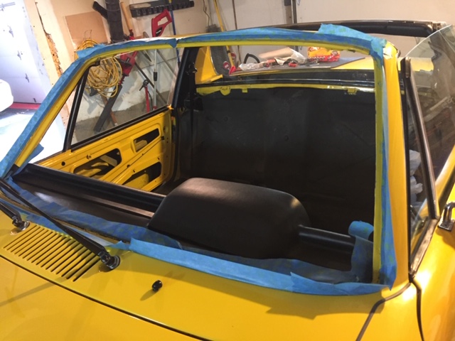

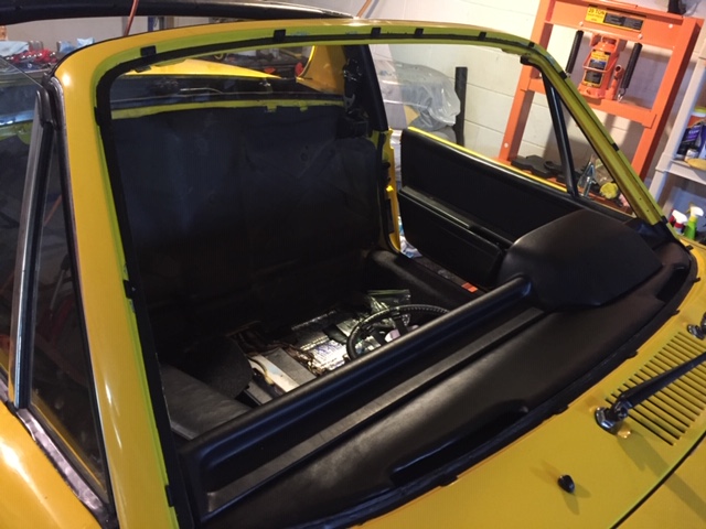

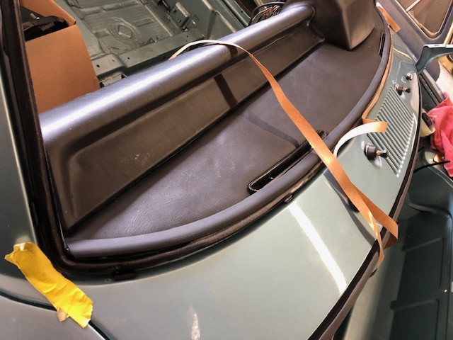

I removed and replaced the windshield on my '73. Pretty straightforward if you go sloooowly and carefully. Though the nice thing about hiring a pro is that it's on them if they break it;). If I lived in SoCal, I def would've done as @914_7T3 did. The hardest / scariest part is pressing the corners into the butyl, which is when the windshield seems most prone to cracking.

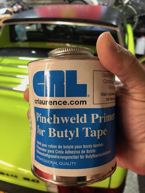

Here are a few pics. You can see where I put the butyl primer. I was much neater than I needed to be, since I'm totally OCD. In reality the butyl / glass / trim covers the whole channel. Also a pic of the primer I used. Put the butyl "seam" on the bottom and butted the ends.
One other tip which I'm pretty sure I read here on the world, though I can't seem to find the link... test fit the glass in-place before you put the butyl down using suction cups (cheeep at HF), the spacer blocks and a helper. Line it up/down/left/right so that it's sitting evenly in the channel and put a piece of blue painter's tape in the middle of each edge, straddling the glass and the frame (top, bottom, left, right). Use a sharpie to draw across the space between the glass and body and cut the tape in-place using a razor blade. The tape and sharpie marks allow you to line up the glass perfectly before you set it down. Once the glass touches the butyl, you can't move it much, so it's important to it place it exactly right before you commit.

On the CRL primer, the dabber is integrated into the cap...
