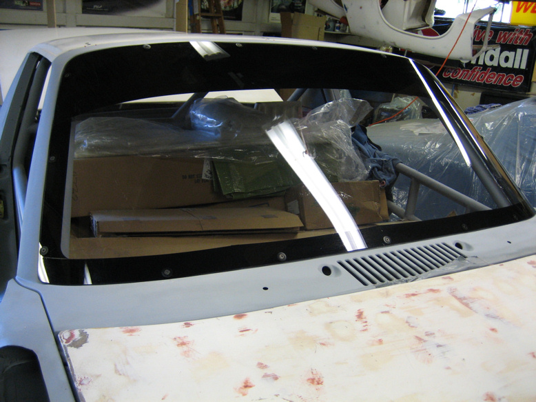

For my street/track project I purchased a Lexan windshield from Five Star Race Car Bodies:
http://www.fivestarbodies.com/store/index....duct&id=793
For the four side glass pieces, I got them from Plastics 4 Performance out of the UK:
https://www.plastics4performance.com/window...9&model=427
I bought the rear window from our friends at 914rubber:
https://900designs-container.zoeysite.com/9...ement-1970-1976
I was thinking of applying a windshield tearoff for some longevity.

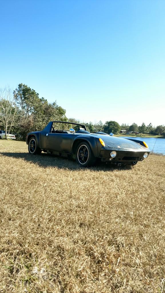

914 Ranch
post Jan 6 2019, 02:04 PM
Team Sharp where the 914 grow wings
Posts: 1,525
Joined: 29-January 16
From: TheNorth Shore Retreat. Deland
Member No.: 19,611
Or um, no glass. Probably not an option.
Hope this comes out ok.
1600 pounds...
Mikey914
post Jan 6 2019, 09:42 PM
The rubber man
Posts: 12,772
Joined: 27-December 04
From: Hillsboro, OR
Member No.: 3,348
QUOTE(914 Ranch @ Jan 6 2019, 12:04 PM) *
1600 pounds...
Well in that configuration you don’t have too many other options
cali914
post Jan 7 2019, 12:19 AM
cali914
Posts: 458
Joined: 26-April 06
From: Berkeley Ca.
Member No.: 5,934
QUOTE(mlmgm @ Jan 6 2019, 11:27 AM) *
Thanks that looks really good. What is the longevity you think?
