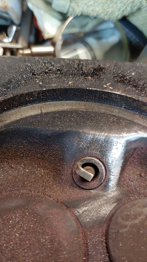

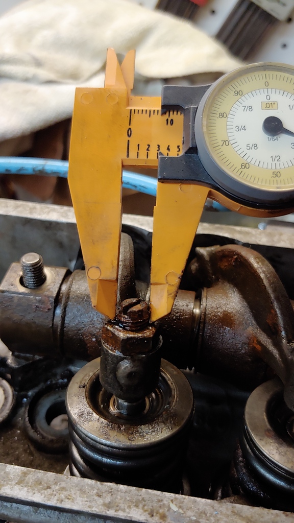

Got to look at the heads just a bit yesterday. Found out the adjuster screw on the rocker is 8MM and not the stock 10MM. Not really sure why though.
(IMG:http://www.914world.com/bbs2/uploads_offsite/i582.photobucket.com-21387-1548624974.1.jpg)

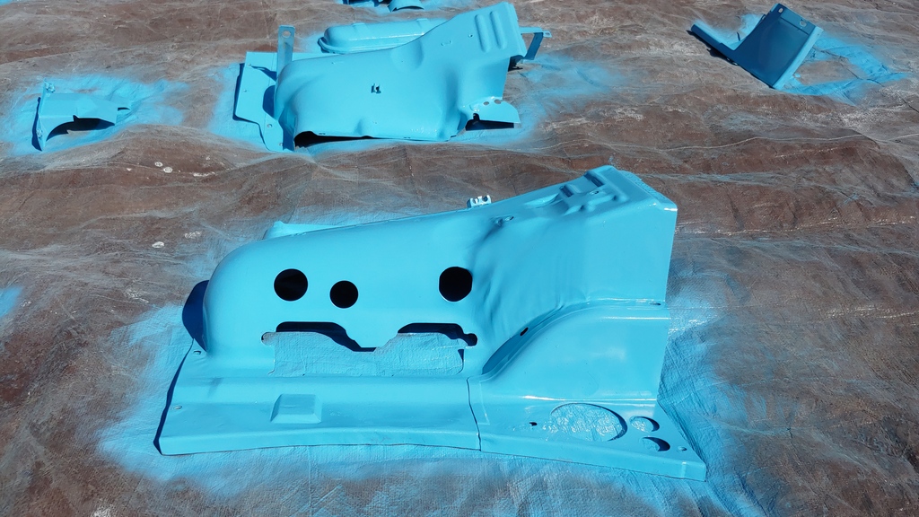

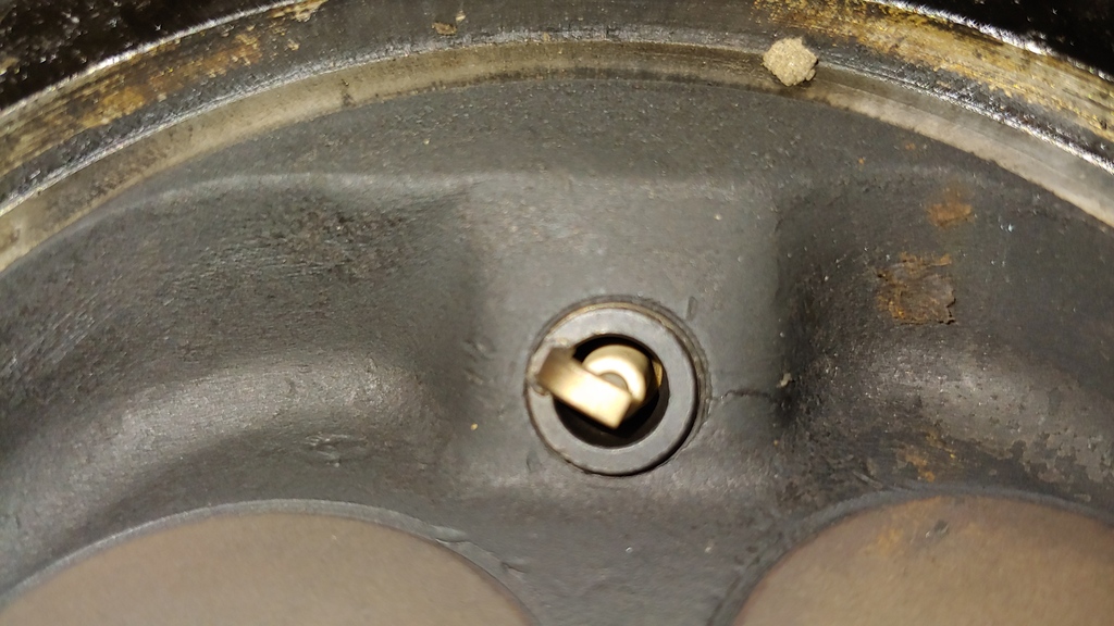

Also not sure if this is a issue or not. Really hoping not cause buying new heads was not in the budget. I'm going to contact a local shop tomorrow to see if they can inspect and rebuild if possible.
(IMG:http://www.914world.com/bbs2/uploads_offsite/i582.photobucket.com-21387-1548624974.2.jpg)
(IMG:http://www.914world.com/bbs2/uploads_offsite/i582.photobucket.com-21387-1548624975.3.jpg)

That crack needs some head welding.
Sorry for the bad news.

The heads are with Adrian at Headflow masters. He called saying they are repairable and will do a complete valve job including new stainless valves, springs, guides and seats. He said the SI valves he uses will work well with the stock adjuster screws. He suggested going with bigger valves, 44x38, since the car is running carbs so that will be getting done as well.

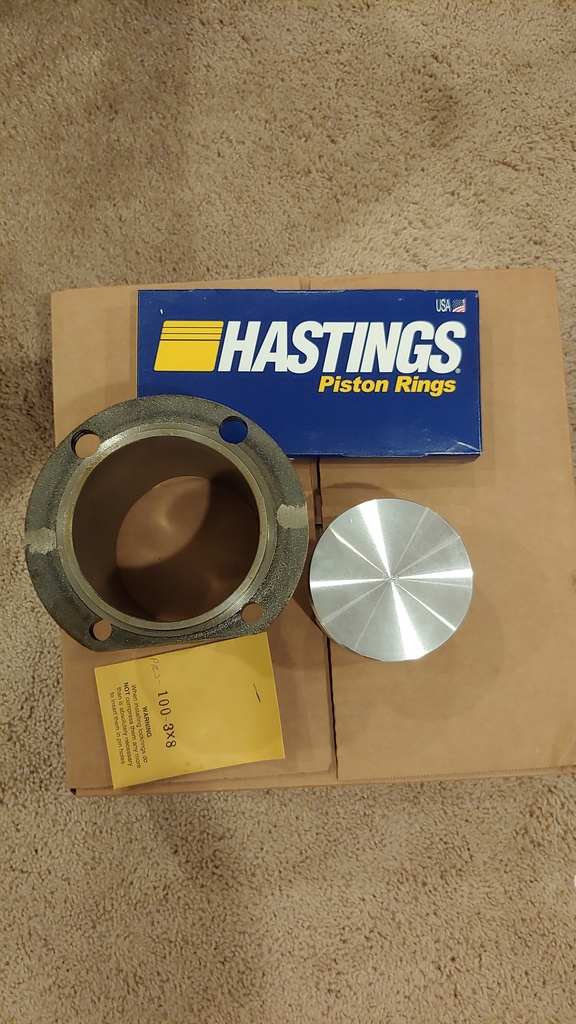

Just ordered 96mm Keith Black piston and cylinders from FAT Performance along with a new 86 grind cam, solid lifters and a new cam gear from Web Cam.
Will be ordering the rest of the stuff such as bearings, gaskets, seals, clutch, push rods, etc very soon. Hope to have all the parts arrive within a couple of weeks so I can start to rebuild. I did pick up the Tom Wilson rebuild book so hopefully it goes fairly smooth. I'll post pics of the new parts and progress as soon as I get them.

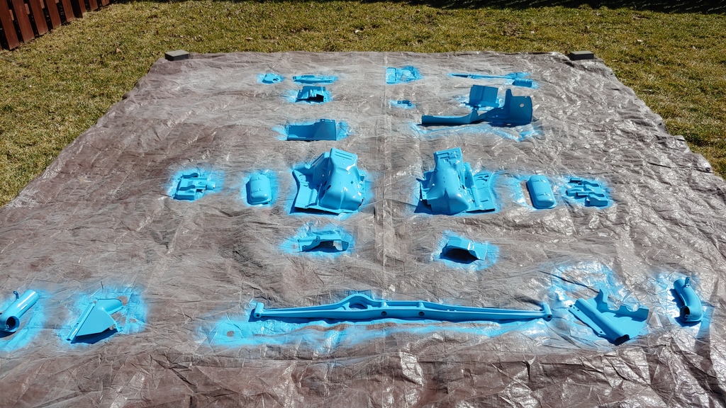

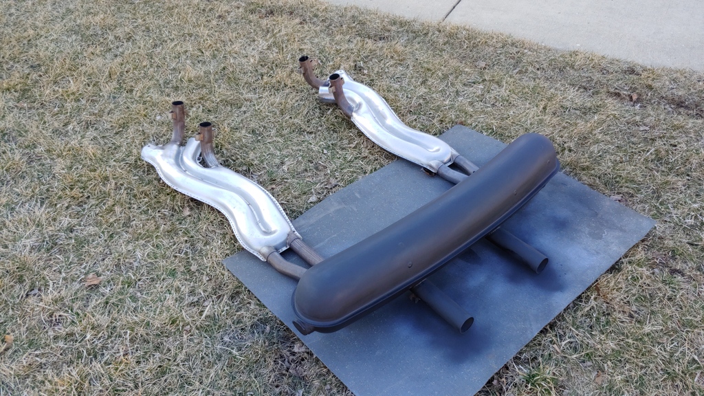

Also started to clean up and paint some parts to get those ready. The engine tins (as well as many other parts) are painted the original color of the car, 51P Olympic Blue to pay tribute to what it was originally

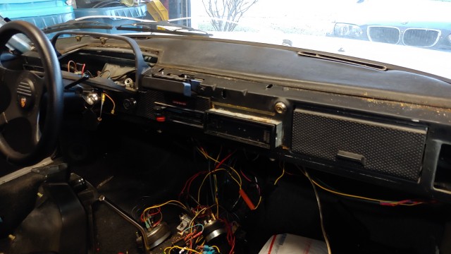

1) I need to know where does the oil temp sender wire plugs into under the battery? I looked everywhere and couldn't find it. The wiring is not stock so I'm sure that doesn't help
2) At idle the volts is just under 12 and then when you hit the brakes or turn signal it drops to under 10. Is this normal? If not, what should it be and how do I tell if the alternator is bad or something else? If something else, where to start?

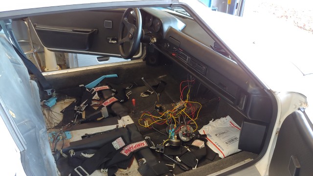

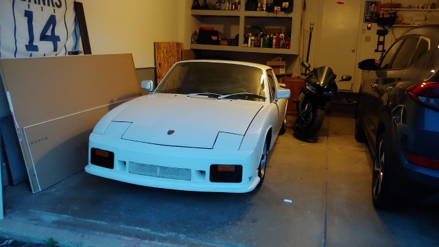

Got the interior torn apart. Now I need some help so please educate me. I was going to send my gauges off to @timothy_nd28 to get LED's put into them. Do the LED's plug directly into where the old light bulb plugged into? If not what do I do with the old light bulbs?
Here is a couple of pics
(IMG:http://www.914world.com/bbs2/uploads_offsite/i.ibb.co-21387-1577213019.1.jpg)
(IMG:http://www.914world.com/bbs2/uploads_offsite/i.ibb.co-21387-1577213020.2.jpg)

Yes, the old light bulbs are not used anymore when you do my LED conversion. Each gauge has its own LED strip, and a connector at the rear of the gauge. A small wiring harness connects each gauge together, which leads back to a hidden controller. I did a few write ups for people that want to do this themselves.
I've been out of the game for a few years, and wow how these RGB LED's have changed! In addition to that, this forum has also changed. I received a PM from a member, and it had a embedded picture! When did that happen? lol
Trying to keep up with these new style LED's, I'm experimenting with RGB+CCT LED's on another members car. This new LED has the original RGB function, but with two extra white LED's. Consequently going from 4 wire to 6 wire LEDs, which changes my setup quite a bit.
