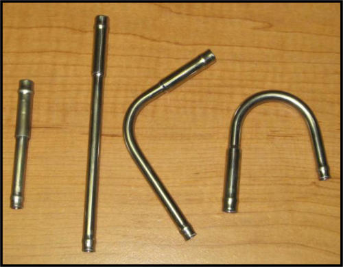

Chris makes these fuel adapters
http://www.tangerineracing.com/stainlessfuellines.htm
