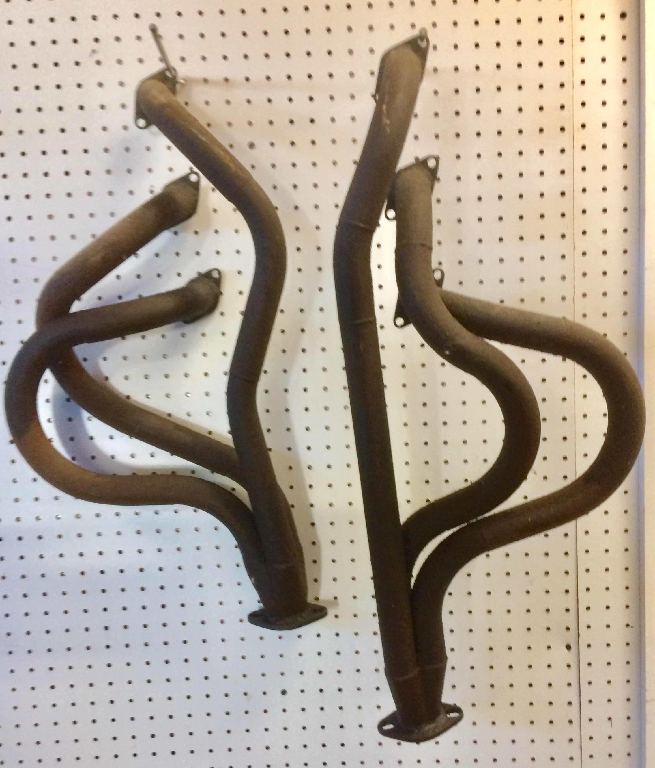

At the same time I bought that shift rod, I also bought a set of
Headers that Ralph kept as a backup to the sets on his cars.
I offered them as patterns for people looking to reproduce
Early headers, but there was no interest..

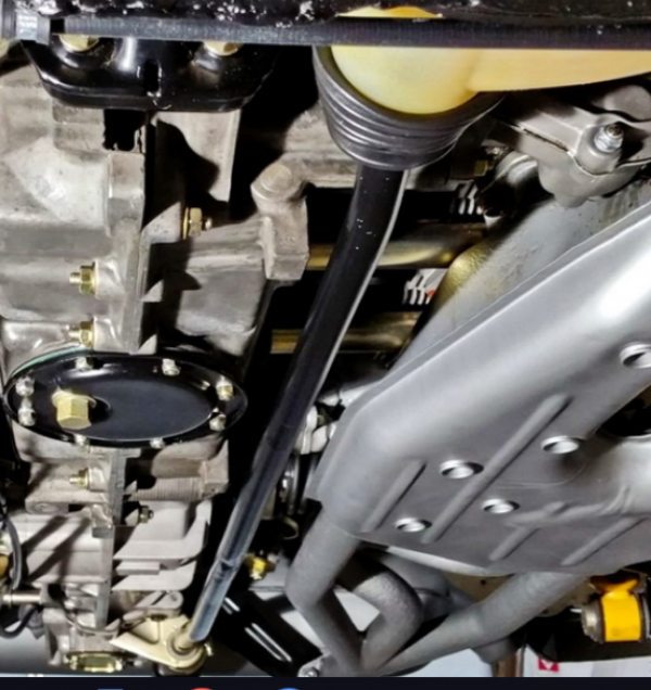

you are correct about the six shift rods,,, Unfortunately this is using the 4cyl. tail shift...yuk

It would be cool if you could post some pics.

I don’t get your point...
The 4 cylinder rear shift rod was similar
in shape to the 6 tail shifter....
As in fairly straight..
Can’t see someone had to bend the hell out of
it and then cut the exhaust to clear..
Modding the shift rod might have worked by itself...
Just my opinion of course.....

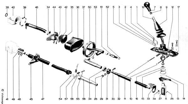

four and 6 rear shift rods.
Both pretty straight originally.

These are the headers as they are now.
They spent a lot of years on my car just sitting.
Went on the car in the 70’s and sat from the early 80’s.
Car hasn’t been run since..
the 4cyl shift linkange is not very precise, the 6cyl, is decent.
If it had a 6cyl, tail housing and shift linkage, it would have cleared no problem..

If you read what I posted, you’d see I wasn’t debating
the plusses or minuses of either...
Just saying there was a better way to mod the shift rod
And not
Make a mess and have to cut up the exhaust..
That’s all...

I got it, six would fit no prblem, they should have went to side shifter. (IMG:style_emoticons/default/beerchug.gif) see pic in post above
esp. for the $$$ they want

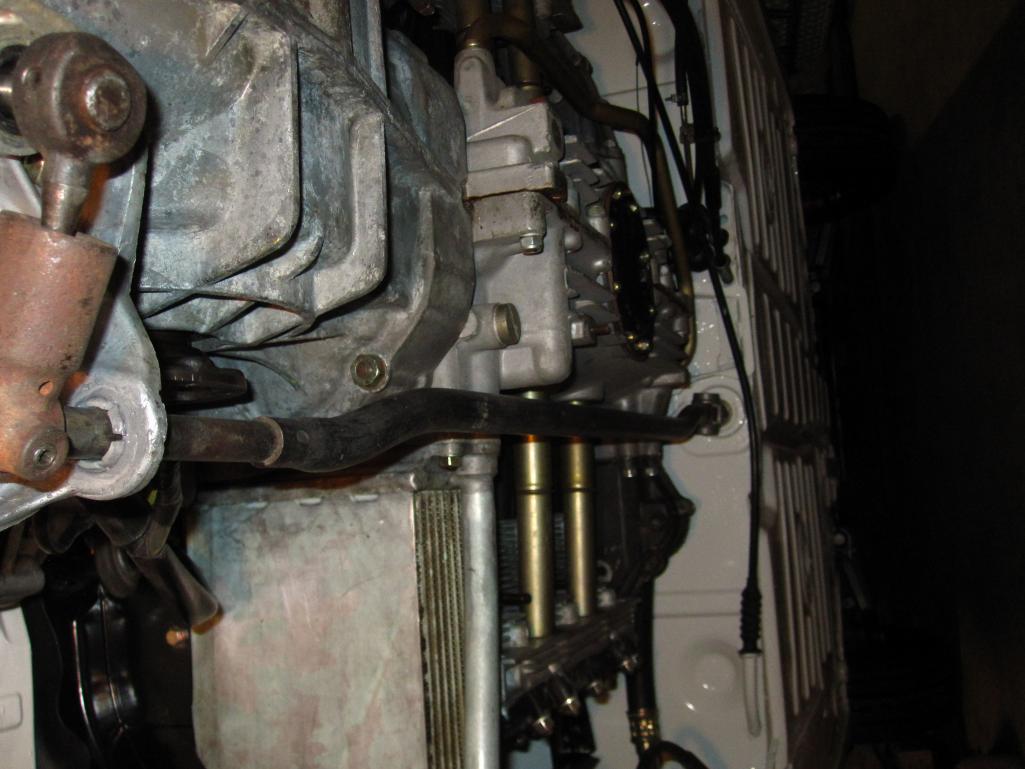

QUOTE(gandalf_025 @ Mar 26 2019, 02:43 PM) *

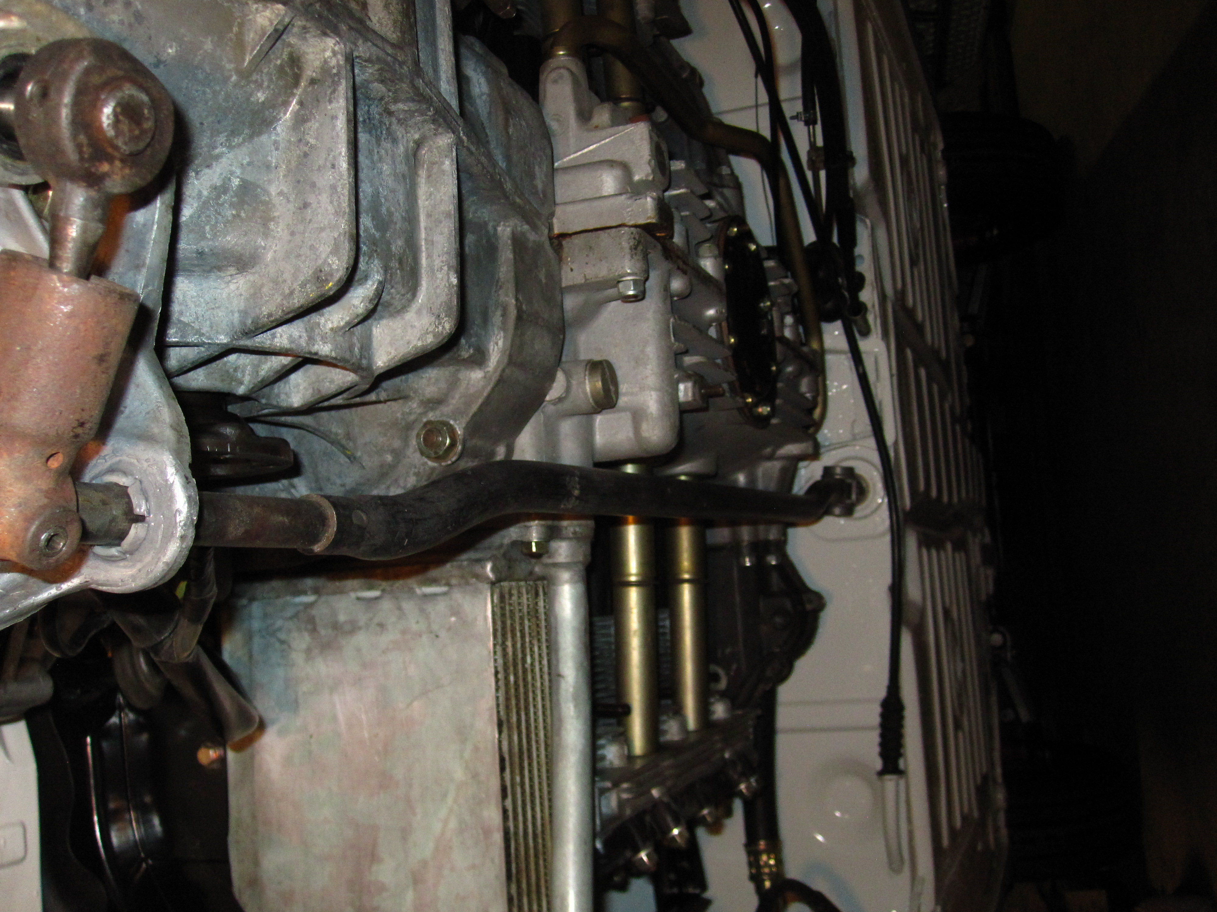

Side shift conversion piece for a 6 using re-arranged 4 cyl. rear shifter parts.
Even clears an aluminum engine and stock heat exchangers

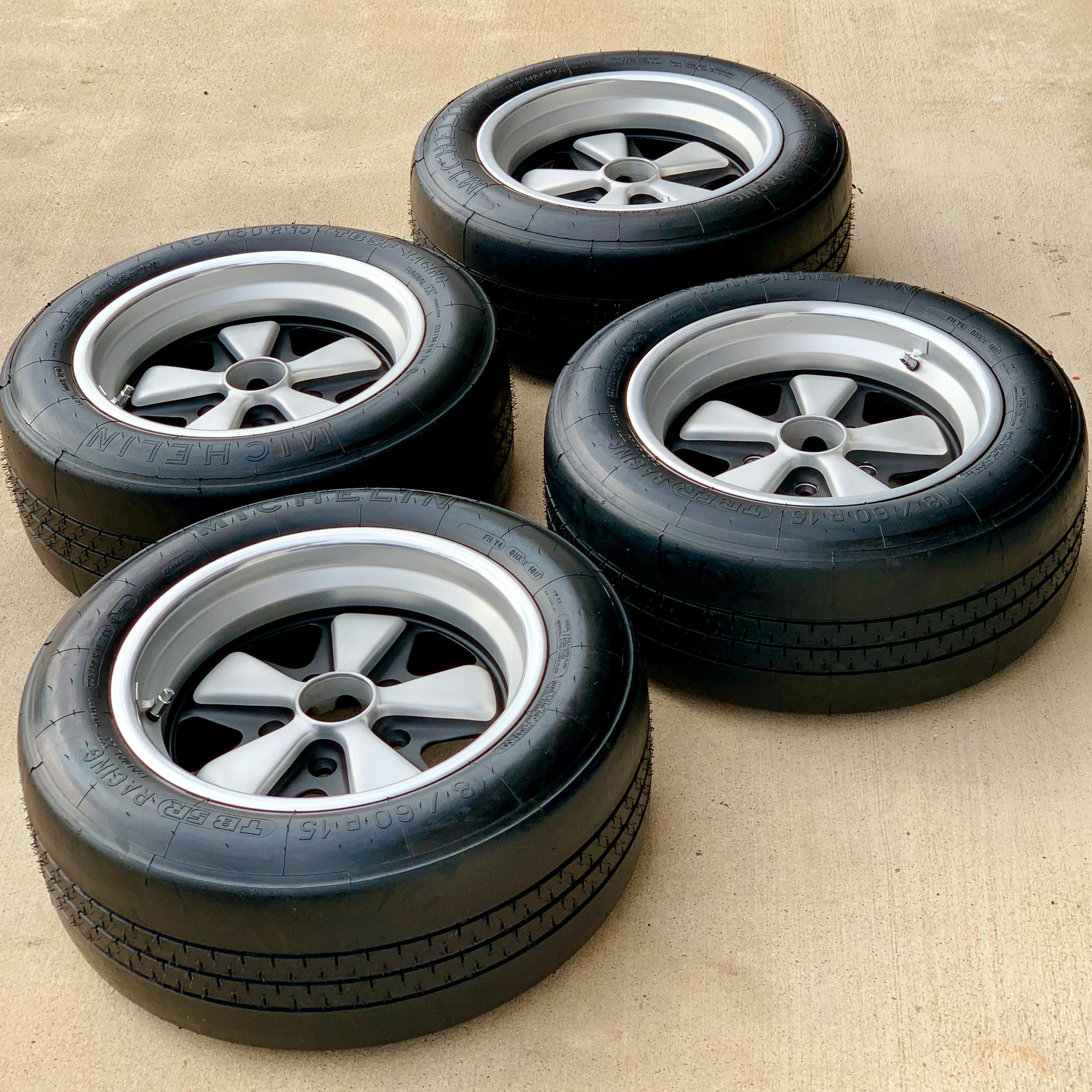

QUOTE(rick 918-S @ Mar 25 2019, 08:40 PM) *
QUOTE(Eric_Shea @ Mar 25 2019, 03:41 PM) *
I was going to ask.... (IMG:style_emoticons/default/drooley.gif) Vintage PHAT. What model and size are those? Can't find that tread pattern.
I just got the same - TB-5 from Coker Tire. It's a modern radial repro of a vintage Euro tread pattern, comes in medium/rear and soft/front compounds.
Beware, they are $pendy. Like if you think Hoosiers are expensive (I do, and they're my only other real option)...don't look. Sizes very limited also.

QUOTE(horizontally-opposed @ Mar 26 2019, 10:35 PM) *
QUOTE(mepstein @ Mar 26 2019, 10:24 AM) *
Shift linkage on a 911 is pretty straight forward but not so much on a 914 conversion car.
Fwiw, a 911 shift rod (interior side) can be modded to work beautifully to replace the rear rod in a 914-4 side-shifter. Has to be cut, plug welded, then seam-welded. This is the best-shifting 901 that I've ever tried, and my stock 914-4 side-shifter was very well sorted. This is nicer...
I think you mean this..
