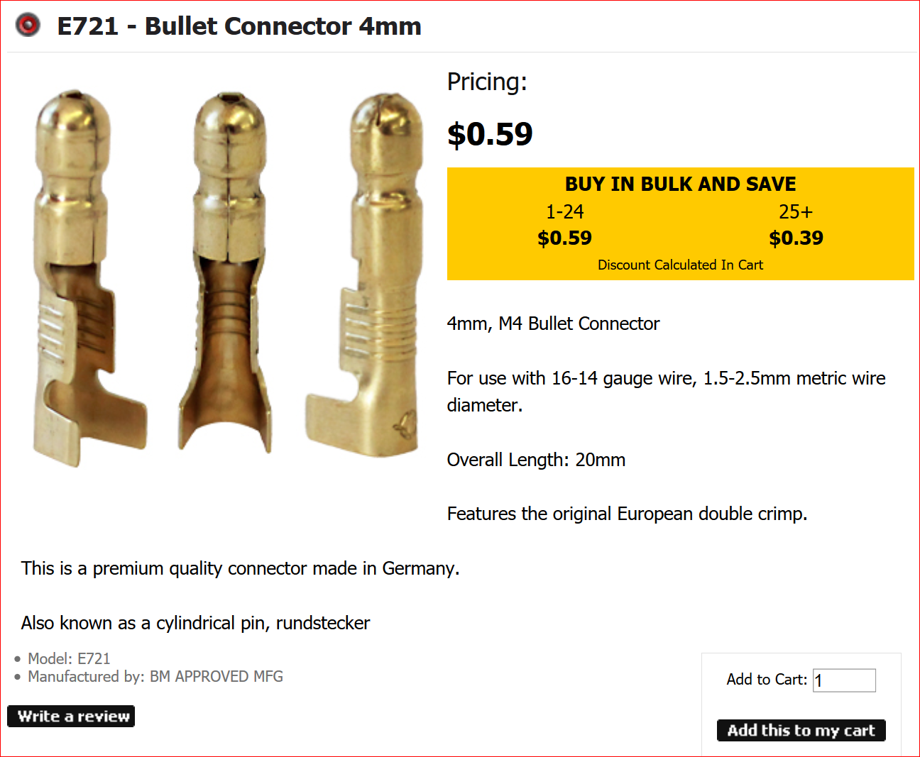

@Str1974
I got the correct ones from Bel Metric. German made with double crimp on bare wire and insulated wire. I think they were 4mm.
https://www.belmetric.com/bullet-connectors...mm-p-11391.html

QUOTE(bdstone914 @ May 12 2019, 11:25 PM) *
@Str1974
@Bleyseng
Wow, you guys are awesome. 914World rocks! I want to thank all you guys for your help.

Yes, I picked up some of these so now I just have install them.

4.5mm is the correct size for these terminals.
