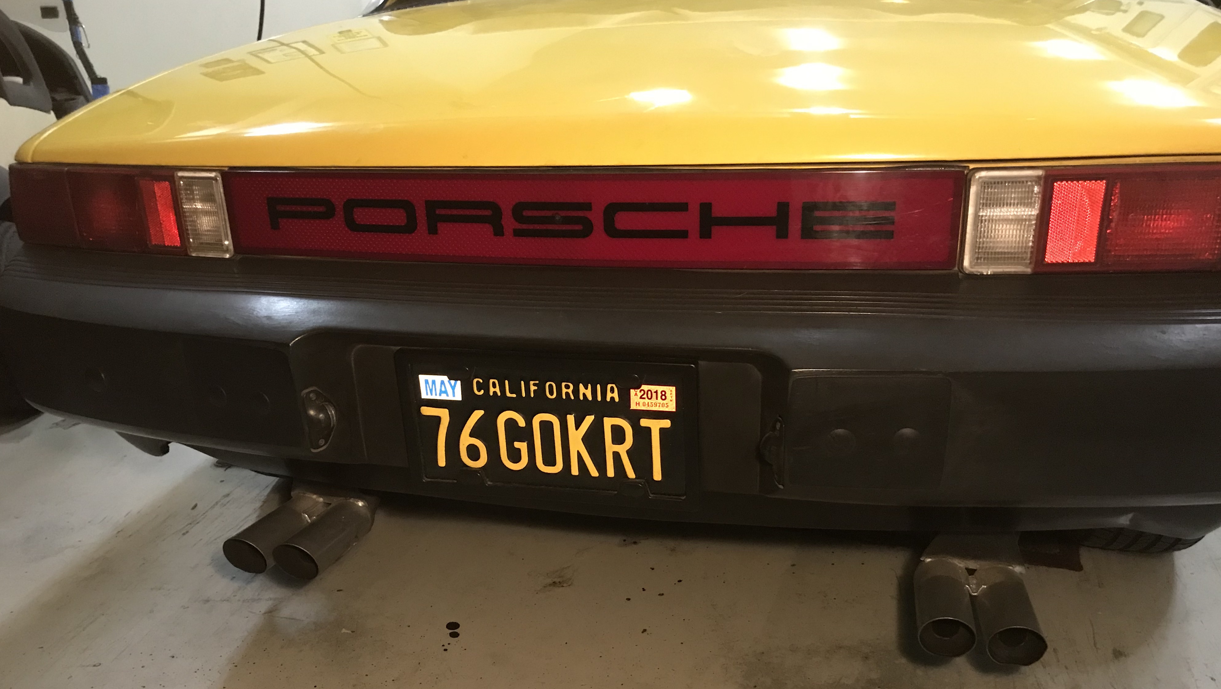

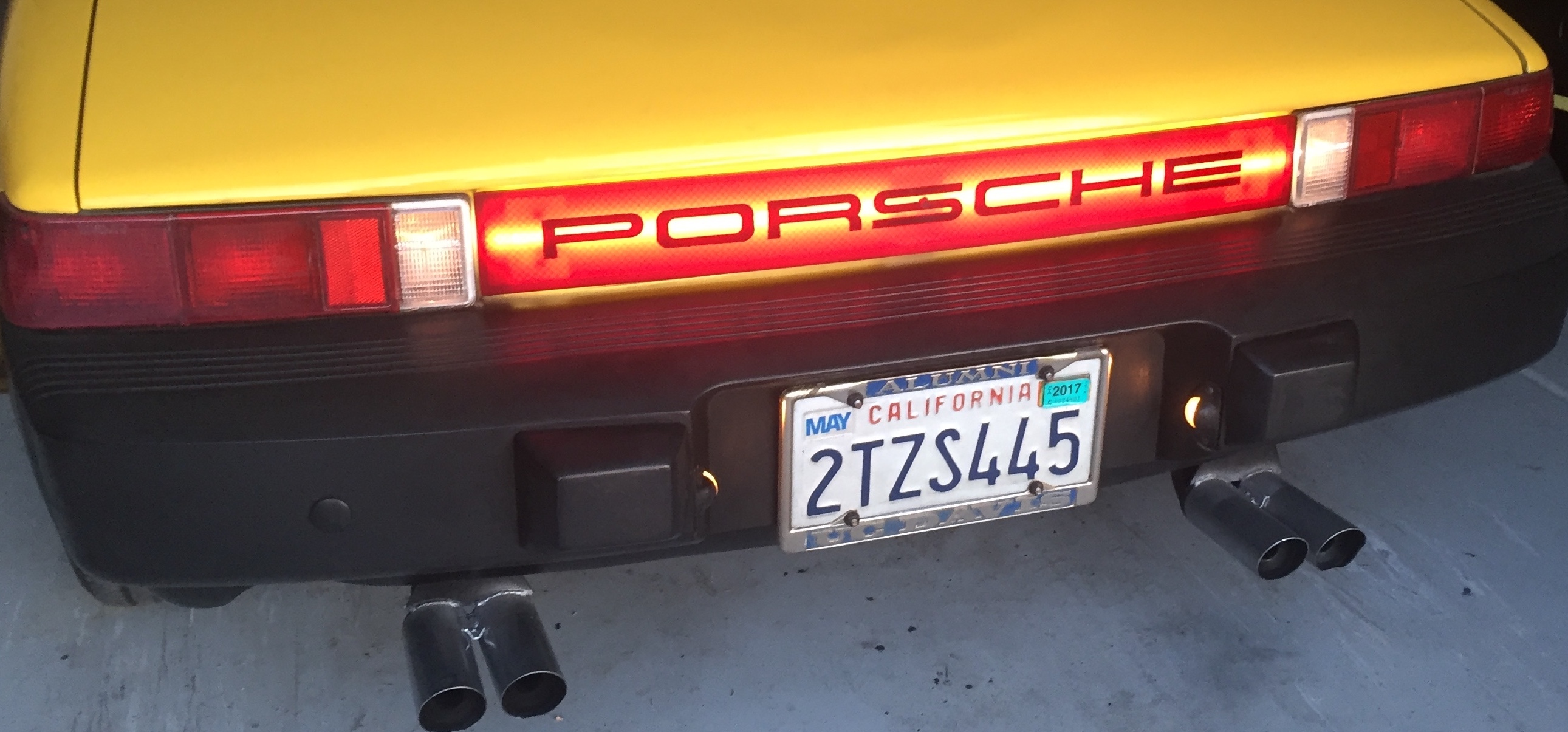

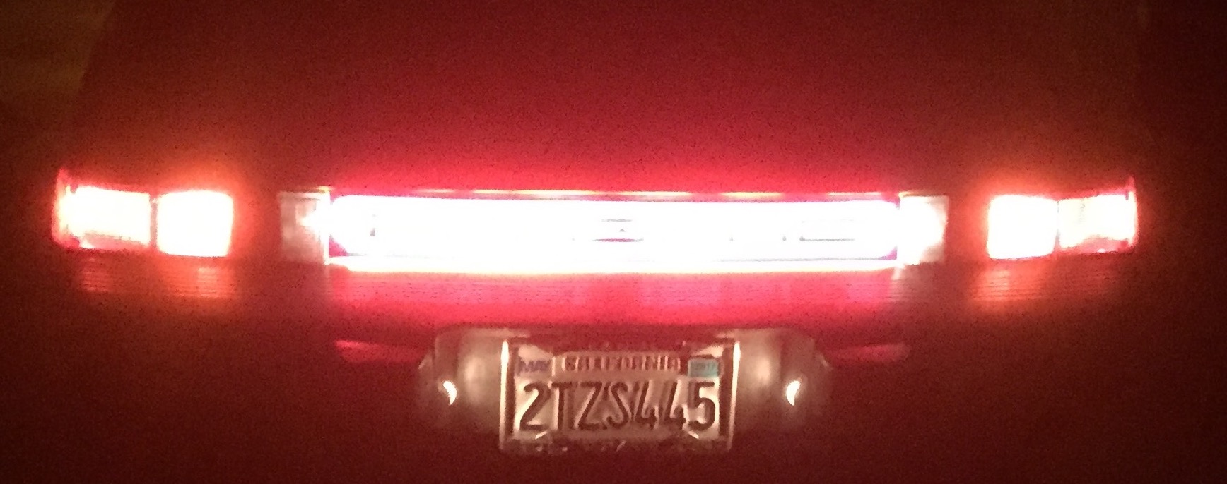

Hey Ed, I guess opinions are like....., oh, never mind. I have had a reflector on the back for a long time, and I enter a lot of car shows with my car. I get nothing but positive feedback on the look of the reflector.
I have also added an additional layer of safety with the reflector in place. I put two strips of LED's behind it. I wired one strip to the running lights and the other strip to the brake lights. Here's some photos of the results. Daytime, running lights, brake lights. Can't be "too safe".......

I’ve often thought I’d like to do this but wasn’t sure how to go about it. Did you remove the silver paint on the back?

Was 20 years ago, but mine was already translucent....

Hey Tejon, I didn’t take any photos at installation of the sticky back LED strips, but it’s super simple. Buy some 12 volt strip LEDs online and cut length to go across metal trunk back. Then you solder some lead wires on to the LED strip, feed the leads through a small hole in back into trunk and connect to appropriate trunk light leads. Then peel of LED strip sticky back and press into place. LEDs are polarity sensitive, so check operation before installing lens.

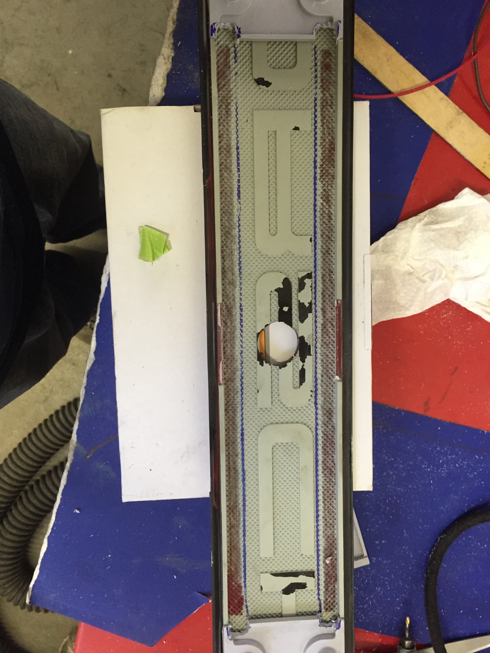

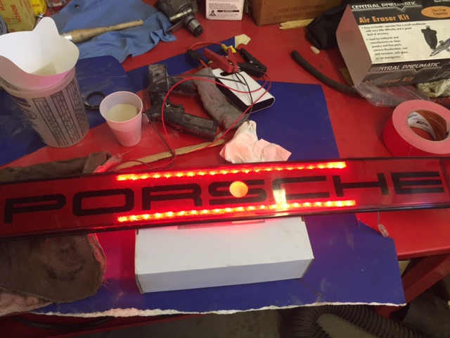

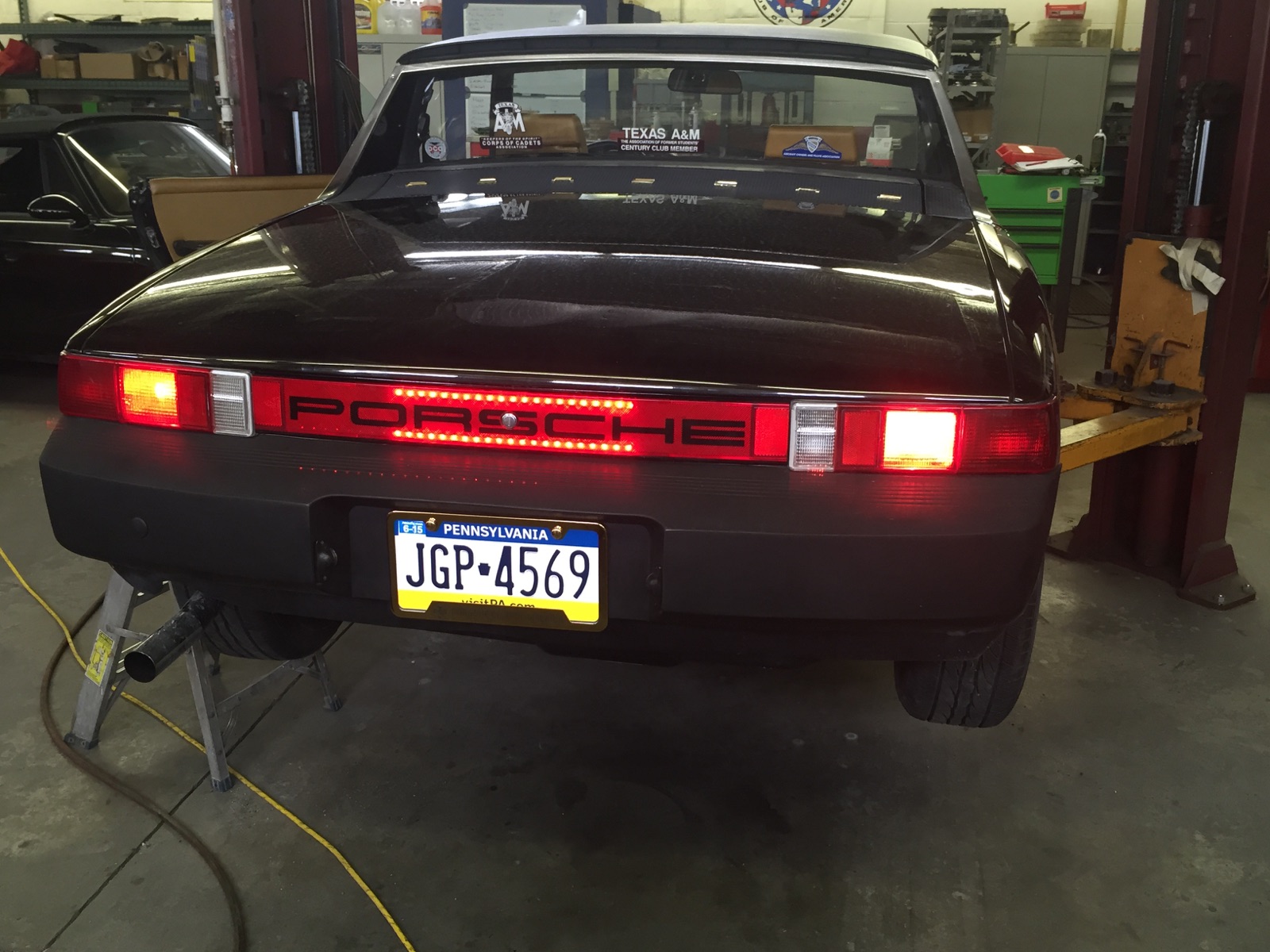

Here's the installation I used:
The shop sanded off the reflector where the LEDs were to be installed and then glued them to the back. The LEDs are wired into the brake circuit, which I believe provides more of a contrast than just a brighter light, serving as a somewhat third brake light. The car had the reflector when I bought it, and the remote trunk release was too much of a hassle (took 2 people, one to press the under-dash switch, the other to press down on the trunk latch), so as part of this installation I had the shop drill a hole in the reflector and reinstall the keyed latch. Since the original installation, I've added a pulsing relay to the connection that pulses the LEDs 4 fast and then 4 slow, finally staying on as long as the brake pedal is pressed.

Pvollmo and Oakdalecurtis,
Thanks for the info and photos!
So, now there's a couple options for the reflector lighting. Both look great, so I'll have to think about it. Like the brake light option with the auto-flash system.
