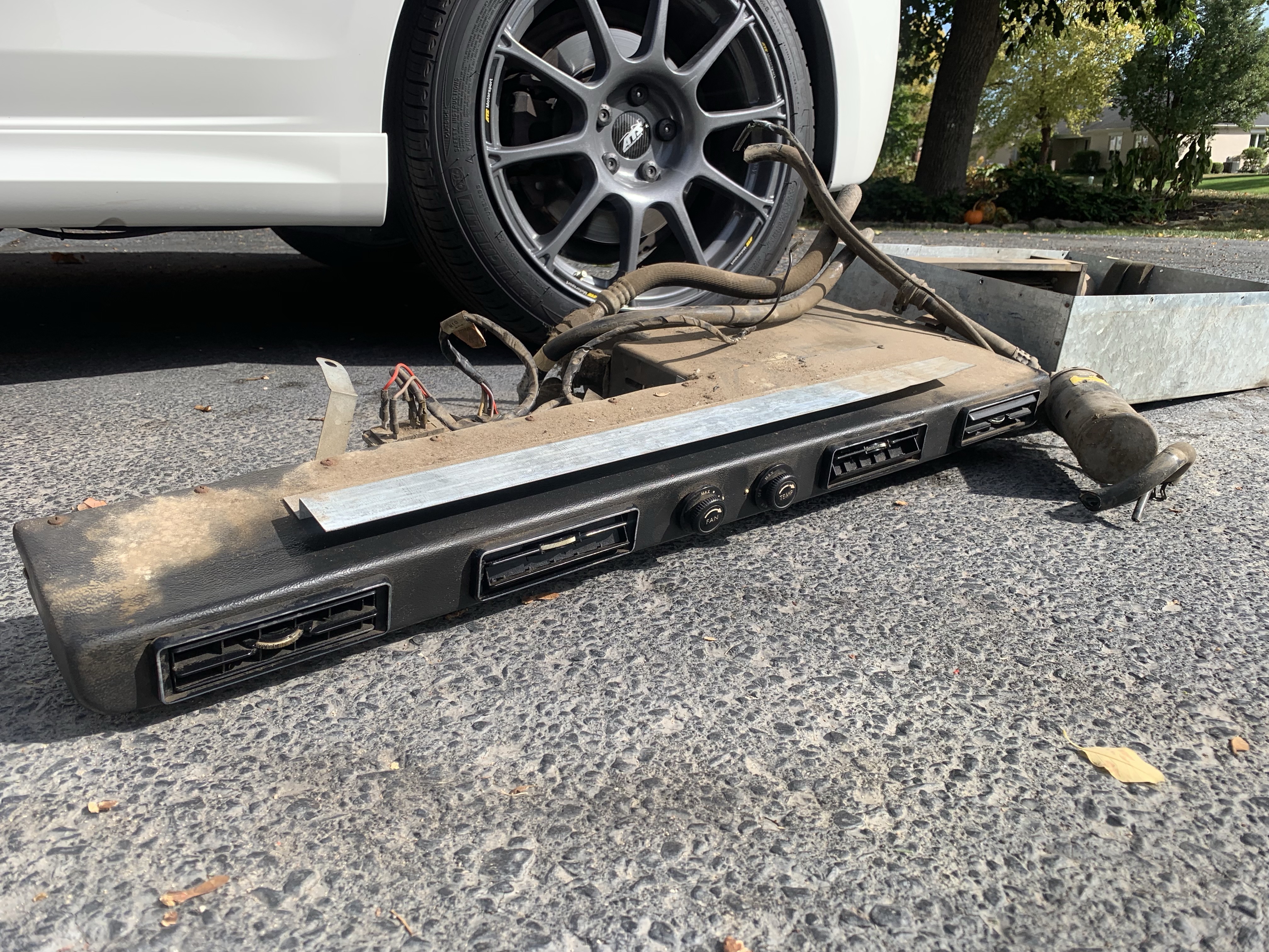

Just curious, what's this system worth? Compressor and bracket included, but not shown. Not sure if compressor works.

Hard to say. People are hesitant to cut front floor.

that is a nice system, at least 300

I’d say 200-300 but the dash unit has to be intact and no missing vents, the wiring has to be complete and not cut, and the condenser has to be complete. The old compressor is junk and not worth anything. Any old hoses and the dryer are both trash. .

Congrats on getting it out of the car! (IMG:style_emoticons/default/piratenanner.gif)

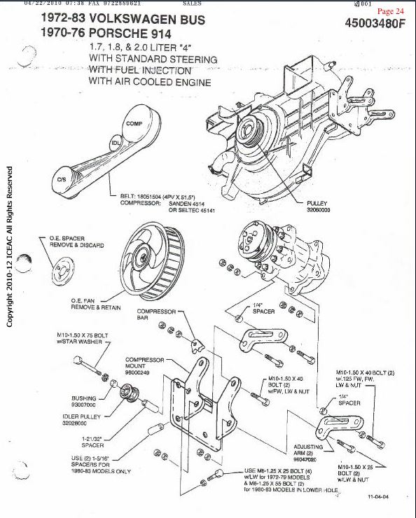

There is a kit used on the Type IV VW bus to mount a compressor. It's sold by ICEAC in California. It replaces the York boat anchor with a R-134a compatible compressor.
We have been running this on Betty's car for years. It works great, and doesn't suck Horsepower like the York. We use the stock DPD evaporator and condenser. I replaced the fan on the condenser with at 10" fan from FLAPS. I also added a 911 SC condenser to the underside of the engine lid with two fans on it. We get really cold AC out of the vents.

Did the install involve cutting the engine shelve and pass side upper tin? Replacing the belt on the pulley behind the fan shroud looks like a hassle.
