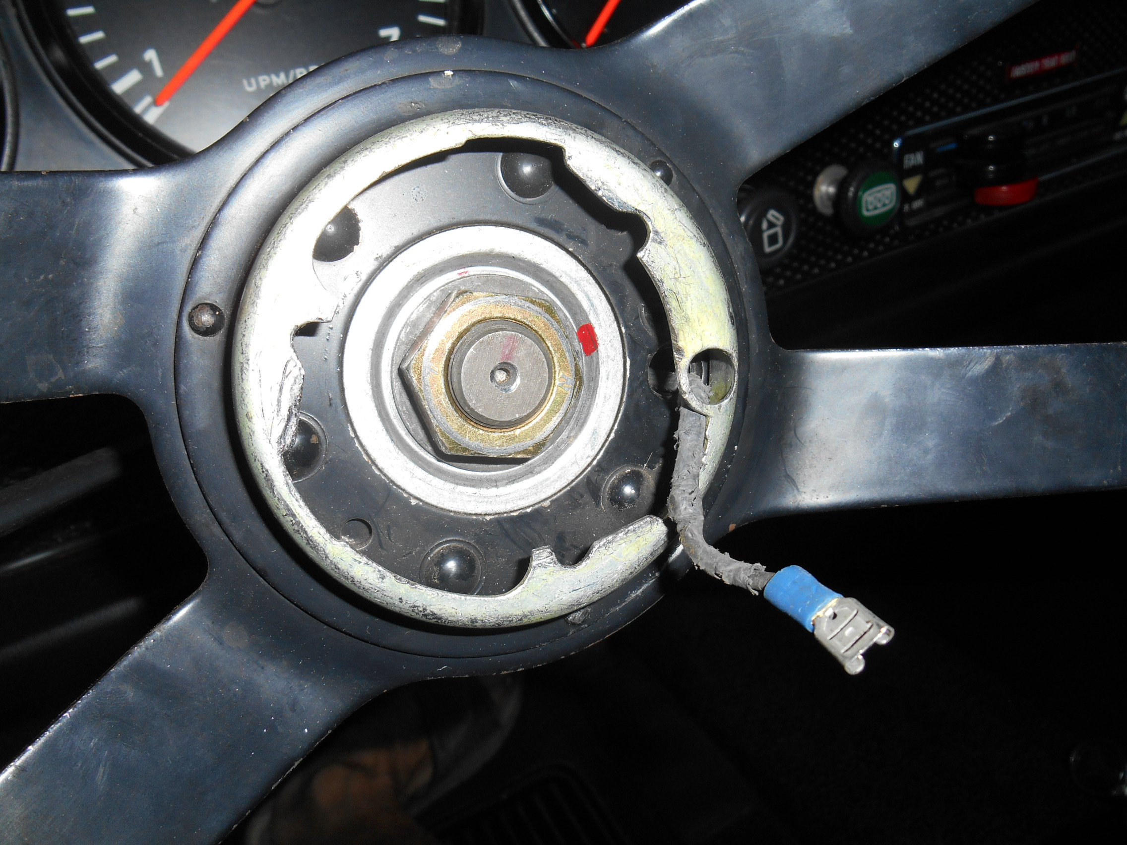

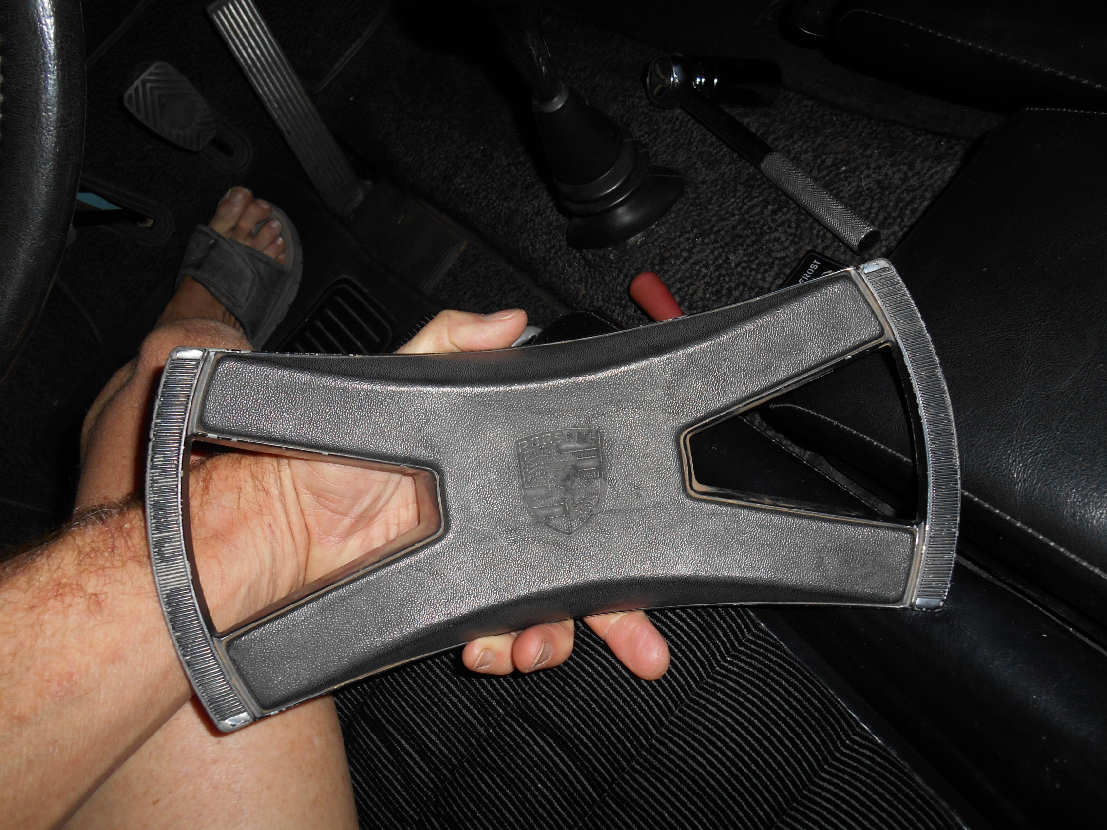

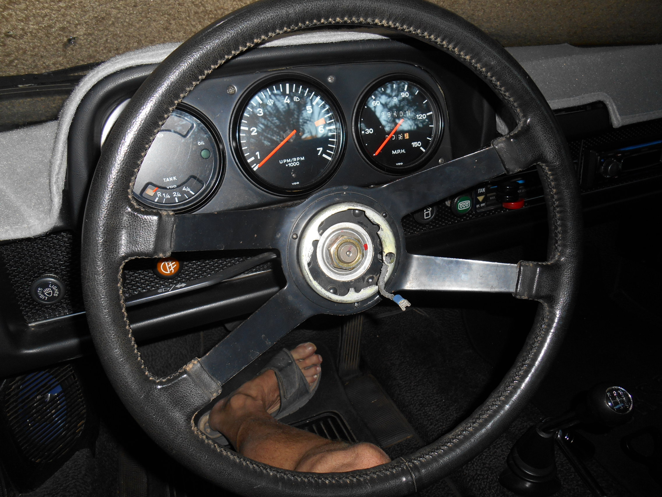

Hello, I put the stock steering wheel on and attached the horn wire to it at the plug in. When I turn on the ignition the horn is on right away continuous. Also the center cap of the wheel does not seem snug but loose. Any ideas what is wrong?

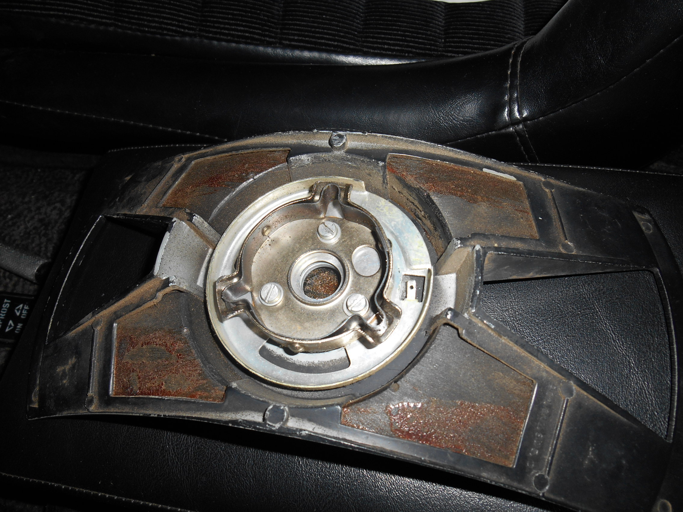

Second post here are picturesAttached Image Attached Image Attached Image Attached Image

Do you have plastic or fiber spacers on the plate that’s bolted to the horn pad?

Ask as the insulator, for the plate. Just, snaps in .

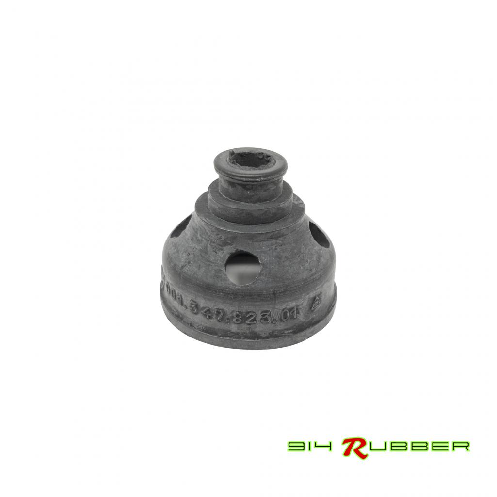

Possibly. I don't know if you have the fiber washers behind the plate. You do also need the rubber piece in the pic.

Thanks Garland so I so have a missing part the rubber piece in the picture. Do I ALSO need some fiber washers put around the 3 points on the back of the front plate?

Here’s the link to 914 Rubber
Steering Wheel Horn Rubber Cuff

The horn wire looks a little crusty make sure its not contacting anywhere else but the horn button ok,and need to fix the other stuff as mentioned,good luck.

Yes, you need the rubber piece and the isolator washers/spacers for plate that attaches to the horn pad. Here’s a link to a picture of what they look like:
https://sierramadrecollection.com/Horn-Butt...-76-p21568.html

Hello, does the horn wire go thrugh the metal hole or can it be attached to the horn as the wire is shown?

No, the wire does not go through the hole in the wheel. That hole is used on very early /4 cars and all the /6 cars for the horn contact. It is completely different.
