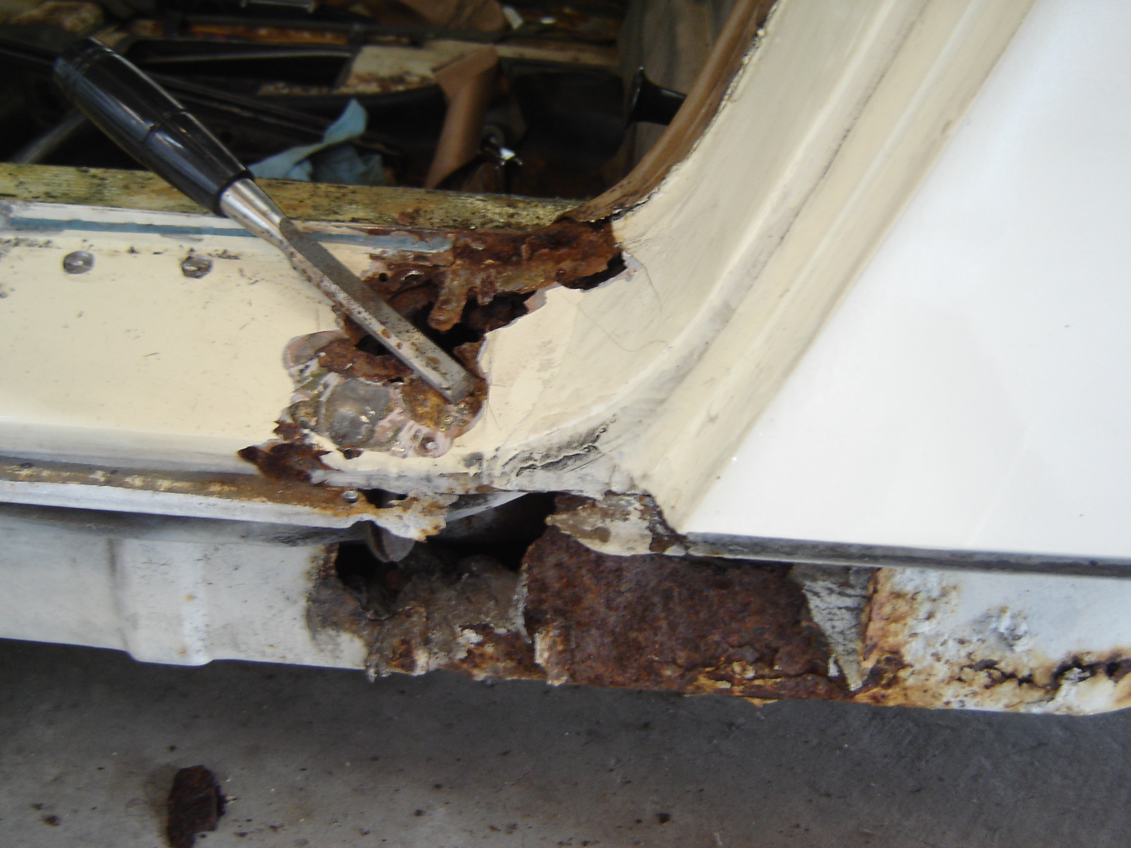

Hi guys,
I'm getting ready to shoot a 914 for Newbies video about the most common places to find rust. Looking for shots of rusty:
Floor pans
Sail panels (nasty foam a bonus)
Cowl area
Rear of trunk
Base of firewall
Headlight buckets
Door sills
And any other common areas I forgot to list. The hell hole already has its own episode, so no need for those (and thanks again to all who posted). A pic of a broken rear trunk hinge would be great, too..
If you have some pics you'd like me to include, please upload them to this thread at a decent size. It'll help the greater good.
Thanks!

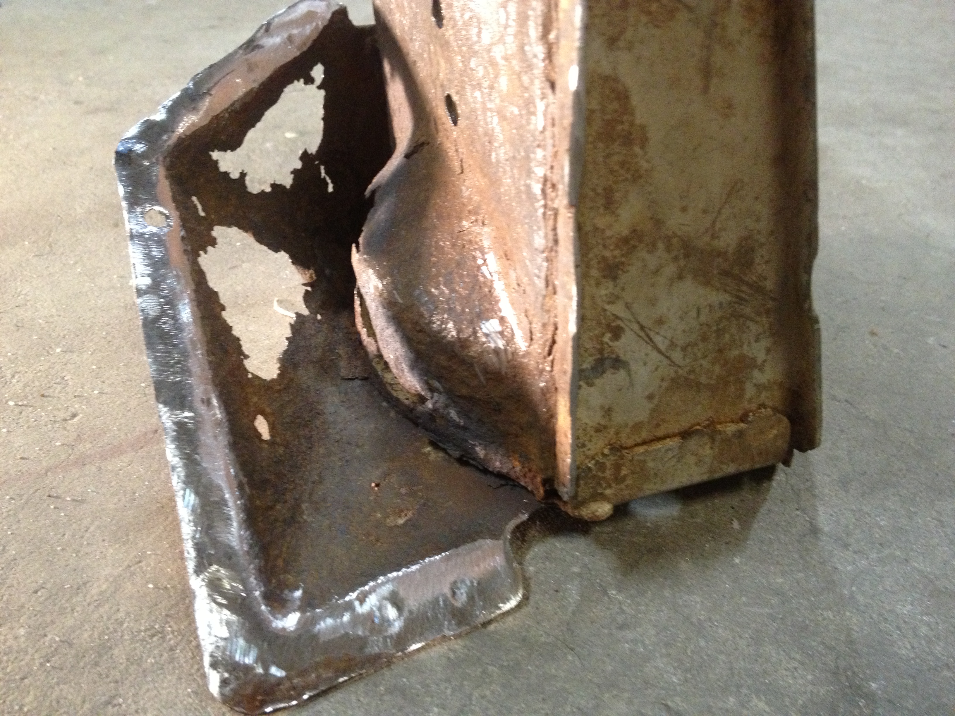

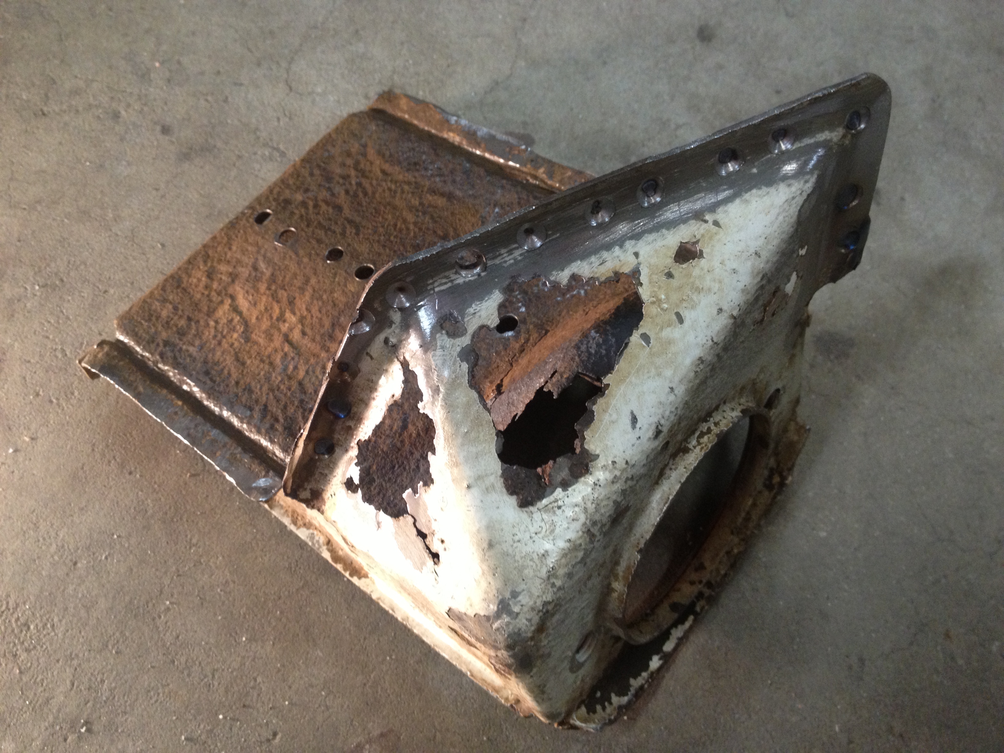

Don't forget the tunnel area. It often get's overlooked. Pinholes on the outside underbody are usually a sign of much worse rust penetrating from the inside out.
Suspension consoles.
Passenger side is usually the 1st to go.
In this case my driver side has some stress cracking that also leads to rust on the consoles flanges that pick up the semi-trailing arm.

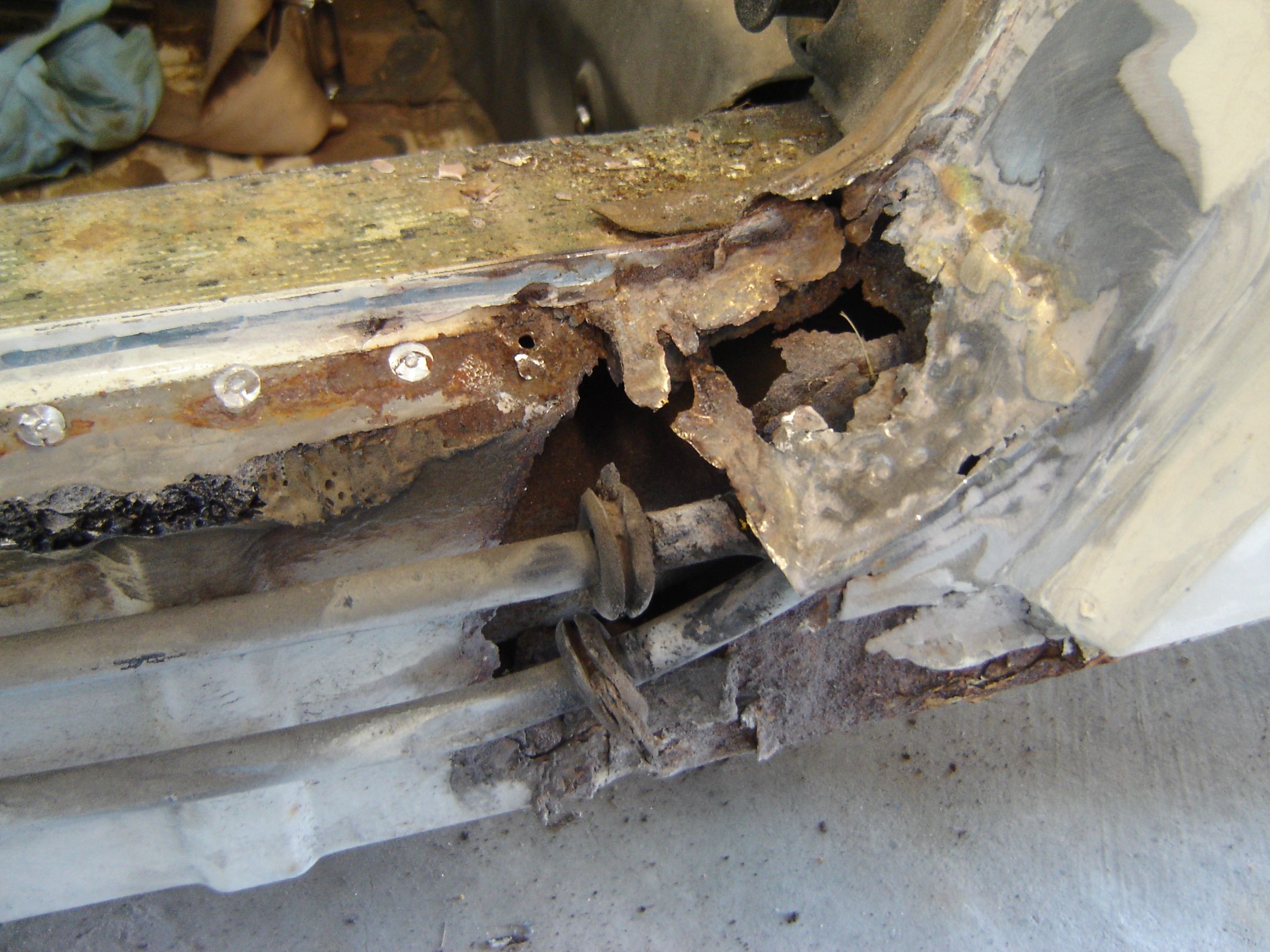

Found this in Jamaica
This is my car. Had I only known what I was getting into.....
Hope this helps. Appreciate you doing the videos. I've benefitted from other videos you've done so Thanks!

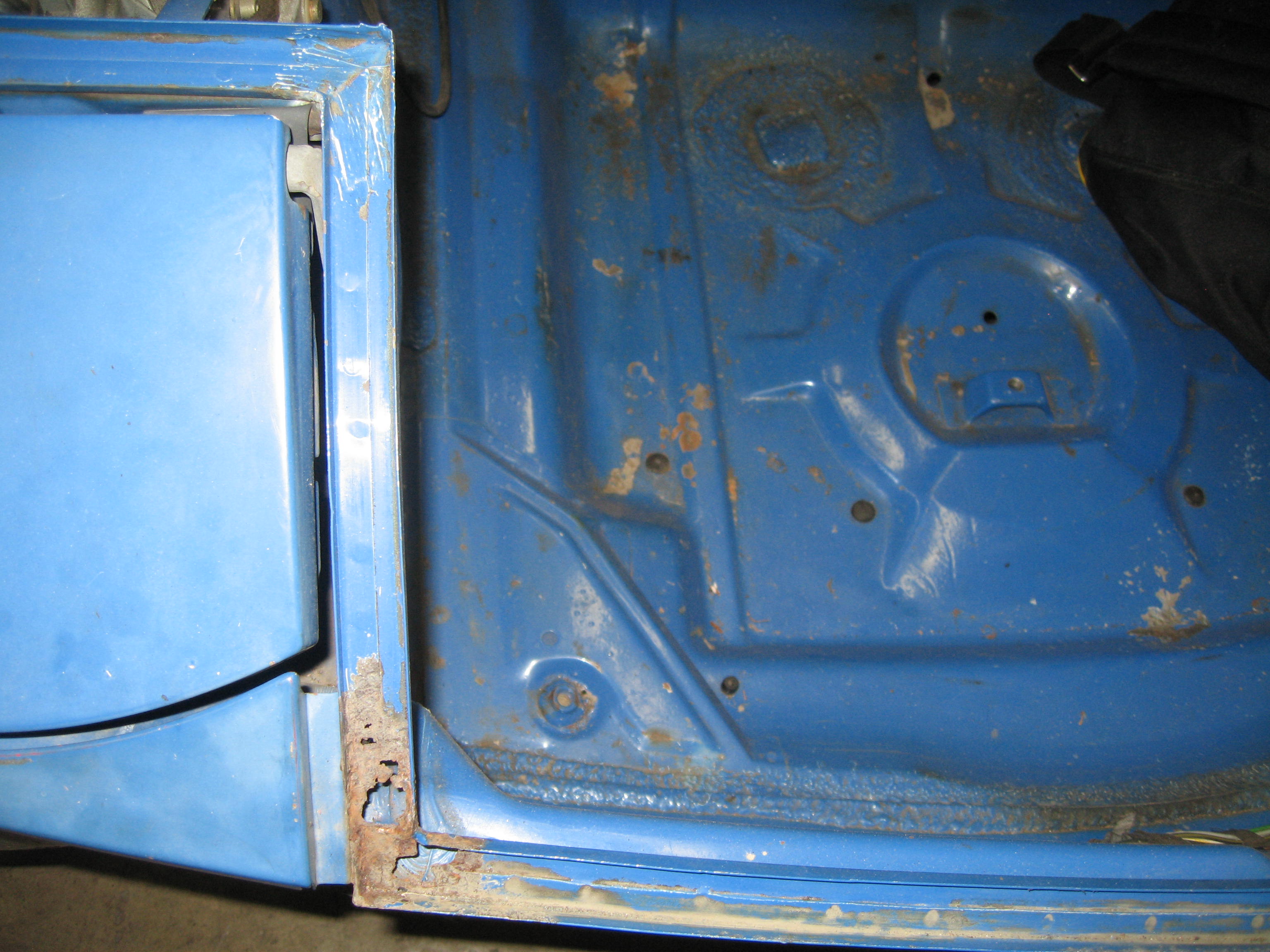

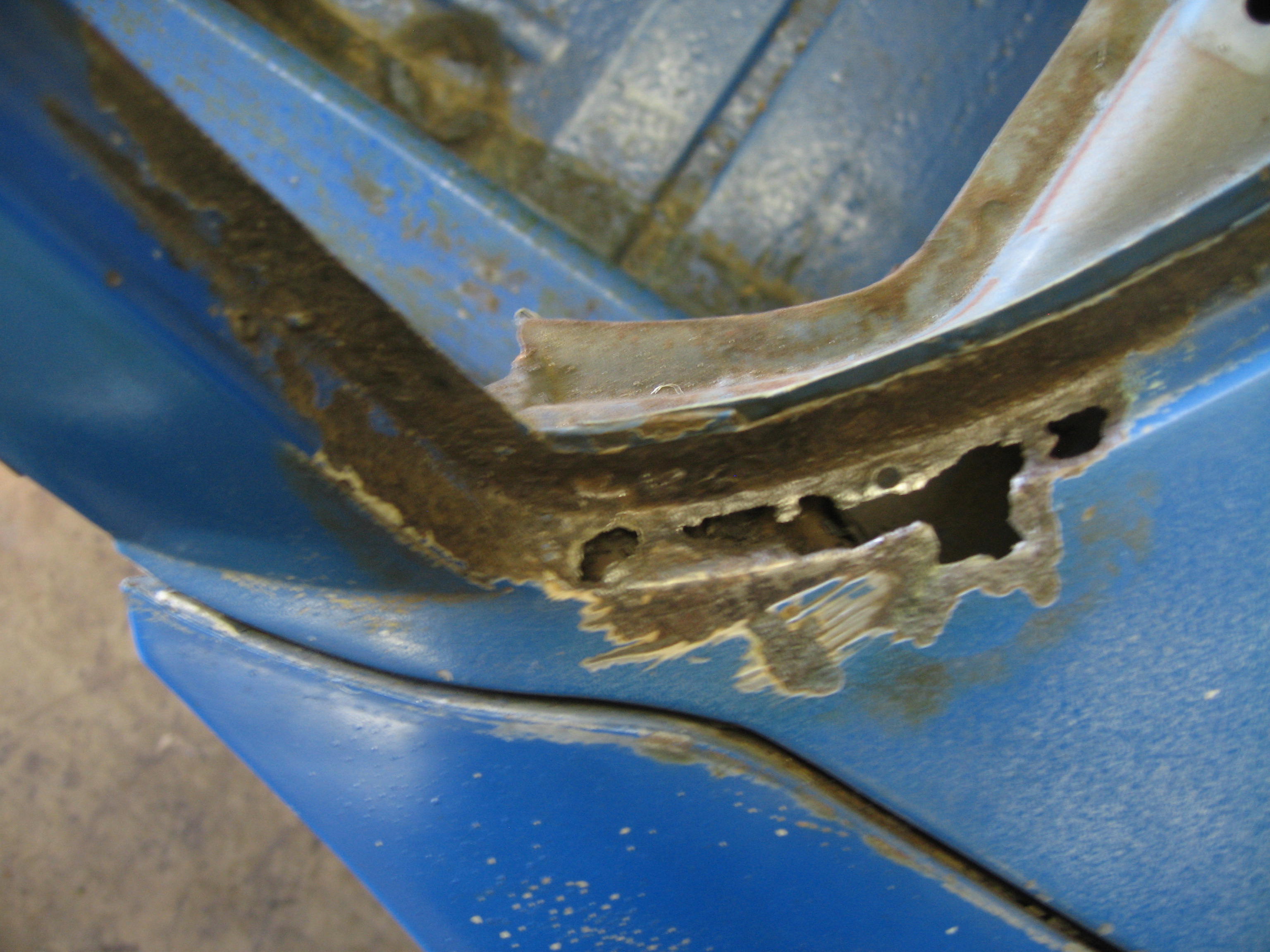

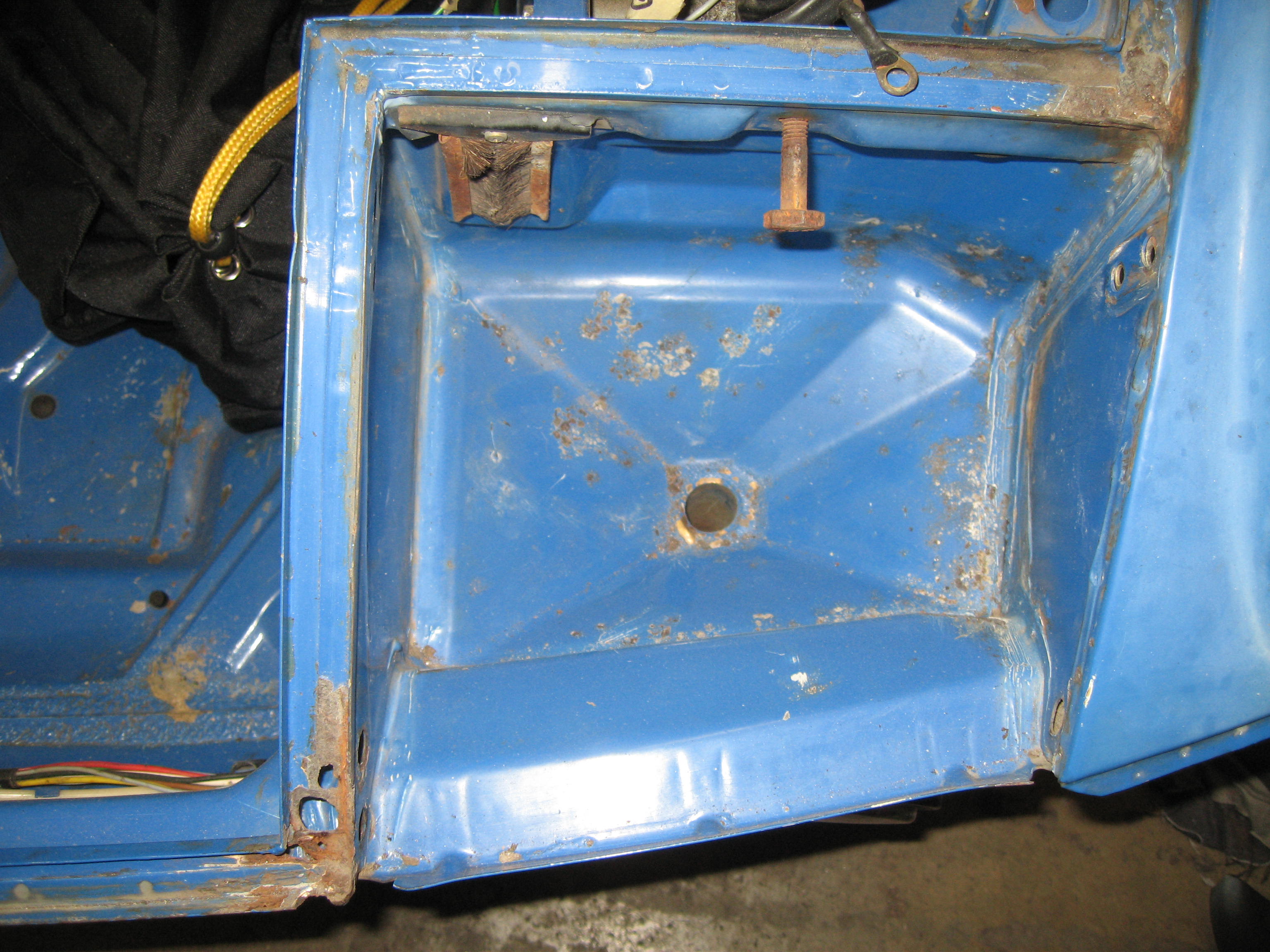

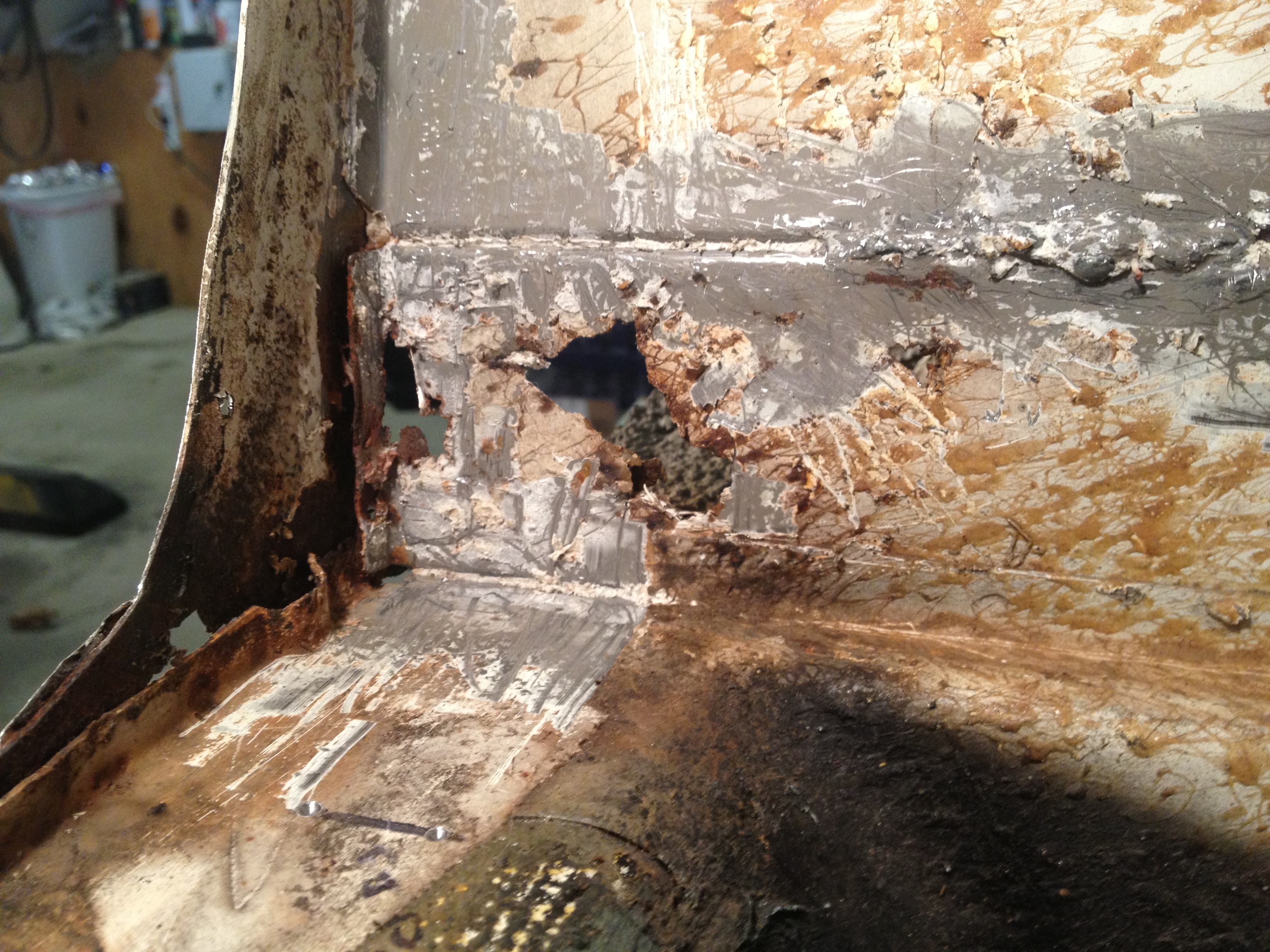

Cowl rust that you can see
And once I got into it

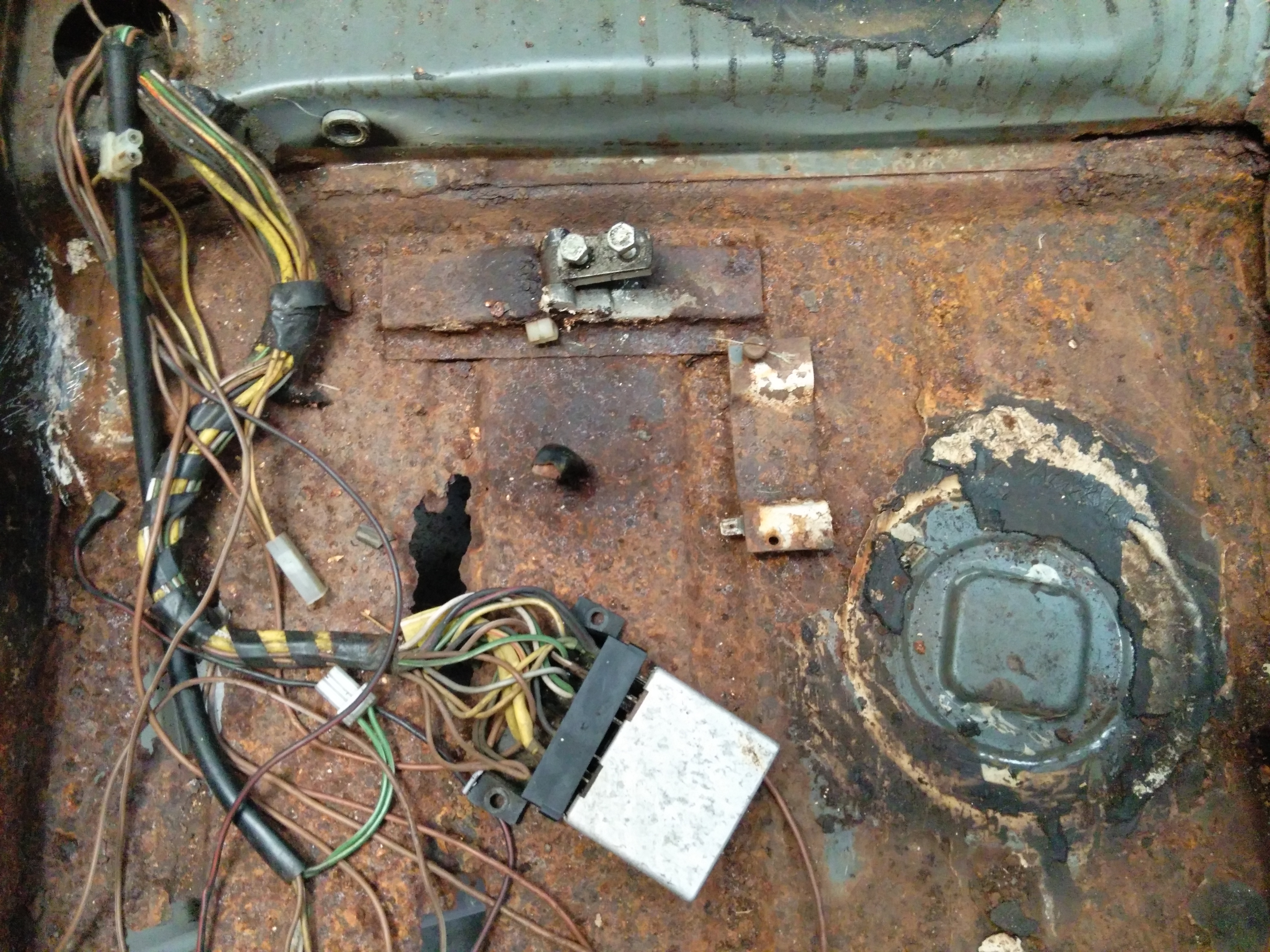

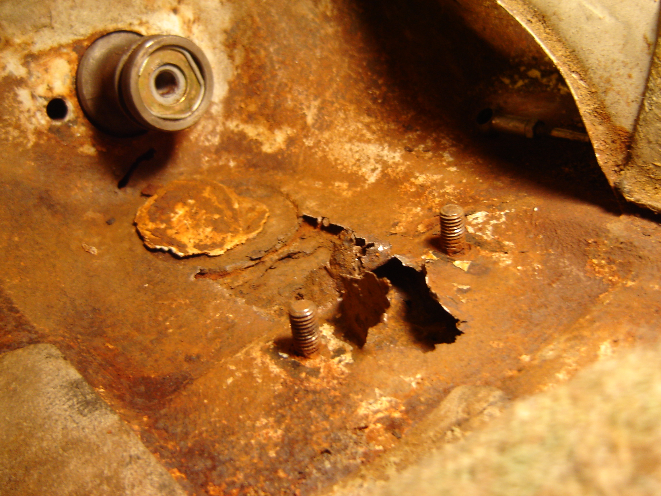

You don't hear rusty motor mounts talked about that much.
TargaToy
post Jan 23 2020, 03:27 PM
-NONSOLIS RADIOS SEDIOUIS FULMINA MITTO-
Posts: 714
Joined: 26-March 10
From: DelMarVa Peninsula
Member No.: 11,509

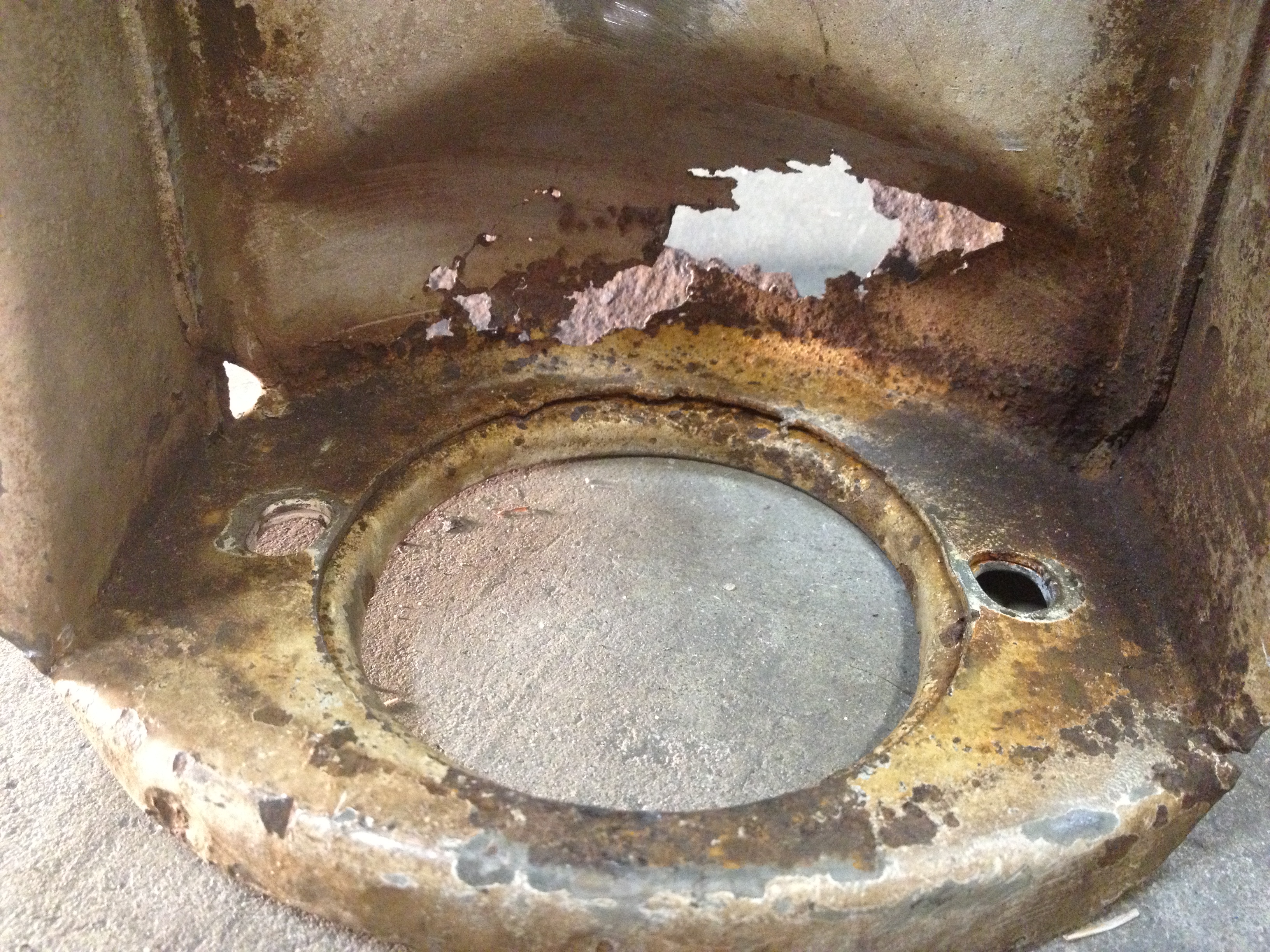

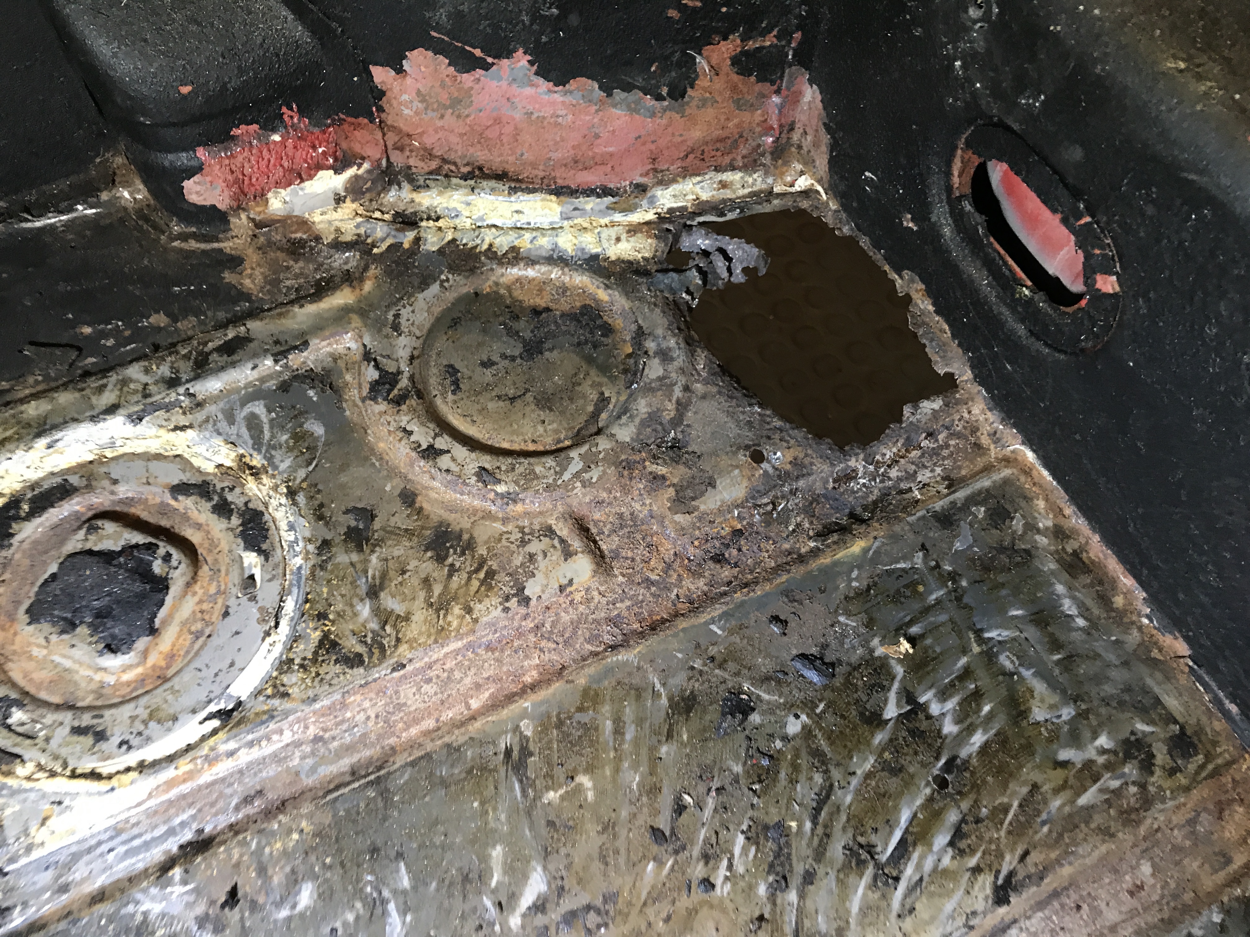

These are often a problem, passenger side especially
(IMG:http://www.914world.com/bbs2/uploads/post-7199-1223520815.jpg)
Always rusting from inside out. A little blemish in mine, a screw driver went right through.
shot of this same one inside, not terrible but very thin at the bottom, close to rusted through

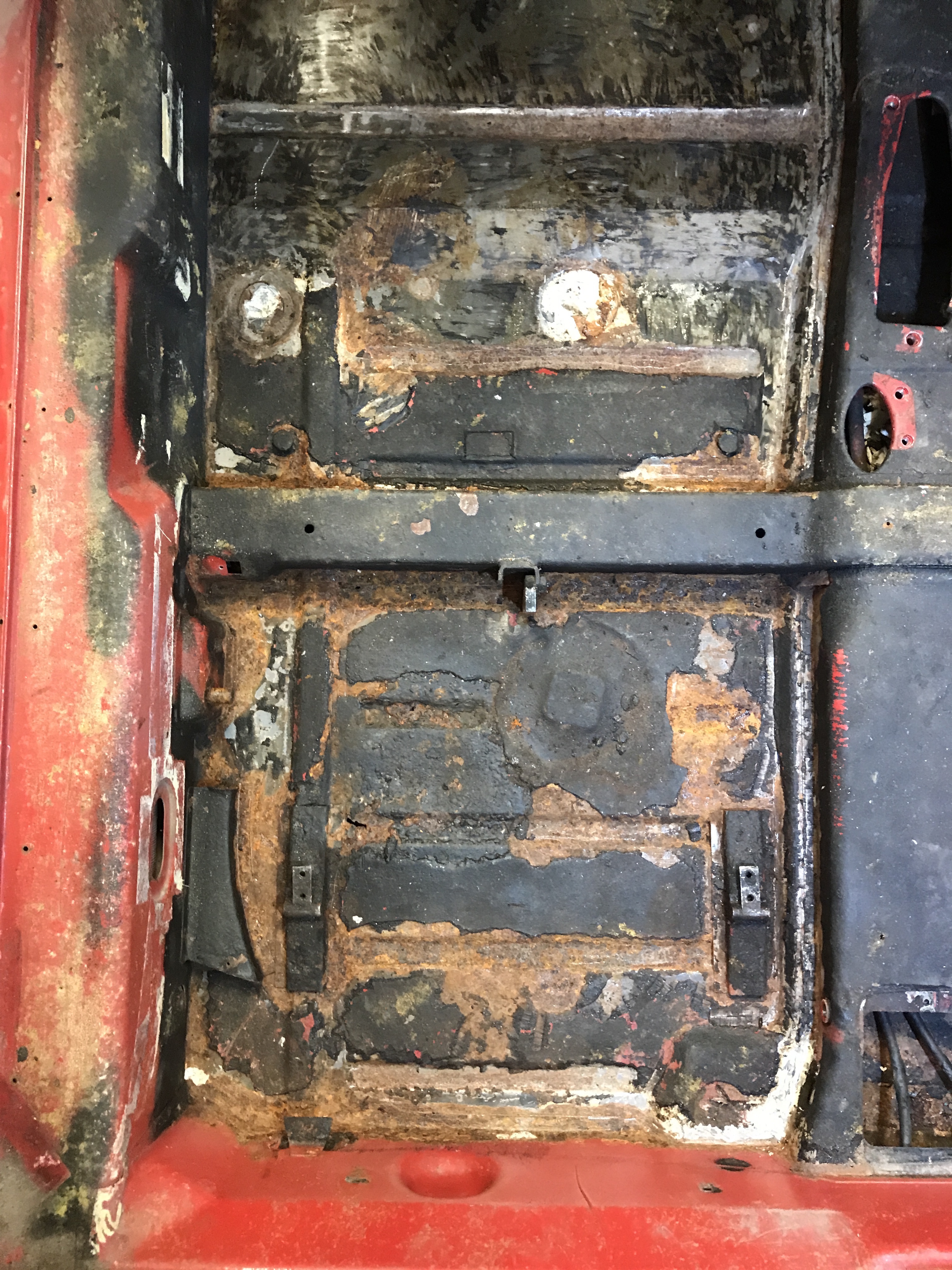

post Jan 25 2020, 10:28 PM
Posts: 787
Joined: 16-October 15
From: Riverside
Member No.: 19,266

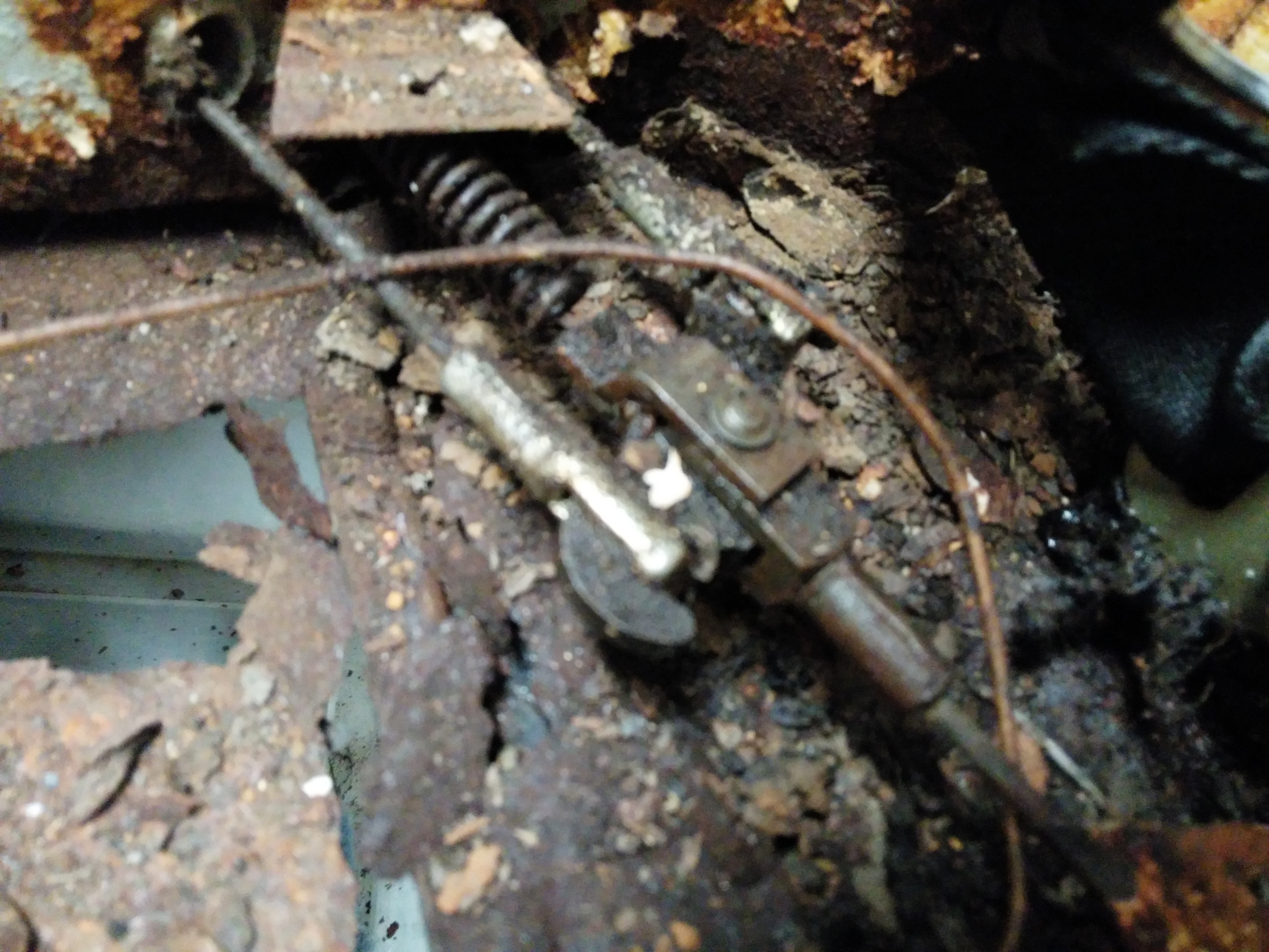

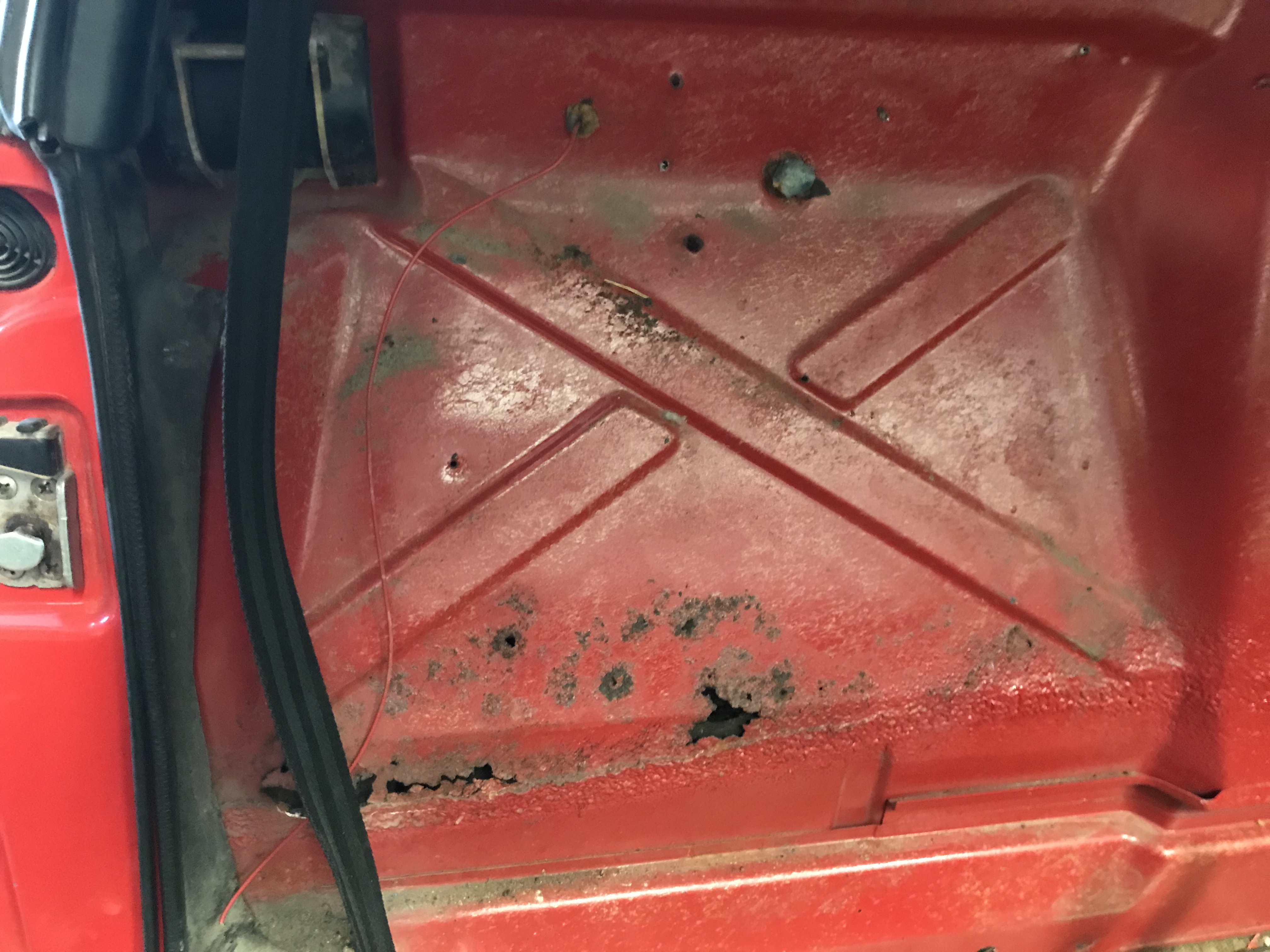

Under the brake cable
djway
post Jan 25 2020, 10:31 PM
Posts: 787
From: Riverside
Member No.: 19,266
under passenger seat
