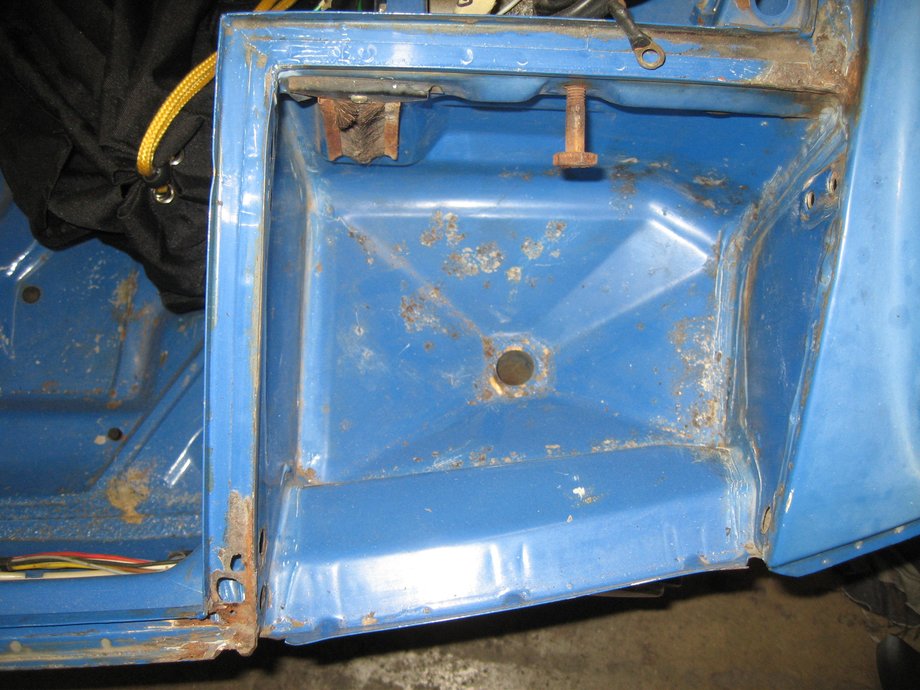

bkrantz
From my 1973 2.0 project.

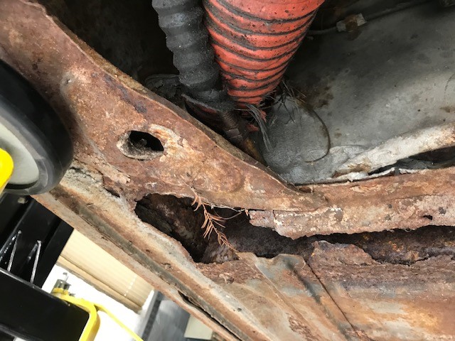

Superhawk996

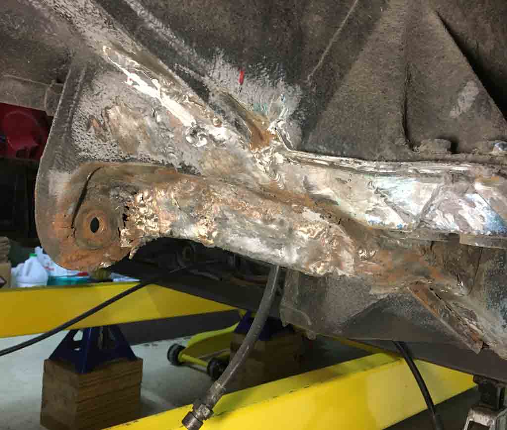

Don't forget the tunnel area. It often get's overlooked. Pinholes on the outside underbody are usually a sign of much worse rust penetrating from the inside out.

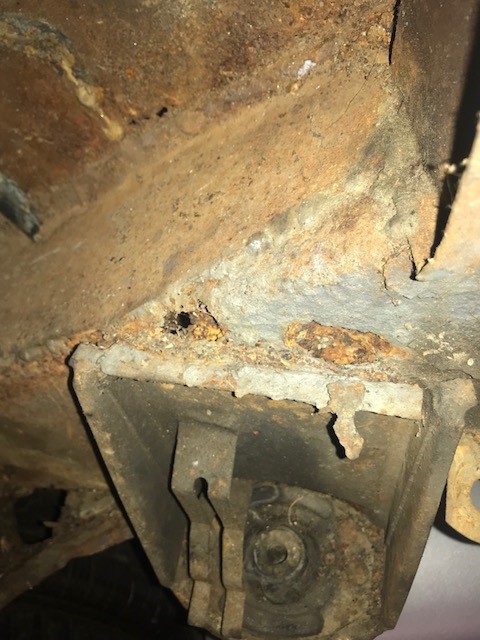

Suspension consoles.
Passenger side is usually the 1st to go.
In this case my driver side has some stress cracking that also leads to rust on the consoles flanges that pick up the semi-trailing arm.

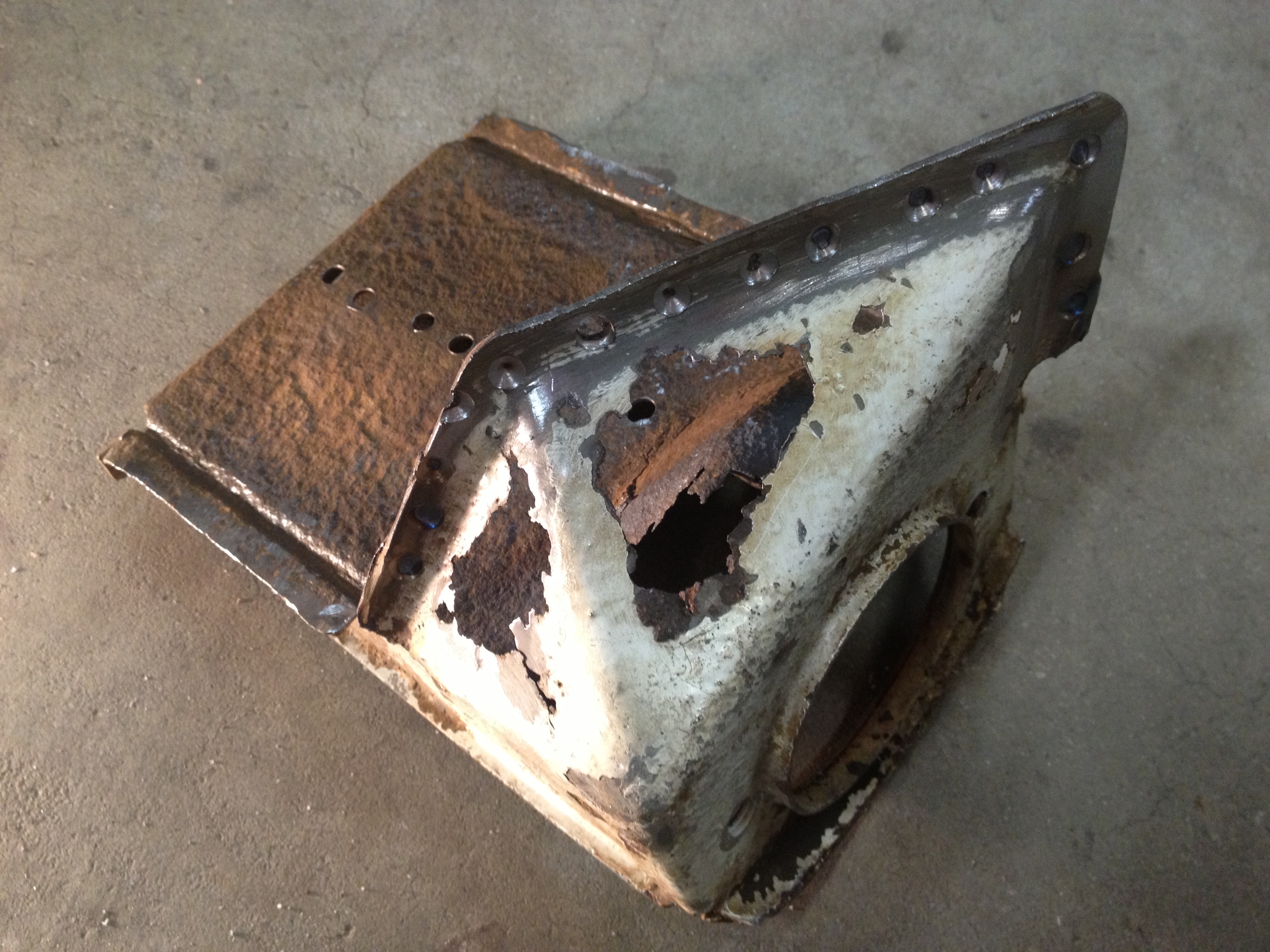

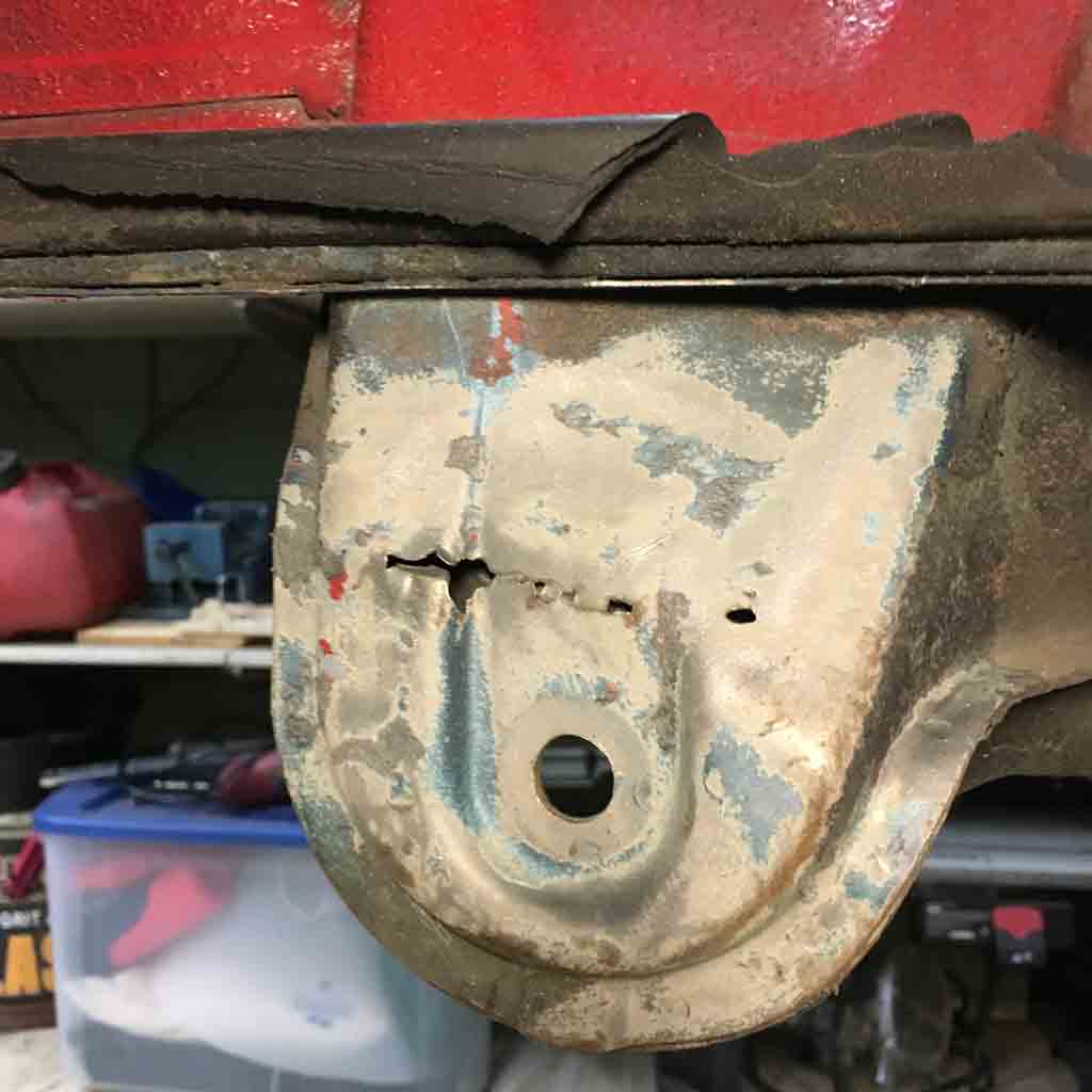

nathanxnathan
These are often a problem, passenger side especially
IPB Image

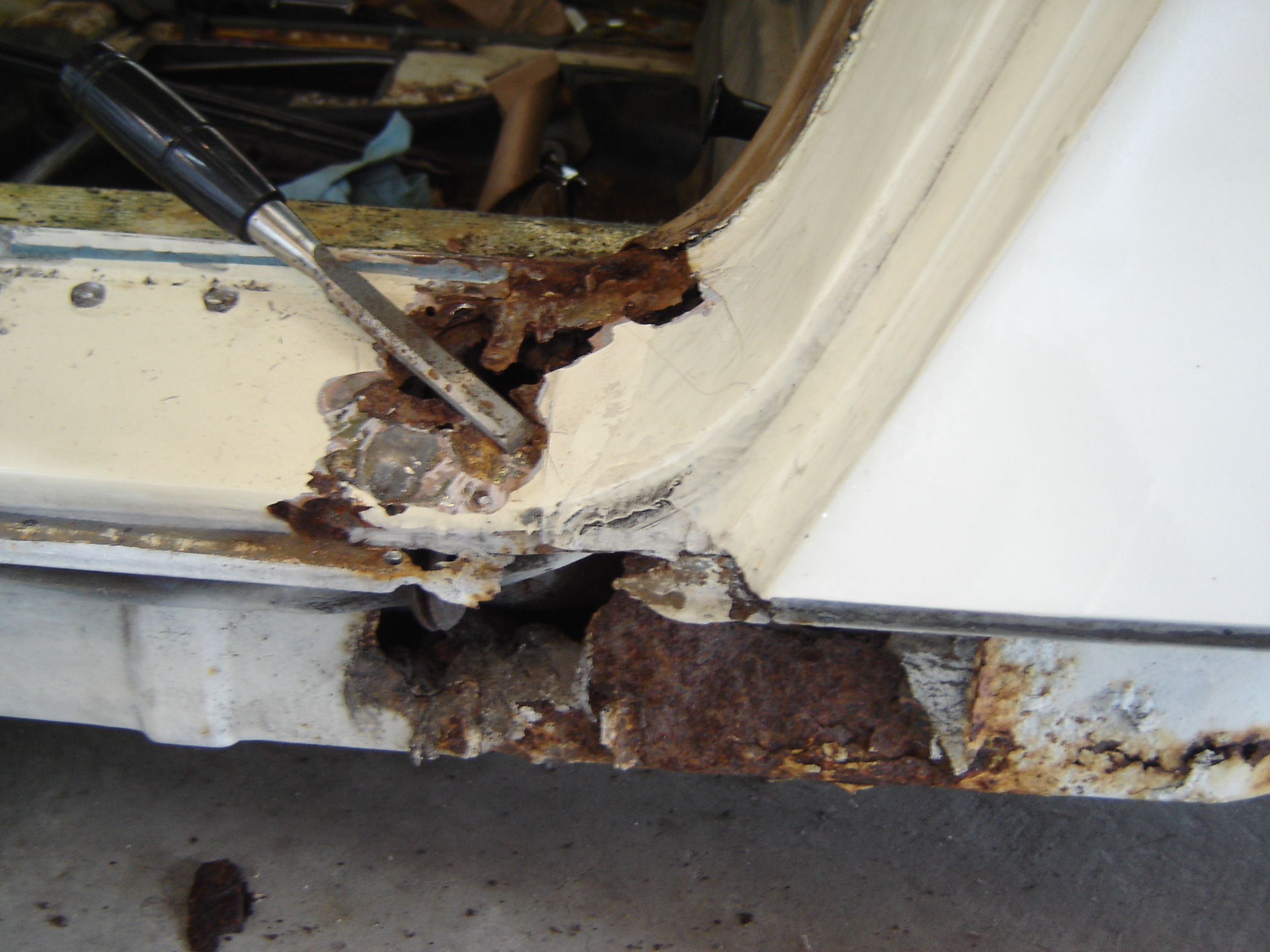

Always rusting from inside out. A little blemish in mine, a screw driver went right through.

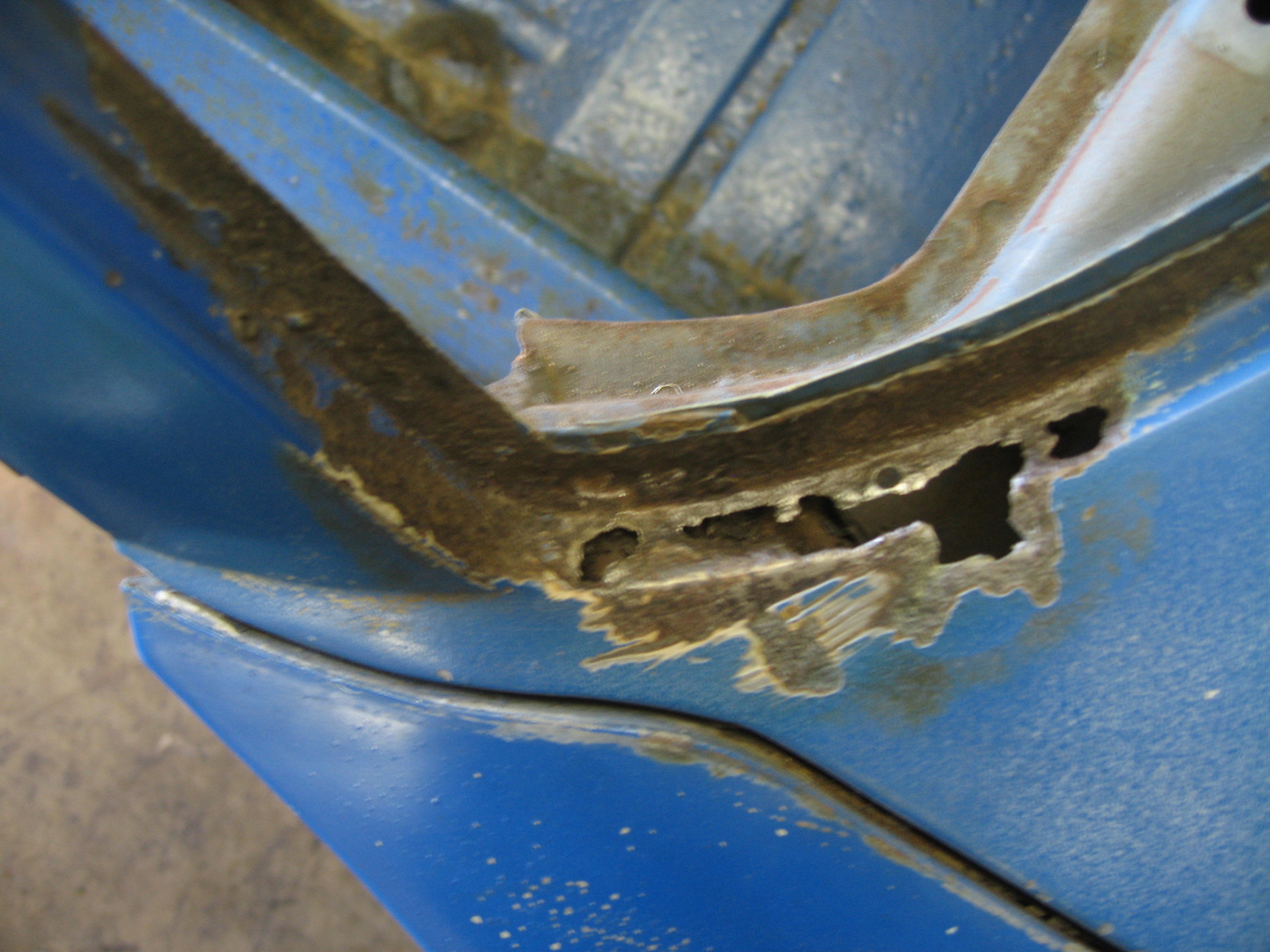

shot of this same one inside, not terrible but very thin at the bottom, close to rusted through
