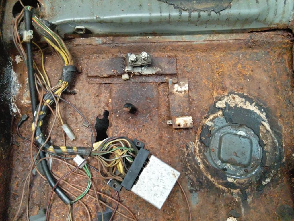

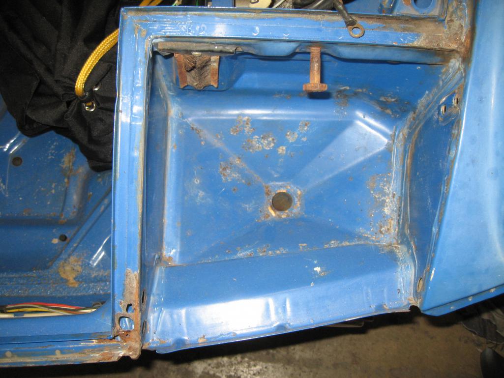

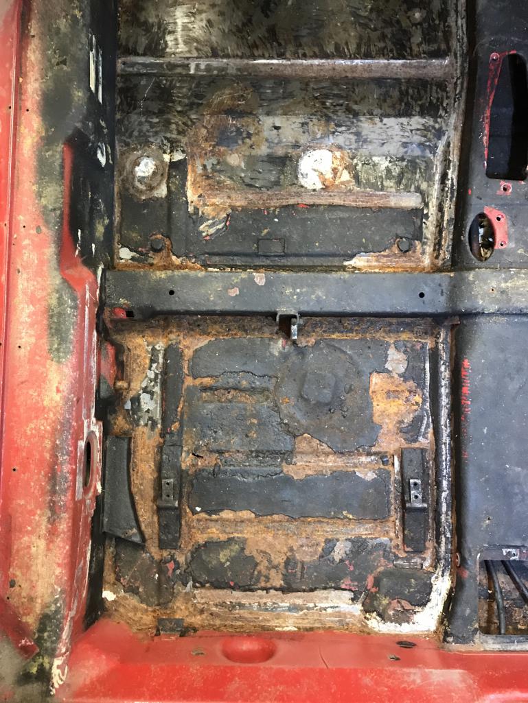

From my 1973 2.0 project.

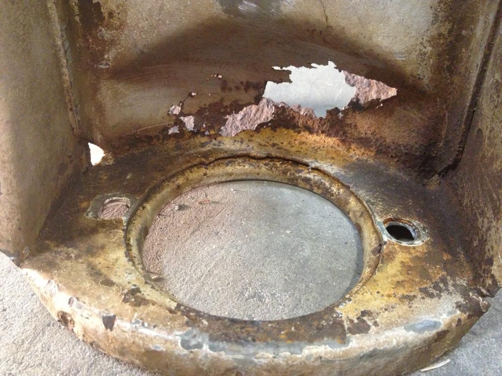

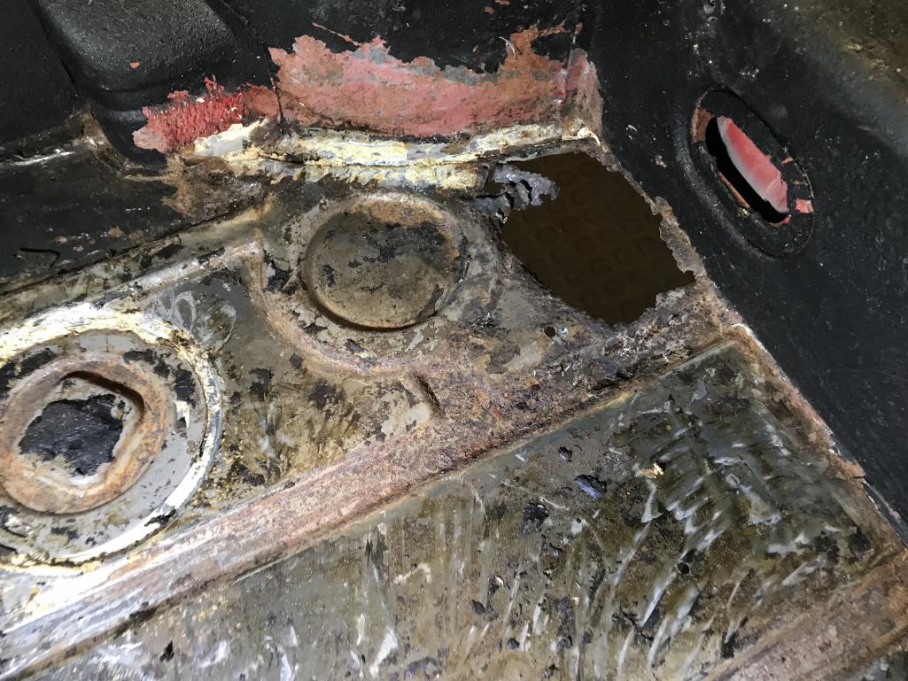

More

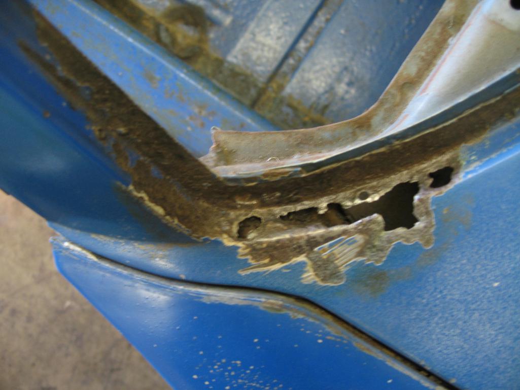

More

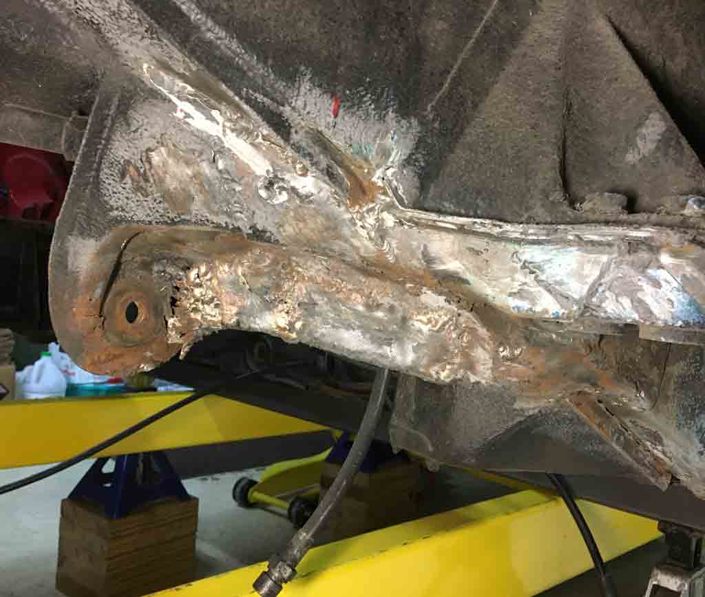

Superhawk996
post Jan 23 2020, 05:35 AM
Posts: 7,779
Joined: 25-August 18
From: Woods of N. Idaho
Member No.: 22,428

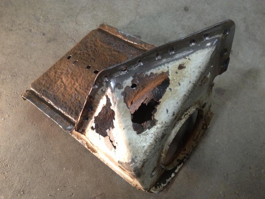

Lot's of rust pics here. (IMG:style_emoticons/default/dry.gif)

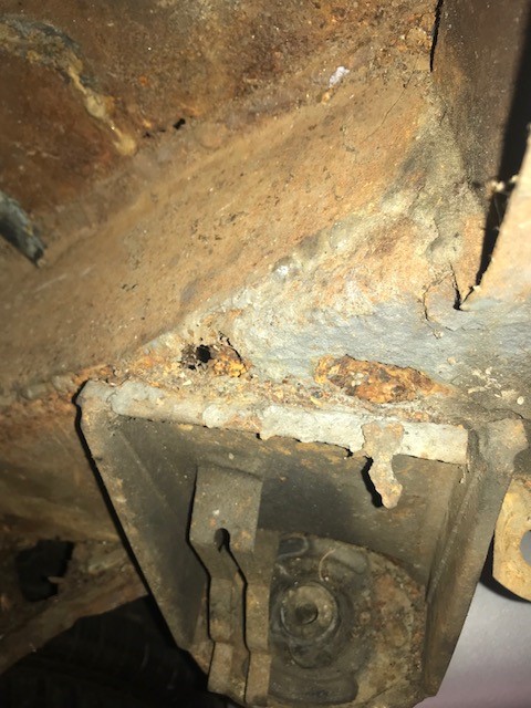

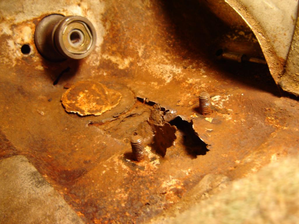

Don't forget the tunnel area. It often get's overlooked. Pinholes on the outside underbody are usually a sign of much worse rust penetrating from the inside out.
Suspension consoles.
Passenger side is usually the 1st to go.
In this case my driver side has some stress cracking that also leads to rust on the consoles flanges that pick up the semi-trailing arm.

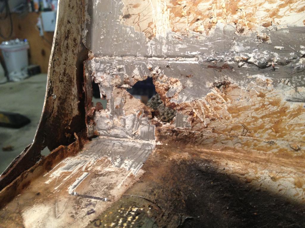

Can't seem to lay my hands on it quickly but have pics of rust at base of rear bulkhead that penetrate both inner and outer sheetmetal if no one else posts them.

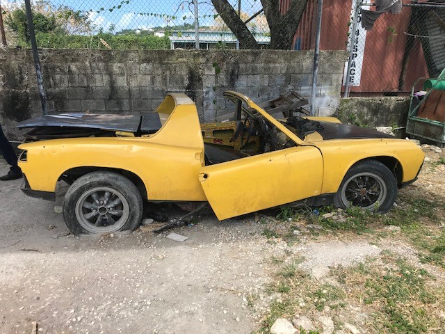

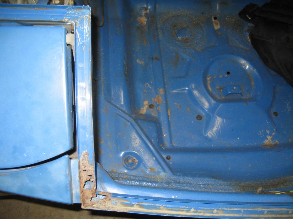

Found this in Jamaica
This is my car. Had I only known what I was getting into.....
Hope this helps. Appreciate you doing the videos. I've benefitted from other videos you've done so Thanks!

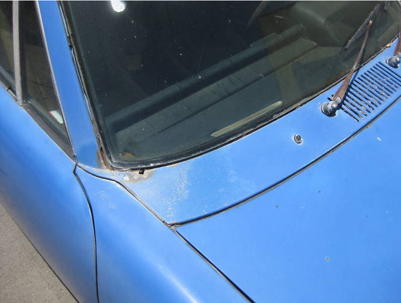

Cowl rust that you can see

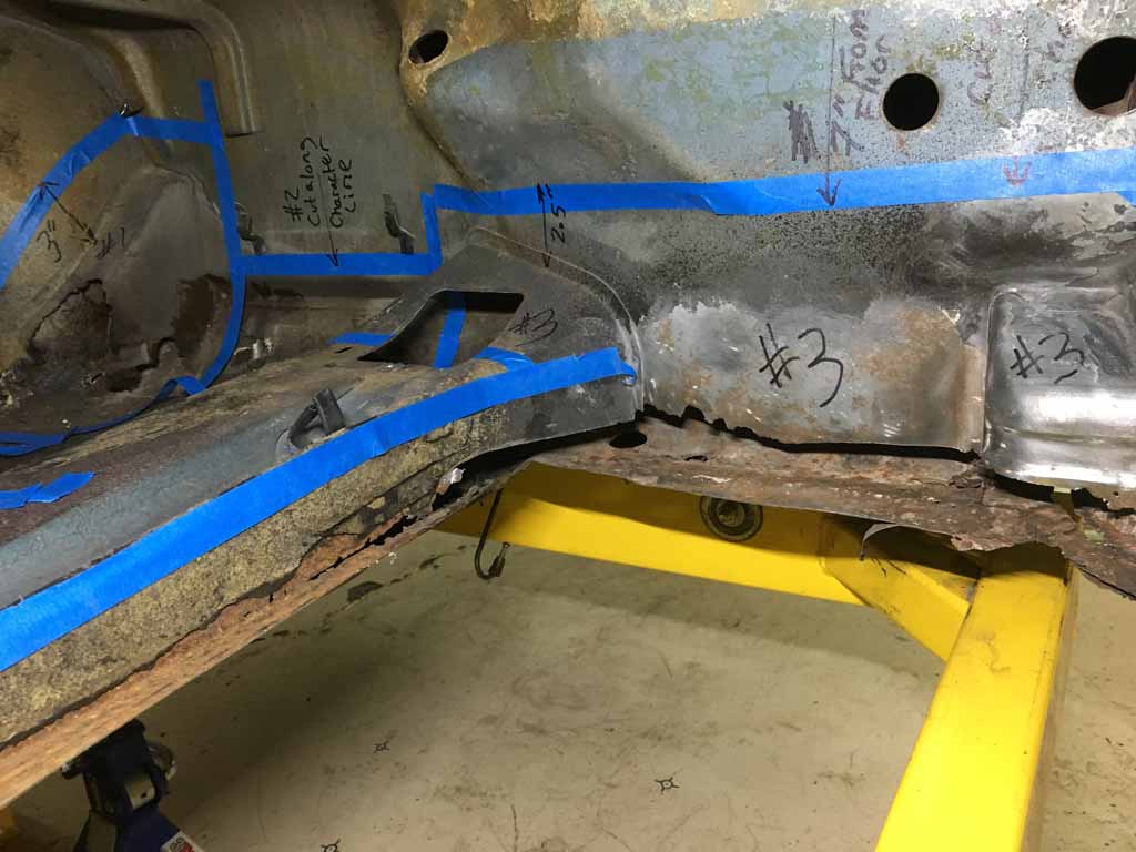

And once I got into it

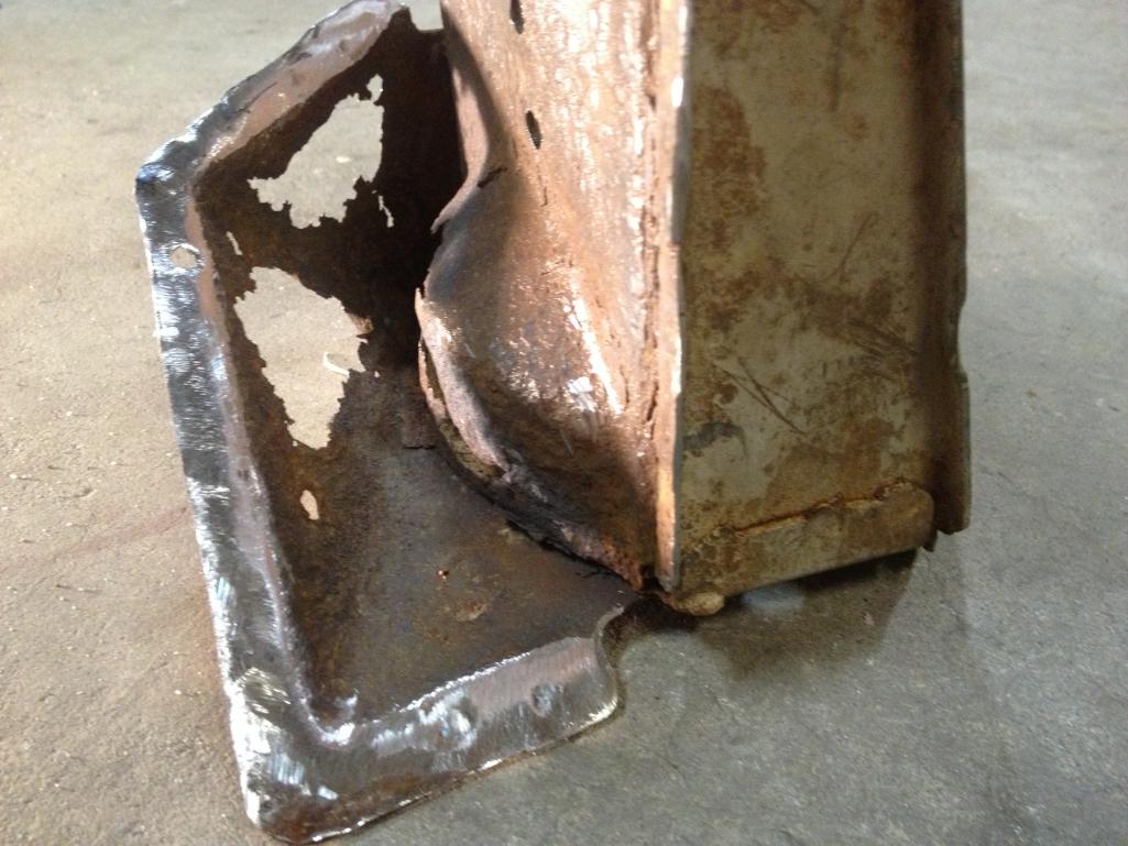

You don't hear rusty motor mounts talked about that much.
TargaToy
post Jan 23 2020, 03:27 PM
-NONSOLIS RADIOS SEDIOUIS FULMINA MITTO-
Posts: 714
Joined: 26-March 10
From: DelMarVa Peninsula
Member No.: 11,509

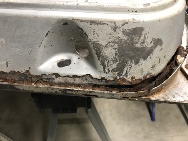

nathanxnathan
post Jan 23 2020, 04:31 PM
Posts: 294
Joined: 16-February 18
From: Laguna Beach, CA
Member No.: 21,899

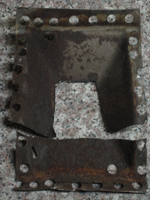

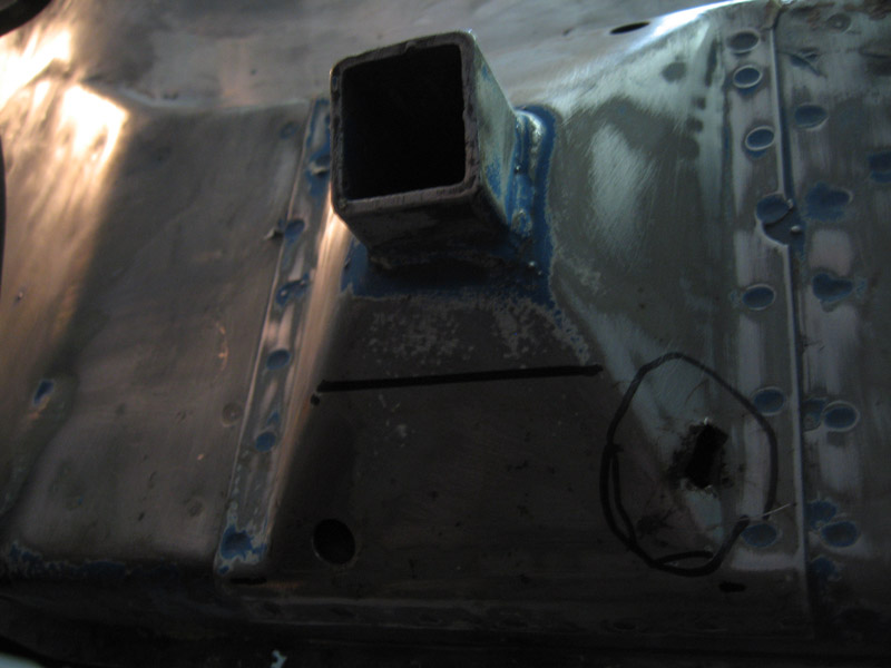

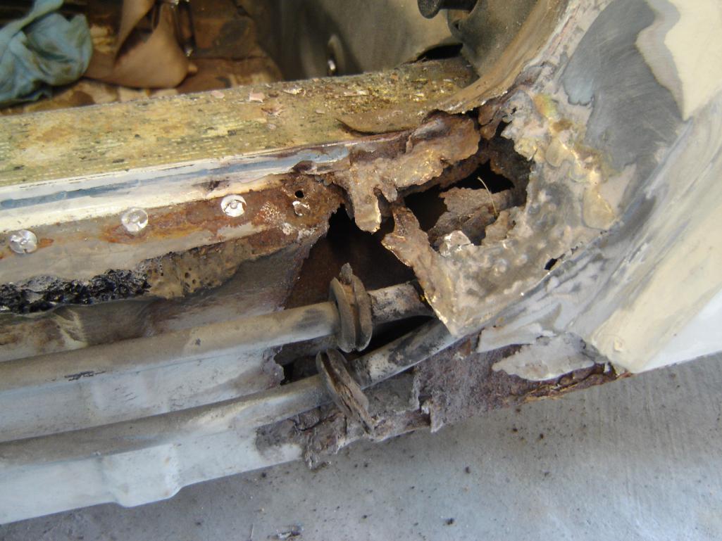

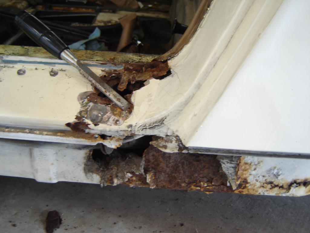

These are often a problem, passenger side especially
(IMG:http://www.914world.com/bbs2/uploads/post-7199-1223520815.jpg)
Always rusting from inside out. A little blemish in mine, a screw driver went right through.
shot of this same one inside, not terrible but very thin at the bottom, close to rusted through
bkrantz
post Jan 24 2020, 10:53 PM
Posts: 8,653
Joined: 3-August 19
From: SW Colorado
Member No.: 23,343
QUOTE(TargaToy @ Jan 23 2020, 12:11 PM) *
This is fun!
In a sick sorta way.
