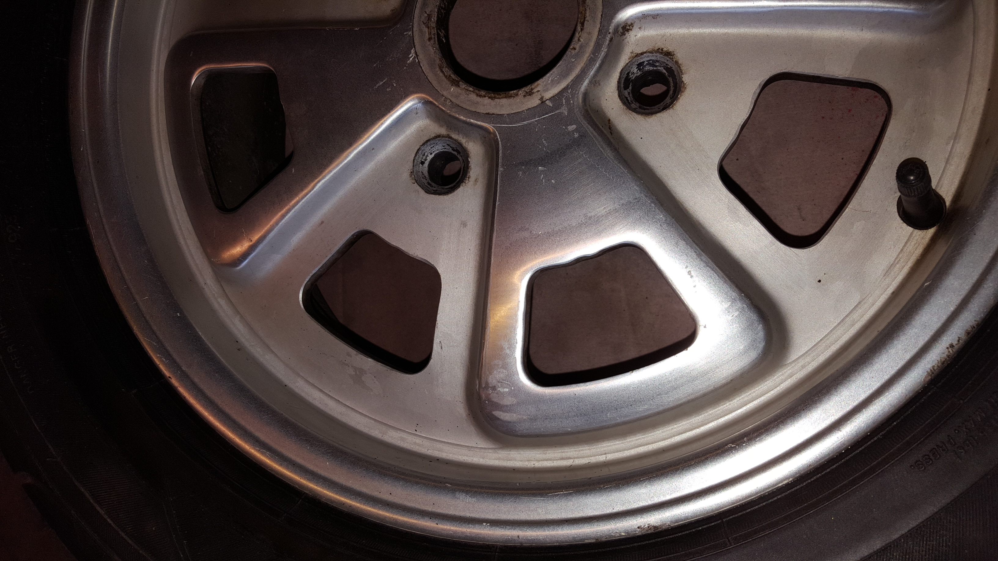

Is there a finish on the wheels that gives the satin or polished finish
I expected it to be either polished or non polished alloy but it appears to have been broken through in places Attached Image Attached Image
bdstone914
post Feb 9 2020, 05:42 AM
bdstone914
Posts: 5,280
Joined: 8-November 03
From: Riverside CA
Member No.: 1,319
They are anodized. The pedals ate polished and the recessed areas satin.

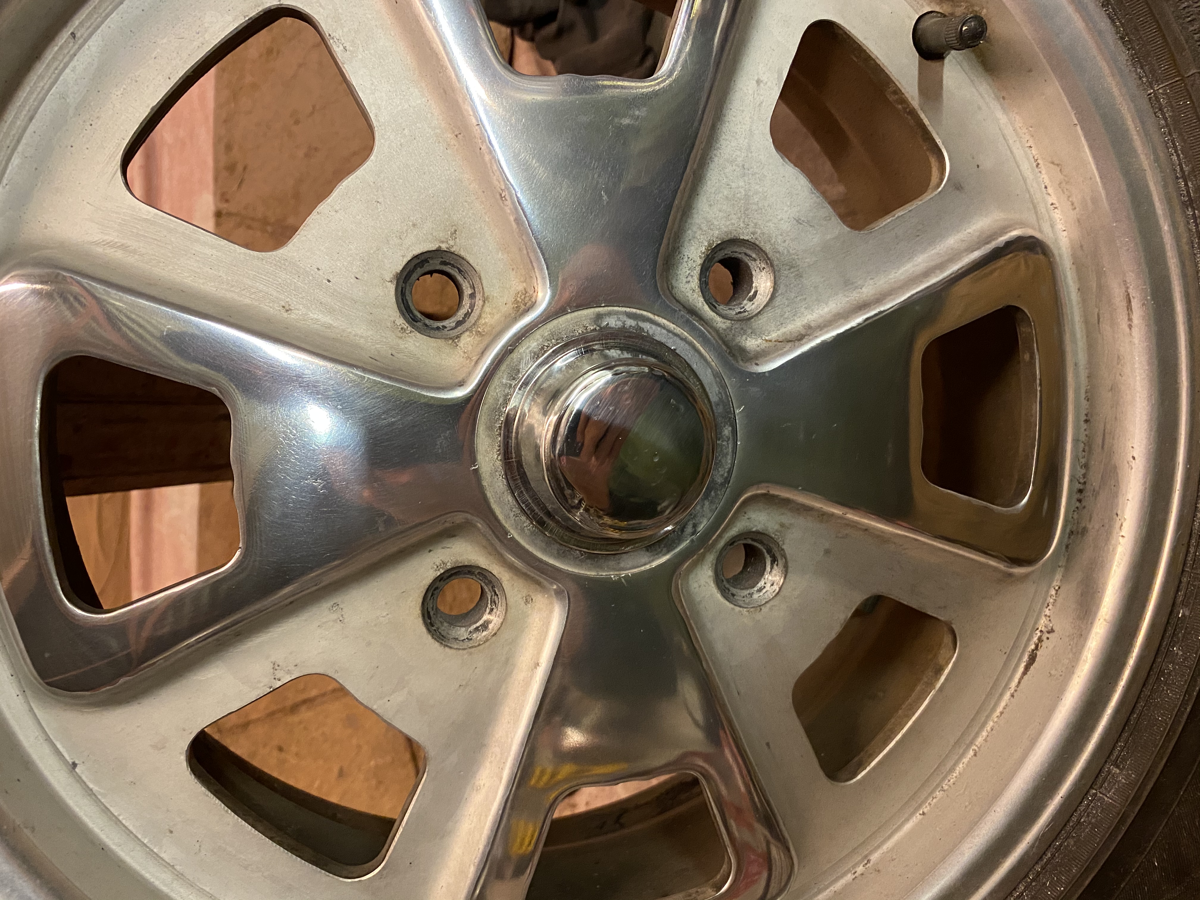

Thought I would give polishing the petals a goAttached Image

TargaToy
post Feb 12 2020, 01:19 PM
-NONSOLIS RADIOS SEDIOUIS FULMINA MITTO-
Posts: 714
Joined: 26-March 10
From: DelMarVa Peninsula
Member No.: 11,509
QUOTE(dt4 @ Feb 12 2020, 01:59 PM) *
That looks nice. What was your procedure?
Will you attempt to seal the "new" fiinish or just stay on top of polishing it?
dt4
post Feb 12 2020, 02:27 PM
Posts: 503
Joined: 26-May 19
From: England
Member No.: 23,161
Region Association: England
I used a 200 grit sanding pad on a 3" airsander to remove the anodising and the scuff marks etc... then went upto 600 then 1000 then 2000 then polished with a mopping pad and autosol metal polish
I had to planish the centre cap to get it reasonably flat first as it was pretty beat up ten sanded it flat before polishing

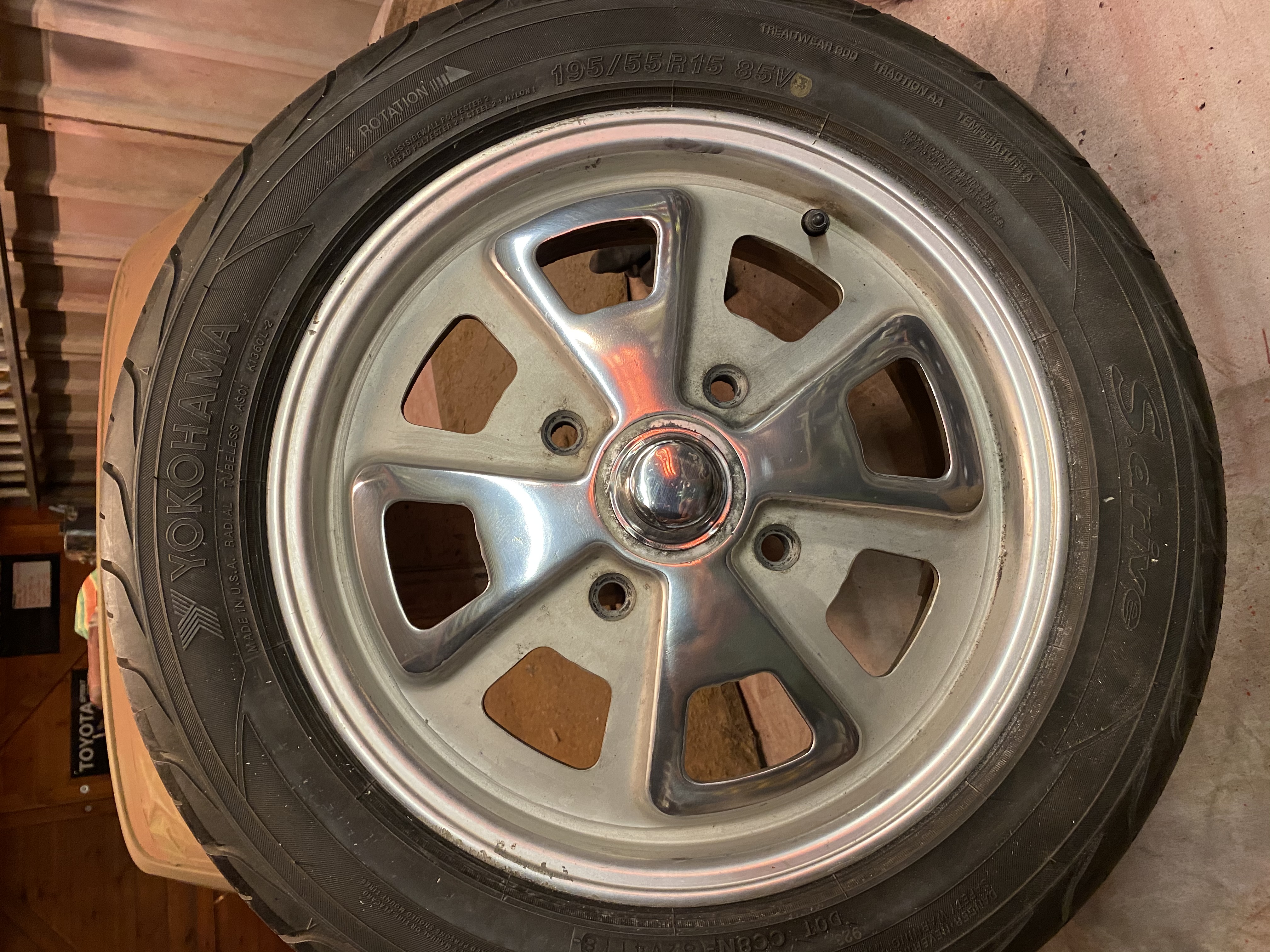

A bit of planishing, sanding and polishing laterAttached Image Attached Image
