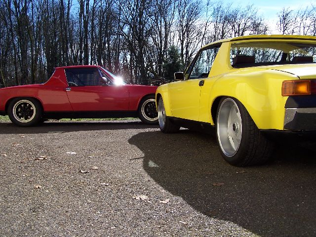

JLO with 325X45x12X17 and the red car is the V8.

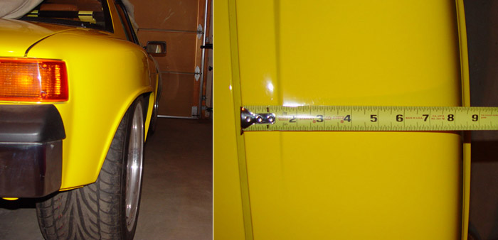

Well, I always have to jump in on the big butt posts.
Front: 205/40 ZR17's (no flares)
Rear: 275/40 ZR17's (steel flares)

Mountain-
Any more pics? Are those custom made flares? Looks great!!

QUOTE(jdogg @ Dec 10 2004, 07:26 AM)
Mountain-
Quite a few pics at my home page
http://members.rennlist.com/mountain914
Yes, custom flares.
Thank you !!

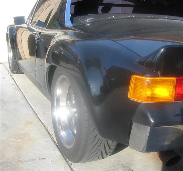

QUOTE(scooter311 @ Dec 9 2004, 07:59 AM)
I have flares and 7 inch cookies with 225/50s and they appear to sit way out, but still don't fill the space right (to me at least) and they're spaced out 1/4 inch.
GT flares, 7" cookies with 225/50 tires and 1 1/2" spacers in the back ...
the flare lip is shaved and i can't put a finger between the flare and the tire, but no rubbing.
(IMG:http://www.sirandy.com/pix/914/2003.10.01/15.JPG)

Heya Andy, where did you get the spacers, and how much $$?
Ooo yeah, your spoiler - do tell, it doesn't hang over the trunk sides, therefore eliminating 'those unsightly scuff marks' on your quarterpanel tops, like the ones I have on mine, that I noticed shortly after my repaint.(IMG:style_emoticons/default/cool.gif)

QUOTE(scooter311 @ Dec 10 2004, 12:19 PM)
i believe that was performance products ...
they are the bolt on type (5 on 5, no adapters) and they come in different thickness.
1 1/2" works perfect in the rear for the 7" cookies.
in the front, i used a 1" spacer (also bolt on) plus a 1/4" thin spacer, so 1 1/4" total in the front.
i run 225/50 on 7" cookies all around.
as for the spoiler, you said it already, cut in the middle and re-glassed.
much nicer than the "hanging over the fender and scratch it up bad" types ...
