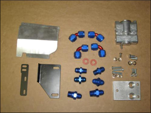

You could leave them off buy you'd need to block the area where the oil cooler flap goes down. Chris Foley replaces that with an aluminum panel when the flaps are removed for his oil cooloer kit. It's the panel in the upper left in the below photo.

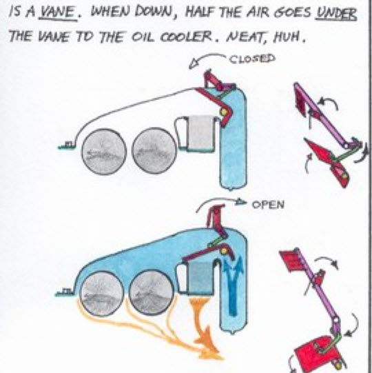

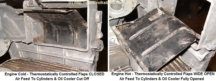

Here's some info: YES you need the flaps !

QUOTE(barefoot @ Feb 26 2020, 07:41 PM) *
Barefoot,
Thanks. That is a great illustration of the flap positions and how the air is directed to the oil cooler when the engine is hot, or when the flaps are in the default open position. I agree this was often misunderstood, and continues to be.
