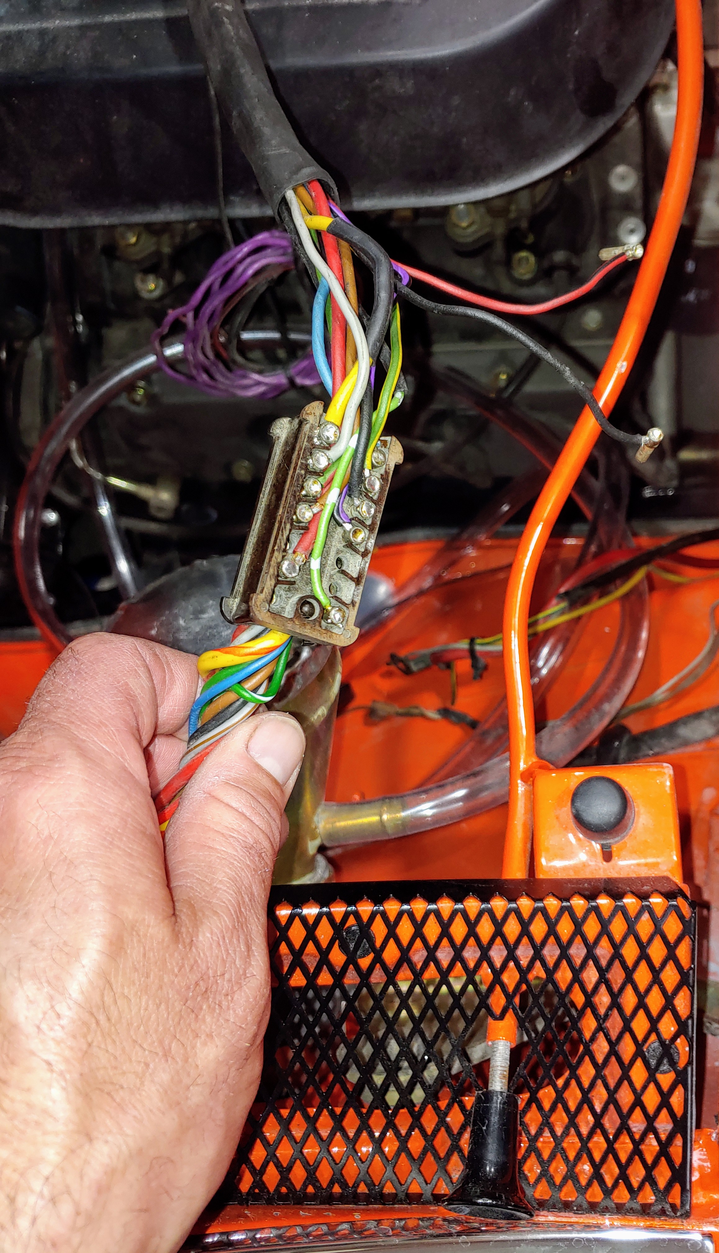

I have 90% of the harness connections made.. My biggest issue is that I am not 100% sure where the voltage regulator wires in.. Should the blue DF wire go to the regulator from the engine go to the regulator then back to the main harness? What about the black wire from the alternator? I believe that hooks onto the brush pack on the back of the alternator but does that directly hook into main harness plug?
I have everything else figured out.. Attached Image
mb911
post Apr 13 2020, 01:43 PM
Posts: 7,729
Joined: 2-January 09
From: Burlington wi
Member No.: 9,892
Looks like the DF wire is actually the black wire.. So does the blue wire make a side track to the regulator as well?

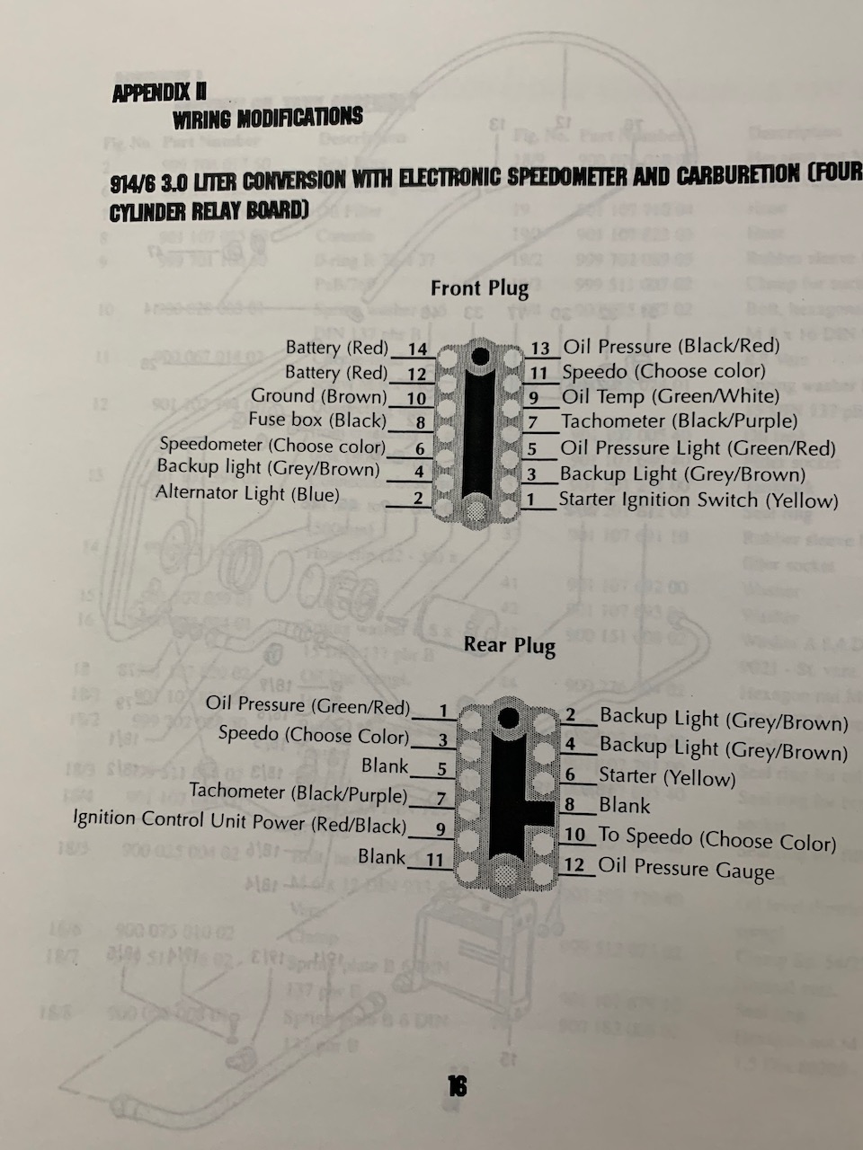

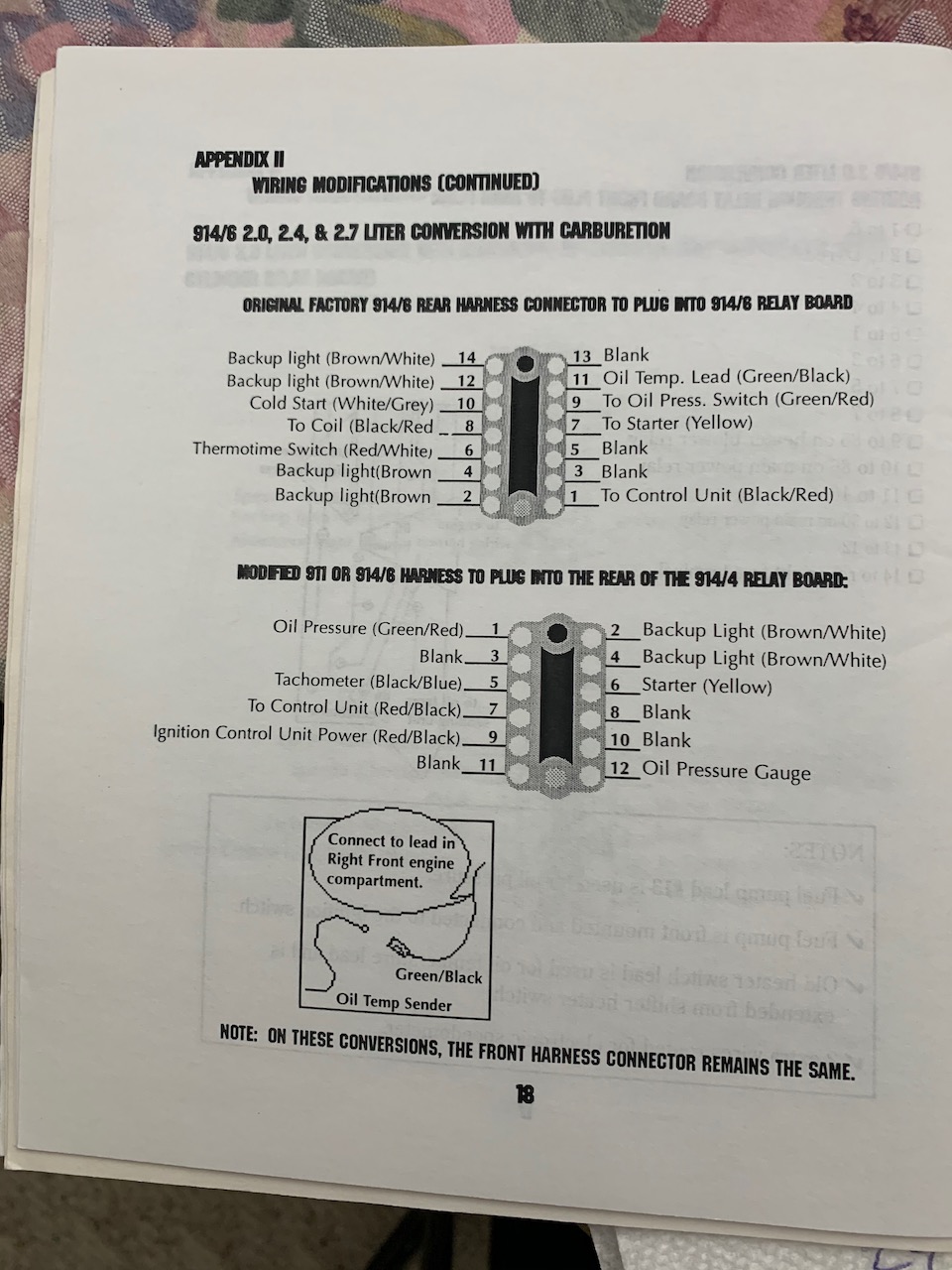

post Apr 13 2020, 03:20 PM
Posts: 3,899
Joined: 24-July 04
From: Dayton, Ohio
Member No.: 2,388
And the other two pages of wiring reference.

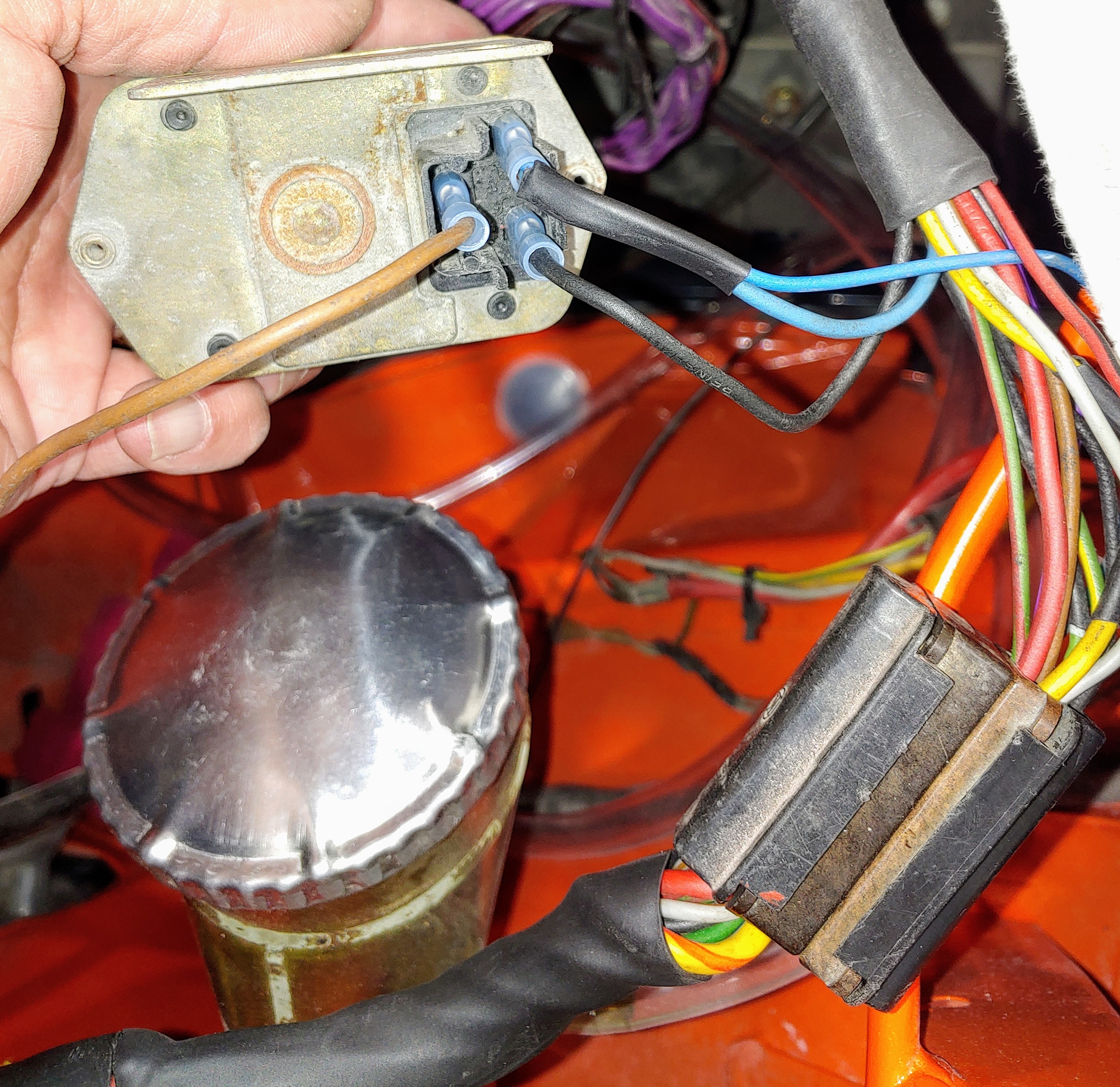

mb911
post Apr 13 2020, 03:43 PM
Posts: 7,729
From: Burlington wi
Member No.: 9,892
Thanks.. Now keep in mind not using the relay board.. I checked the wiring diagrams and believe this is correct.. I temped in the regulatorAttached Image

IronHillRestorations
post Apr 13 2020, 05:28 PM
I. I. R. C.
Posts: 6,926
Joined: 18-March 03
From: West TN
Member No.: 439
The blue charge light wire goes to D+
mb911
post Apr 13 2020, 05:41 PM
Posts: 7,729
From: Burlington wi
Member No.: 9,892
Thats how I have it wired.. Thanks

QUOTE(mb911 @ Apr 13 2020, 12:57 PM) *
Clay its a 73 engine with a fresh SEV Marchal alternator
Hope you are not using a Bosch voltage regulator with that SEV Marchal alternator. It's a mismatch big time and you'll not have enough voltage at the battery.
