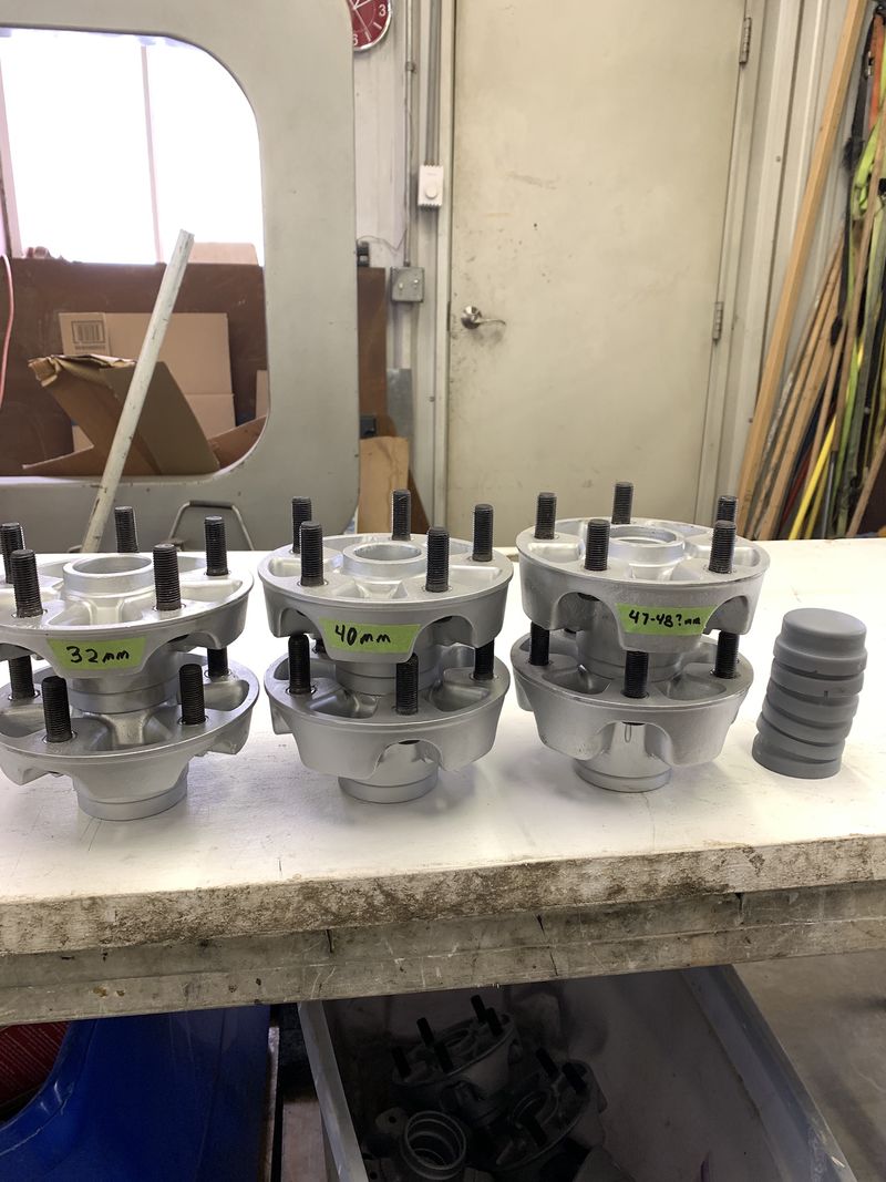

I have a set of early 3" 911T front struts that I need to get hubs for.. is there any chance that a set from a 911S (991 version) would work ? I found a smoking deal on 'em..
narrow body car if that matters, cookie cutter or deep six replicas being considered. TIA.

But didn't the original 914/6 use 32mm hubs and vented rotors?

I have 911T struts which BTW are the actual 914/6 strut part number, 40mm hubs, 914/6 rotors and I'm using Alfa calipers.
All bolt on, no funky shims etc.

You want 40mm, but there are early and late on those as well. Early has a smaller center and takes a grease cap that goes over the center. Later is hub-centric and uses a grease cap that is pressed into the center. They both take the same bearings.

All the info I have says the 914/6 had vented front rotors with 40mm hubs. Rear rotor were solid.
Brembo calipers that Mark has are similar to the 911S caliper except for the 3" mounts. The 911T & 911S calipers, 914/6 and Brembo all have 48mm pistons. But the 911S and Brembo have larger pads.

Well I'm wrong again, the hubs on my cookies teen are 47mm.
I'm going to have to measure the front hubs on my '74 with the fuchs but eyeballing through the rim I think it's also 47mm.
Fills out the wheel well real nice on a narrow body with 205/60-15 (Fuchs) or 205/55-15 cookies) tires.
