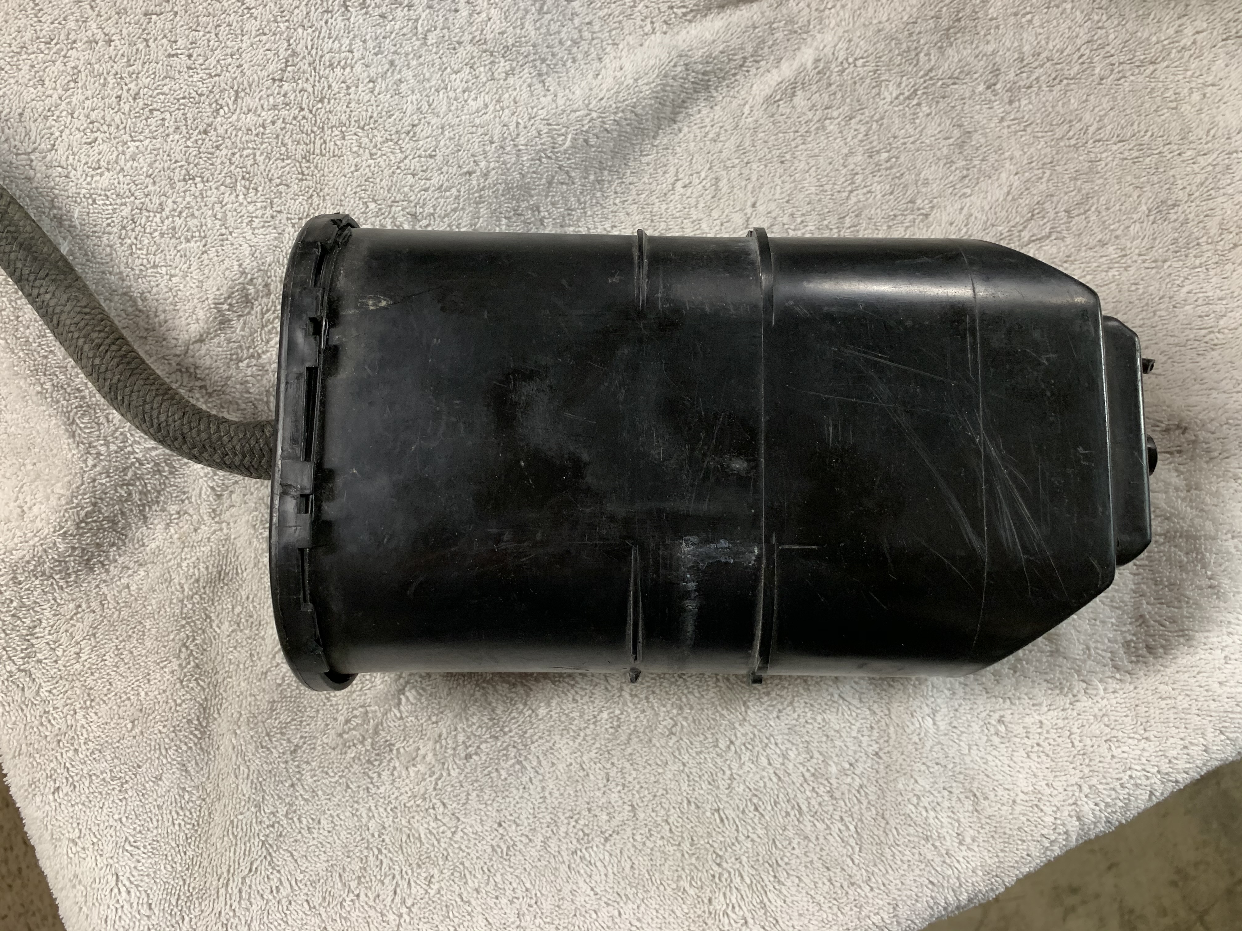

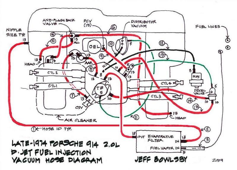

Jeff, Thanks for the diagram. I questioned the direction of flow through this plastic canister because it has the large nipples on each end and small nipples (fuel tank expansion chamber) on each end unlike the metal canister.
Also, how do you know when the charcoal pellets need to be replaced? Do they change color or smell?
Thanks-Rick Attached Image

If your canister has 2 small ports, check them carefully. Seems to me I have seen them like that but one is not a port its solid.
Function of the canister relies on intake airflow from the engine fan through the filter media, to the exit port back to the intake. Fuel vapors are just along fro the ride.

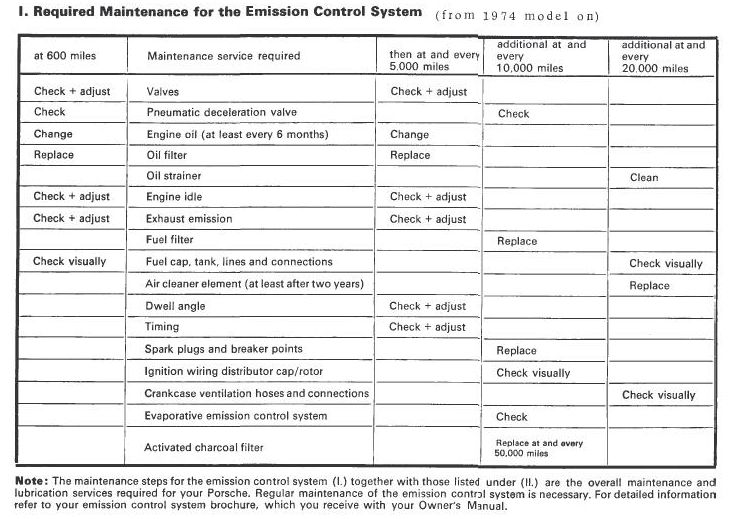

Factory says replace the charcoal every 50K miles.
