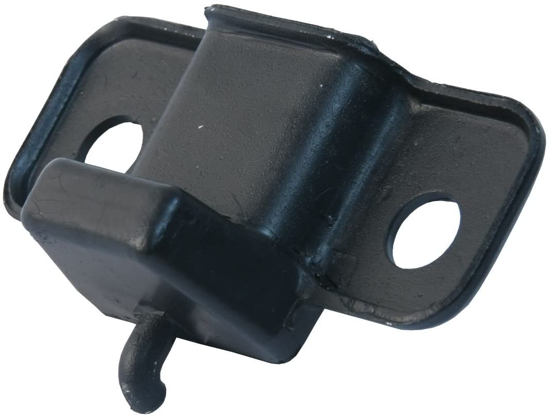

Likely the rear latch bumpers are dry & hard. Easy test is to undo the rear latches and listen.
jim_hoyland
post Apr 24 2020, 05:16 PM
Get that VIN ?
Posts: 10,041
Joined: 1-May 03
From: Sunset Beach, CA
Member No.: 643
Could those latch bumpers be replaced ?

QUOTE(jim_hoyland @ Apr 24 2020, 04:16 PM) *
uro makes some but they don't specify early or late.
URO Parts 91456303319 Targa Top Mounting Block, Rear Mounting BLock
