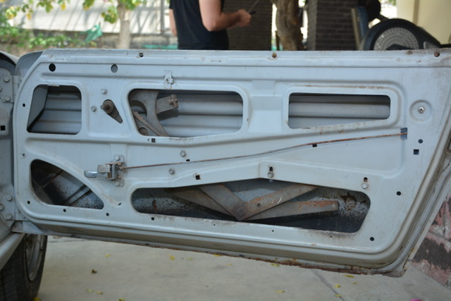

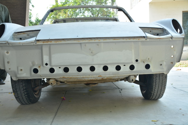

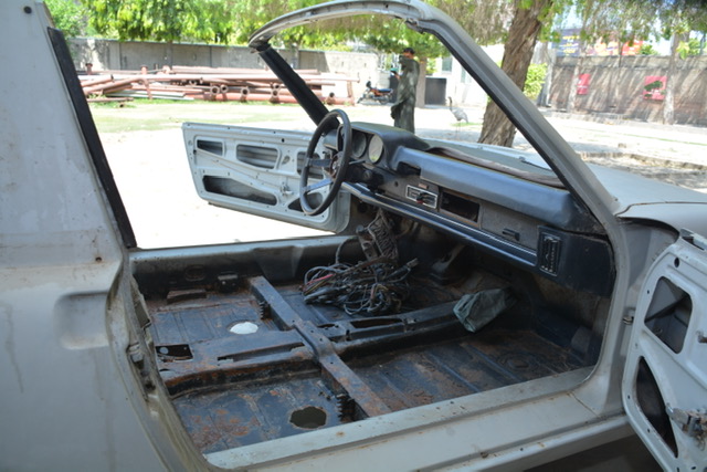

I feel as if I need everyone on here to give me input on the build I will start sharing the current pictures of the project. I will also share some inspirational images, videos, and features that have inspired me for now and later. (what is the best way to share lots of pictures in a post)

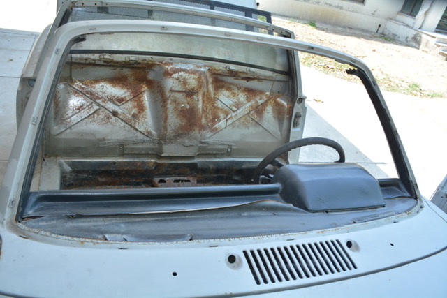

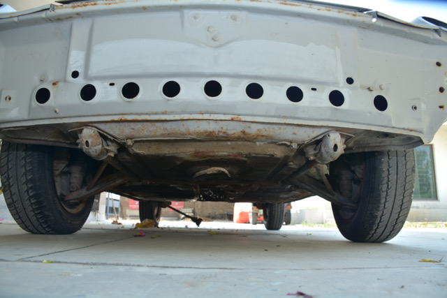

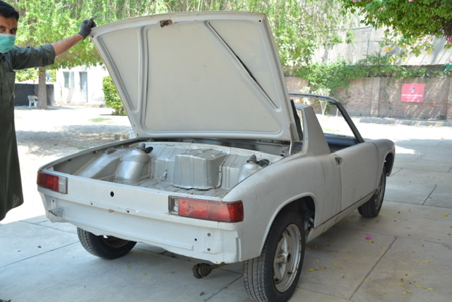

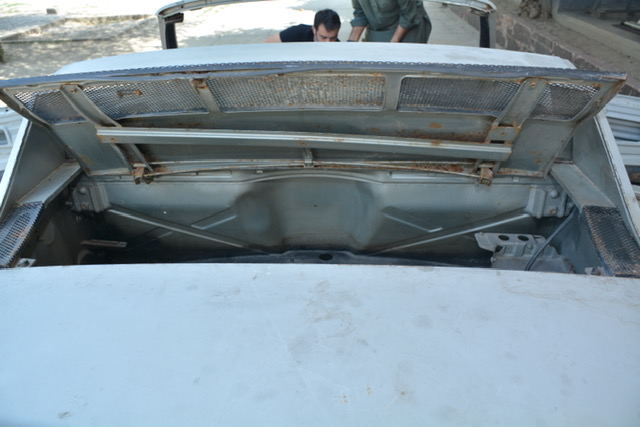

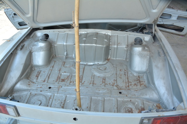

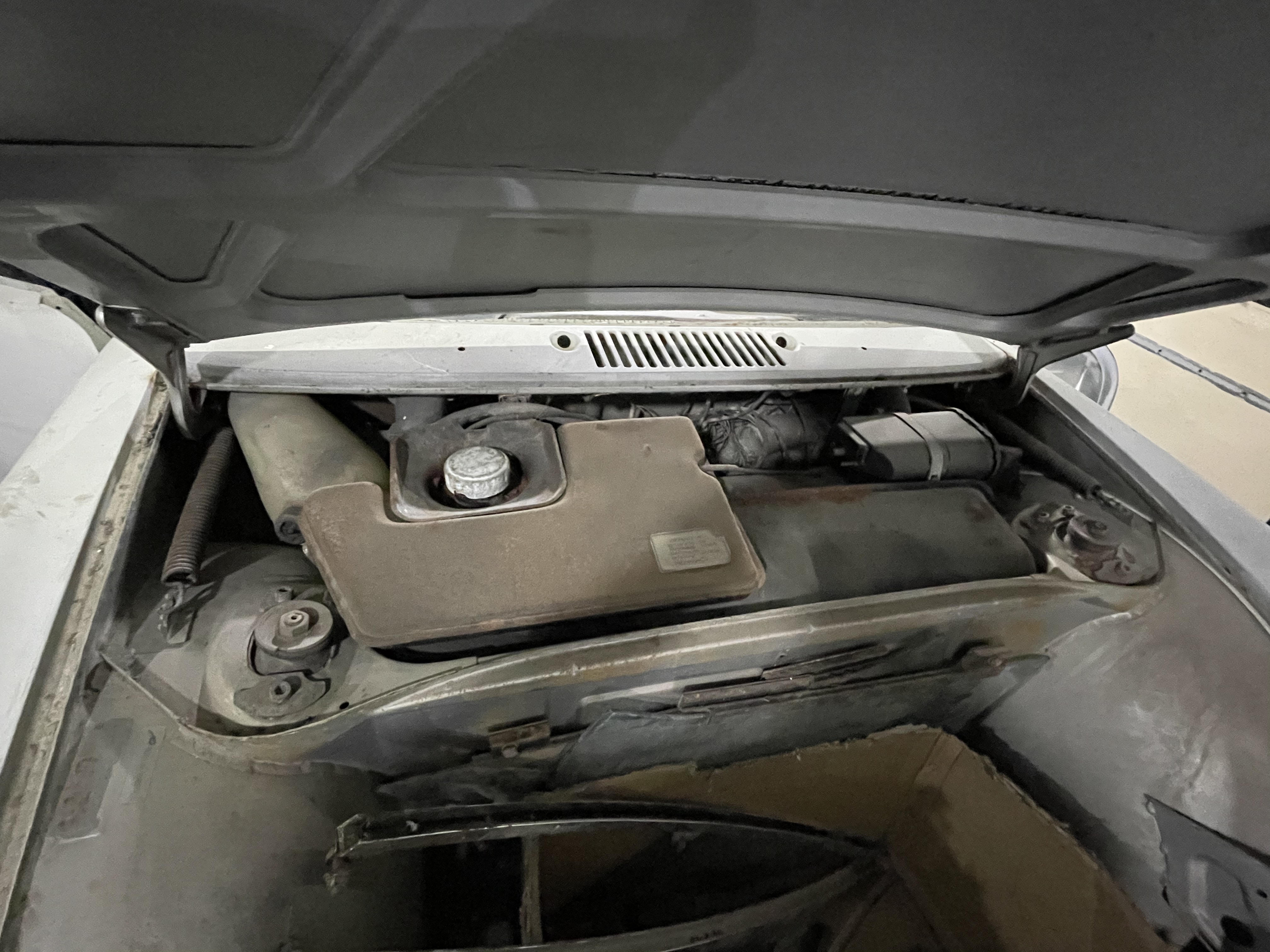

(IMG:style_emoticons/default/welcome.png) Hi Ali - After looking at the pictures you posted I agree you are starting with what appears to be a pretty solid chassis. So at least that puts you a little ahead of the curve. I believe the best thing for you to do is to get the chassis in good shape all around.
Inspect the chassis to make sure you have no rust-through issues to deal with. Make sure all of the suspension mounting point are solid. Get a friend or maybe 2 friends to stand in the interior on the floorboard of the car and with both doors open, see if the chassis flexes up and down. Be careful, start with one person and if that's looks good, add another. I am thinking maybe 225 pound is enough to test the rigidity of the chassis so you know if you are in good shape or not. You can also check the area of the floorboard where the pedals are attached as that is another rust spot. Look at the entire floor of the car for rust-through holes. Pull the rocker panel covers off, the long covers that are below the doors that have the jack post holes in them. Inspect that area for rust as it is the most prone to rust.
Of course check the engine compartment out looking specifically at the base of the firewall (the section between the engine and the passenger compartment) look along the bottom of that entire firewall for rust though as that is a typical problem. Then check the areas below the battery box on the right side of the car as you sit in the car, and then look on the left side too. Water tends to get trapped in those areas when the drain holes get plugged up.
Look in both the front and rear trunks for rust-through. The front trunk is going to be prone to rust all around the weather seal channel where the hood seals closed. Also another bad spot is the area of the brake fluid reservoir. In the rear trunk, in addition to the weather strip channel, check the trunk floor where it joins the rear panel in which the taillights are housed. That area where the rear panel and the trunk floor meet is a very common rust area. Of course when you are working in the rear trunk that would be the time to find a repair panel section for the area where someone has added a cover/box, maybe that is where they put the battery. Pull that off and see if the area is cut out or not. That is not a typical body modification that I have seen.
Another spot prone to rust on these is all around the windshield where it meets the cowl. The area where the windshield wipers are attached. Also along the sail panel (roll bar) where it joins the rear quarter panels and there is usually a piece of trim at the base. That and the area where the door handles recess is where you place your hand to open the door handle. Rust is common in that pillar and area.
Oh, yeah... one more place is the end of the quarter panel up high by the tail lights. Porsche packed that area with foam and it absorbs water and causes rust. That foam should be romped and never reinstalled in my opinion.
Your chassis looked good in the pictures, but I always think the most expensive and difficult part of restoring these cars is tackling the old chassis to make it safe, string and reliable for all the work that will come after the chassis is solid.

Why the odd boxed section it the rear trunk? Was it a V8 conversion?
Probably should move this thread to the Garage.

ndfrigi & Cairo94507 - plan on getting complete body work done in the coming weeks contemplating flares or narrow body. narrow body has grown on me quite a bit, but it took a long time do so. what are your thoughts on body type? saw some of the RD panels i might buy those if required. I am very ocd about the body work hence looking for the person in town. (will be posting more on this later)
Olympic 914 - some elders in the family had a go at brining it back on the road with some engine swap along time ago. i have gotten it dissasbmled since and plan to restore it back to its original form.

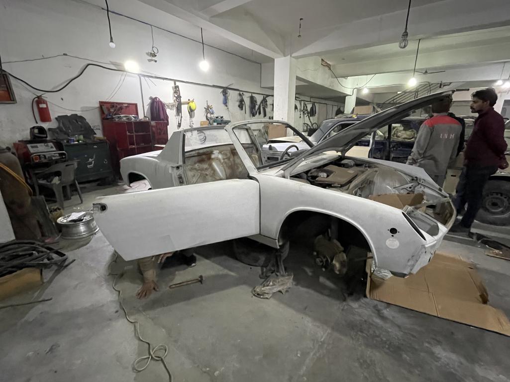

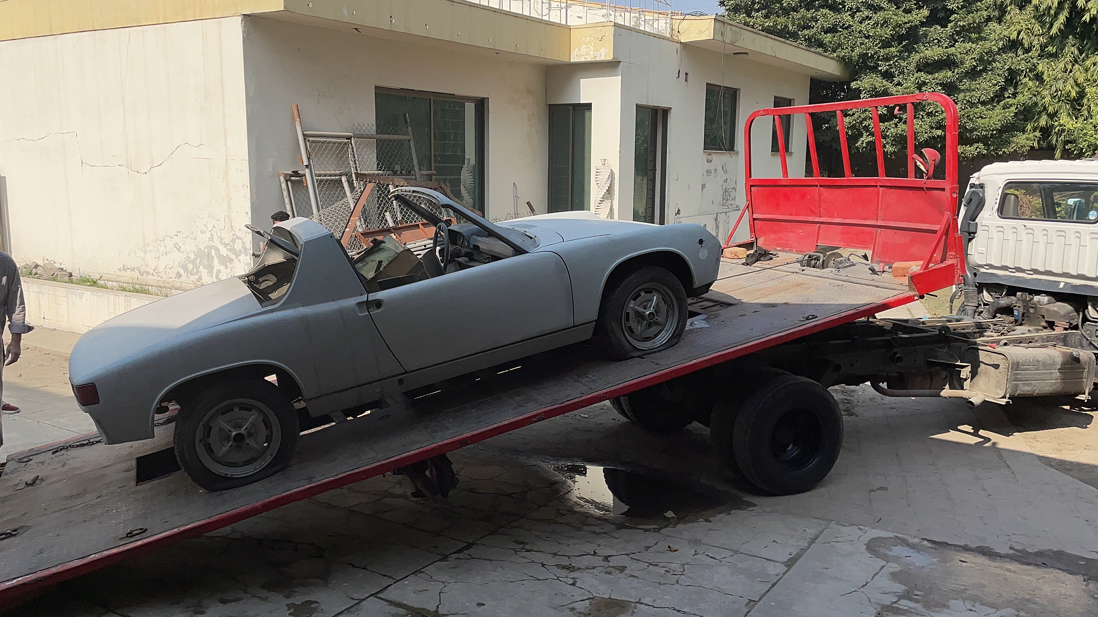

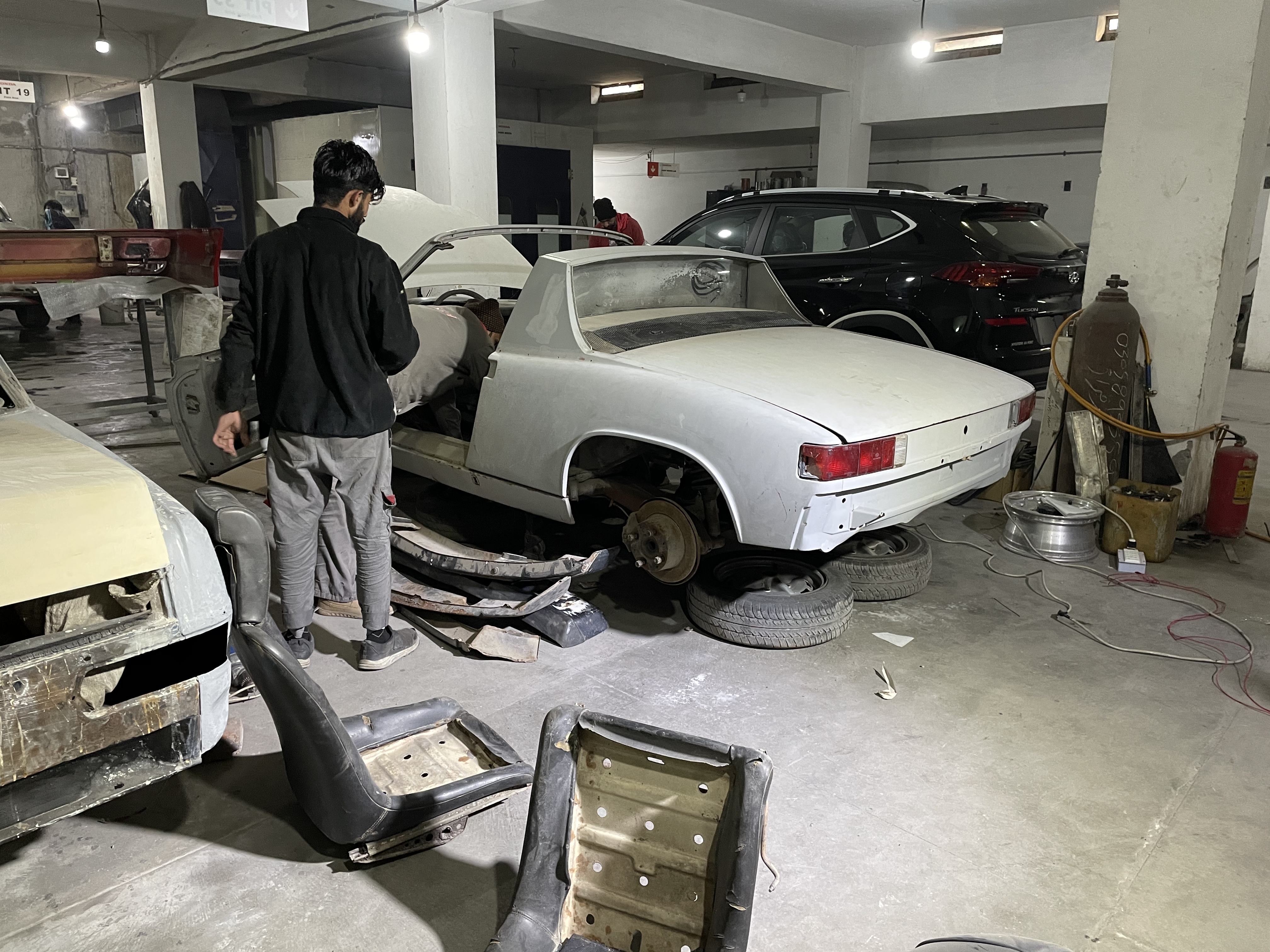

Finally sent my car to the workshop
Asheikh
post Feb 9 2021, 11:49 AM
Posts: 48
Joined: 7-August 15
From: Pakistan
Member No.: 19,037
Region Association: Pakistan
At the workshop

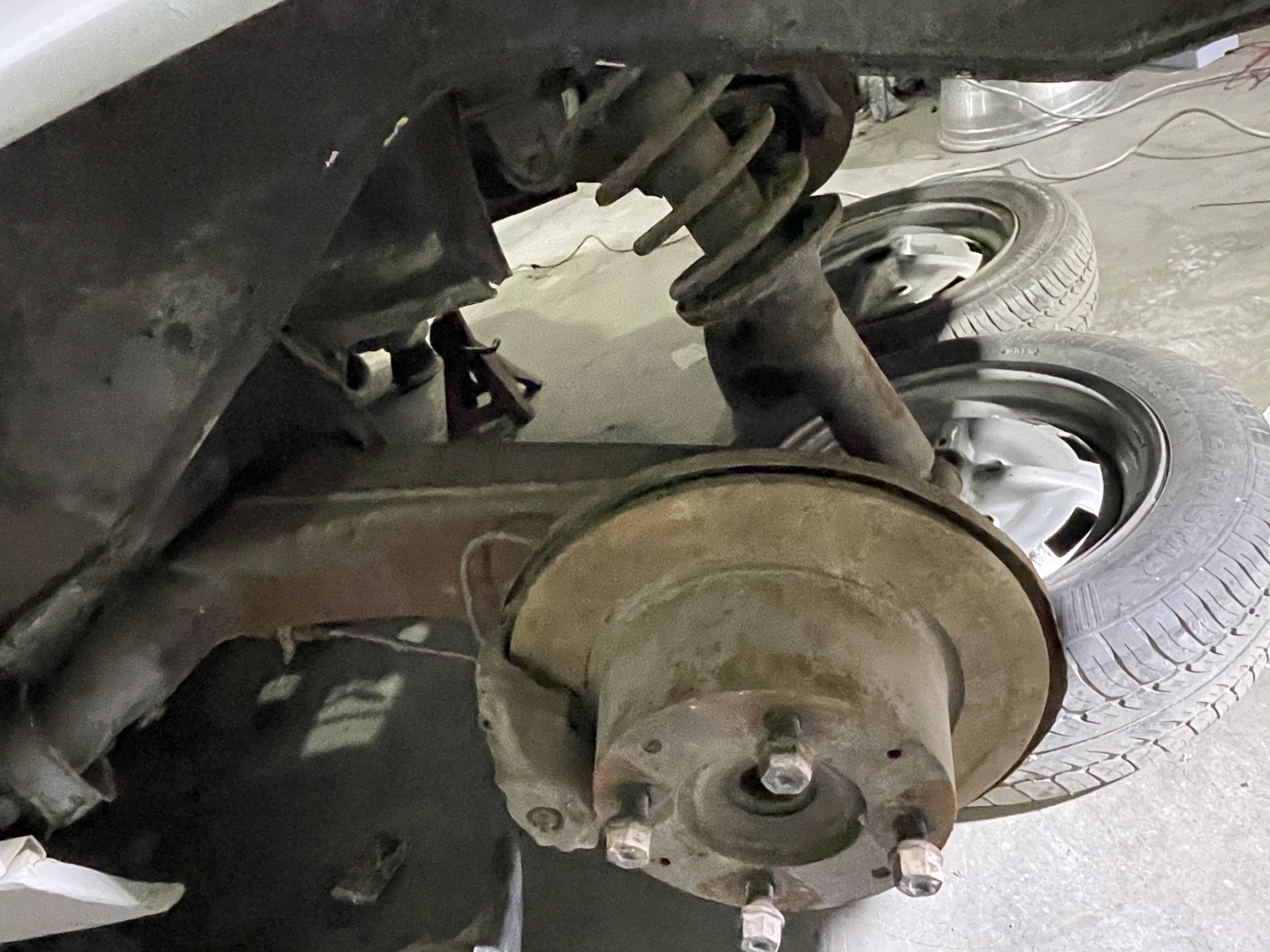

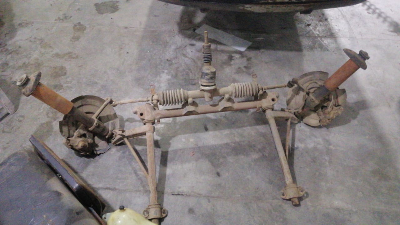

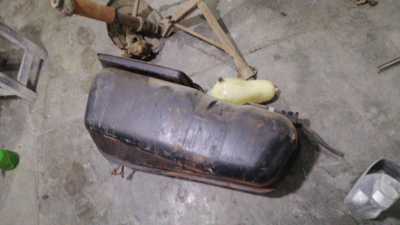

Going to disassemble the complete suspension system
Asheikh
post Feb 9 2021, 11:54 AM
Posts: 48
Joined: 7-August 15
From: Pakistan
Member No.: 19,037
Hope I’ll be able to get the calipers repaired locally along with the trailing arms

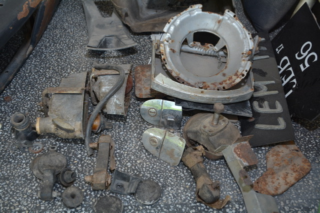

Out
Gonna restore what I can locally
I have ordered the stock restoration kit from elephant racing
