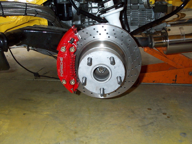

I'm using an '84 915 w/Vellios conversion and limited slip in my 3.6 914.
Shifter is 915 and rods are from Patrick Motor Sports.
Surprisingly, this is the only picture I have:

WOOOW 914RS I would love to get more info from you. Like what brakes you are useing and with your tranny does Vellios have a web site. If you would can you send me all your info and any tips on your car.

Series9
post Dec 14 2004, 10:57 PM
Lesbians taste like chicken.
Posts: 5,453
Joined: 22-August 04
From: DeLand, FL
Member No.: 2,602
Hi Theron,
Welcome to the club. To do the tranny, you need to buy the Vellios conversion kit ($1800), buy an 8:31 110mm large-flange, limited-slip tranny ($1200-$1500) and have it rebuilt with the conversion kit and flipped diff ($1000).
Then, get a 915 shifter ($80) and the shift rods form Patrick MS (about $250, I think)
That's right: $4k+. Drive shafts and 5-bolt hubs are extra (like $600).
The rear brakes are '86 930 with 930 rear rotors.
I've posted so many pictures here, I'm surprised no one has told me to stop, so run a search on 914RS and you should be able to see plenty of pics of my car. If you'd like to see something specific, let me know.
