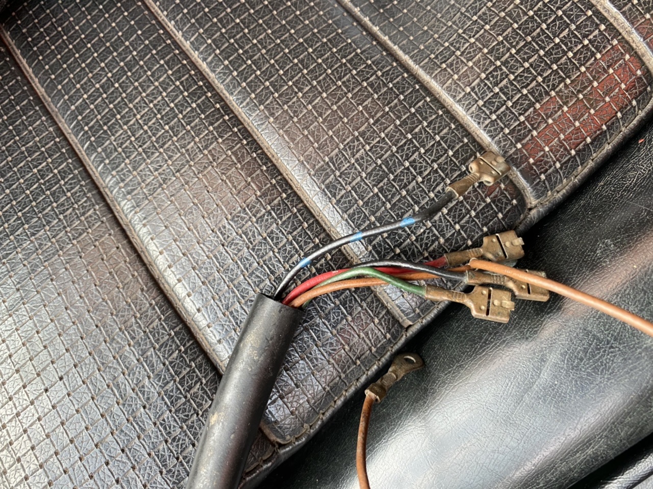

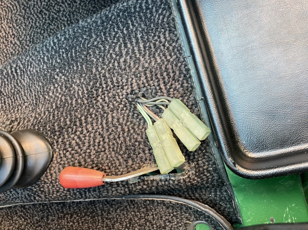

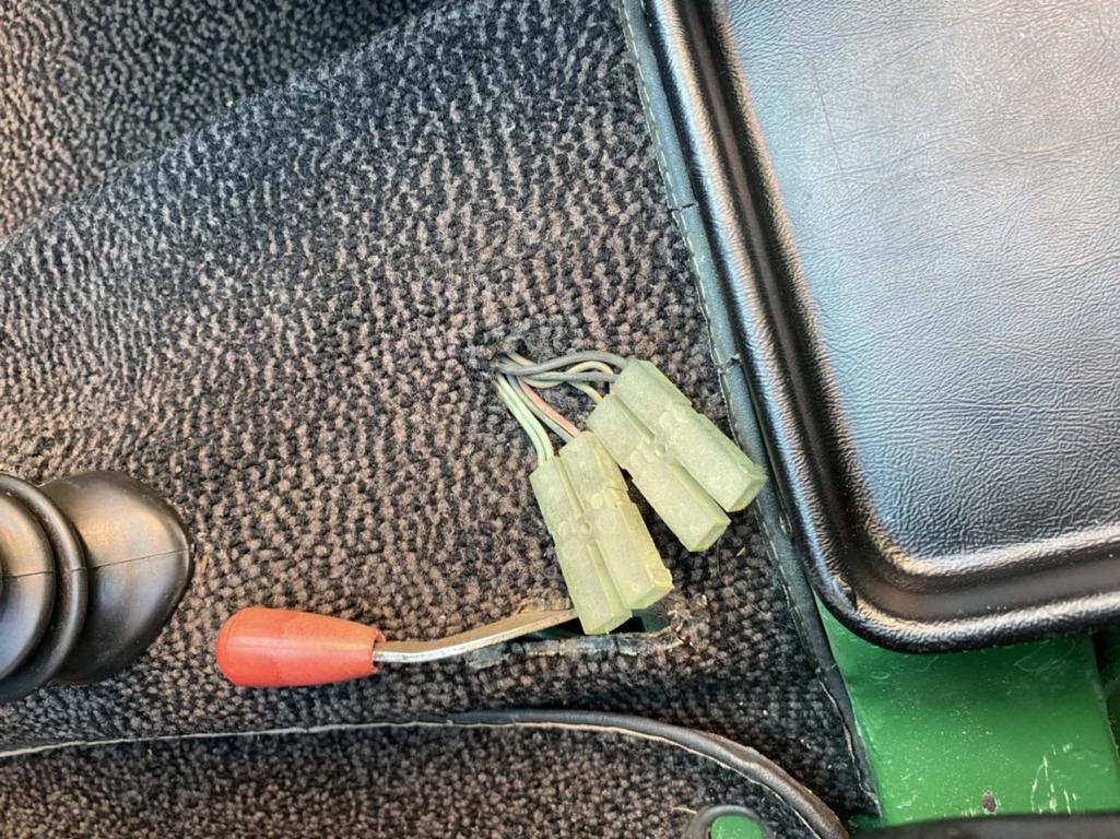

Sorry for the continuous questions but there is little by way of information over this side of the pond
I have been putting the console together and when I compared the gauge wiring harness to the wiring in the car there isn’t anything I can see that matches
The car is a 75 1.8
Should the wiring be part of the harness at the dash end or engine end?

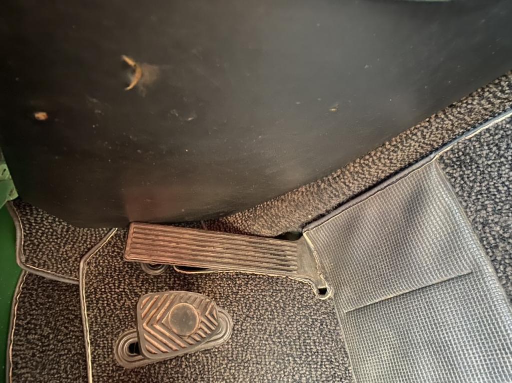

Also the fit is way off
The side panel is up against the accelerator pedal and the heater lever is no where near fitting through
Photos to illustrate
Thank you
Attached Image Attached ImageAttached Image

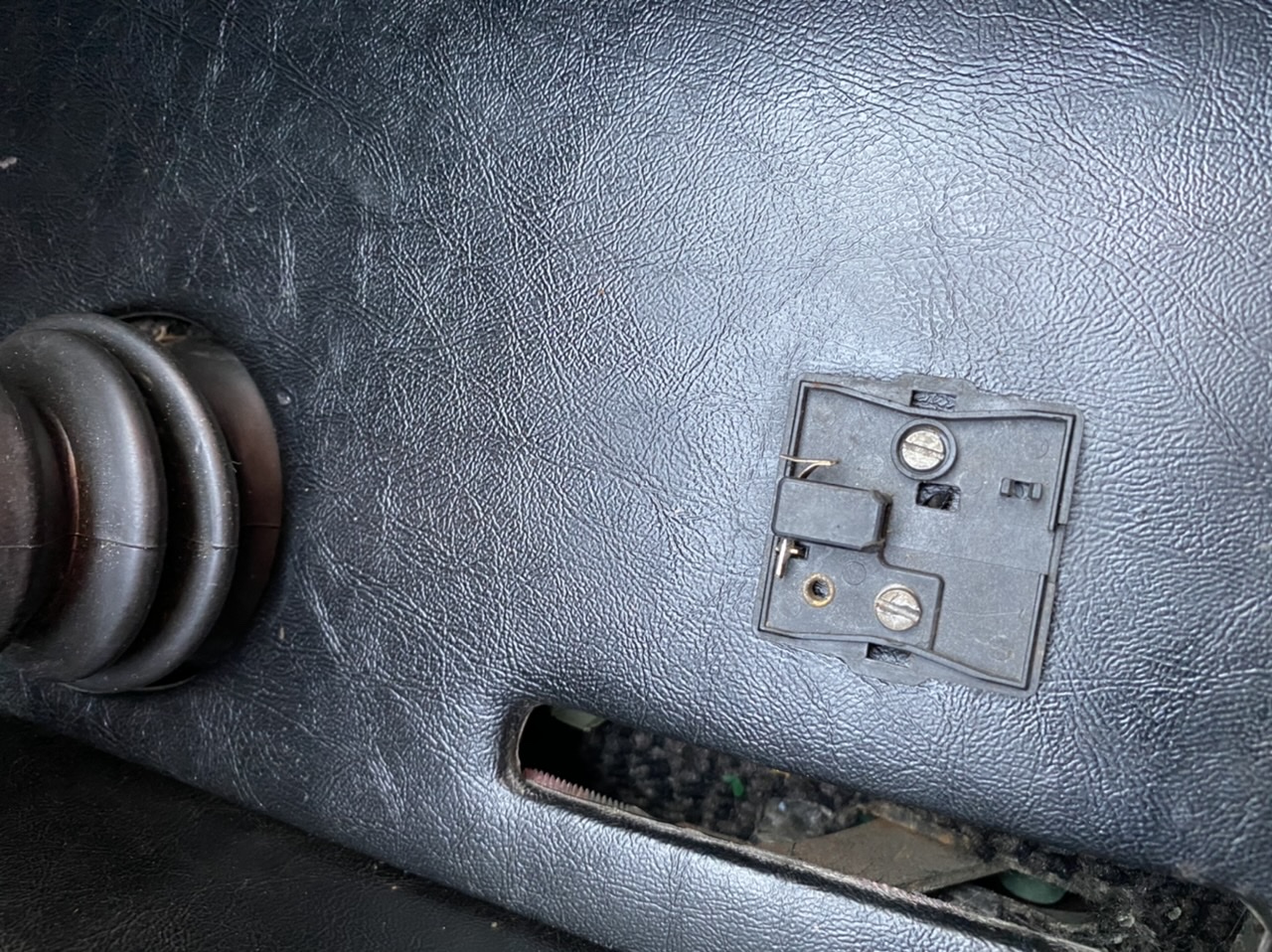

Also I can’t see how the wiring next to the ventilation lever mates to the demister light on the panelAttached Image

Looking back at my general wiring question it looks like those wires are for the console but then how would the wiring from the gauges feed through to those connectors
Oh this is twisting my melon man

I would hope to be able to figure out the wiring from the article but the closeness of the unit to the accelerator pedal still concerns me

Check the for sale threads and eBay for the parts you need. I found my heater lever on eBay for like $30 about a year ago.
Yes, the wires for the center console gauges do fit into the white plugs. It's just spade connectors with a plastic sleeve. The male connector is in the plastic sleeve, and the female end is the wires from the gauges. Just push the female connector into the opening and onto the male connector. The brown wire with the round connector attaches to the defroster light (plastic square next to the heater lever).
As far as the upper u bracket that connects to the dash, my console was missing that as well. I never installed one. I haven't had any issues with the console moving. It's a snug fit.

There is a crappy console in the classifieds for sale. You could rob that piece as they seem to have fallen off the edge of the Earth. The heater lever is an on-off item that goes to earth and completes the circuit for the heater blower motor. There is a small harness for the console gages. They are plentiful. IIRC, the wiring schematic for the console gauges is on a separate page in the Haynes manual toward the end of the schematics section. (IMG:style_emoticons/default/beerchug.gif)
EDIT: I may have that lever. I'll look around this morning. If so, you can have it for shipping costs.Wait a minute. I can see the lever in your pic. You just need the red knob for it. The 2 console brackets will hold the console in the correct position so it won't touch the pedal but it is close. You'll get used to it. Also, that lever should center up once the console is properly attached.

Thanks for the offer of the lever, it’s the angled one I need

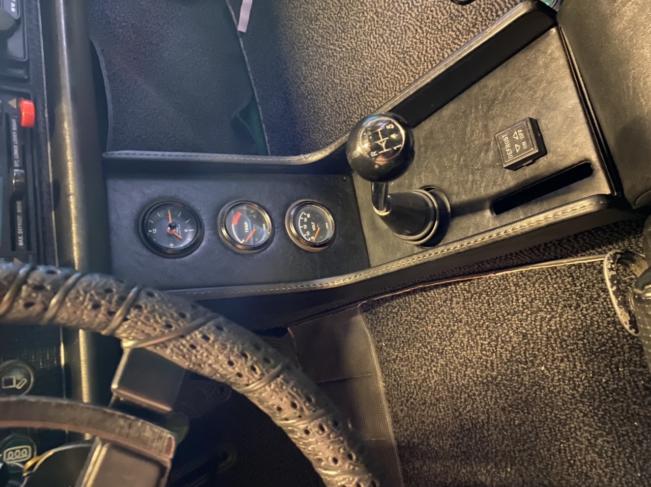

I made up a bracket to keep the console clear of the accelerator pedal
I was then able to fit everything up and followed the wiring instructions on the pelican guide
The clock sounds like it’s working but not actually moving

The console fills the gap nicely and the voltmeter works (IMG:style_emoticons/default/smile.gif)
