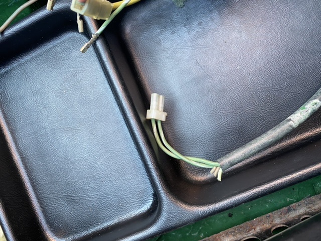

I have a few electrical connections that I don’t have figured out
Could you tell me what they are for pleaseAttached Image Attached ImageAttached Image

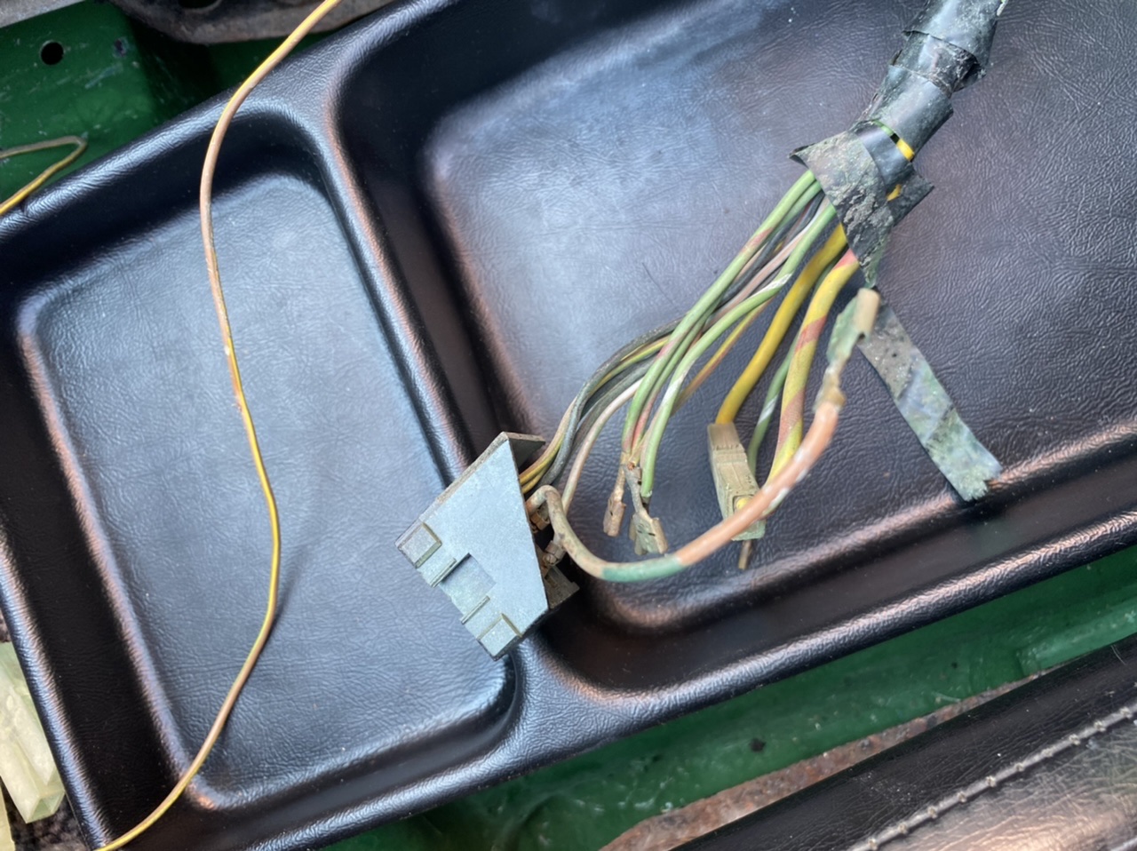

1. Looks like part of the seat belt cushion pressure sensor/seat belt receiver connectors. Looks like a few have been cut.

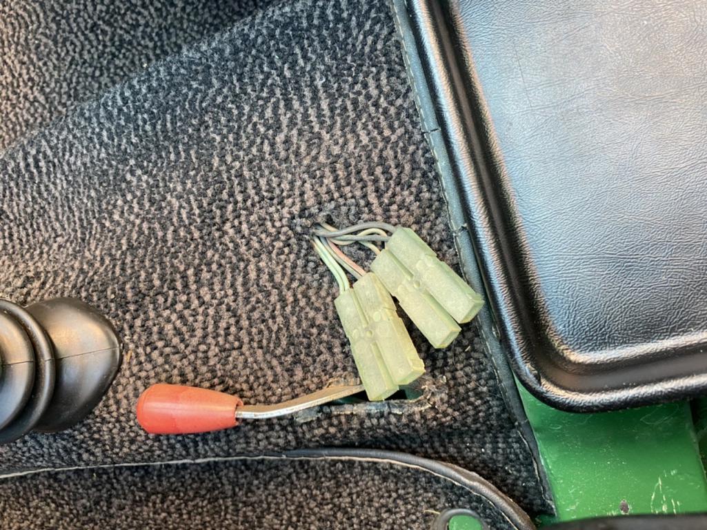

2. Looks like connectors for the center console gauges. Doesn’t look like you have a center console though.

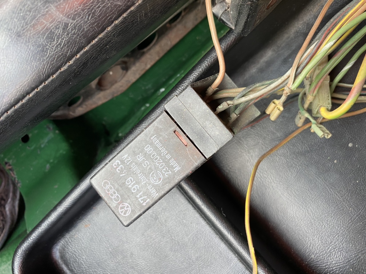

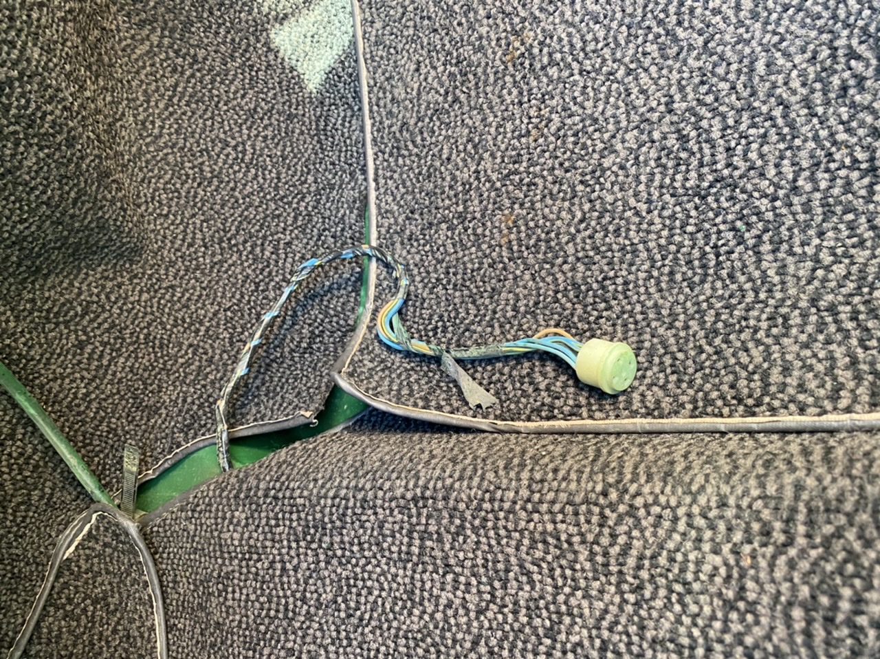

3. No idea because I can’t tell where from the picture this is located in the cabin.

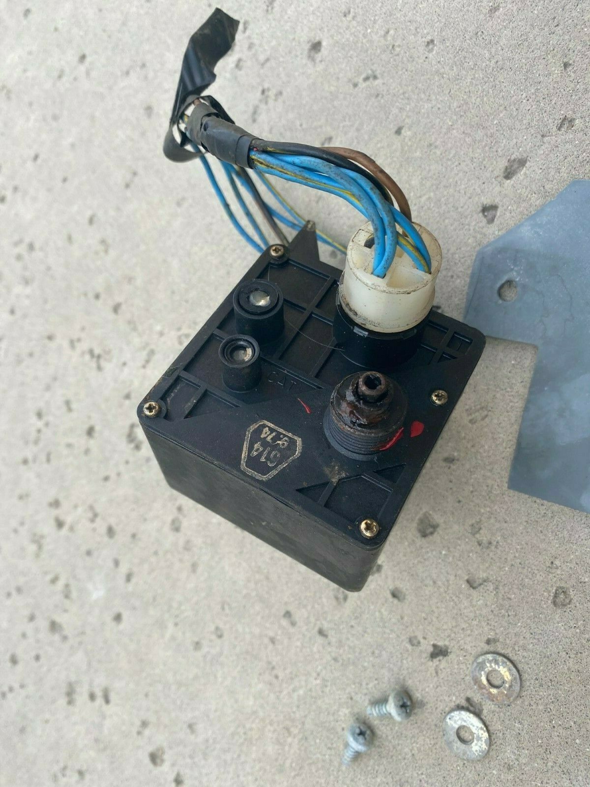

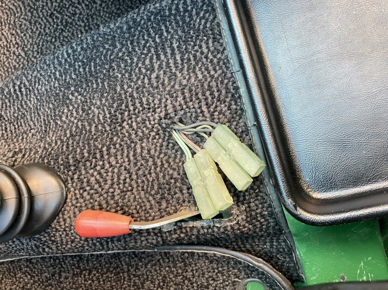

4. Looks like part of the seals belt interlock relay wiring. I only say that because of the two large yellow wires in that bundle.

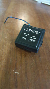

Tucks under carpet your missing the Defrost on light, useses blue black wire

Photo #1 is supposed to connect to the seat belt buckles for the seat belt interlock system.
Photo #4 is the seatbelt interlock relay. The Yellow and Yellow with a red tracer are already spliced together. So it is bypassed and shouldn't be an issue.

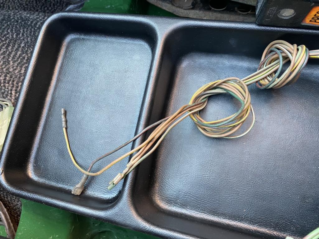

Photo #5 is the wiring for the backpad light.

I did find something in my parts bin that mates up to one part of the wiringAttached Image

QUOTE(dt4 @ Jun 17 2020, 07:52 AM) *
You no longer need that relay if your large yellow power wires are looped together.

The one by the shifter is for the center console connections. Temp, voltmeter and clock.

I would purchase a 914 Haynes manual. It has all the diagrams. The first picture goes to a seat pad for the fasten seat belt system.
Second picture goes to the center console,
The picture with the yellow wire bypass, was for the seat belt interlock system.
