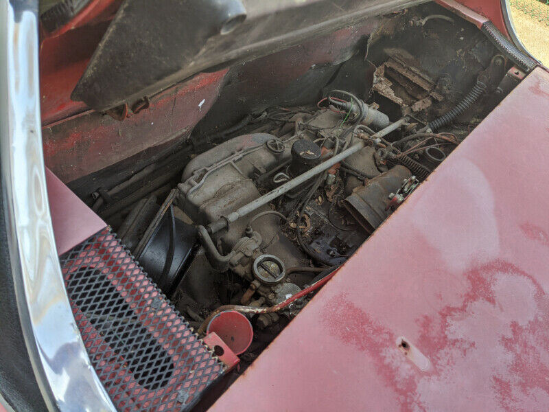

Hi All,
Totally new to the 914 so sorry for the Newbie question...I come from the Triumph TR world so I’m like a fish out of water!
Just been to see a very rough 914 car locally to me. The owner of the car is telling me that it’s a 1.7 L ( who am I to argue (IMG:style_emoticons/default/sunglasses.gif) ). My understanding is that the car originally should have been fuel injected with the Bosch D-Jetronic injection (incidently, my Triumph TR8 uses a L-Jetronic injection).
Here are a few pics from today of the engine bay...it’s in quite a disarray. Can anyone tell me what this might be and if it is correct (pretty sure it isn’t).
Looks like I might only be able to add 1 photo so I might have to make an additional post below...Attached Image

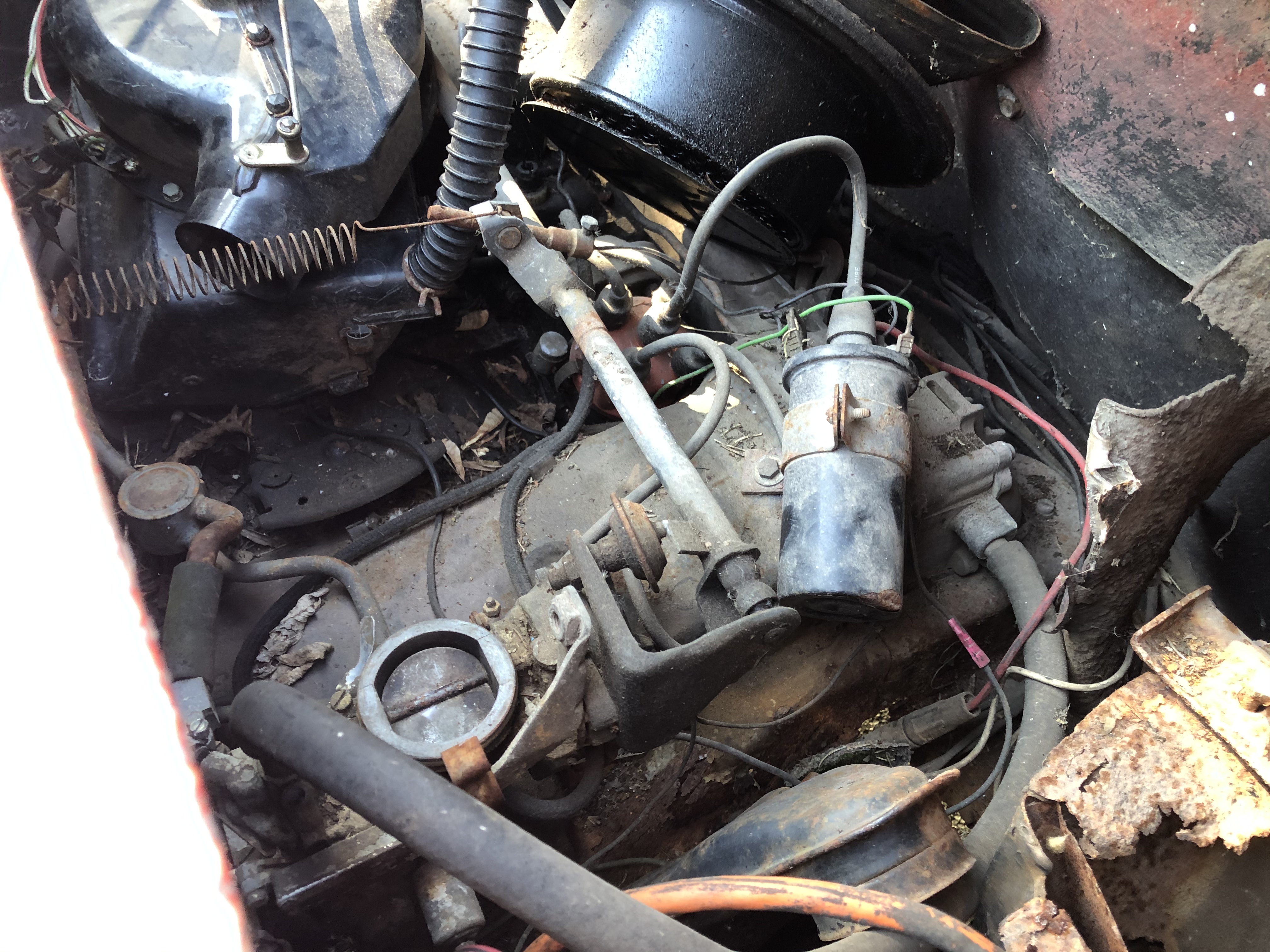

More photos Attached Image

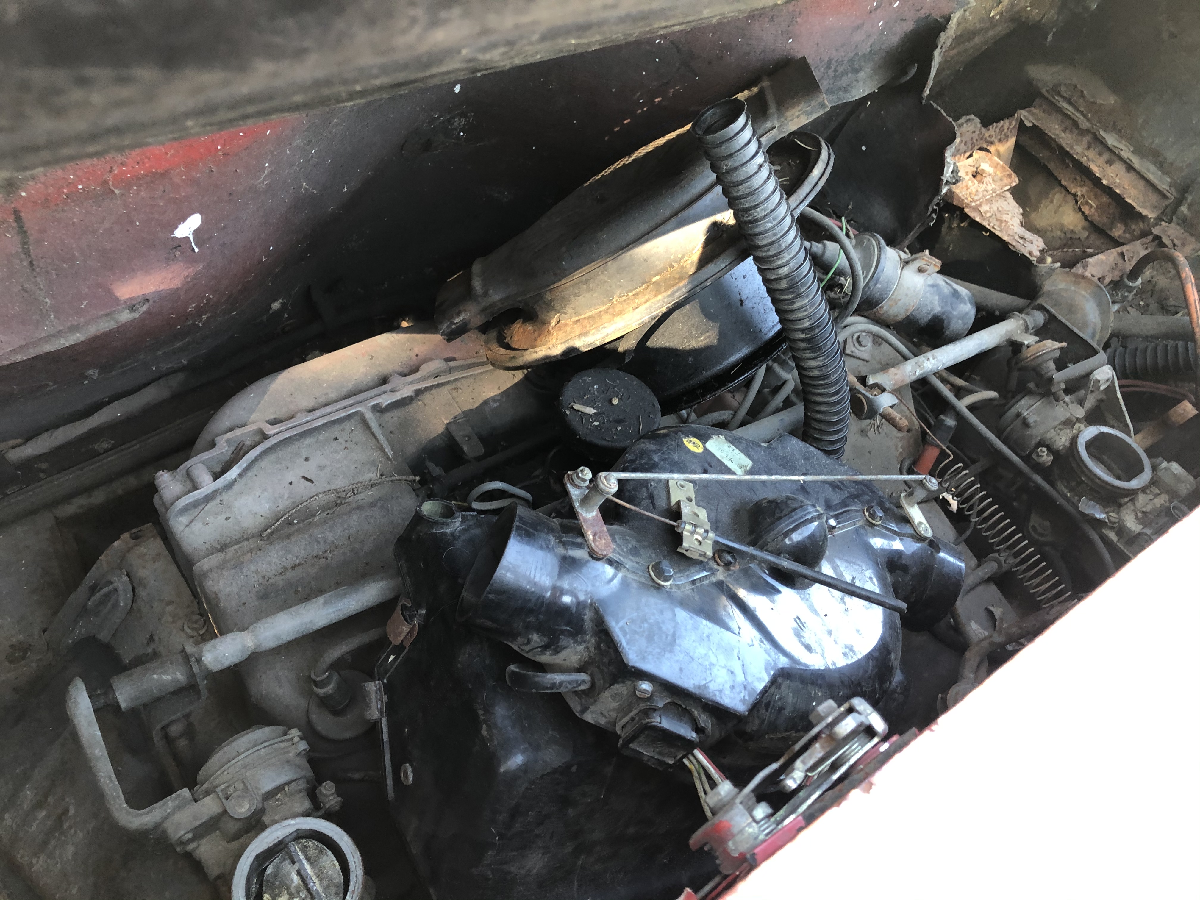

1 more

Welcome to the 914 world !
I guess you were looking for a next project and not a driver if I see these pics.....
Hard to tell anything from this pics, but it is a type4 engine (IMG:style_emoticons/default/smile.gif)
And Yes, it should have an injection system, but it was at some point in time swapped to carbs. But it misses a lot, for example all the vacuumhoses around the engine and other stuff.
Listen...before you buy this car, there is already a lot of rust in the pics and those are only the few pics of 1 side of the car....are you sure you sure you are looking for a project
Is this a 1973 914 ?

Could be whats left of euro market 1.8L. Dual solex carbs if I remember correctly.

Looks like the FI system was stripped from the car. Can't see any evidence of a carb on the engine, or an effort to put one one. Possibly harvested for parts? Makes you wonder what else has been removed.... The amount of rust seen on what is left of the battery tray also makes me suspicious of significant other areas of rust. The battery tray is probably the "tip of the rust berg." There is a "914 for newbies" series on youtube (done by a 914World member -- Ian Karr) that might be helpful for you in understanding issues around the hell hole. As far as engine identification probably best if you Google "914world" and "engine number location" to guide you in finding the engine number. Different engines have the engine number in different locations. A replacement case may not have a number at all. In the "914 info" section of this website there is a chart to identify the engine by number. Until you are familiar with them it can be confusing to navigate the layout of the engine. Ian also has a video on this that you would find helpful.
Not enough pictures or information for me to say this authoritatively, but unless you are getting a price consistent with a parts car, or money is not a concern, you might want to keep looking. Easy to get burned on these cars unless you have a good fund of knowledge. Ask me how I know that.....

Those look like the throats of the little solex carbs that came on type 3s before they were fuel injected.

No the carbed 914 used the larger square bowl 40 Solex's ,those carbs are off a bus T4 motor.
I'am thinking these are off an early 1.7 that had the steel oil bath air cleaner.
Ok to get the engine running but they really aren't great carb on a 914 T4 motor.

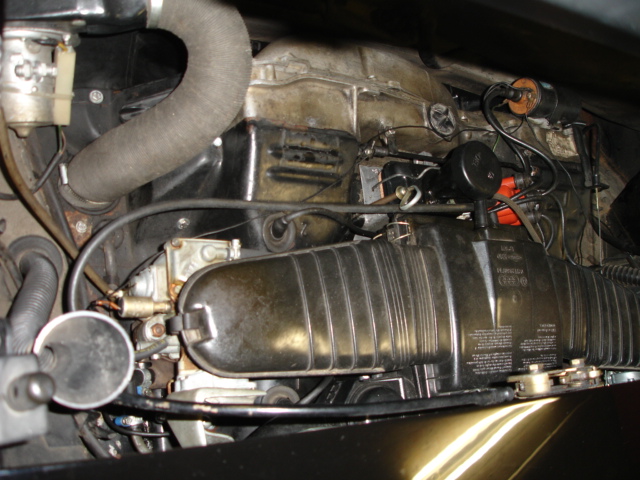

Here's what the real deal (Euro 1.8L Solex carbs) should look like
(IMG:http://www.914world.com/bbs2/uploads/post-179-1377570821.jpg)

Looks like a 72-74 1.7L bus engine with the 32 PDSIT's Solex carbs.

Normally I'd say you are right about the rust. However, if you restored completely and were able to source the correct engine plumbing it would be a rare example of a euro car. You would need to do some homework to make sure it wasn't just a motor someone popped into. Not sure what you get on a COA these days that would be helpful.
I think that as a unicorn, it would have some value. The question is are you ready to put the time and resources to do it? Do you really want to, it's a gamble?

I thought that to start with but checked the dipstick location and oil filler/breather.
The OP should supply an engine number.
