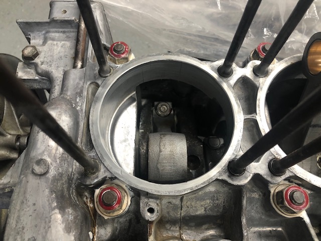

Forgiven me if a stupid q....
I am re-building my 1974 2.0 and following the manuals and Raby video. As I measure the deck height, I am too close - about .15”
I have some spacers, but it appears they only fit correctly on the head side and not on the case side of the barrel. They are too small if I try to install between the barrel and the case. I am using AA pistons and 96 size
Is it ok to add the spacers on top of the barrel instead of below to add the necessary height?

So I tried again tonight and also installed the stock sealing ring between the barrel and the case. I tightened down the barrel and then turned the crank to get TDC. First one was .033. I did it again on another and got .034. The method I used was a straight edge solid metal bar across the barrel top and then used detached feeler gauges to slide under the bar until there was no resistance.
