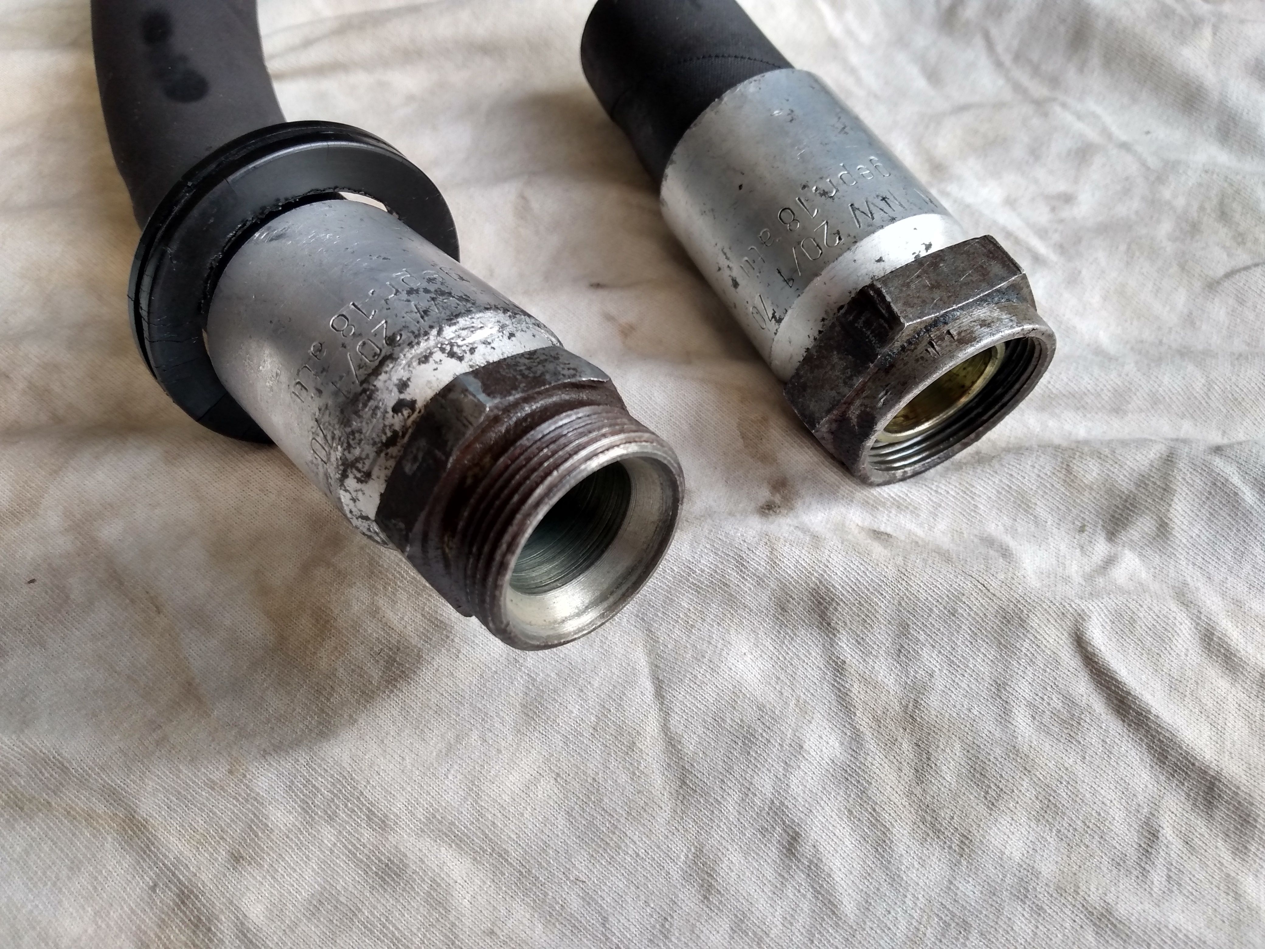

Don't discard your original plumbing.
As mentioned they can be rebuilt.
If you chose to rebuild avoid putting a ChannelLock on the aluminum
collars, they are dated and have value with your car. Use a strap wrench or find
someone familiar with these fittings. Some of us on this site have done this.
Crimped style replacement hoses are available.
Removing the tank with the first hose attached is either impossible or a very big
challenge. It's a toss up.

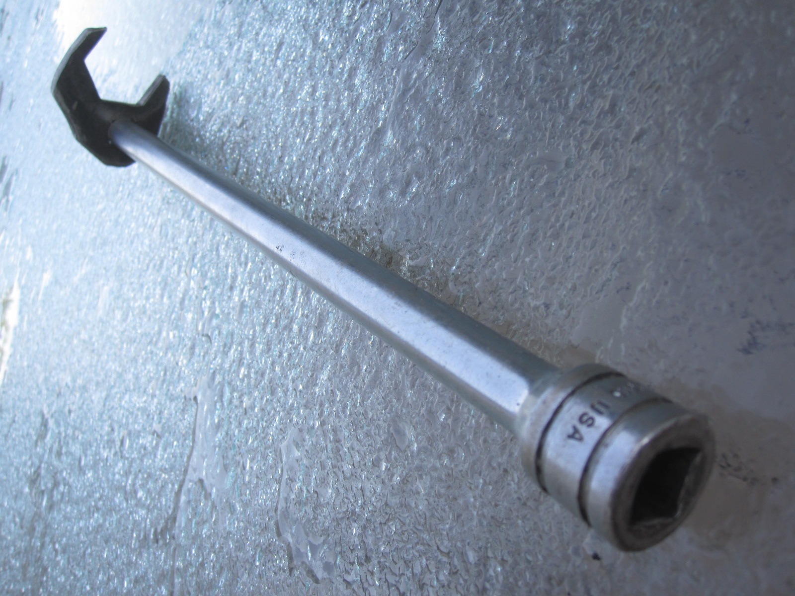

Pictured is a tool to reach into the fender for the first fitting off the tank.

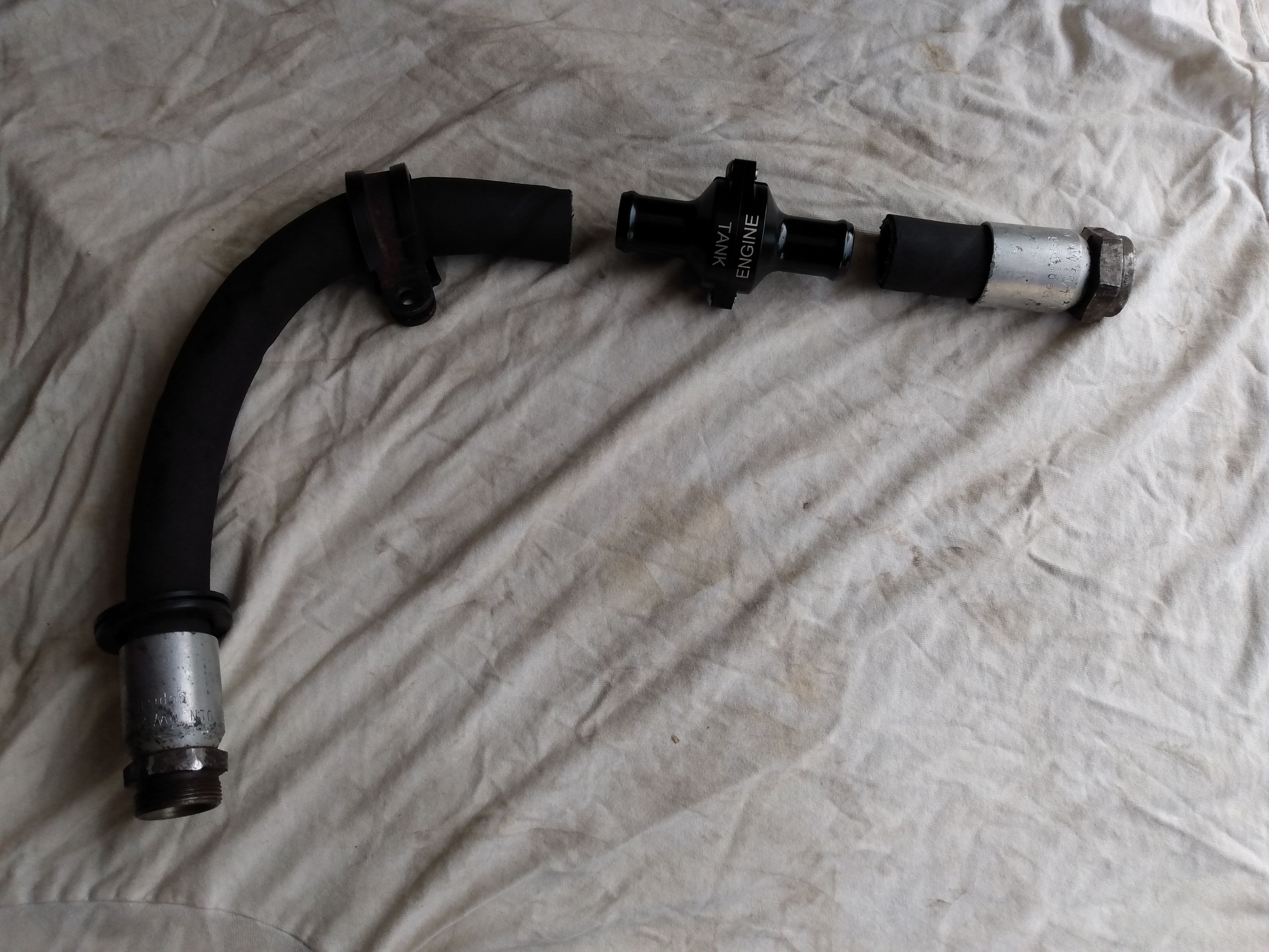

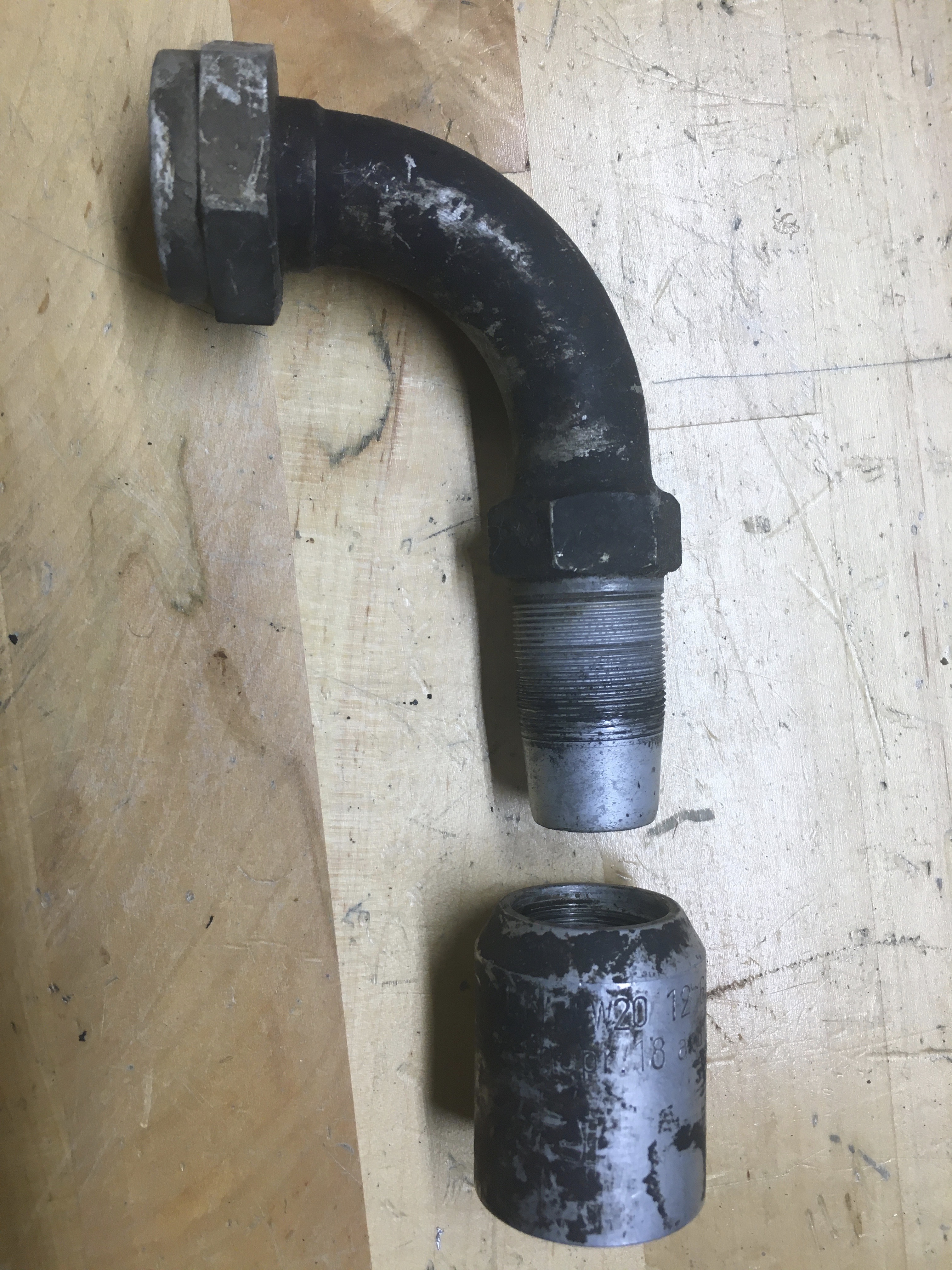

Ahh, so that's how they come apart. Nope, not something I want to try on my own. The fittings seem to be in pretty good shape. This curved pipe piece is still attached to the tank and I'm going with the 'if it ain't broke...' for that part. I did clean up the rust around the fitting nut and it seems like it will be fine to reconnect the other piece.
The second picture is what the original objective was/is. (why does swamp and alligators come to mind...)
So if you are willing to tackle it, I would be glad to ship the pieces out to you and pay for time/materials/whatever. If you have a couple short pieces of hose, great, otherwise I'll see if I can find the proper size and send that also.
PeteAttached Image Attached Image

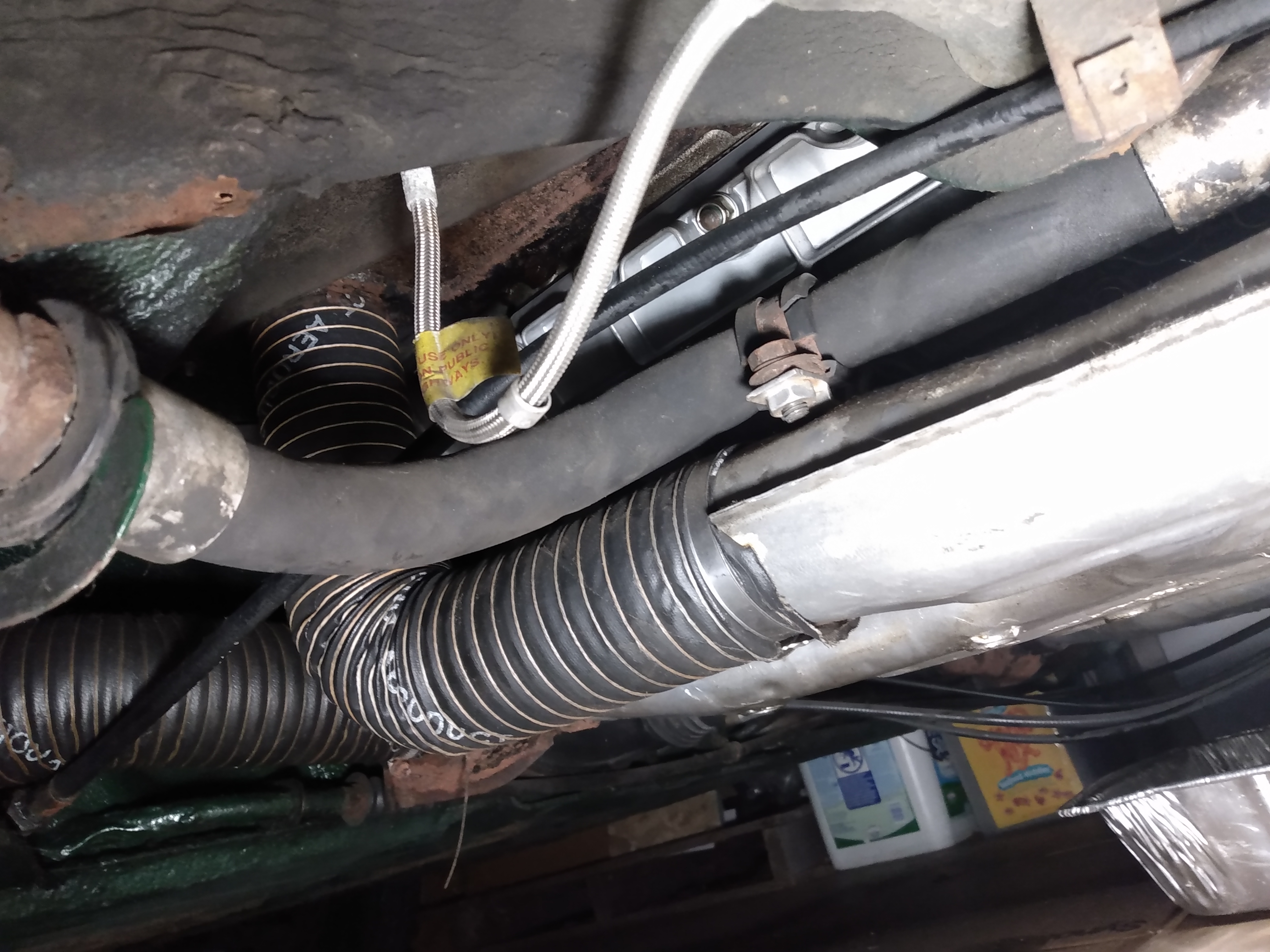

See my original pictures, and the one I just posted with the line off. On a factory car with heat exchangers, there is really only one place it will fit and that is right next to the oil cooler.
fixer34
post Aug 26 2020, 08:58 AM
Here's one with the heat exchanger on. The clamp attaches to the heat exchanger there is just enough room for the valve between it and the fitting. The rest of the hose has too tight of a bend to insert the valve.Attached Image

I'd be glad to help but honestly if you've gotten this far you can easily do it yourself and get back on the road. Removing the fitting from the collar isn't that difficult. Use a rubber strap wrench to hold the collar and just back out the fitting. Clean up the fittings, measure and cut new hose and put it all back together. I would suggest this hose as it has an abrasion resistant outer layer.
Belmetric Hose
If you really don't want to mess with it let me know and we can work something out. (IMG:style_emoticons/default/wavey.gif)

QUOTE(fixer34 @ Aug 26 2020, 10:46 AM) *
Too me the cooler end is cut a little too close, you want to make sure the two barbs don't touch, I'd want 1/2"-3/4" space between the valve and cohline barb tips.
Got it. Ordered a meter of hose today so I have some to 'play with'. I'll cut a short piece and mount the valve, then measure, and cut back if needed, the cooler side.

@rgalla9146 Thanks for the tip about the Stoddard wrenches. I just ordered set. Of course I had to toss in a new T-shirt too. (IMG:style_emoticons/default/beerchug.gif)

I like the wrench for the tank connection. Sure beats replacing the tank 3 times getting the angle correct as i recently did.

@fixer34 looks like got it apart?
Making progress. Yes, your wrenches helped immensely. Put 18" of pipe on each one and that provided enough force to break it loose without damage. Cleaned up the surface rust around the nut, threads all look good and even did a test fit back together. Cut the hose to install the valve, but 50yr old rubber doesn't stretch anymore. So ordered a length of reinforced hose, it came today. Valve goes in much easier, but now I need to remove the cohline fittings and out them on the new hose.

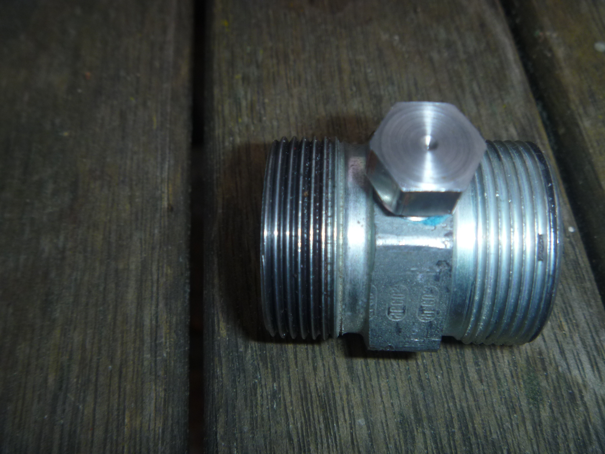

No need the bung thread is tapered,and has a wee lick of blue Hylamar ...going nowhere,cheers.
