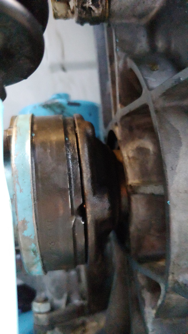

1) While tightening up the CV joint to the trans, I noticed a big chuck missing. I think the pin hit it when it came off. I am assuming grease will just fling out of this?? If this does need to be replaced, do I need a new new cv joint or is it just a simple spacer or something?

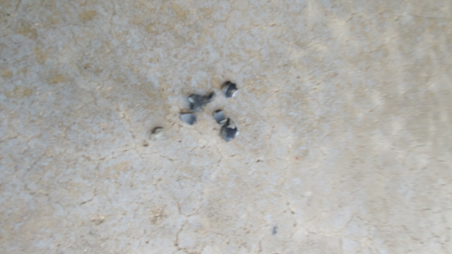

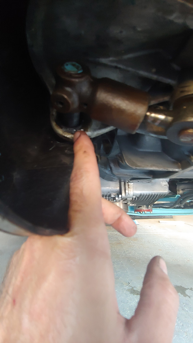

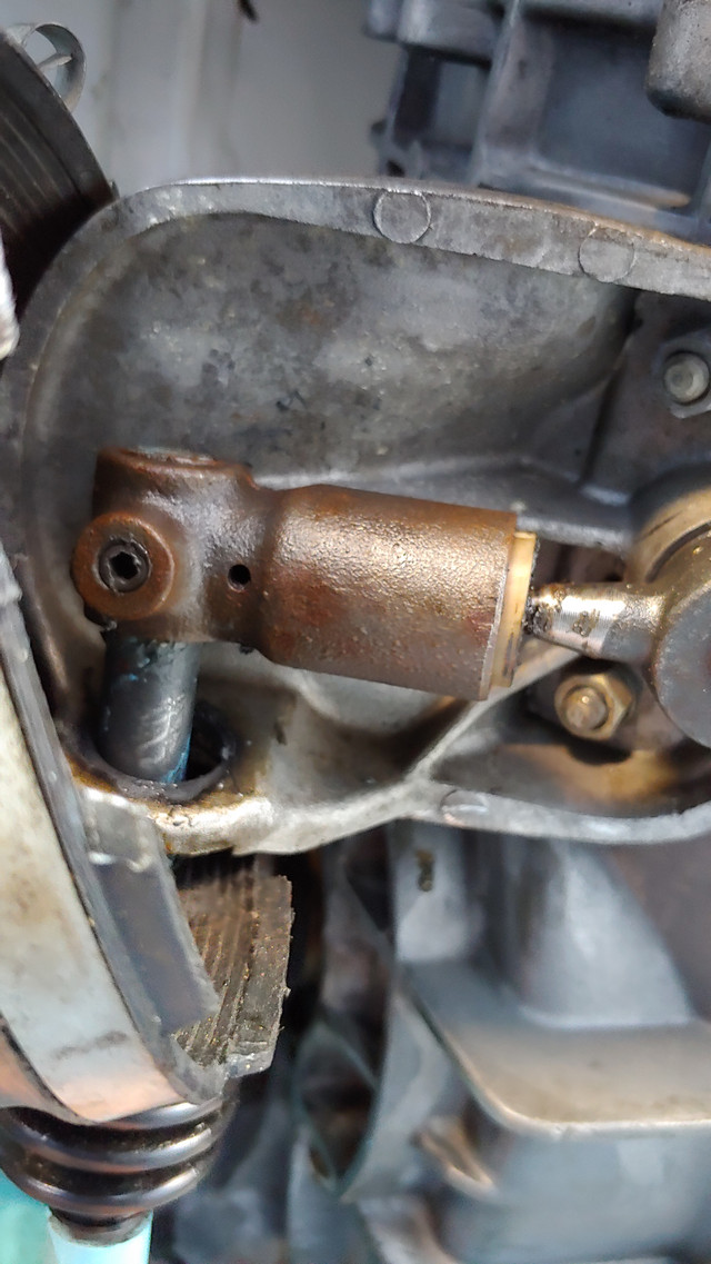

2) The shift rod that runs under the car/into the trans seemed to have a lot of play in it. I removed the rectangle cover on the trans and a bunch of plastic shards came out. So clearly something exploded, likely a bushing.
Is there supposed to be a bushing where the rod goes into the trans? (Refer to where my finger is pointing in the below pic)

that bushing is shot. remove the cone screw completely and pull off the coupling. The plastic sleve may also be broken. It looks like it is sticking out too much.

Check forward to the firewall and the u joint. Likely need replaced bushings there as well. The bushing you’re see in your third pic is likely shattered. Easy and cheap replace. Still don’t think tranz needs a rebuild. The CV joint is likely shot. See if the bitch communicates to where the grease is in the joint, but most likely.

Where the rod comes out of the firewall, that bushing was pulled out of the firewall. I pushed it back into place but it can likely use a new one. So is this the kit I would get with the firewall bushing, the one that goes into the trans and the ball cup?? http://www.autoatlanta.com/Porsche-3-piece...N-BMIS4200.html
Regarding the CV joint, sorry to be very ignorant but trying to learn. Is this something that can be rebuild with a kit or do I have to buy a whole new axle?

You can get a replacement joint from PMB for $113. Get the pre-machined one. You will need to remove the axle in order to work on it. I would get all new schorr washers and bolts as well. The bolts require a special driver. Do not use a standard torx driver.

Agree, just call Eric Shea at PMB and he will let you know what you need to do. Best to buy a new CV joint, not while axle.

Fix the whole set of bushings and you’ll be good!
