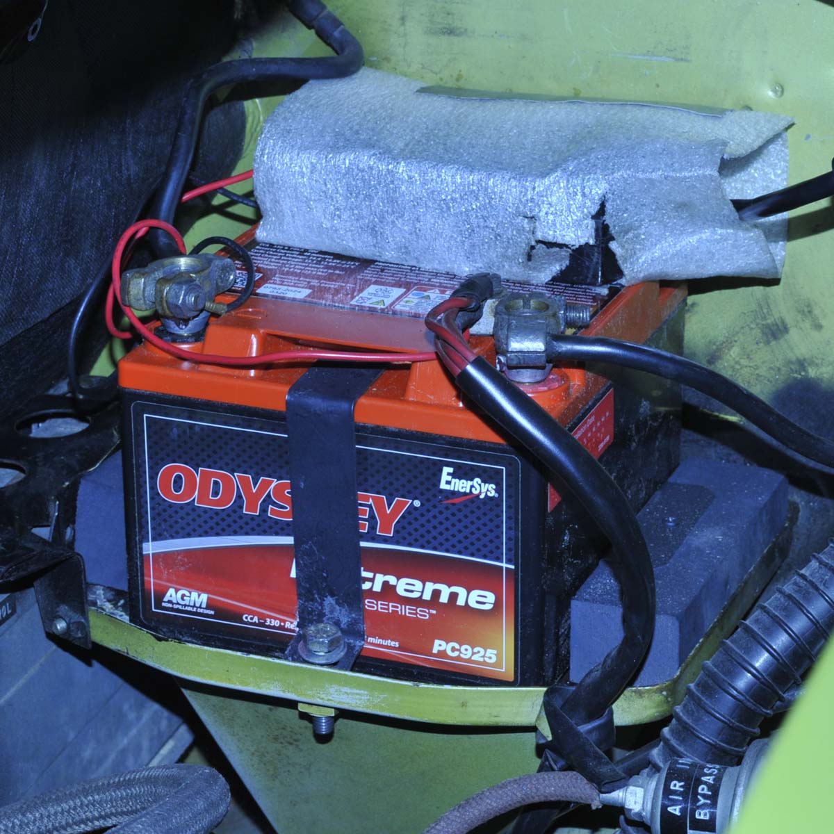

QUOTE(jim_hoyland @ Sep 23 2020, 05:31 PM) *
Pics ? I’d like to see how it fits... (IMG:style_emoticons/default/smile.gif)
Here is the new Odyssey I installed yesterday, much smaller that the Optima it replaced. I made wooden blocks to keep the battery from moving laterally, and a steel strap down that I will improve later. The object wrapped in white foam on the top is the trickle charger that stays in place. I'm not pleased with the battery posts because they're too short, and will upgrade when I find suitable replacements.

QUOTE(jim_hoyland @ Sep 24 2020, 09:43 AM) *
The battery posts are sketchy; why would they be different from the regular batteries ?
This series of Odysseys come without posts, you have to add screw in posts and what I initially found available were this short.The screw in sockets are recessed below the top of the battery, making full use of the posts problematic.

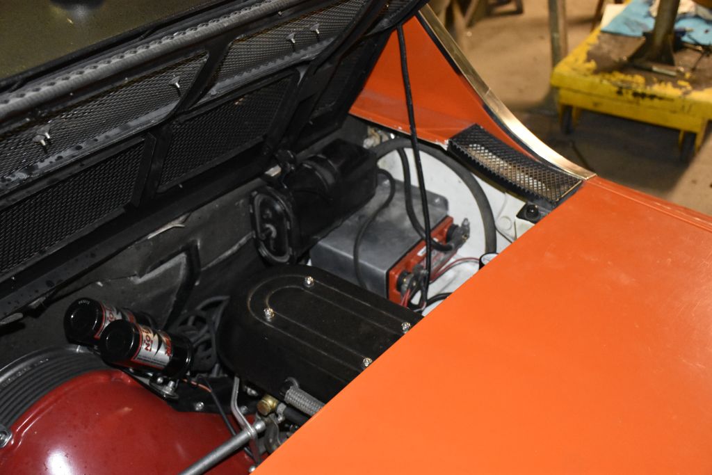

Get that VIN ?
Posts: 10,041
Joined: 1-May 03
From: Sunset Beach, CA
Member No.: 643

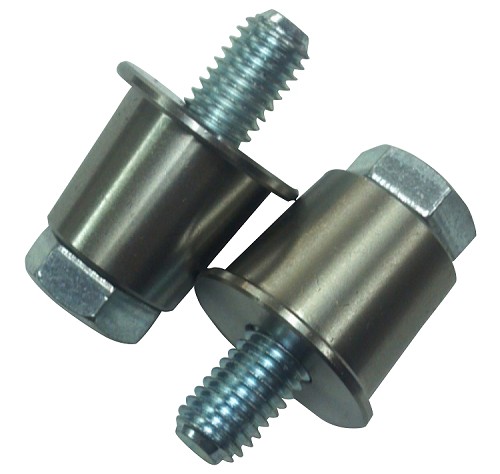

Will these work ?
https://www.vmaxtanks.com/VCP8-8mm-Stainles...osts-_p_72.html
windforfun
post Sep 24 2020, 02:53 PM
Posts: 2,097
Joined: 17-December 07
From: Blackhawk, CA

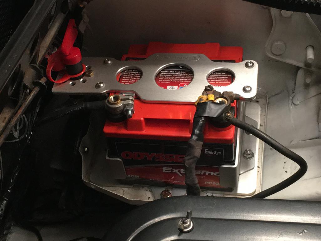

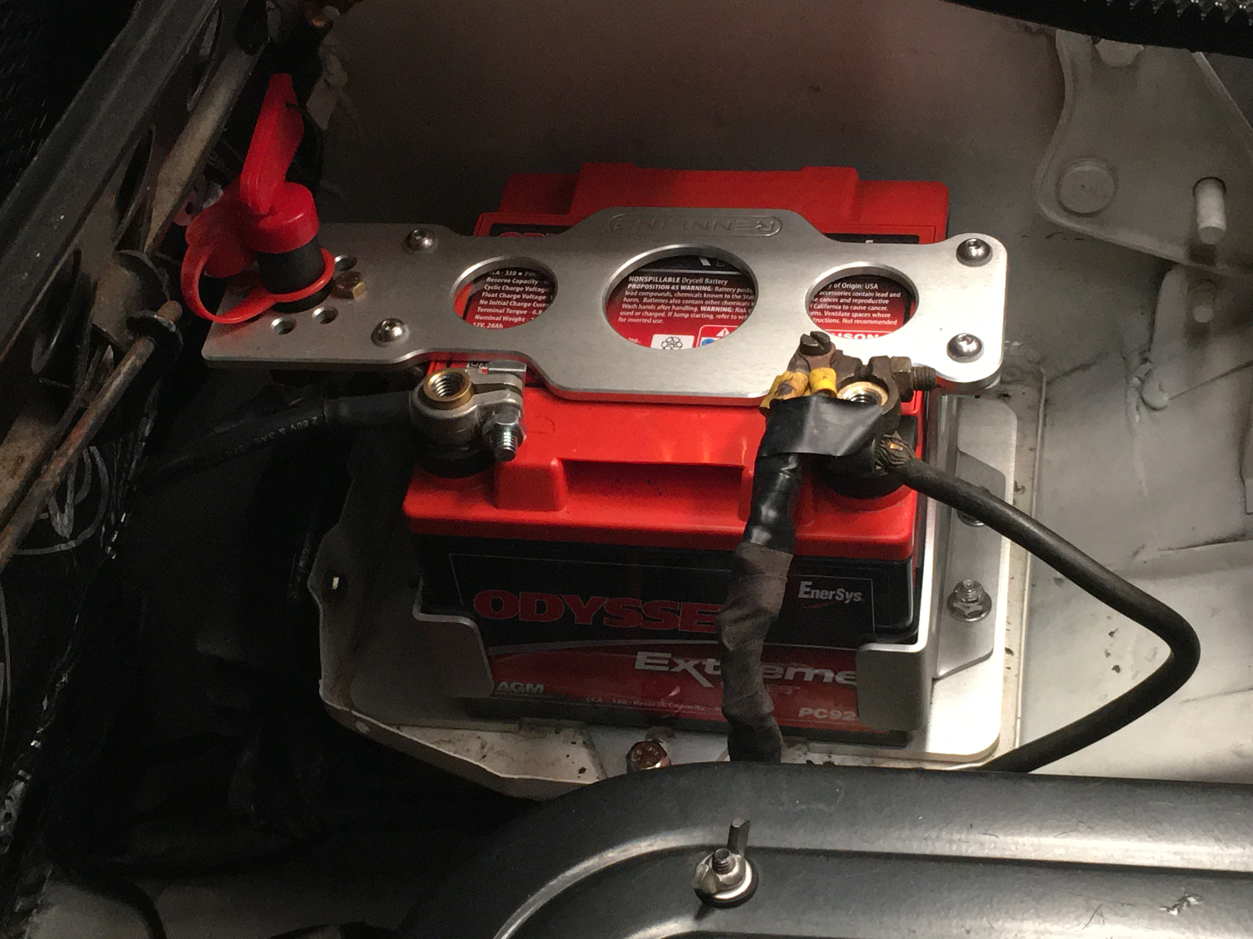

Is that as far as it can go down? Is the clamp obstructed?
I have a PC680 it's posts stick a fat 1/8" out of the stock positive clamp and the FLAPS negative cable. But it does have a flat top (side) and I had to take the bolts out and spread the clamps wider to get them down that far.
(IMG:http://www.914world.com/bbs2/uploads/post-26-1565064513.jpg)

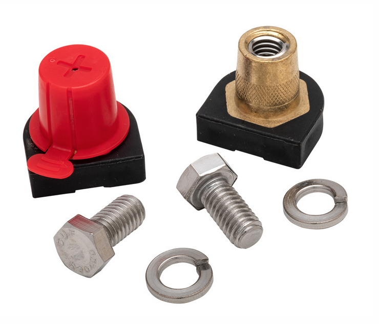

Odyseey makes SAE terminals for $10. This is what I bought and there's plenty of room to properly seat the cables.
https://www.odysseybattery.com/products/sae-terminal-kit/

My PC680 came with those terminals. I bought mine from Summit.

QUOTE(Jamie @ Sep 24 2020, 10:19 AM) *
Wow. That's a lot smaller. Per Odyssey, looks like it weighs 23.8 pounds.

QUOTE(rjames @ Sep 24 2020, 01:45 PM) *
I looked at these on the Odyssey site, but don't know how they are fastened to the battery? There isn't any info about how they are installed on the battery screw connectors of the PC925.
nditiz1
post Sep 24 2020, 06:14 PM
Posts: 1,272
Joined: 26-May 15
From: Mount Airy, Maryland
Member No.: 18,763
They screw in just like normal terminals
silverg

I just checked the 680 isn't a flat top, it has the same indents as the 925.
I'm using the same terminals as in the the pic, the block on the bottoms gets the terminal bottom flush with the battery top.
But note mine are different bolting as they have inset hex socket bolts and I don't remember the terminals being threaded, just the battery.
