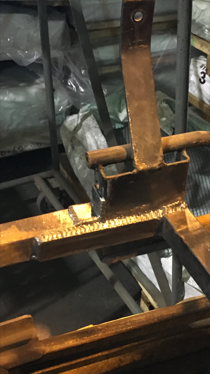

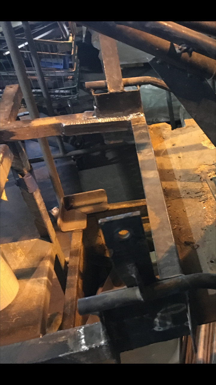

Had to pull the frame from a friends shop because he was too busy. Had one of my shop welders work for me after work hours and get the front section reattached. Butt welded 1" square tubing not the strongest. Put some strap pieces on the inside and outside. Also removed the differential unit and can now get it off to sandblasting and powder coat. Can't wait to get I back.

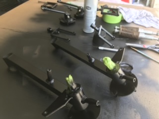

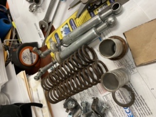

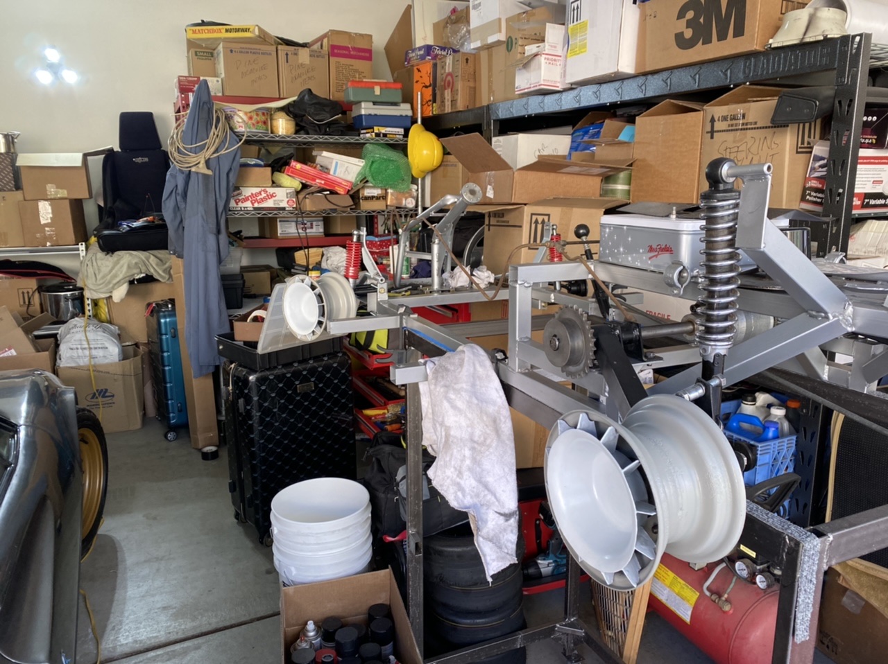

Recently moved to Irvine and am able to finally squeeze some room in to get back to the chassis. Built a rolling frame to be able to reassemble the chassis at a comfortable height for my back. I thought I had possibly contracted COVID as I had a coworker infected so I prepared for some possible quarantine time.
Cleaning and refreshing suspension pieces first. Then I have to design and fab a new brake pedal /master cylinder set up up front.

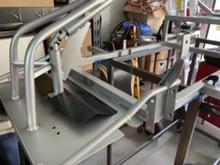

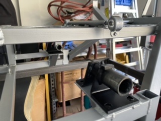

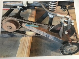

Frustrating time trying to align the rear axle and the bearing blocks. A center support next to the diff (see pics) causes interference if the bearing blocks are are not level to it. I suspect that the chassis mounting pads are also not flat, or level with each other.
My have to bring it back to work and put it on my big surface plate and measure everything for shims. Ughhhhhhhhh.

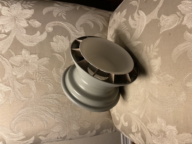

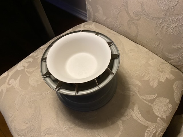

Trying to make lookalike bbs wheels.
Beach914
post Mar 21 2021, 07:00 PM
Post #99
Posts: 1,002
Joined: 28-March 10
From: Aliso Viejo
Member No.: 11,519

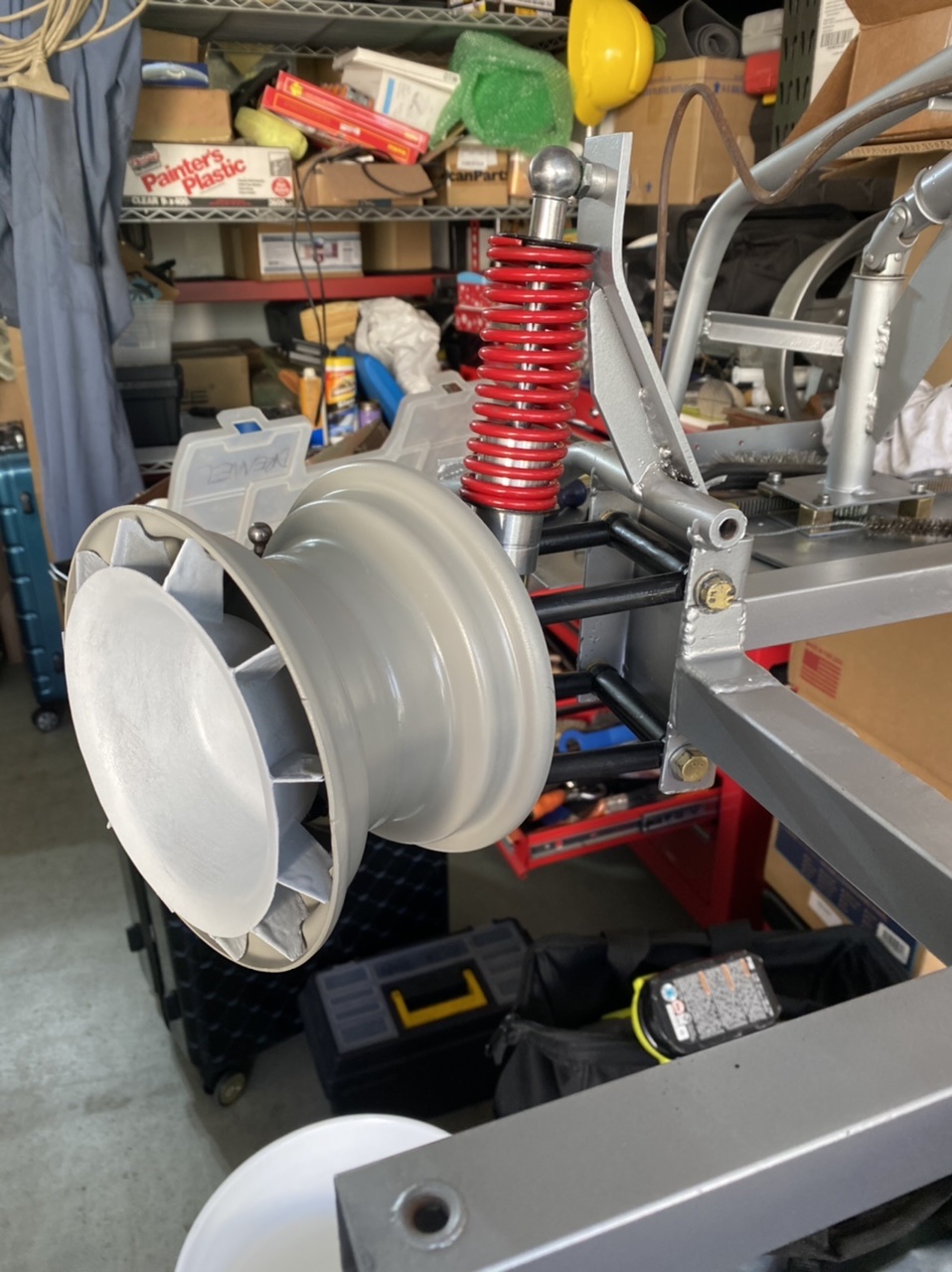

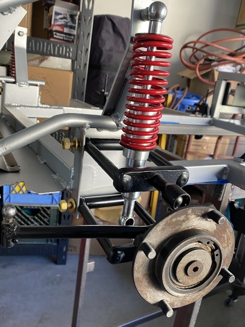

Reassembled the front suspension and steering rack. Added the wheels with the BBS cooling fin ‘look’ that I’m working on to see how it looks.

They look great (cooling fins) to me.
