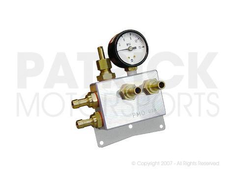

QUOTE(Tdskip @ Oct 15 2020, 08:36 AM) *
Assuming you guys have a fuel pressure regulators that you’ve put into your fuel system where there’s a return line coming off the regulator?
Yeah. I haven't finished mine yet but you need a bypass style regulator. I'll be putting this one in. https://patrickmotorsports.com/products/fue-pmo-fpr

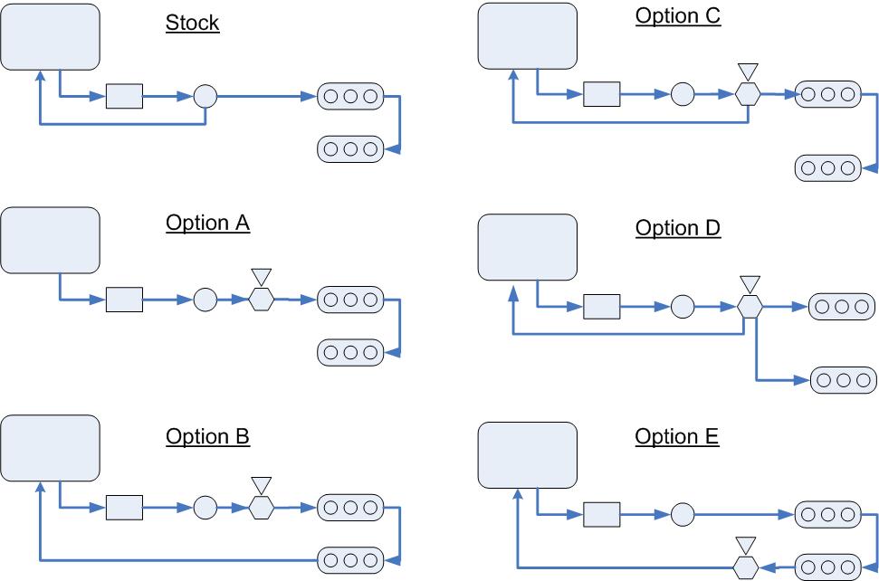

I think I took this from another member 10+ years ago
but its a good diagram:
