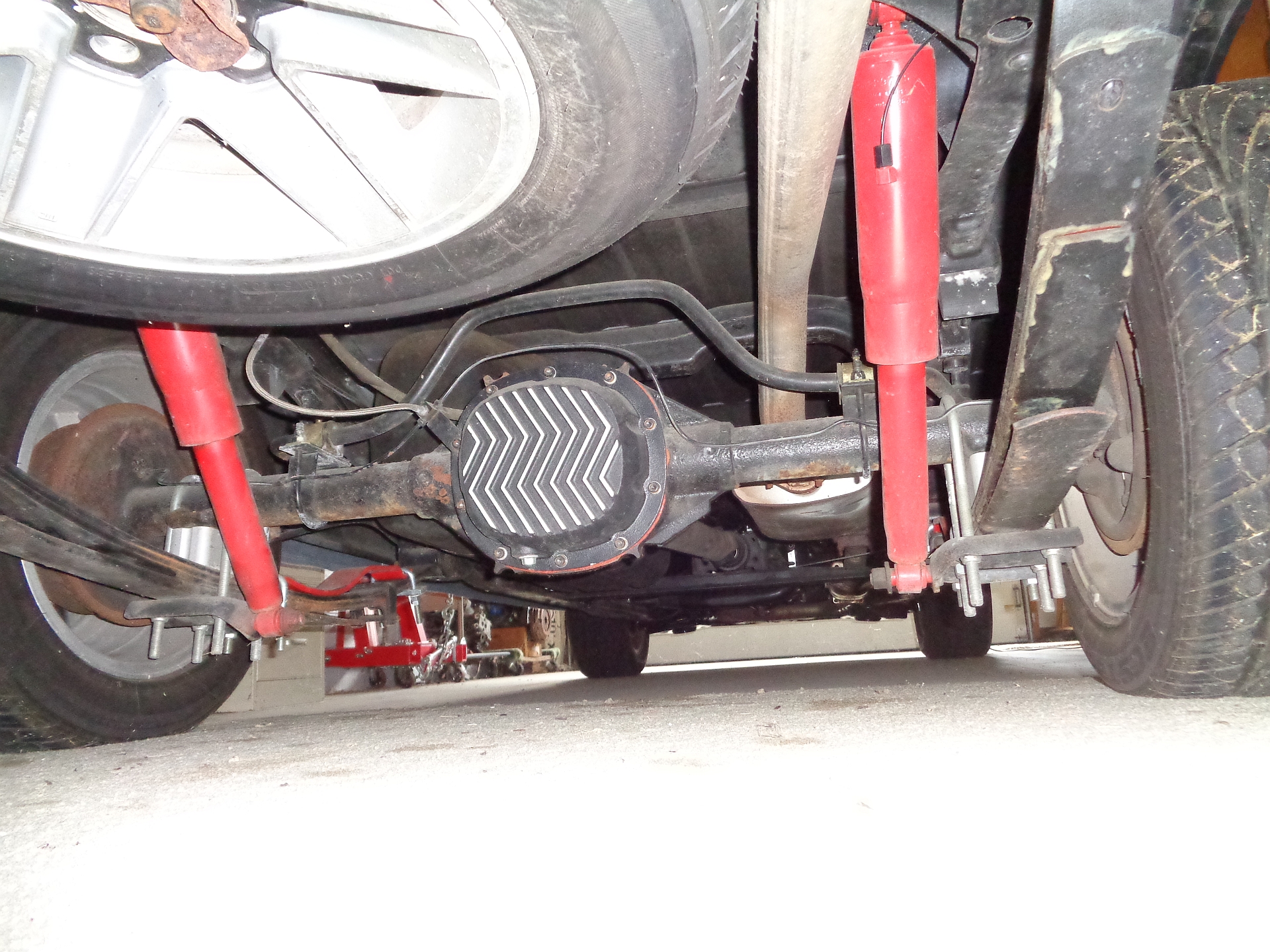

I'm quite satisfied with my rear Addco, however it's bolted to a Eaton limited slip with 3/4 ton springs & air shocks... (IMG:style_emoticons/default/biggrin.gif)
