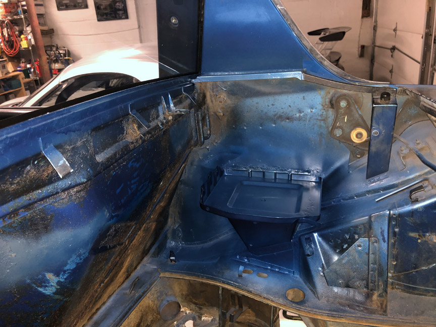

This is what the battery tray looked like:
This is the result of old age, not prior-owner abuse, but it still needs to be fixed. So, out it comes.
I was really hoping to be able to keep the original tray support, but it was a little too rusty to keep using. So it came out too. Here's the result:
Next step is to clean up the remaining rust and paint it. Then, the new tray and support will be installed.

Question, when you took out the battery tray, did you manage to do that damagefree for the other side ? (outerside of the car) ?
(in case someone wanted to replace his/her tray, could that be done without hurting the other side ?)

It's relatively easy to remove the tray without damaging the outer quarter panel or the inner panel (the one you can see in the pic). I did it by using a dremel tool and grinding through the spot welds inside the battery tray; although it is kinda slow and time consuming. If you're careful, you can get all the spot welds and not damage the car's sheet metal.
For re-installation, I will drill holes for plug welds to attach the tray support to the car and the tray to the tray support. I will probably also drill holes through the inside panel, for plug welds to the lip of the tray. However, I'm going to test and make sure I can get my welder nozzle in the space between the inner and outer panels before drilling the holes -- if it doesn't fit properly, I'll have to figure something else out.
If you want, I'll take more pictures of the installation process, to show the steps.
