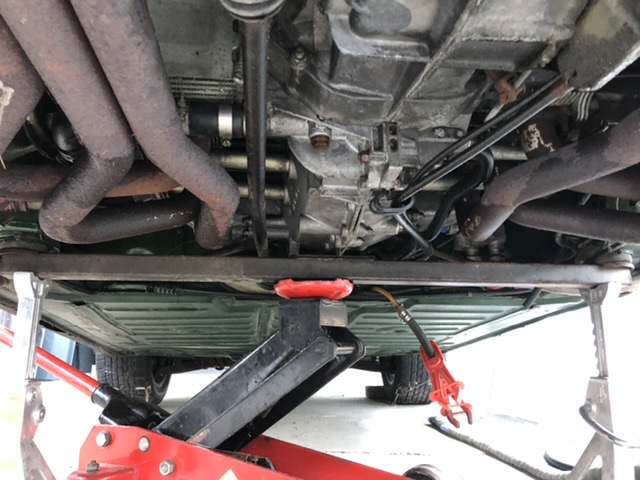

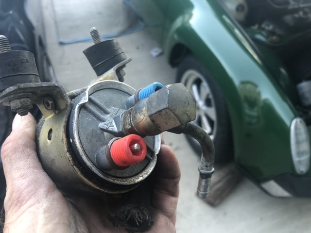

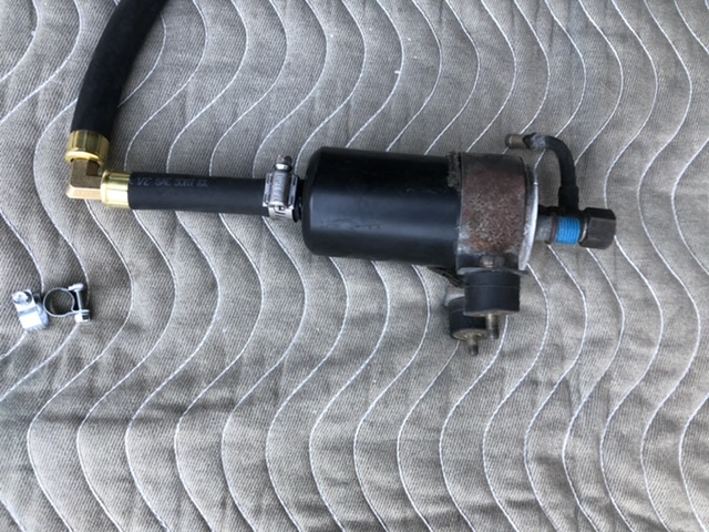

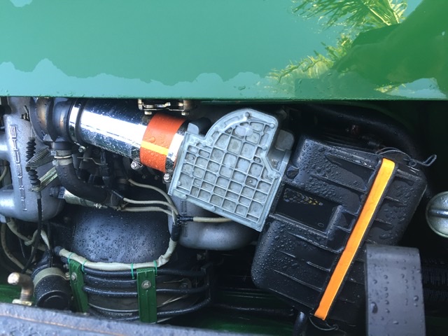

20 years ago I bought a new Audi 4000 fuel pump. It has these nice color coded screw on plastic terminals with rubber O-rings seals. (Again Audi factory) The early fuel pump location is tight. It’s super clean and I’m still running the same pump. No issues at all with fuel pressure and the car does 150 mph with no fuel starvation confimed several times..!
