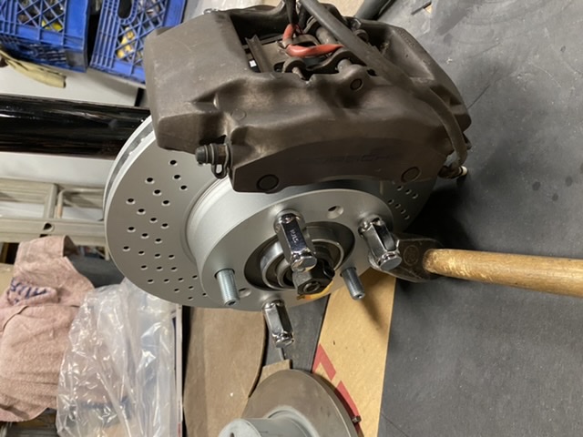

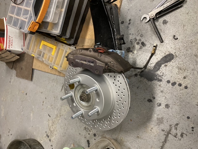

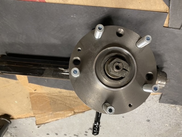

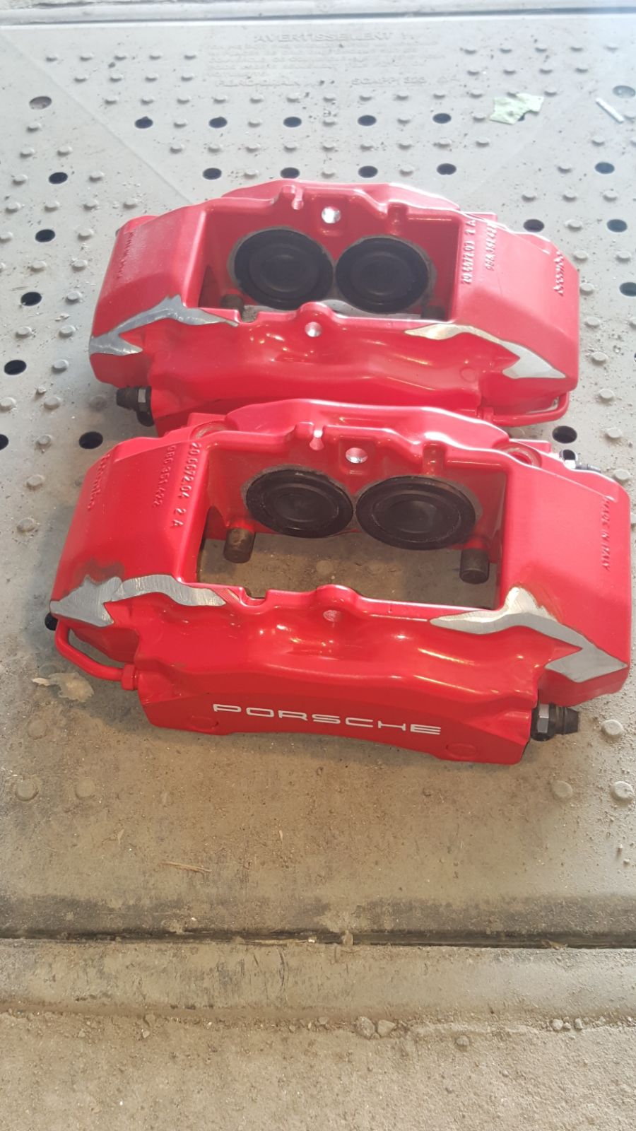

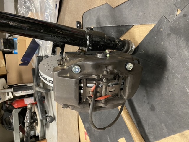

It was suggested I make this a stand alone thread so here it is. This will work for 4 or 5 lug wheels.
Parts
07,08 cayman, 05-08 boxster 2.7L (non-S) rotors.
298x24 front
299x20 rear.
Calipers 97-08 Boxster
07-08 Cayman
Adapter mount for rear caliper. Re-drilled rear hub or the soon to be released 5lug hub from URO. If you want to keep 4 lug have the Boxster rotor drilled.
Front hub that goes right onto the stock strut and can use 4 or 5 lug wheel. Front rotor mount adapter.
I have not tried but am told 15” alloy works.
Rear
Front
Once the URO rear hub is available (announced Nov 2020) this entire upgrade to Boxster brakes with 5 lug will be an off the shelf bolt on affair.
edit I believe it can be done for both early and late struts. the struts shown are late which was harder to work out.

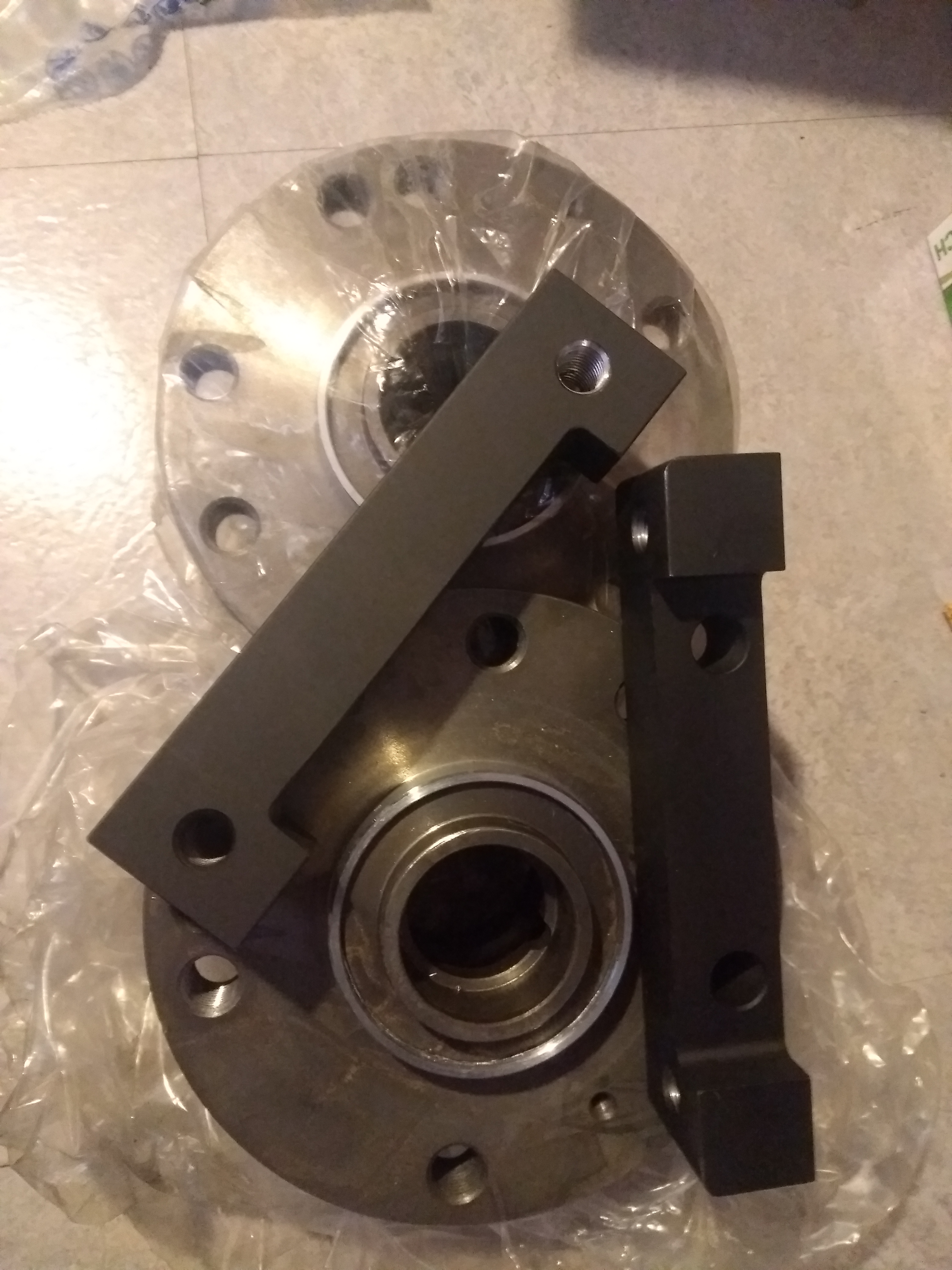

My name is Lanner. I built this setup. It uses new iron hubs with radial brackets for use with stock 914 spindles. Bearings and wheel seals are stock 914 and it's bolt on. It's a good option that doesn't require swapping out to 911 suspension. Please let me know if you have any questions about the setup.
Thanks

Djway has been a great help, measuring things for me and even sending me a strut to work with. I build custom brake setups for mainly the vw and Porsche 944 crowd, but I have worked on alot of different platforms. I didn't have a 914 to mockup on, so DJway sent me a spindle and has been of great help in getting this setup done.
As built, this setup has no parking brake. I could probably adapt a 911 or 944 style drum in disk setup, but would need a trailing arm to work with. Current rear setup is just a set of radial adapters for use with stock 914 rear hubs, either stock or redrilled to 5-bolt.
Here is a mockup pic of the front setup. Let me know if there is something specific you'd like to see. I can build the front (hubs and brackets) for about $550.
Thanks Lanner

Correct on front setup. You need the hubs and brackets. You can get some nice screw in studs from BMW shops or 034 motorsports.
Correct on rear setup, you'd just need the radial adapters. The 914 hub will accommodate the Cayman caliper without any work. Note you lose the parking brake.
I have this setup on my car (vw) with 19mm master and works well. It's been on there for over a decade. I'd suggest maybe a slightly bigger master (20.6) if you want a really tall pedal , but I've left good enough alone.
On 16 fuchs the calipers need a little massaging, and maybe a slight spacer 5mm unless you have the 951 Fuchs. Pic of massaging here:
In general you need 16" wheels. Some 15s fit (mainly the spare tire alloys such as 928/993 15" spare or 951 spare

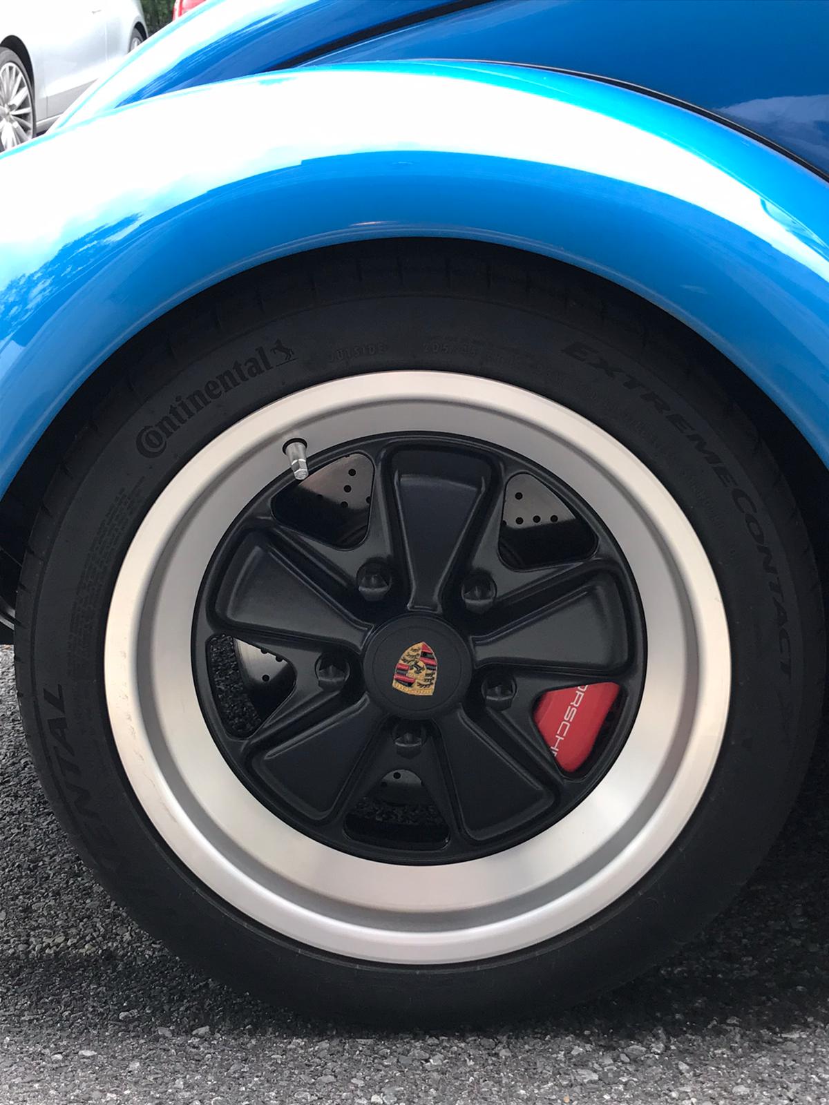

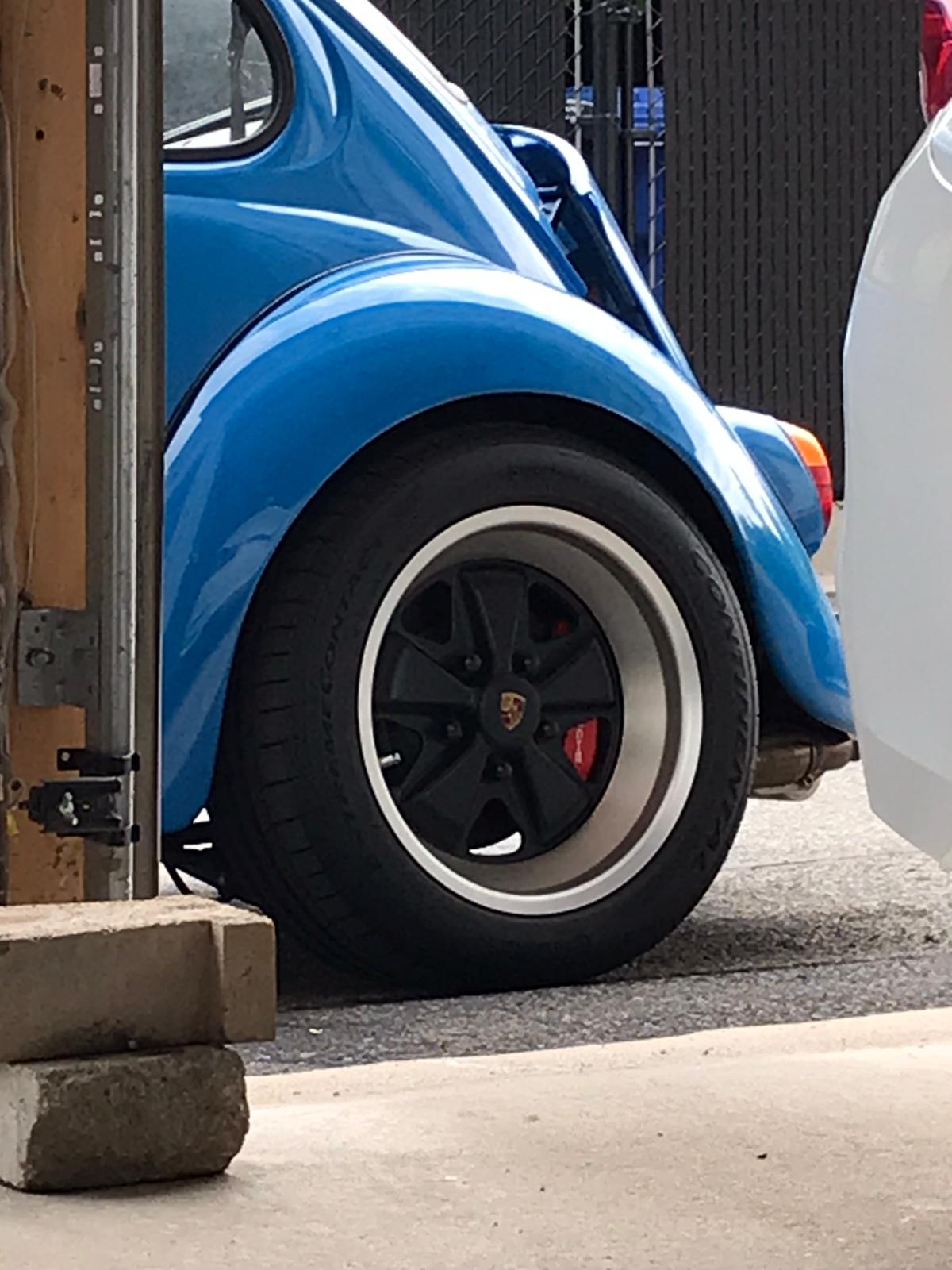

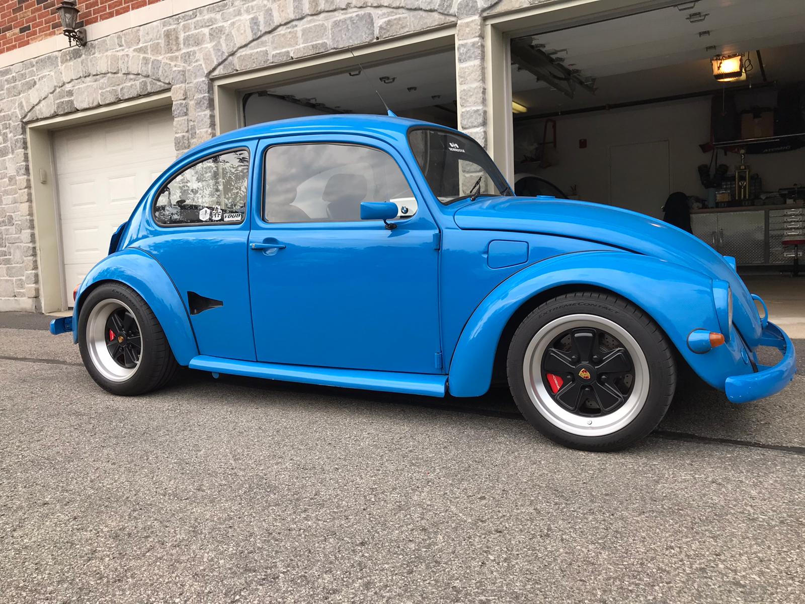

Here's a VW I built on the same brake setup, 16*7/8 wheels. Yum

Super cool bug! (IMG:style_emoticons/default/smile.gif)
I would be curious to know more on that car... Engine, trans, rear IRS I suppose, looks like a 68 or 69 with earlier front fender and bumpers? Fun stuff. I bet @Mark Henry would be curious too... (IMG:style_emoticons/default/smile.gif)

@montreal914 , funny you should ask...are you in Montreal? That car is. 2332t1 EFI, built 091 trans, irs rear, a-arm front end, rack and pinion steering. It's a euro 71 iirc. Getting a turbo this winter..aiming for 300whp (IMG:style_emoticons/default/evilgrin.gif)
