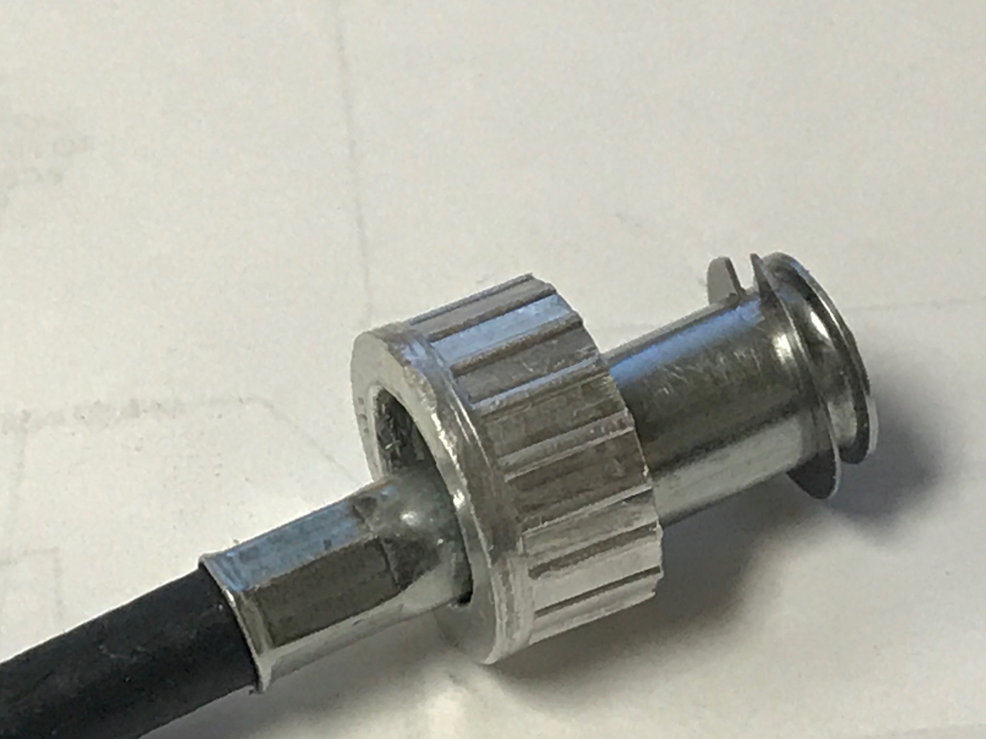

I ended up making the cable work. I realized that the bad angle gear nut could come off the sheath if I could get the smaller speedo side nut off. I carefully enlarged the hole in the speedo side nut until it cleared the flange. I then slid the bad angle gear nut off and replaced it with the nut from my original cable. I then made a thin split washer out of a shim that captured the speedo nut. Worked like a charm. See the picture.
