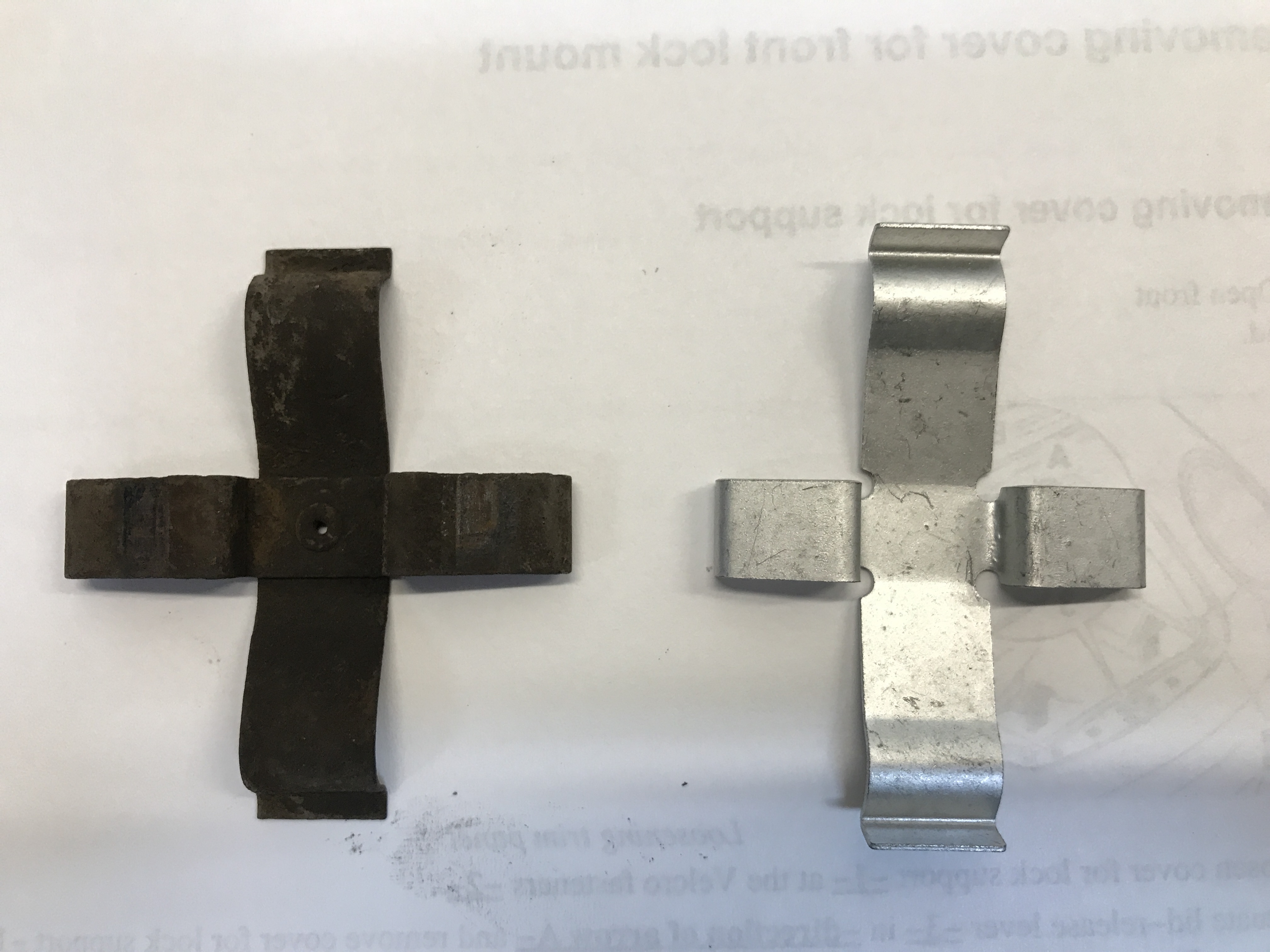

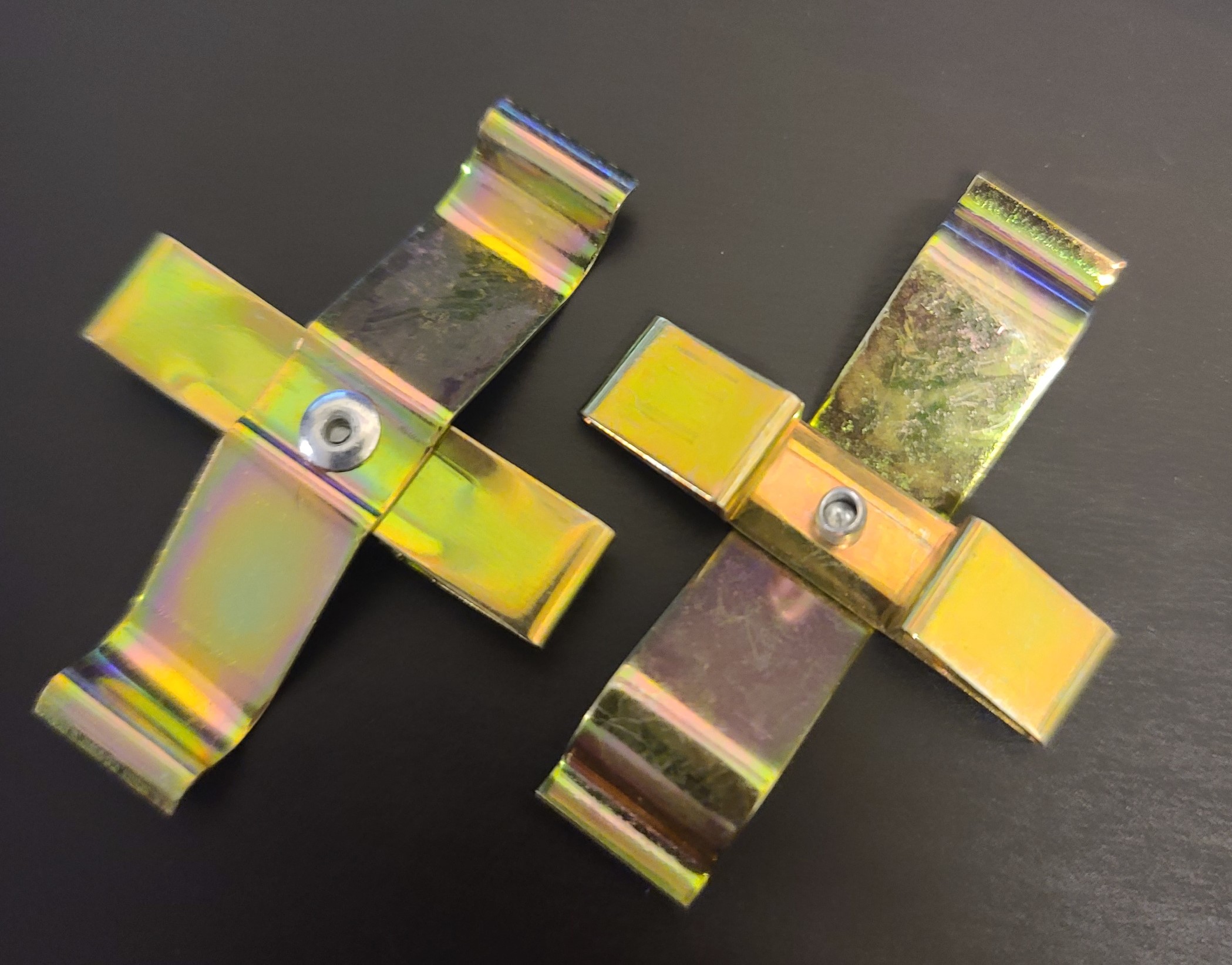

So far I have purchased new pad spreader springs for front calipers (914-4 late), and both are too narrow. Heres the one I took off, and one of the replacements. The original has a wingspan of about 54 mm, and both new springs only about 45 mm.
Both vendors sold these as part number 901 351 916 16, supposedly for late calipers.
Does anyone know of a source for the correct springs?

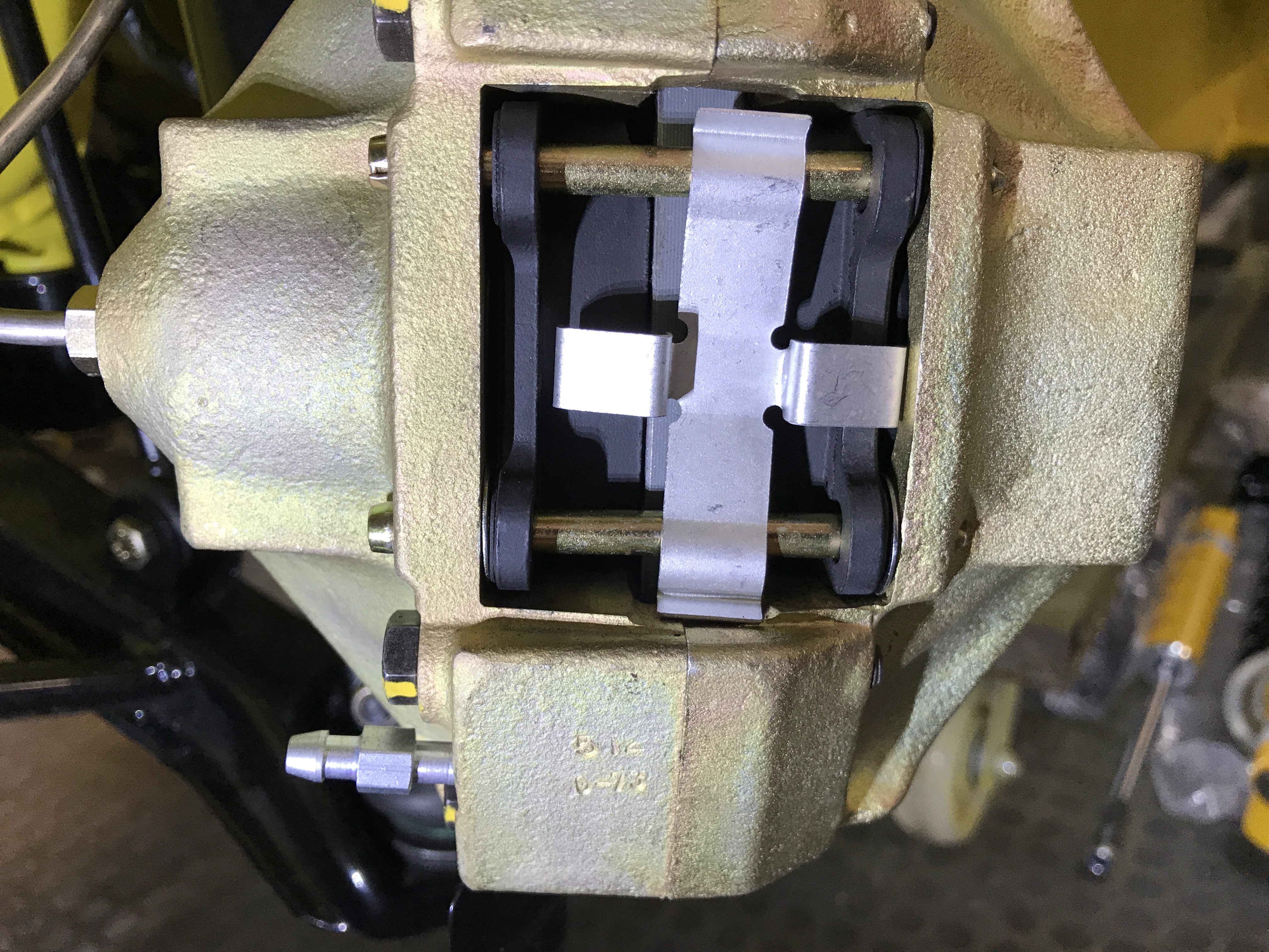

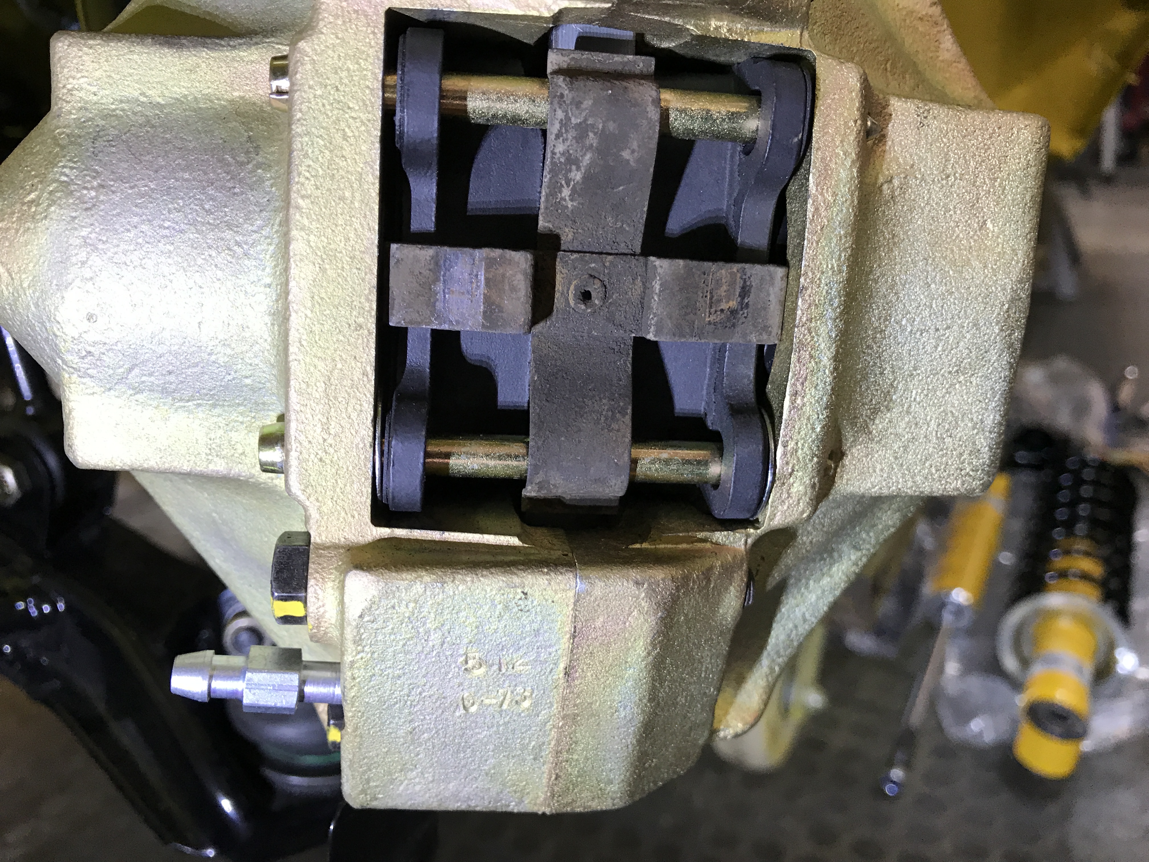

Here's the original propped in the caliper. It fills the entire opening for the pads.
bkrantz
post Feb 9 2021, 09:38 PM
Posts: 8,646
Joined: 3-August 19
From: SW Colorado
Member No.: 23,343
The new one is too narrow, and actually blocks the pads.

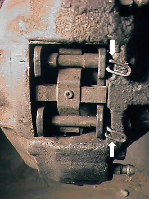

QUOTE(bkrantz @ Feb 9 2021, 07:38 PM) *
I think that spring is inverted
https://www.pelicanparts.com/techarticles/9..._brake_pads.htm
bkrantz
post Feb 10 2021, 07:15 AM
Posts: 8,646
Joined: 3-August 19
From: SW Colorado
Member No.: 23,343
QUOTE(ndfrigi @ Feb 9 2021, 09:37 PM) *
Yes. I just put the springs in the front of the caliper to show the issue with the width.

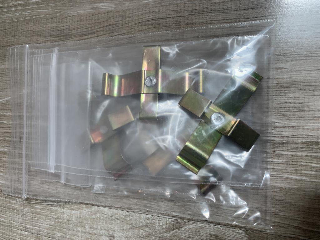

I have a bag of new springs that MIGHT fit. PET shows that part number 901 315 919.16 for EARLY CALIPERS to 72. Your part is 411 615 269A.

This might be what you need. Click to open
Mikey914
post Feb 10 2021, 01:18 PM
The rubber man
Posts: 12,772
Joined: 27-December 04
From: Hillsboro, OR
Member No.: 3,348

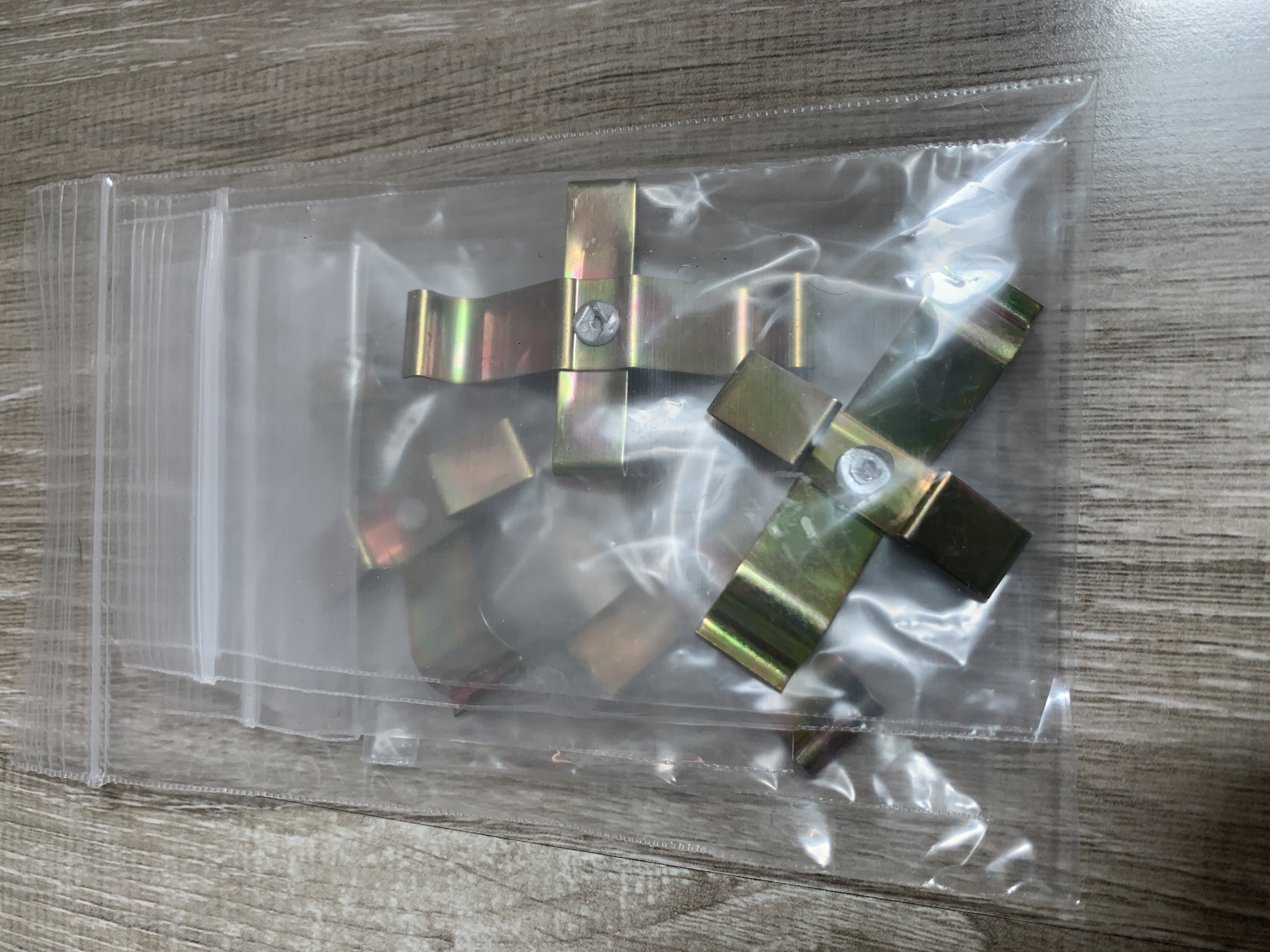

We had made up a whole bunch of these for Eric on spec and he decided we were too expensive. so let me send you a set. PM me your address I'll drop you a set out.

I will do up a GB for these in the next 10 days figure $19.99 for a set of 4? I know other places these are selling at $10 a pop. Should be a good value. I've spent a good chunk on tooling to get these right. Note that the indentation like OEM used to have to mount these perpendicular (the new ones do not have it).

Received them today and nicely made sir Mark! @Mikey914
thank you again! Stay safe and God bless!

Hmm, those still look narrow to me.
